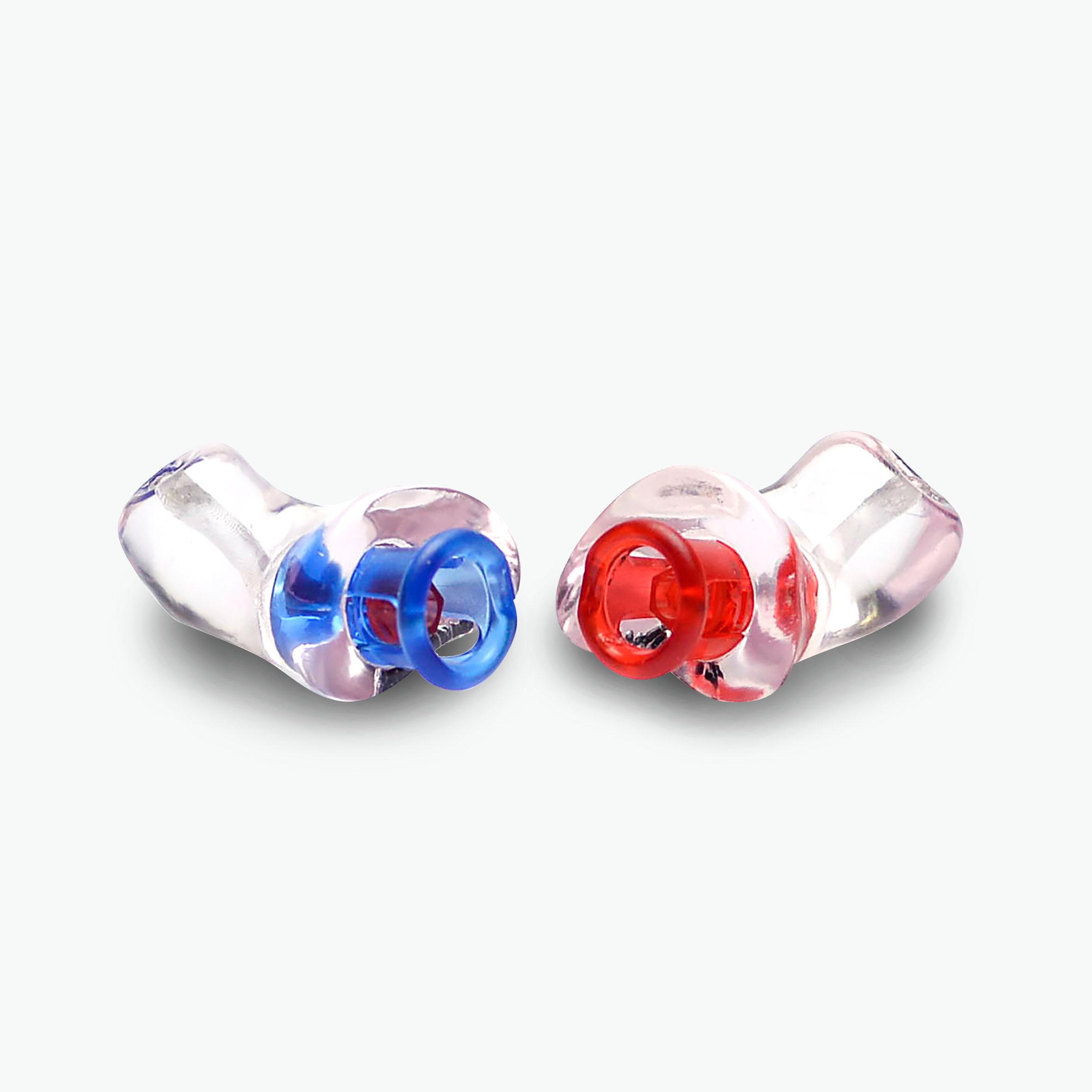

I work for a historic site where while demoing we need to be able to hear and talk to the public. I have been looking for some ear protection that will allow me to hear and speak with guests more easily, be discrete as we are in a historic space, and give me some protection from the anvil ring. Does anyone have any suggestions?
I have been looking at these but was curious whether anyone has had any experience with them. Earpeace HD - Musicians Ear Plugs

I looked those up and they are certainly discrete compared to my sound cancelling  earmuffs. Those plugs say they work with noise up to 110 db. 110 is not very high. If you have a power hammer they will probably not be enough.
Another choice would be to look at what hunters use to cancel the noise and still be able to hear and talk. All of these gadgets are not cheap, but your hearing is worth it.

To return to your original question, to this explanation about the possible use of otoplastics. These hearing protectors are custom molded plastics from your ear canal that are equipped with special filters that allow communication but attenuate the dangerous sound frequencies. I use these plastics in my workshop but also with other filters when riding a motorcycle. The great thing about these plastics is that they filter out the harmful sound, but make communication and perception of the ambient sound possible. To the fact that I have forged and grind 25 years plus without hearing protection, I am now partially deaf. In order not to aggravate this situation anymore, I have been wearing this PPE consistently since the last decades. In Belgium and Holland, the production of these customized plastics costs on average between 70 and 100 euros. But it allows you to continue to communicate and protect yourself.

I have used these for the past 20 years both in the forge, driving the tractor, shooting and other noisy places. They allow regular conversation and shut out the loud noises. They run around $10 U.S.
I use the "active noise cancelling" headphones from KOVE. At $200 they are not cheap, but cheaper than those custom made ear canal plugs used by shooters.
