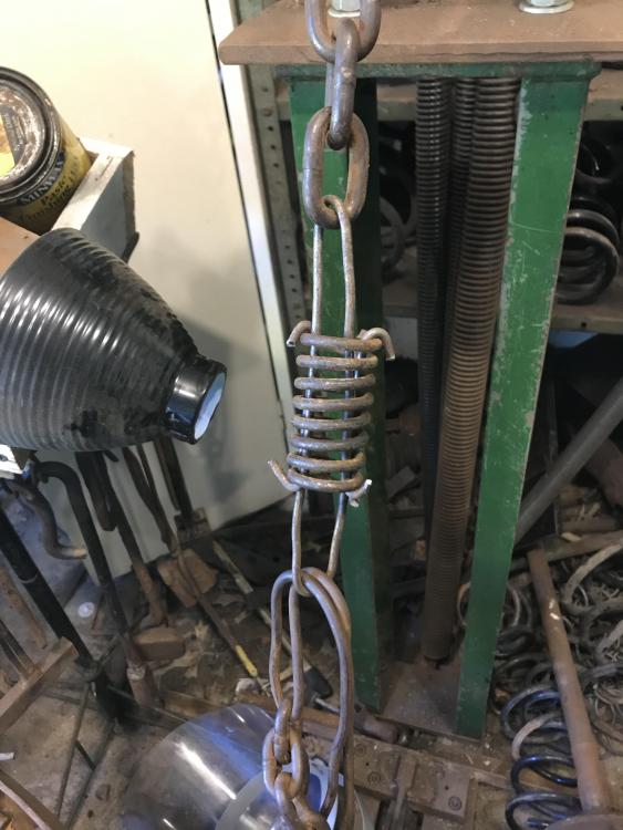

Have a small shop and was considering a treadle hammer that would attach to a wall post and be used on my working anvil (300lb) rather than having its own anvil separately.
I was considering a treadle hammer design which could swing up out of the way when not in use to free up the anvil for hand work.
I would love to hear ideas and comments from people if this is a good idea, or is it may actually damage the anvil if used in this way, or really if there would be some other downside to this set up Im not seeing.
I feel it might be tough to make an anvil base from scrap that would be as large or solid as my current anvil anyway, so it made sense to me in that regard.

My treadle hammer has a steel frame that holds it the proper distance from the anvil and a chain linkage that can be disengaged to allow the head to swing up and out of the way:
Note that since this photo was taken, I have modified the linkage to incorporate a shock-absorbing spring:
And the shortening/lengthening mechanism described here:
A sort of self contained "When I nod my head, HIT IT!"
Over the sweet spot it should be fine, if it's a hefty one I might not use it over the hardy hole.
My basic recommendation for this kind of setup is DO IT!!! This radically changed what I'm able to accomplish in the shop, and I don't regret it at all.

OK sounds like the votes are in and no issues to the anvil, just better not on a hardy hole. Ive seen old anvils with big saddle going on, but perhaps this was just due to HEAVY striking over 100 years or more?
