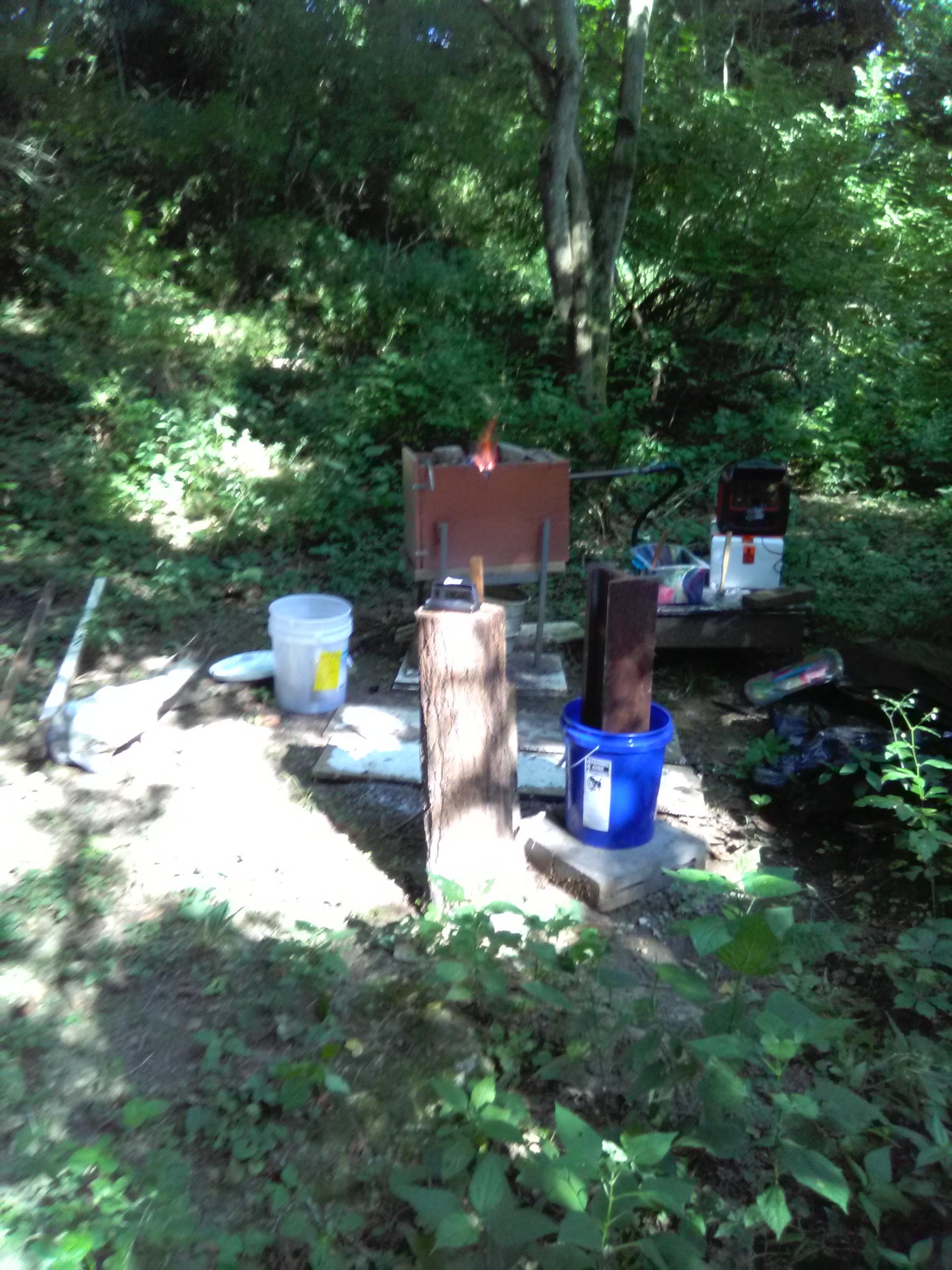

Kyle Haidet Posted December 18, 2019 Share Posted December 18, 2019 I’m a young blacksmith at the age of 17 and I don’t have enough money to buy myself a nice old style anvil. Heck I can’t really afford any anvil as a matter of fact... I’ve been using a railroad anvil that my uncle was given since I started and I’m definitely tired of it. It’s rounded face makes things quite difficult and I can’t even get a hardy hole or anything because I don’t have the tools available(all damaged and tools in need of repair). But I had a gentleman come to my house that lives more than 100 miles away to make me a very generous trade of two 5 gallon bucket sized steel cans and enough ceramic fiber insulation to line both cans to make myself a gas forge rather than coal. But this gentleman gave me the idea of making some types of hammers by making a shell and filling it with lead then sealing them. That idea later made me wonder if I would be able to make a nice anvil shell and fill that with lead. I’m not sure if it would work as an anvil since it’s filled with lead and I don’t know how rebound would be effected or what not so if you guys can give me advice on what to do and if it would be a good idea or bad idea to do the lead filled idea or not. Any help and free knowledge would be greatly appreciated Quote Link to comment Share on other sites More sharing options...
Glenn Posted December 18, 2019 Share Posted December 18, 2019 A collection of improvised anvils Solid fuel forges are cheap and quick to build. Look up the JABOD or 55 Forge. Do not tell us what you can not do. Show us what you have to work with, and we can give you ideas to make things happen. Quote Link to comment Share on other sites More sharing options...
pnut Posted December 18, 2019 Share Posted December 18, 2019 Any heavy piece of steel will work as an anvil. I use a 29 1/2in. piece of RR track as an anvil and it works pretty well. Have you tried standing your piece of track vertically? More steel under your hammer is better. I think the only thing I had to pay for in building my charcoal forge and RR track anvil was the matress pump I use for an air supply. If you don't have money you have to be resourceful and creative. A forge can be made from a box a pipe some dirt and an old hair dryer. Any relatively heavy piece of steel can be an anvil. This is what my "smithy" looks like. It's mostly things that were being thrown out or was free. Read through the jabod threads and the link Glenn posted and you'll get a better idea of how little it really takes to Blacksmith. Good luck be safe and remember it's supposed to be fun. Almost forgot to answer your question about the hammer and anvil filled with lead. No it won't work. It would be a dead blow hammer and dead anvil. It wouldn't have any real rebound. Pnut Quote Link to comment Share on other sites More sharing options...
Tom7 Posted December 18, 2019 Share Posted December 18, 2019 I'm a beginner too (probably a lot more so than you). I presently get by with a garden fire pit filled with soil, a piece of steel tube I had lying around that I've welded some legs onto and a mattress air pump. Only for outside use, of course, but I can keep a coal fire about the size of a sideplate hot enough to burn steel. The only big advantage I can see in a propane forge is that it doesn't take a quarter hour to get up to temperature. Quote Link to comment Share on other sites More sharing options...
maple smith Posted December 18, 2019 Share Posted December 18, 2019 13 hours ago, Glenn said: A collection of improvised anvils Or look up a video by Torbjorn Ahmen, he has one where he demonstrates making a forge using a pair of sawhorses, a wooden box, some dirt and rocks, a piece of tubing and a hair drier. He then uses it to blacksmith something. Quote Link to comment Share on other sites More sharing options...

Goods Posted December 20, 2019 Share Posted December 20, 2019 Kyle, I hope all of this has not chased you away. Get us some pictures of you current setup. We would love to help! If you in my area, I could help in person or hook you up with others who are much more knowledgeable than myself. David Quote Link to comment Share on other sites More sharing options...
Glenn Posted December 20, 2019 Share Posted December 20, 2019 59 minutes ago, ThomasPowers said: As I recall IFI started as Glenn was not happy with how another blacksmithing forum ran. Thomas you are thinking of a completely different website, NOT IForgeIron. IForgeIron was started as I collected information from the internet and folks wanted a copy printed and sent to them for reference. Copies of the information and postage became an issue and the web site was established so the information was more readily available. IForgeIron has supported other websites, and still does. IFI was the original photobucket and gallery for one website. The images had only a 24 hour lifespan and were then deleted. Another web site had server issues. A new section was set up on IFI with a different format to serve and support those folks. Three weeks later their server come back on line. Four hours later IFI took down the section and posted a redirect link to the new server. IForgeIron currently has direct links to over 50 Blacksmithing groups and organizations in the United State and blacksmithing links to 5 other countries. More can be, and are, added upon request. Location is important when we reference to information and events in YOUR location. IForgeIron has always supported the blacksmithing community. It is a G rated family forum and a comfortable place to visit in order to learn about blacksmithing and metal working. Quote Link to comment Share on other sites More sharing options...
Charles R. Stevens Posted December 20, 2019 Share Posted December 20, 2019 Kyle, building a gasser will add a $150 or more to your starting expenses. While for $50 or less (depends on your abilities as a scrounge) you can get started with a solid fuel forge. The only reason we want to know where you live on your profile (give us an idea with in an hours drive or so) is because we have folks from 150 countries here. If you live in Ferndale Australia I am not going to recommend you swing buy Iron Dwarf’s shop in Wales UK. An hour with an experienced Smith will save you hours on your own (not that you can’t do it, many off us have) and he or she knows the lay of the land as fate as were to find fuel, tools and materials. I my self am all about low budget smithing, and with a $100 and a trip to town can have a forge, anvil, starting tools and stock. Given a week or two of scrounging I can get that down to $20 or less. Experience and knowledge are tools you will always have and we are willing to lend you our experience and share our knowledge. We ask three things in return, do your homework (read at least the stickies in the areas your interested in so you come from a complete know nothing to a level of ignorance so you can ask good questions.) the only dumb question is the one you don’t ask, but some of us have answered the same question thousands of times. Remember the manners your mother taught you, even old crotchety old men like me forget and will be reminded of that one. Makes the site run smother and makes old colts like me just that much more willing to invest time in answering questions. Lastly, pass on what you learn. Even I can learn something new from you. Be it a new and inventive mistake, a better way to pass on my experience or just onsite from a fresh set of eyes. we are all guests her on Glenn's front porch, he provides us a place to learn, visit and have fun. IFI is an interactive pear reviewed document, bad advice and information won’t stand long and we have people who are real experts who contribute. We do have our squabbles, it’s hard not to with so many members from all over the world but Glenn and crew do a good job riding herd on the rable. Quote Link to comment Share on other sites More sharing options...
