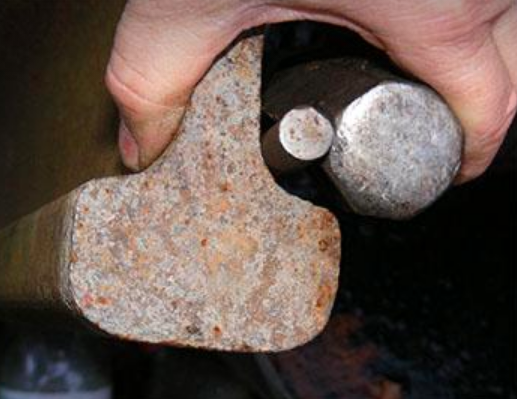

Glenn Posted November 12, 2019 Share Posted November 12, 2019 A really quick search turned up 3 anvils. 70lb. Farrier's Anvil A $2.84 a pound used. A bit light for blacksmithing but can work. 260 lb double horn for $6.92 per pound new. 125 lb double horn for $6.76 per pound new. Cast entirely of H-13 tool steel 3 hours ago, Bubbadreier said: I have a couple Railroad pieces but when I stood them up on end I realized how small the face would be and i am not certain my hammer control is that good. A photo of a piece of RR track, a 2 pound hammer head, and a piece of 1/2 inch round stock. Only the metal under the hammer moves on impact with the hammer. So please tell me again why you need an anvil face the size of the flight deck on an aircraft carrier to forge on. You may want too review A collection of improvised anvils Quote Link to comment Share on other sites More sharing options...

Bubbadreier Posted November 12, 2019 Author Share Posted November 12, 2019 Glenn, I think my Railroad Track is smaller than yours. I could be wrong, I am not the best at judging size from images! I added a couple of pics of mine next to a 2 pound hammer. Quote Link to comment Share on other sites More sharing options...
Glenn Posted November 13, 2019 Share Posted November 13, 2019 Thomas, USS George W. Bush has a displacement of approximately 97,000 tons (87,996.9 metric tons), or a good size for an anvil for a power hammer. The 332.8m-long supercarrier features a 4.5-acre flight deck so there is plenty of room for a couple of strikers. Bubbadreier point taken. If you can drive a nail with a hammer you should be able to hit hot metal with blacksmithing hammer, and a little practice. Look at the hammer faces and notice that your hammer face could benefit from some contouring at the edge of the face. This blends the hammer fact to the hammer head and there is less of a chance of leaving hammer marks. Start looking for a piece of metal 50 to 100 pounds in weight that you can use as an anvil. The improvised anvils topic provide some great ideas. There is not going to be one item that does everything you need. You may need flat surfaces, cone shapes, round shapes (both outside round and inside round curves) and the list goes on and on. Pipe for example had the recognized outside round shape. If you cut it open it now has a curved inside shape. Collect several sizes of the pipe for use. Just keep your eyes open and do not look, but see the possibilities. Quote Link to comment Share on other sites More sharing options...

pnut Posted November 13, 2019 Share Posted November 13, 2019 Bubbadreir, I believe what you have is light rail maybe from a spur line, mine, or possibly a crane as it indeed looks smaller. I'll try to take a pic of the cap on my rail anvil with a tape measure on it. The rail I have is main line rail weighing 139lbs/yd. If I remember what the guy from the maintenance crew told me correctly. The cap is the part the wheel rides on. It's in the teens outside so I may not go to the forge for a couple days but I'll try to remember to snap a pic when I do go. Pnut Quote Link to comment Share on other sites More sharing options...
MC Hammer Posted November 13, 2019 Share Posted November 13, 2019 If you want a cheap anvil that is better than a railroad track or a cheap Harbor Freight anvil, check this review of a cheaper 66 pound anvil by an experienced blacksmith: I was kinda surprised that it performed well enough for someone to use it to get started. I hate to see people go the railroad track route. I've heard so many guys talk with great regret all the years they spent using them and struggling to move metal. Again, not a great anvil but better than many other alternatives and it's affordable. Quote Link to comment Share on other sites More sharing options...

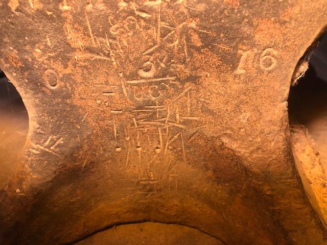

Bubbadreier Posted November 15, 2019 Author Share Posted November 15, 2019 Well wouldn't you know it, the little craigslist ad I put out a few days ago turned up a little gold for me. At least I am going to call it gold, you all might tell me different. I got a call from a gentleman this morning, and he tells me that he saw my ad and he might be able to help me. He has an anvil in his shop that has been there for 20+ years and he has maybe used it twice in that time. He works on machinery for people and some old man had traded a bit of work for it but he just never used it once he got it. He couldn't tell me the weight but he could give me the dimensions. Based on what he told me and comparing it to the below chart, I figured it would be right around 100 pounds. I ask him for pictures but this man said his phone doesn't take pictures. Well I ask what he would take for it and he tells me that the price of these things are pretty high but if I could come up with $250 then it was mine. Well for $250 I thought a 45 minute drive would be worth it, I could still walk away if it was trash. So when I get there he had it pulled out for me and it was covered in cob webs and dirt but it looked pretty darn good. I don't know much about anvils (I still haven't put in the time to learn, shame on me), but I figured it was worth the risk, if anything I can throw it in the flower garden in front of the house. We shook on it and I loaded it up to take it home. Once home I put it on the scale and it comes out to 96 pounds, and for $2.61ish a pound I hope I did pretty good. I will let you guys tell me if I made a mistake. I have included some pictures I took when I got home. I can't read the markings because it looks like there are several different markings and I don't have a clue what I am looking at, but I included a few of those as well. Any help would be appreciated. Now to research how to clean it up! Quote Link to comment Share on other sites More sharing options...
