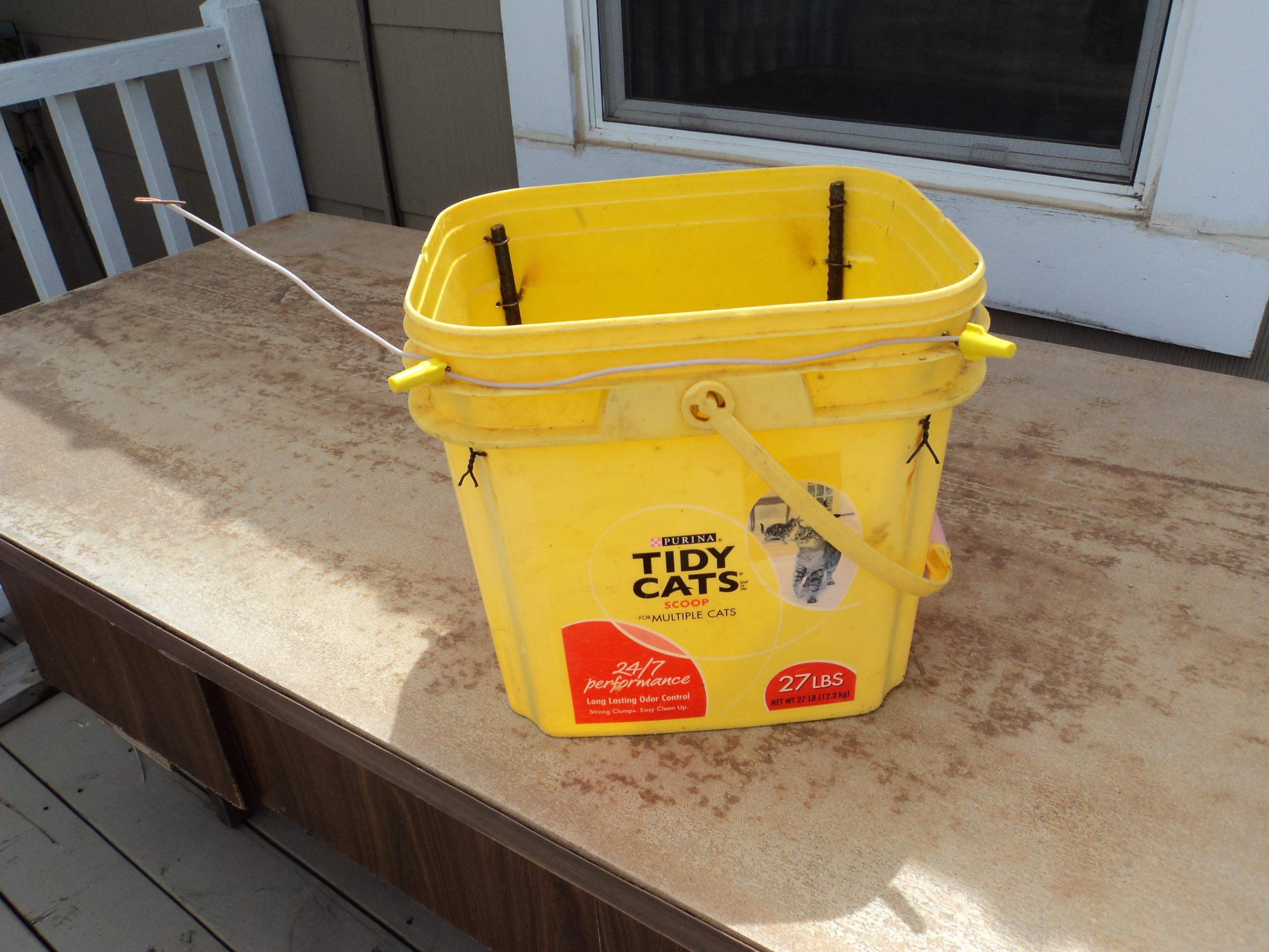

4575wcf Posted December 31, 2021 Share Posted December 31, 2021 Hey All It has been two years since I submitted this electrolysis post to the shotgun forum, but I still had the pictures on the PC, so I will duplicate it here Picture #1--This is Oscar. AKA known as "Shopcat" or "Donor of the Bucket" Picture #2--The Tidy Cats 27 lb cat litter bucket. Just about made to order for de-rusting a shotgun receiver. Picture #3--!2 inch pieces of 3/8 inch rebar from Home Depot are cut off a few inches and wired into the "racks" in the side of the bucket. Two small holes drilled through each side of the wire at the top of the bucket allow soft iron ties to hold them in place. Picture #4--Another tie at the very top is put on by the same method using solid copper wire to attach the DC electric source. Picture #5--The receiver is hung off a dowel with soft iron wire, with a receiver flat pointed toward each corner of the bucket containing a rebar because the process works pretty much line of sight. Picture #6--In this operation, the receiver is hung by slipping the wire through the trigger plate hole in the bottom of the water table and bending out a T shape to keep it from slipping off. Conforming grooves are rasped into the bucket top to hold the round dowel in place on the bucket. Picture #7--The whole set up. The Super Soda, the modified bucket, and the battery charger. A quarter cup of the Super Soda with enough water to fill the bucket up to the first set of wire holes is about the right mix. I would guess this bucket holds about 2 1/2 gallons. Picture #8--The leads are hooked up. Black (negative) goes to the soft iron holding the receiver, and red (positive) goes to the wires connecting all of the rebars around the bucket, completing the circuit. Picture #9--The receiver after the treatment with the rusted components removed. I gave the thing about 8 hours, then another 8 before I was satisfied with the results. A LOT of junk comes off in the solution in the form of millions of small bubbles forming a cloud around the metal. You will swear it is dissolving; I did, but nothing of the sort happens. Only the rust seems to be going away. Notice the coiled trip spring came out as a solid cylinder! Quote Link to comment Share on other sites More sharing options...

4575wcf Posted December 31, 2021 Share Posted December 31, 2021 Glad to help. I used the manual setting on the battery charger 2 amps. Even if you don't have a cat, that Tidy Cats litter kicks butt on oil spills in the shop. I did not try this on anything that was still blued. Since bluing is an oxide it might very well go away. Quote Link to comment Share on other sites More sharing options...
arkie Posted January 1, 2022 Share Posted January 1, 2022 Note to those starting out using electrolysis for derusting. As 4575wcf mentioned, he was using his charger on "manual". Very important. The automatic chargers most prevalent these days have a sensing circuit that "looks" for a low voltage or dead battery. That circuitry won't work with electrolysis...one has to use a manual charger. Quote Link to comment Share on other sites More sharing options...
4575wcf Posted January 2, 2022 Share Posted January 2, 2022 Good catch on the manual charger. Most of my tools have been around awhile. I suppose battery chargers have evolved since I purchased mine, so not all will have the manual setting required. Quote Link to comment Share on other sites More sharing options...

Frosty Posted April 7, 2022 Share Posted April 7, 2022 A thing to know about electrolysis goes like this. It's not dissolving or removing rust, it converts it back to the original metal, be it: iron, steel, brass, silver, etc. It removes the oxygen from the molecules. Anyway, as noted regarding the spring above electrolysis tends to weld connected things into one piece. It's an excellent process but like anything, things can go wrong. It's worth it to try it out first on something not too valuable. Frosty The Lucky. Quote Link to comment Share on other sites More sharing options...
