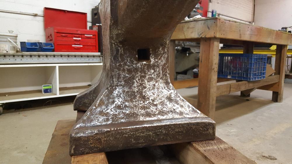

Biggundoctor ; hammering on the face does not seem to indicate delamination, and rebound is moderate but all I have at hand is a rather small bearing which may affect the results due to the lack of mass. Also, the anvil is set on a welded 4x stand with a piece of 1/4 plate, and a moveable machine base under. This may contribute to the lack of ring since the base is strong but may absorb and not reverberate sound .... Frosty, thanks for the input, will try the vinegar etch.... I could not agree more with you as far as brand vs true fitting tools.... I’ve been in commercial architectural mill work for near 25 years and have 25,000 sf of tools from chisels to CNC routers and machining centers... many of our branded equipment functions well but is not always a perfect fit... it is a matter of personal choice. Many of my employees along the years boasted the high quality of their marple chisels, convinced the name implies quality... personally I think of them as a glorified glue scrapper and mini pry bar. The steel is way too hard to take a true edge. I suppose it’s ok when you dress your tools on a bench grinder until they smoke. On the other hand, I have owned a set of sandvik chisels for 30 years, hard enough to get the job done yet soft enough to raise a bur with a few light strokes on a water stone, they fit me perfectly and would not go anywhere without them ... My quest to identify this anvil is more curiosity, as well as the fact that a friend of mine sold it to me and if it is indeed a PW I would feel a tad embarrassed for involuntarily shorting him with a 100 dollar bill and would consider giving him a few more.... one thing that puzzles me is that the waist shows what I believe to be casting bubbles on both sides which does not seem in line with a forged anvil and PW... The photo with tape showing height illustrate what I am referring to ......

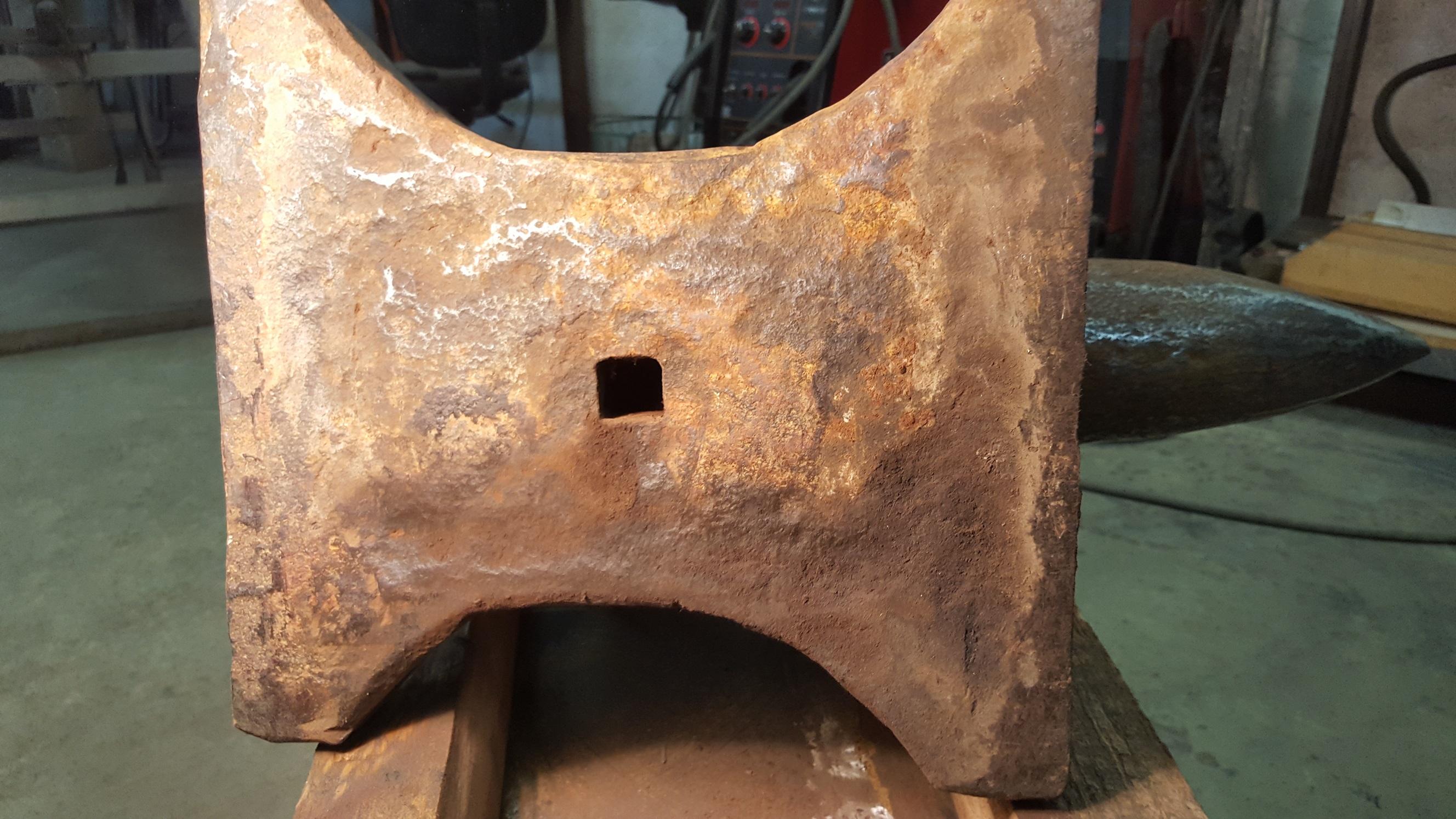

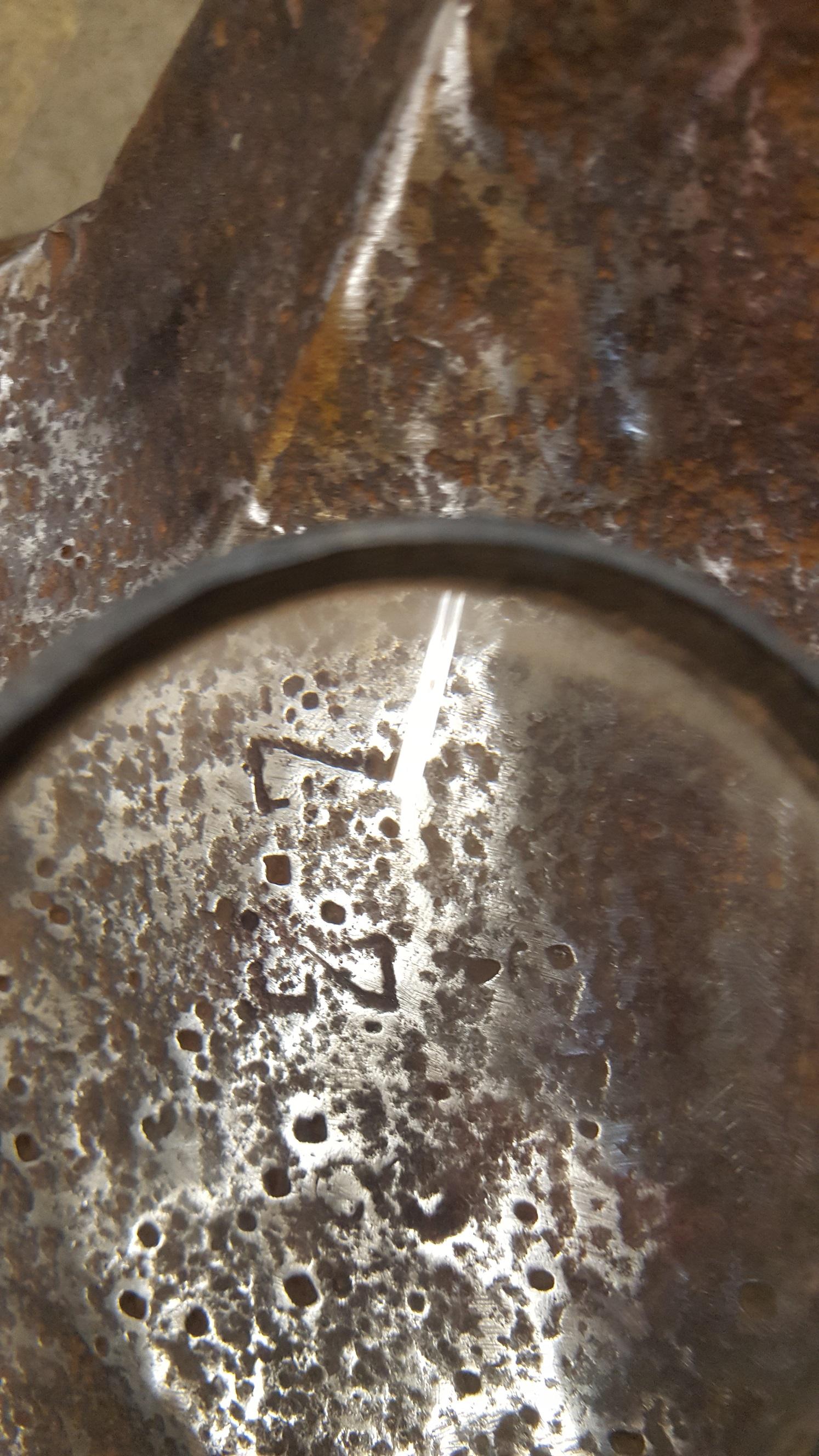

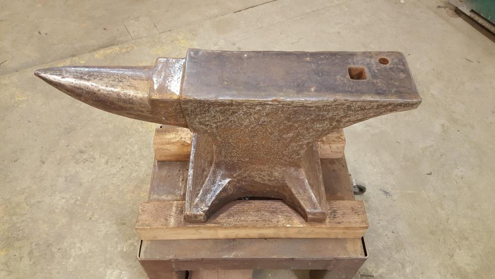

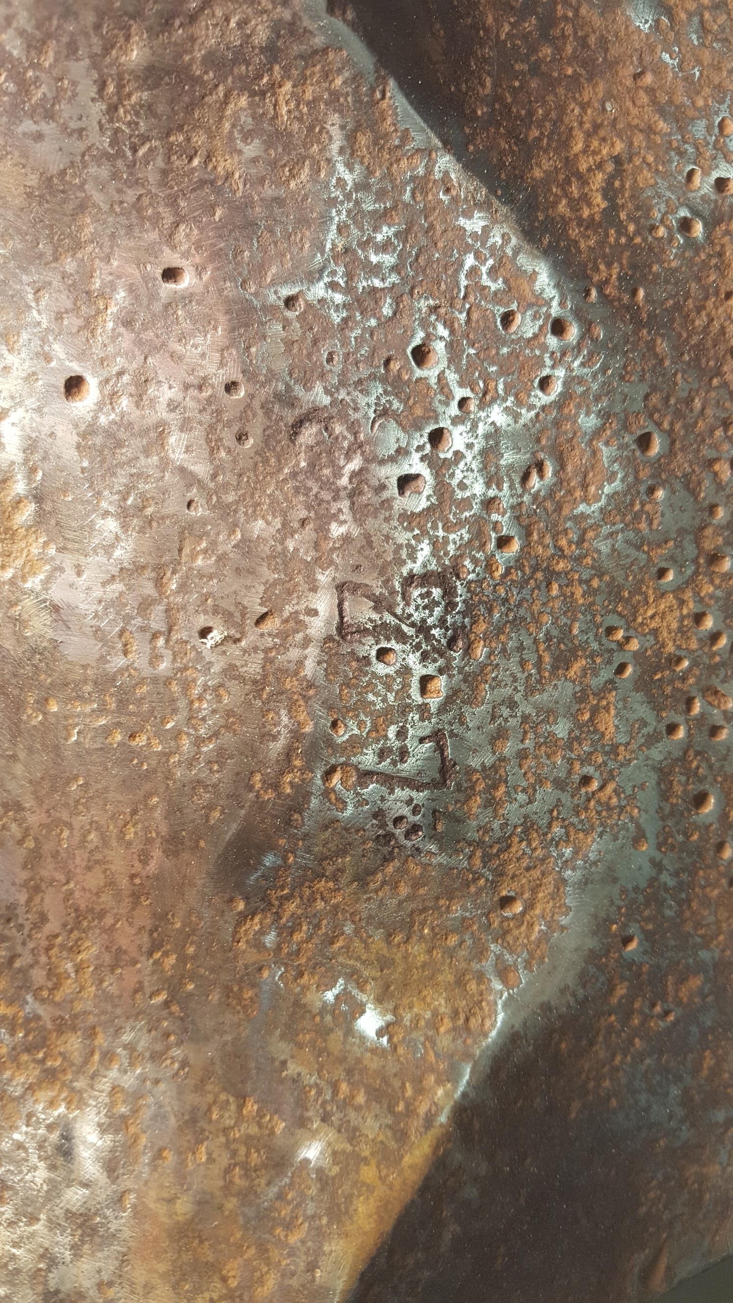

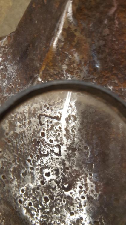

Thanks for all the input ... JHCC ; I did think it is a little" Writish" but considering what it cost me, did not want to be overly optimistic ... like your theory ... Marcus Aurelius ; no other marking that I can see anywhere .... your comment on rebound made me check that again, 24" drop gave me an average of 15" rebound with .5" ball.... PNut ; did get it for peanuts .... (ok that was cheap!) Thomas ; I like your 2-2-27 theory, certainly would explain the 306.5 spacing of the numbers is pretty wide for 27 and not sure it would all fit within the space ... Marc1 ; going for "Wrightish" until better analysis .... Definitely going to use it to forge. Side draft forge will be cut on our plasma table in a couple days .... Pierre

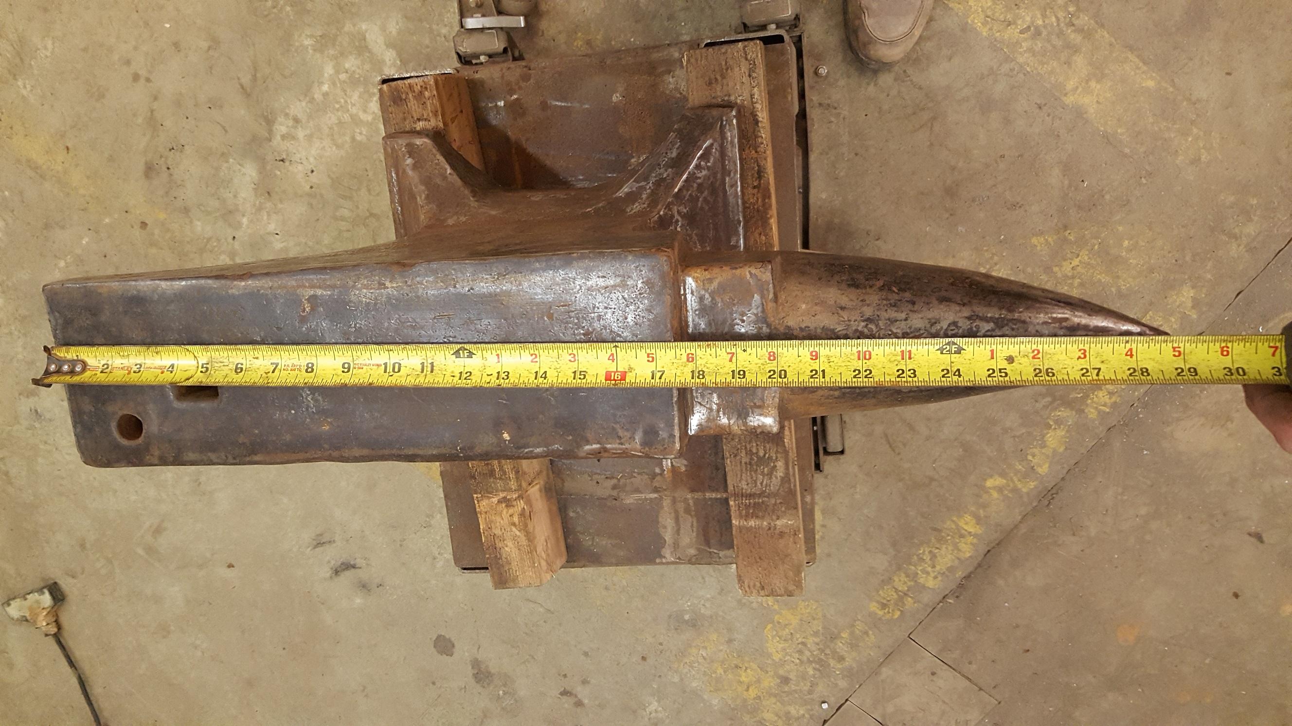

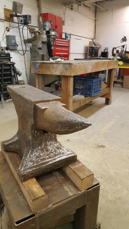

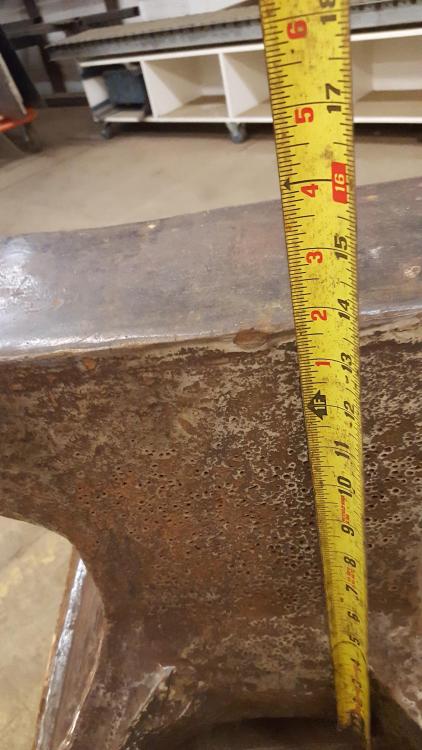

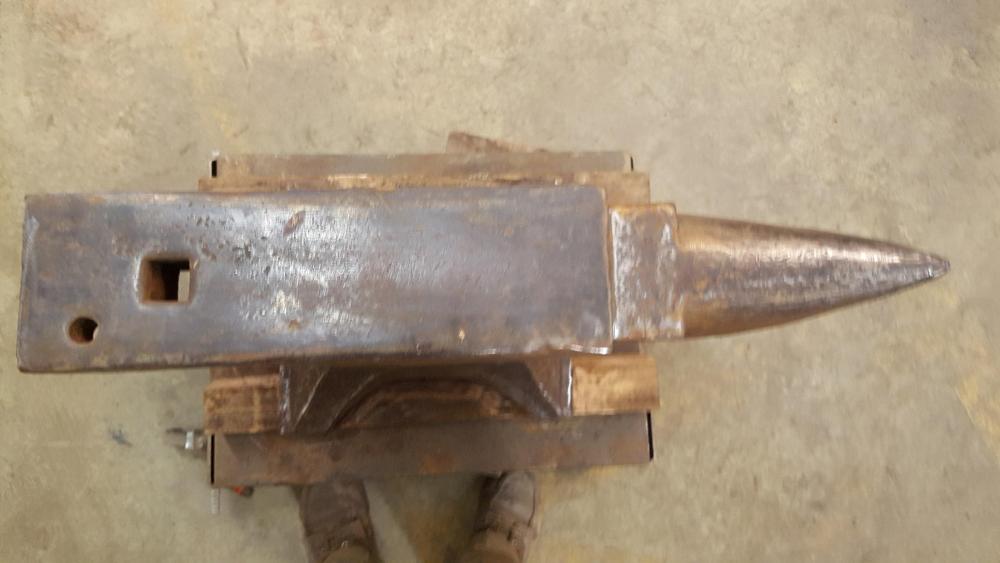

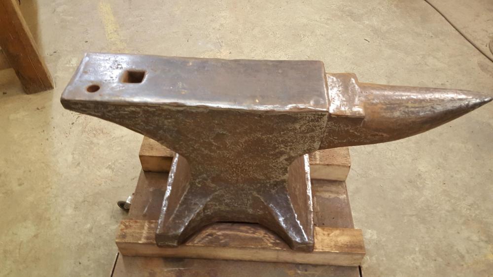

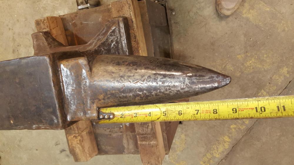

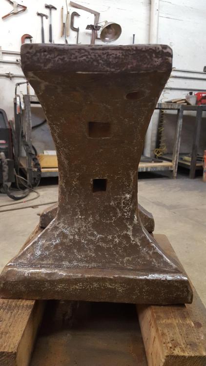

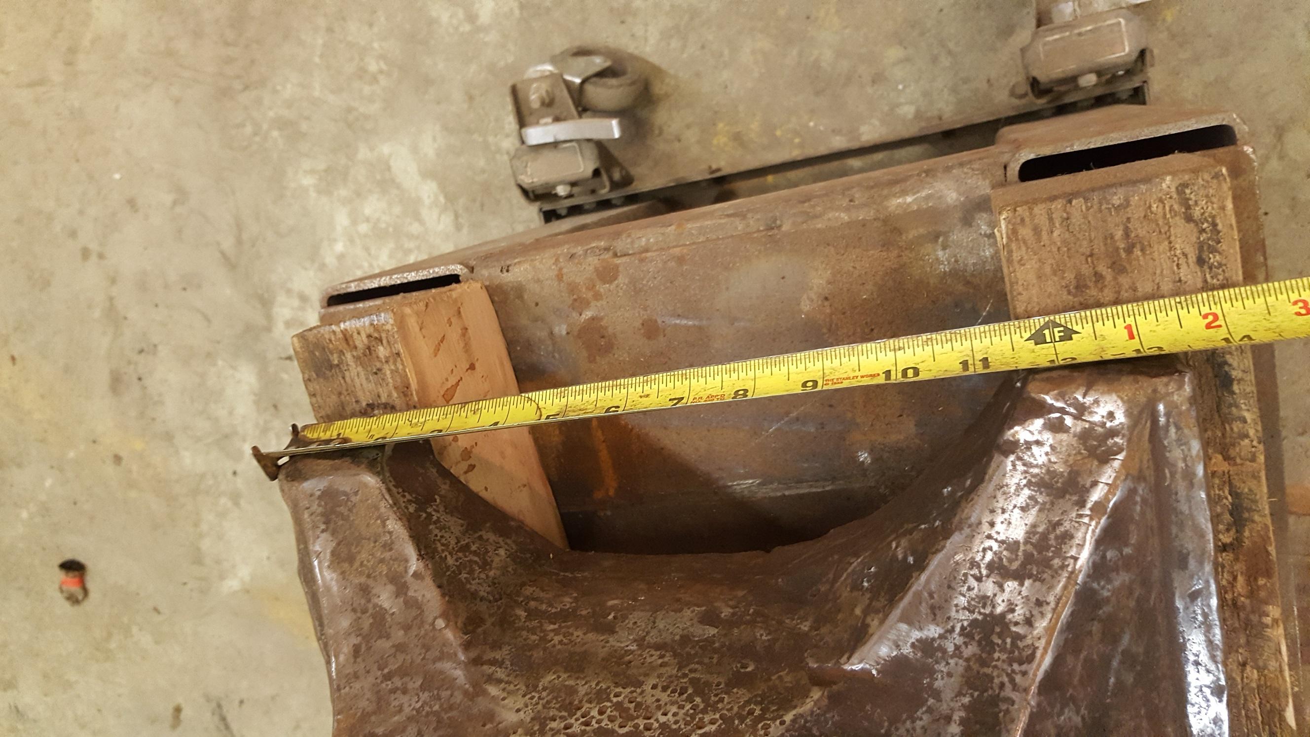

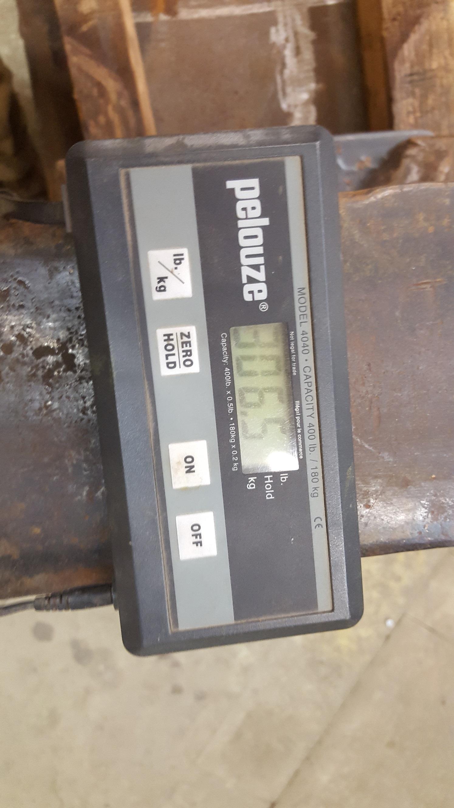

Hello all, and thank you in advance for your help ... I acquired this anvil a couple years ago for a $ 100 bill, and it has since been parked in a corner of our welding shop. Finally had time to clean it up a little and would like your opinions as to its provenance. it is approximately 32" long, 13.5" high, 5.5" wide table, tips the scale at 306.5 lbs cannot see any obvious line between the body and table. Looked everywhere and the only markings to be found are a 2-7, first number being very difficult to read ; it could be a 3, an 8 , a 2 .... due to its actual weight of 306 lbs, I assume it is a 2 which would make it a 2-2-7 or 287 lbs .. not sure why the actual weight differs by an additional 19 lbs .... The odd thing being ; if it is a 2, the font would seem different than the next 2 .... The anvil has moderate ring at horn, stronger at heel (less mass I assume) faint ring on the table. Hammer seems to rebound nicely, a .5" ball bearing dropped from 12" rebounds at least 6"..
