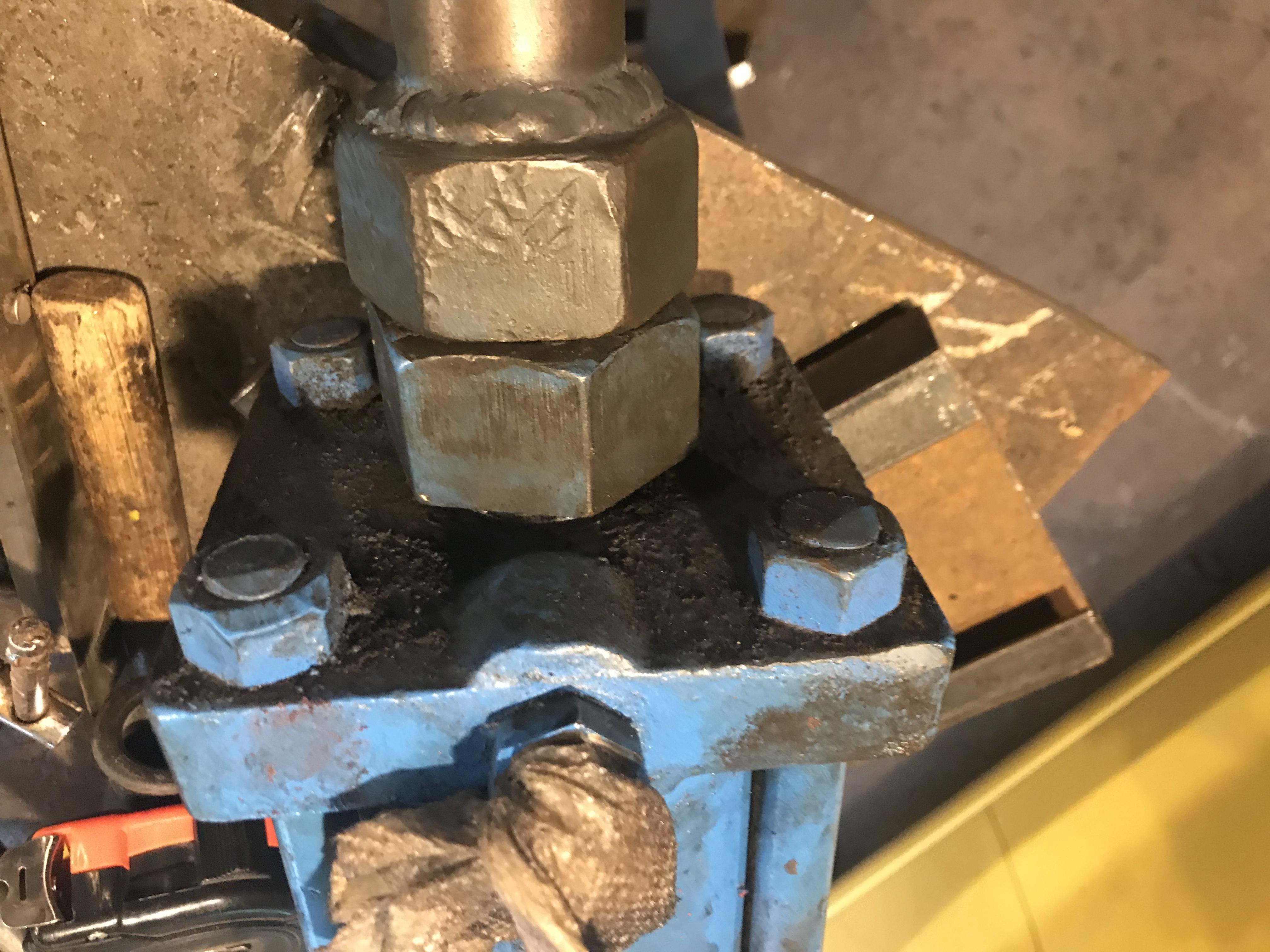

JHCC Posted June 20, 2019 Author Share Posted June 20, 2019 A thought occurs to me: If I can identify the specific diameter and pitch of the threading on the bottom end of the tie rod (where it screws into the end cap), can I not simply get threaded rod long enough to span that distance, assuming that the tensile strength is sufficient? If the cylinder has an internal diameter of 4", that's a piston area of ~12.67" sq. Multiply that by the maximum pressure from the pump (4,000 psi) gives us a maximum pressure of just over 25 tons. I took a look at the McMaster Carr website and find they have grade 8 threaded rod with a tensile strength of 150,000 psi. The tie rods are 5/8" diameter, so their cross sectional area is 0.09765625 square inches. Multiply that by 150,000 (tensile strength) and again by 4 (number of tie rods) and you get 29.3 tons. That should be sufficient, right? (Also, in the Serious Irony Department, the cost for those four rods would to be more than I paid for the press in the first place!) Quote Link to comment Share on other sites More sharing options...
Frosty Posted June 20, 2019 Share Posted June 20, 2019 Yeah, can't blame them, liability issues dealing with folks making their own hydraulic systems, especially modifying existing components. It always makes them twitchy. We're writing at the same time again. Didn't I suggest buying grade 8 bolts long enough to fit through the table top and close cylinder, some time ago? Sure my first was to thread the table top but you pointed out the hyd. cylinder was threaded so I adapted the suggestion to feeding the bolts through the table top and cylinder to the far cap. This is just a correct thread pitch / Diameter x length bolt. A thread gauge is cheap and SAE, Metric combos are the norm. Criminy! I just did a quick search and it looks like they're pushing $40. and it's hard to find the simple flip out index ones that look like feeler gauge index. So, here's the alternative to buying a thread gauge. Pull one of the bolts and go to a Fastenal, go to the nuts bin and start trying nuts till you find one that fits. Write down the number. My memory is so shot I sometimes forget the note pad in my pocket or to look at it. Well, HECK you'll know how long the bolts you need are when you check the thread pitch so buy them. McMaster Carr is kind of expensive and the Fastenal close to me gives me a senior discount and because I'm a likable BSer they usually give me a commercial discount too. They don't even bat an eye when someone walks in with some weird contraption and heads for the bolt or nut bins. They have a LOT of useful stuff on the shelf and are happy to special order for you, only me charge shipping. I'm a likable BSer and do interesting things though. Didn't I tell you replacing those bolts would be expensive? Forget about determining the cross section area of bolts and the calculations stuff. The bolts come with a label or look it up online. I think I also mentioned grade 8 is typical beginner overkill, EVERYBODY thinks they need grade 8. . . NOT. Just look at the bolt's specs. You NEED 25 tons/ 4 is 6.25 tons per bolt, give yourself a REASONABLE safety margin, say 7 tons. The motor will burn up before you could get 28 tons. Do NOT take my guesstimate for it but I'm thinking grade 6 will be plenty. Frosty The Lucky. Quote Link to comment Share on other sites More sharing options...
JHCC Posted June 20, 2019 Author Share Posted June 20, 2019 7 minutes ago, JHCC said: Multiply that by 150,000 (tensile strength) and again by 4 (number of tie rods) and you get 29.3 tons. Also of note is the fact that their next highest grade of threaded rod only has a tensile strength of 120,000 psi, and would therefore only be capable of resisting 23.4 tons of force. Quote Link to comment Share on other sites More sharing options...

JHCC Posted June 20, 2019 Author Share Posted June 20, 2019 Surely not if they're running the entire length of the rod, yes? If the tensile strength is 150K psi, doesn't that take that into account? NB: If the thread turns out to be 5/8 x 11, there are grade 8 bolts of sufficient length available from Fastenal. If it's 5/8x18, I'll have to keep looking. Scratch that: the only grade 8 they have in that length is twice the thickness I need. Quote Link to comment Share on other sites More sharing options...
JHCC Posted June 20, 2019 Author Share Posted June 20, 2019 Also, since there's no lateral load, shearing isn't an issue. Quote Link to comment Share on other sites More sharing options...
JHCC Posted June 20, 2019 Author Share Posted June 20, 2019 Another thought: if I use threaded rod, I can bolt the cylinder together and not have to disassemble it to bolt it onto the top. The nuts holding the gland onto the cylinder would therefore act as spacers between the gland and the underside of the table top, thus: Quote Link to comment Share on other sites More sharing options...
Frosty Posted June 20, 2019 Share Posted June 20, 2019 John: You might want to double check the decimals there. My calc. says 0.625 dia. = 0.306 sq/in. x 4= 1.227 x 150,000 = 184078. lbs. total. / 2,000 = 92.04 tons. However, let's skip the rithmetic it's not necessary. This is my preferred engineering data site. https://www.engineeringtoolbox.com/ The specifics are here. https://www.engineeringtoolbox.com/us-bolts-tensile-proof-load-d_2066.html Note this chart is for coarse threads, compare to the same grades and dia. on the fine thread chart, down the page. Fine threads represent much smaller stress rises and leave more solid base stock with a stripping shear force per linear inch considerably higher than coarse. Being into overkill myself, I never put coarse threads in a high strength application. You're solidly in the comfort zone using anything above grade 2. Grade 5 is comfortably overkilled. Grade 8 is almost silly overkill. I used to make stuff like this for a living you know. I make mistakes but I welcome corrections, say thank you, adopt and adapt. I won't steer you wrong, if I say it's strong enough it is. But HEAVENS YES, double check what I suggest! If I'm wrong I want to know it so I can get it right next time. Heck, I was wrong about how many grades of bolts there are, good to look this stuff up now and then. Eh? I JUST saw your gland nut thought. NO! All a gland nut does is compress the packing gland it is NOT structural at all! That poor thing would be subjected to up to 25 tons of pressure and all it's designed to do is compress an oil seal against the shaft. In the old days packing was lead foil, modern packing is rope like stuff, rubber wiper seals, etc. Just enough oil is allowed to pass the seal to prevent the shaft from sticking. You'll rip the packing nut right out of the cylinder first time you smoosh anything heavier than a beer can, maybe then. It's a thought though, keep it up. Frosty The Lucky. Quote Link to comment Share on other sites More sharing options...

JHCC Posted June 21, 2019 Author Share Posted June 21, 2019 2 hours ago, Frosty said: I JUST saw your gland nut thought. NO! All a gland nut does is compress the packing gland it is NOT structural at all! That poor thing would be subjected to up to 25 tons of pressure and all it's designed to do is compress an oil seal against the shaft. I'm confused. The nut that holds the gland on right now is on the end of the tie rod that holds the whole cylinder together. If we just make that somewhat longer to project through the top, how does that place more strain on the gland? Quote Link to comment Share on other sites More sharing options...
Frosty Posted June 21, 2019 Share Posted June 21, 2019 17 minutes ago, JHCC said: I'm confused. The nut that holds the gland on right now is on the end of the tie rod that holds the whole cylinder together. If we just make that somewhat longer to project through the top, how does that place more strain on the gland? No, that's the cylinder cap and it's gasketed or o ring sealed. The long bolts hold the cylinder ends / caps on the cylinder. Do you have a reference for the term "Tie rod" in this usage? Packing Gland is a specific term. A gland is what keeps a rod or rotating shaft from leaking liquid. Some were even used to keep grease in the hub. Wheel bearing seals are the type seal that replaced packing glands and gland nuts. Old Conestoga wagon hubs were packed with a couple winds of rope, held in place by the hub washers, the wheel nut pressed the hub and forced the packing to ride tight on the axle. You still see packing glands on old machinery, you had me going there. Your's probably has an O ring wiper seal but there might be something internal. If someone told you those bolts had packing nuts on them they were mistaken, maybe it's a foreign term or that's one weird cylinder. Frosty The Lucky. Quote Link to comment Share on other sites More sharing options...
JHCC Posted June 21, 2019 Author Share Posted June 21, 2019 Okay, I'm using the wrong term. Yes, we're talking about the tie rod that is screwed into the other end cap, passes through the cylinder cap, and is held in place with a nut. Quote Link to comment Share on other sites More sharing options...
Fowllife Posted June 21, 2019 Share Posted June 21, 2019 Once again, I'm late to the game and haven't caught up 100% Have you mic'd the diameter of the cylinder tie rod? I happen to have a 4" bore, 24" stroke cylinder laying in the barn and the tie rod bolts mic. out at 0.59x", so not a common size. This cylinder is only a 2500 PSI cylinder though. I partially bring this up because that cylinder is left over from a log splitter project and has a bent rod, so if the tie rods will work for your project...... I will say I have zero experience with an electric/hydraulic press. With a gas powered log splitter the operation & components are the same but the priorities are completely different. Seed is #1, wedge design #2, and power third so flow rates and working pressure are the opposites......I have a spare 2hp motor and a few spare cylinders in the barn, now my wheels are turning Quote Link to comment Share on other sites More sharing options...
JHCC Posted June 21, 2019 Author Share Posted June 21, 2019 The problem is that the longest 9/16-18 bolt that Fastenal carries (as an expanded catalog item, which I assume means that it needs to be special ordered) is 14" long, just baaaaarely long enough to hold the whole thing together (from the top of the cylinder cap to the bottom of the base is 12-3/8" + 1/4" spacer to accommodate that little hump where the hose connects + 1-1/4" for the top = 13-7/8"). At $19.59 each, that's not cheap.(Grade 5, for what it's worth.) On the other hand, I can get two 3' lengths of 9/16-18 threaded rod (60,000 psi or 7.5 tons per bolt) from Gamut for $8.65 each. Even with the nuts, that's all four fasteners for about the cost of one bolt. Would this work? 7 minutes ago, Fowllife said: Have you mic'd the diameter of the cylinder tie rod? I have not, but I measured it very carefully with calipers and a good ruler. I'm confident that it's 9/16-18, but I'm still going to do Frosty's trick with taking one bolt off and toting that to Fastenal to find the matching nut. Quote Link to comment Share on other sites More sharing options...
Fowllife Posted June 21, 2019 Share Posted June 21, 2019 9/16" would more then likely be what mine is also. All the talk of 5/8" above just made me bring it up. I don't deal with tensile strength much, more just shear, so I'll let someone else more qualified answer that one. If it were mine I would run with it for this application and just watch for stretch. Quote Link to comment Share on other sites More sharing options...
