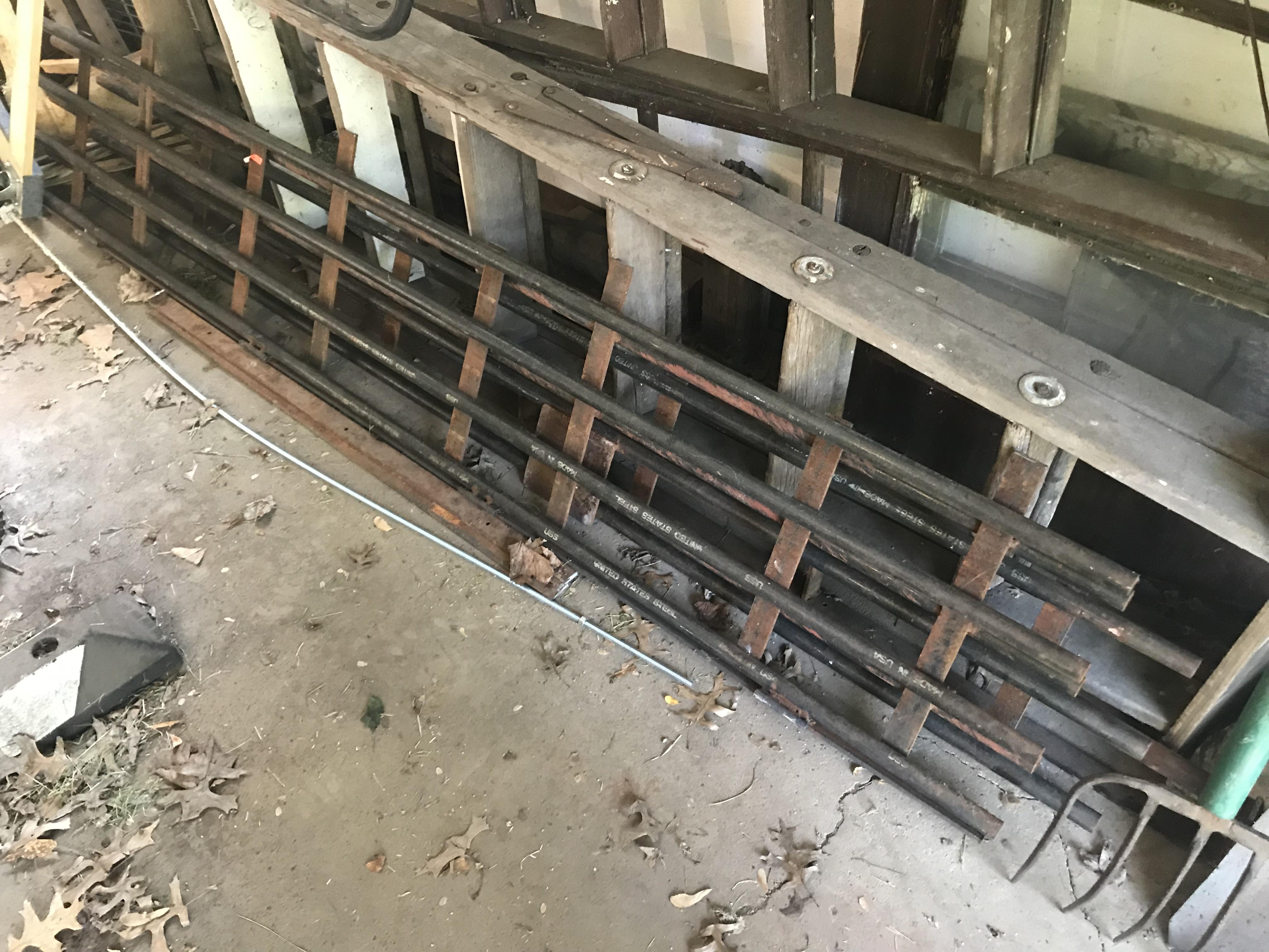

Well, I could always weld something up from my large supply of 1” schedule 40 pipe….
(Formerly a cell door in the set for the College’s production of Dialogues of the Carmelites.)
