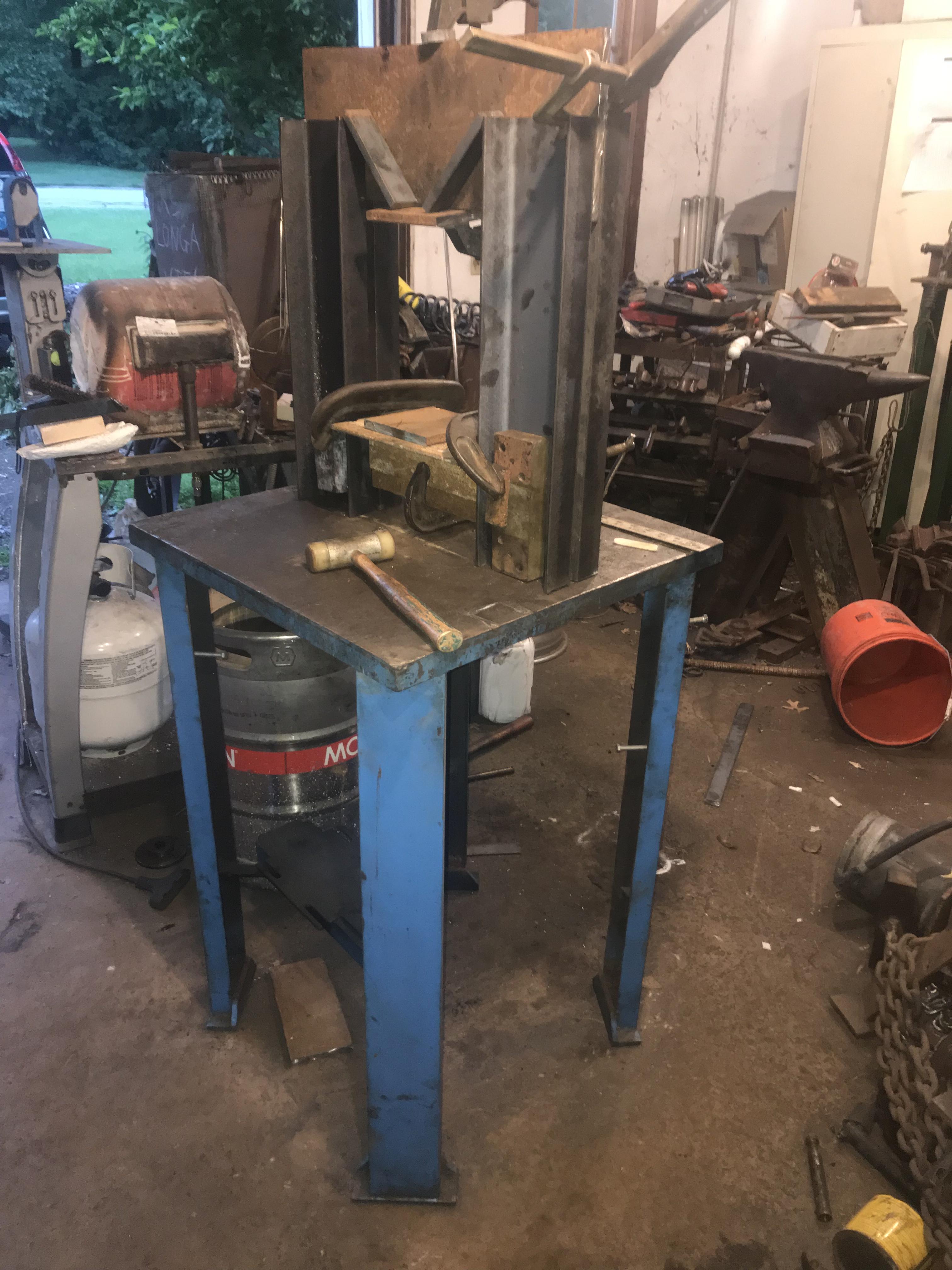

In other news, I got most of the pieces cut out and mocked up:
As long as the bow in the table doesn't throw the posts off it's all good.
The mock up looks pretty good. Do you have enough to run the diagonal stiffeners higher? They'll be okay but higher is better.

5 hours ago, Frosty said:
As long as the bow in the table doesn't throw the posts off it's all good. .
Unfortunately, it does: it drops a fat 1/32” over the width of each post, which means each post leans outward about 5/32”. Added together, that means the tops are about 5/16” farther apart at the top than they are at the bottom.
I’ll double check the squareness of the post bottoms and see if there’s any arrangement that makes them all stand straighter relative to each other.

Better to trim your verticals to suit, rather than trying to level 2 small areas for them, the working distortion between the risers is minimal, and will have near nil effect on your pressings I feel, keep it simple I'd suggest and not overthink it. [ it's nice to say that 'cos I overthink stuff all the time] lol.
Thinking about it a bit more JHCC, I don't think I'D bother trimming them 1/32" over that distance, just do a normal weld prep, and may be a little less on the on the web and outside flanges  as it gets higher, and just run your fillet weld , major loading is going to be on the inside flanges anyway, and a sound weld there will make all the rest insurance anyway
The bottoms of the posts are already ground really clean and square, so I wasn't planning on touching those. I do need to prep the tabletop, though, so I can go a bit deeper on the inner part of that cleanup.
It occurs to me that if I clamp the pieces together really, really solidly, that will give me a good reference for how much (if any) needs to be removed from the table and where.
