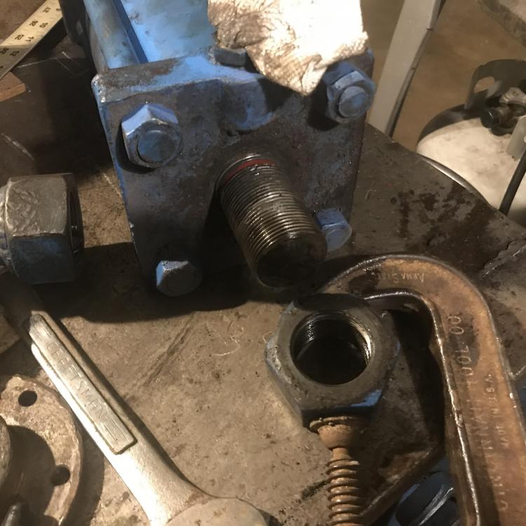

The nut won't unscrew? ooh, that's stinky.
Success! (And an object lesson in what to do when you don’t have a sufficiently large wrench.)

Do you have something to match the threads on the shaft or maybe modify what's there. Does the shaft have wrench flats? That makes life so much easier, I have a strap wrench that's sometimes enough, might've worked on that 1.5" is pretty small though.
The pulling extension is welded onto the end of a nut, so I just screwed that all the way down onto the end of the shaft and twisted against that. It was tough going to start, but then I realized that there was some paint residue on the threads. Once I got that cleaned off with a wire brush, everything came right apart.
I’m thinking that I can cut that nut off the extension and weld it onto the underside of the movable die, using the other one as a lock nut.

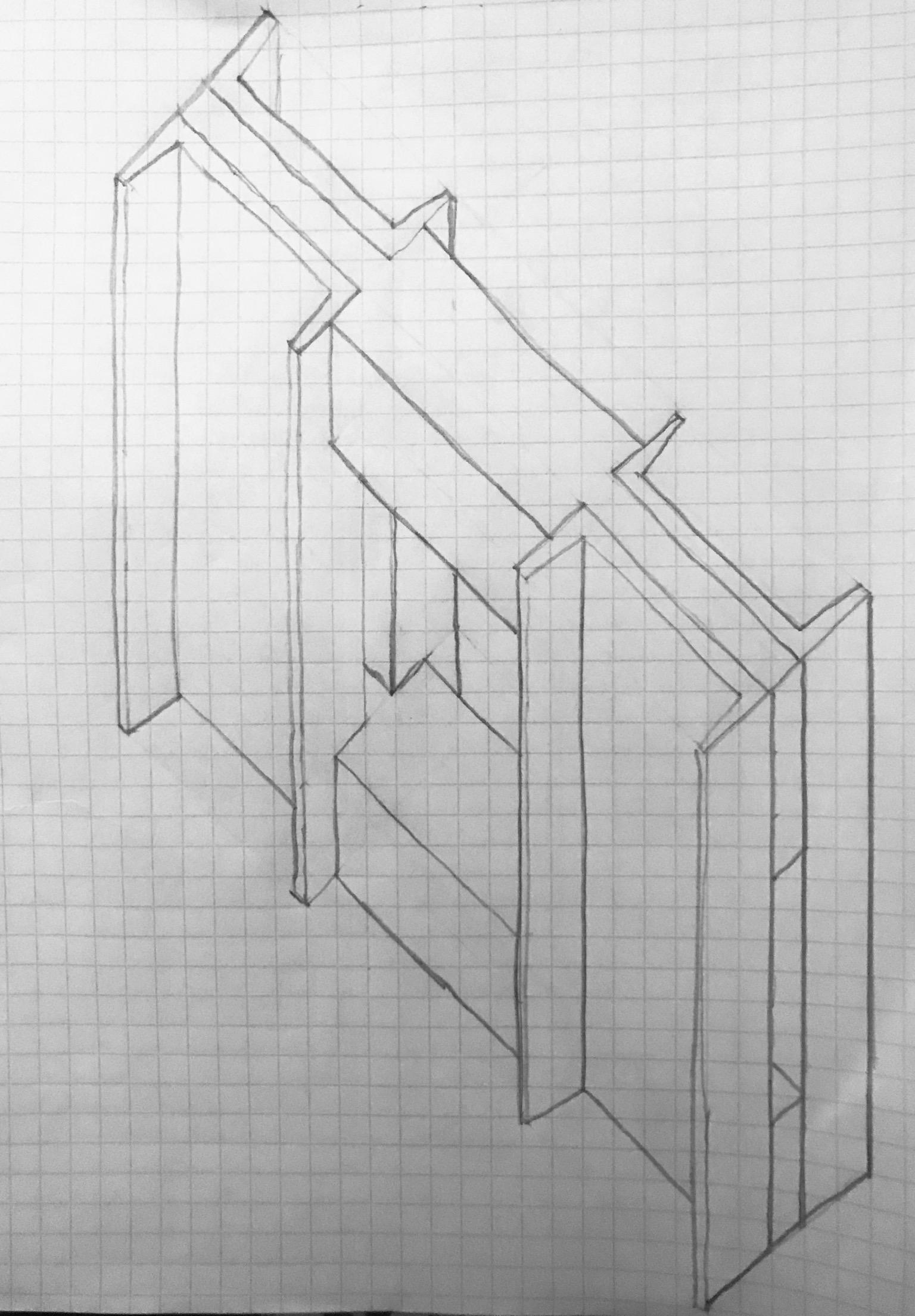

Getting back to design questions....
So, the options for construction of the bridge and the moving part are (1) weld a bar on edge between the verticals, which means that there will be an internal guide:
And (2) weld the verticals together and have external guides that wrap around the flanges of the C-channel:
Thoughts?
(Note: drawings not exactly to scale.)
