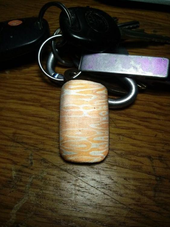

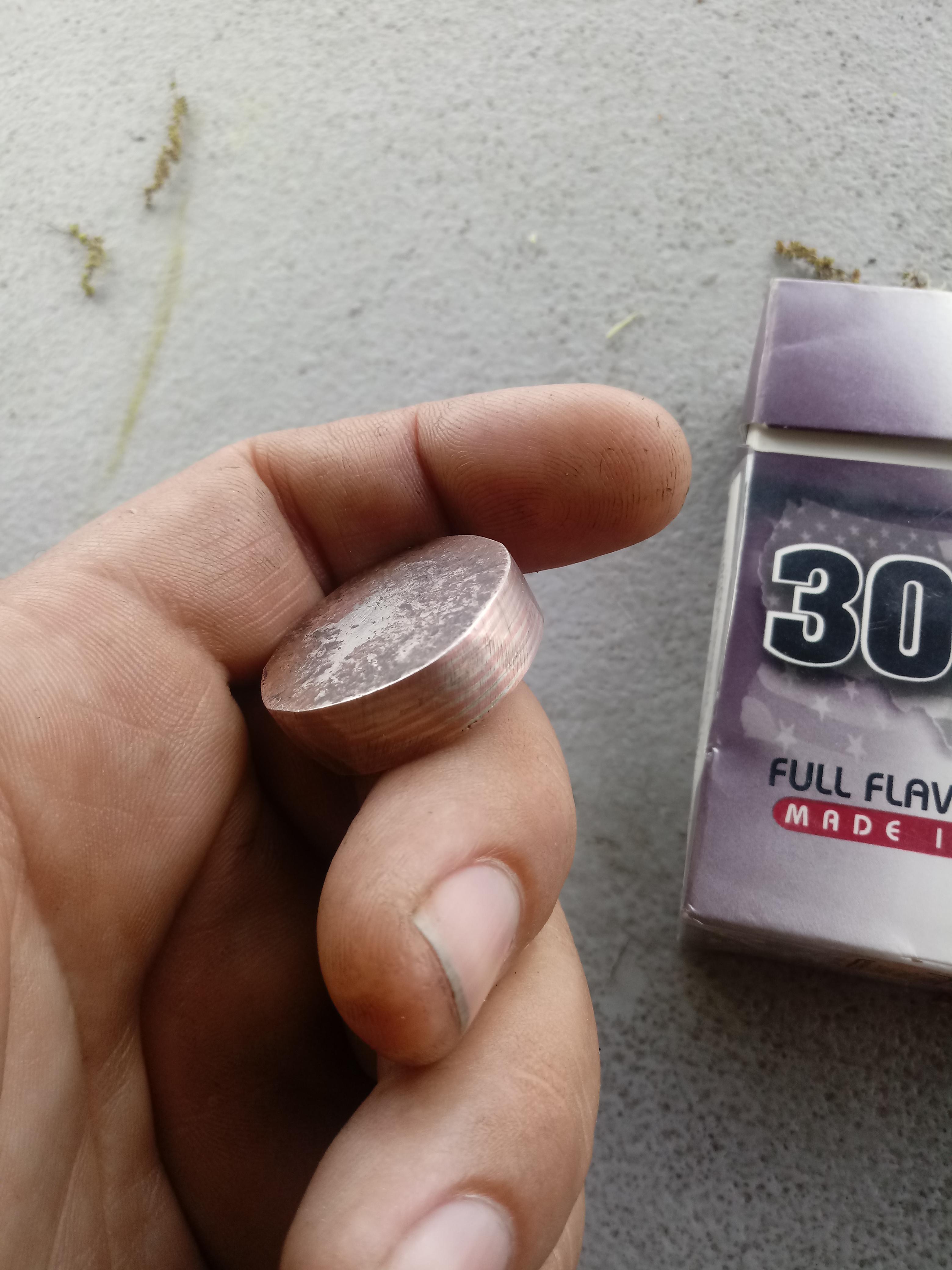

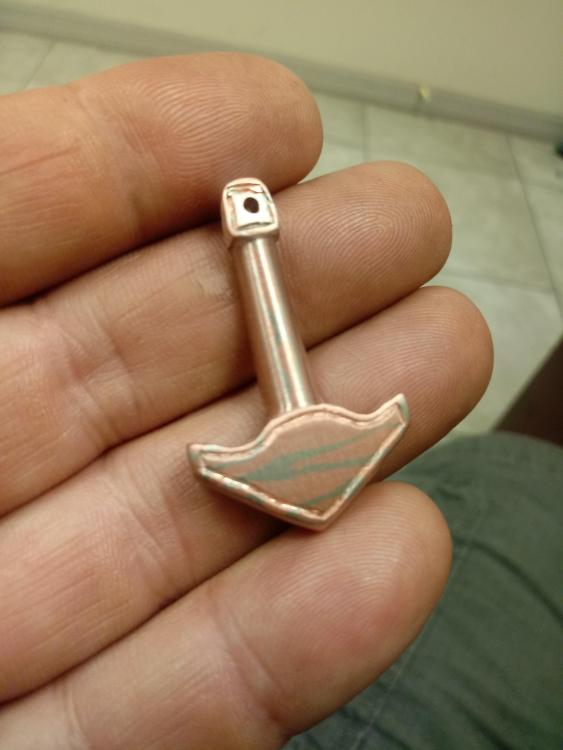

I'm very new to smithing in general but quarter mokume sounded relatively easy so into my little micro forge a stack of 8 went. surface prep was a scrub with steel wool and an acetone bath, I did't use any kind of press just pulled the stack out with a pair of needle noses when they started to sweat and gave them a couple light whacks. The first heat the top and bottom quarters didn't stick so just did a couple reheats until everything was nice and fused. then ground the edges and just stared at the billet for a few days contemplating where I wanted to go from there. thought of restacking a couple times to bring the layer count up but dropped that idea and just shaped it up and ladder patterned it at 24 layers. should make a nice pendant.

You didn't make a clamp? Two pieces of reasonably heavy plate, 1/4" is minimum but don't get carried away. Drill 4 matching holes that bracket a stack of quarters in each plate.
You clean and clamp the stack tightly and heat it all in the forge. The copper, nickle of the billet expands more than the steel bolts so pressure rises exponentially.
I have a piece of steel I lay on my anvil thicker than the bolt heads and fits between them. I have a longer section of the same bar I can use like a punch from above. When the billet reaches sweating heat and soaked a few minutes I lay it on the bar and strike it from above with the other using a heavy hammer and moderately slow dead blows.
By dead blow I want the hammer to just stop, bouncing can shear layers so heavy slow is more effective than sharp blows.

I vote etch. I think verdigris has it's place, but not on jewelry. Etch, then clear coat.
I'd etch and then let it patinate naturally if it will be worn against skin.
That's what i was thinking too. What would be the best way, ferric chloride?
Of those: Ferric Chloride is probably the safest---but it will eat a wedding ring; as will Agua Regia---which will also eat skin...Nitric acid tends to get you put on various lists here in the USA and HCL is probably the easiest to source---look at brick cleaners that list muriatic acid as their ingredient at big box stores . (a less pure form of HCL)  Steve didn't list H2SO4, Sulfuric acid, AKA battery acid found at Auto Parts places.

Well i already have muriatic acid on hand and im not squeamish about chemicals whatsoever so do I dilute it or use it straight? And any reccomendations on time?
Muriatic acid is an alternate for hydrochloric acid,  (HCl)   (the plumber and other people still use the term muriatic acid). It is about a thirty percent solution of HCl and water.
It should be diluted for most purposes.
BUT, always add acid to water and not the other way around. Small amounts at a time.
Adding water into acid will cause the solution to spit up. Which could cause blindness or ruin your handsome good looks.
Just sayyin',
SLAG.
If the metals you are etching etch pretty much at the same rate---use a weak solution and more time to get as much differentiation as possible.
If the metals you are etching etch pretty differently you can use a stronger solution and less time---yes this is a see what works best for you situation.
