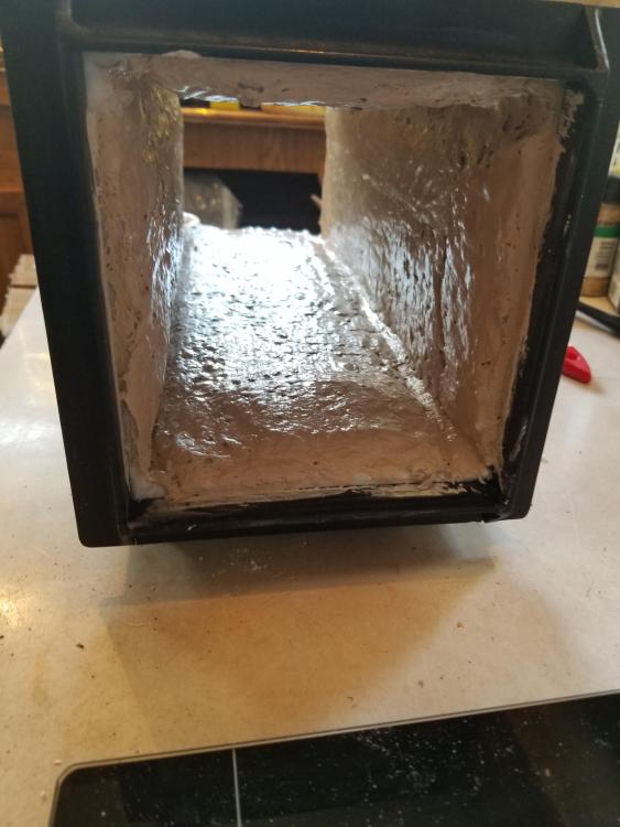

Eventlessbox Posted March 14, 2019 Share Posted March 14, 2019 After a few recent threads it was suggested that those of us that went the commercially manufactured forge route share our experience. Item one, and this is huge, unless you spend the big money for a manufactured forge, They are not plug and play. When your forge arrives there are steps to take and for a good experience products to buy before your forge is useable. The forges 101 thread covers this extensively. Devil forge now comes with a ridgidizer, which appears to be a very fine paint on clay. This is the step I just completed. After this step I will still be applying a layer of Kast-o-lite. And then most likely a layer of IR re-radiating coating. So while the forge arrived very quickly I expect to be weeks before actual usability. Link to comment Share on other sites More sharing options...

Andrew Collington Posted March 22, 2019 Share Posted March 22, 2019 I am considering getting a 2-burner Devil's Forge with a door (the DFPROF2+1D) and came on here to ask if the refactory clay they supply is enough or not (especially after reading the https://www.iforgeiron.com/topic/53239-ceramic-wool-insulation-safety-alert/ post!). I had seen one video of its application (https://www.youtube.com/watch?v=xNOywSx01pM) but have no idea generally how thick the clay liner should be - I just assumed it should be enough not to allow the fibres to break loose. So anyway, it was good to see this thread because it looks like someone else has figured it all out :-D So please let us know how it goes! Link to comment Share on other sites More sharing options...
Eventlessbox Posted March 22, 2019 Author Share Posted March 22, 2019 Andrew, Welcome. I'm hoping to apply the Kast-o-lite tommorow and will post those pictures then. The clay supplied is quite thin and not really very penetrating. It also has already started to crack just as it dries. After application my impression is that while it may( and I enphisze may, there are small holes in the layer) contain the fibers, it would likely degrade very quickly. Does not at all seem durable. A few other recent members have posted about the round version and reported similar results. Link to comment Share on other sites More sharing options...
MCalvert Posted March 22, 2019 Share Posted March 22, 2019 Do you think the clay will be rigid enough to suspend the refractory while it sets up? If not, you may want to get some West 406 and spray the other side with it (suspended in water with food coloring). It will be a cheap fix I think. Link to comment Share on other sites More sharing options...
Mikey98118 Posted March 22, 2019 Share Posted March 22, 2019 It is seldom too late to fix a forge problem. rigidizer can be poured into ceramic blanket, even after a seal coat is applied, At worst, it can be poured in through a small hole at the top of a metal shell, and the excess gathered into a pan, as it pours out of a bottom hole. Take a deep breath, relax, and just do what you need to end up at your desired end point. Link to comment Share on other sites More sharing options...
Eventlessbox Posted March 22, 2019 Author Share Posted March 22, 2019 I'm hoping the kast-o-lite takes care of any issues. If not I'll deffinatly try a ridgidizer piur through. Link to comment Share on other sites More sharing options...
Eventlessbox Posted March 22, 2019 Author Share Posted March 22, 2019 Seems like the clay should support. I just wouldn't trust it solo. Andrew, that being said, for the price I am very happy with the quality of construction and am not too upset with buying some castable. I found a small bag from a local furnace repair shop. Although Wayne Coe( a member here) also sells small batches for a very reasonable price. Link to comment Share on other sites More sharing options...
Andrew Collington Posted March 23, 2019 Share Posted March 23, 2019 Good to know you're happy with the quality and thanks for posting those pictures. Yeah, there are some quite obvious gaps there... So you're just laying a base of the supplied clay (is it refactory clay or rigidiser? Is there a difference? Sorry - no idea about this stuff yet!) and then putting a much more complete layer of Kast-O-Lite over the top of it? Could one option be to remove the blanket entirely and replace it with fire bricks that are of an appropriate size? (The base ones supplied and then some on the side that effectively hold up ones across the top with holes drilled through them for the burners, of course.) Their DFPROFK series seem to use fire bricks rather than blanket, so I guess it's possible, but don't know if the internal construction of the forge you have is any different. Link to comment Share on other sites More sharing options...
Eventlessbox Posted March 23, 2019 Author Share Posted March 23, 2019 My first forge was a fire brick construction. It started degrading somewhat quickly. So I'm hoping to do better with what seems to be the preferred method of the group. My plan is to put a 1/4" layer of Kast-o-lite one the walls and ceiling and a 1/2" layer on the forge floor. Link to comment Share on other sites More sharing options...

MaxwellB Posted March 24, 2019 Share Posted March 24, 2019 Same one I've got. Works very well. Although I'm having issues with the second burner, seems like it's combusting a bit early at the lower psi. Also, when the tank gets icy and pressure drops, it seems that's the burner that suffers. Might have to rethink how they have the piping done for them, but that's down the line. I also threw on some refractory and an IR coating, fired up the forge today to forge the Fuglies. Seemed to hold it's heat longer, so the IR definitely helped. Might get me to the point where I can eventually forge weld without needing to do anything else. I'll check out the forge tomorrow or Monday after work and see if the IR needs any patching. Ended up using ITC 100 since some of the other stuff I was seeing couldn't be used over a refractory. Not sure how accurate that was, but I took the dive. Overall I'm happy. Should hopefully last me a decent amount of time. Link to comment Share on other sites More sharing options...
Eventlessbox Posted March 24, 2019 Author Share Posted March 24, 2019 Paul, Was already headed down that road. Unfortunately my local pottery supply shop is an hour and a half away and only carries a limited supply of shelfs all of which I'd need to cut down and which would still not be a great fit. Link to comment Share on other sites More sharing options...
Mikey98118 Posted March 24, 2019 Share Posted March 24, 2019 Kast-O-lite 30 is not as strong as high alumina kiln shelf, but is better insulation; it makes a good alternative, for about the same price if you buy from Wayne. Link to comment Share on other sites More sharing options...
paulgatx Posted March 24, 2019 Share Posted March 24, 2019 Eventlessbox, the alumina kiln shelf cuts very easily with a masonry blade and it sands very easily as well on your belt sander to shape-to-fit. And to be clear, I still put a thick floor of Kastolite down but then use the shelf to protect the Kastolite so that you don't have to repair it as often. Link to comment Share on other sites More sharing options...
