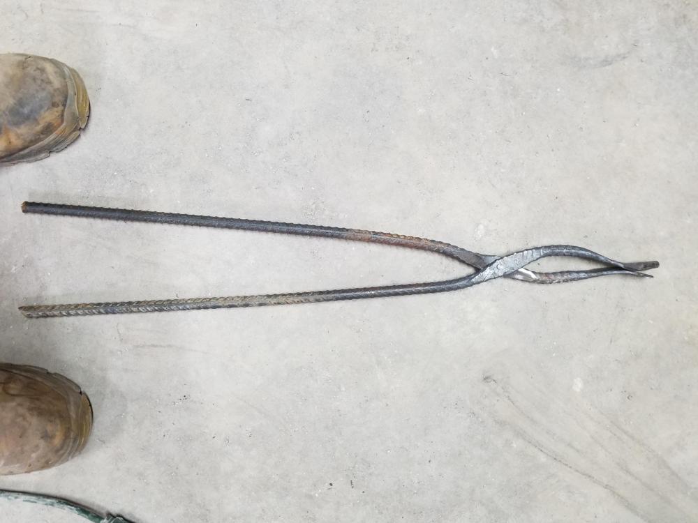

  4. I'm not quite sure what it is that's causing it to do that Mikey, you mentioned something about it being clogged up yesterday so I grabbed my torch tip cleaners and made sure it wasn't clogged up. I went through everything and made sure there wasn't any blockages anywhere else in the line. It's a full 20 bottle of propane so I don't think that could be it. Who knows, I'm sure I'm not doing something right. Maybe I will get a new regulator and see if that is the problem, it's the 1 that came with the burner so I'm sure it's a cheap one lol. On a good note though I was able to run the forge for 30 minutes playing around, I just made sure to adjust the choke when I would here it start to act up some. I managed to make me a horrible looking pair of tongs out of some rebar but at least I made something and got to use the forge for the first time so that makes me happy...
