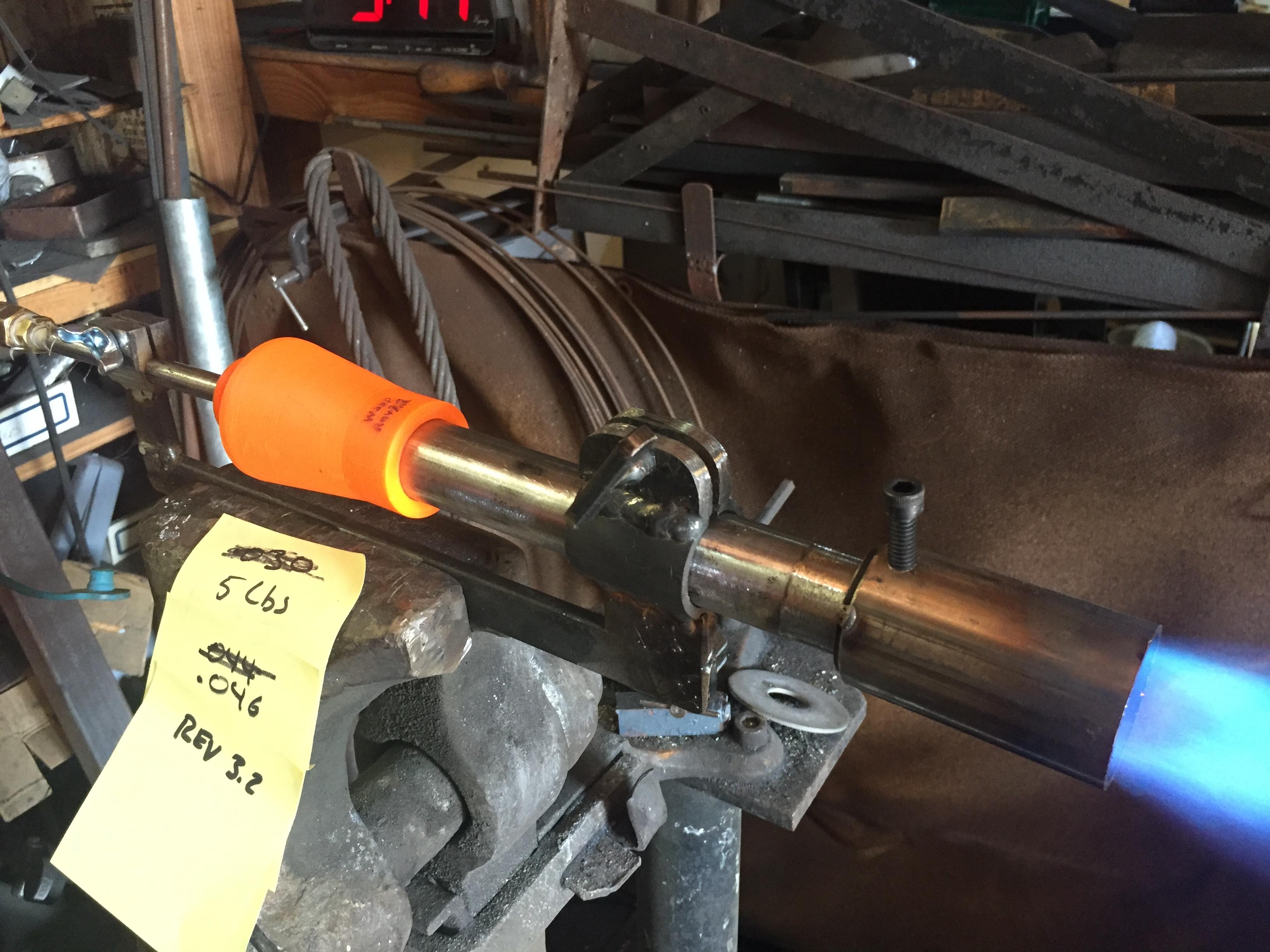

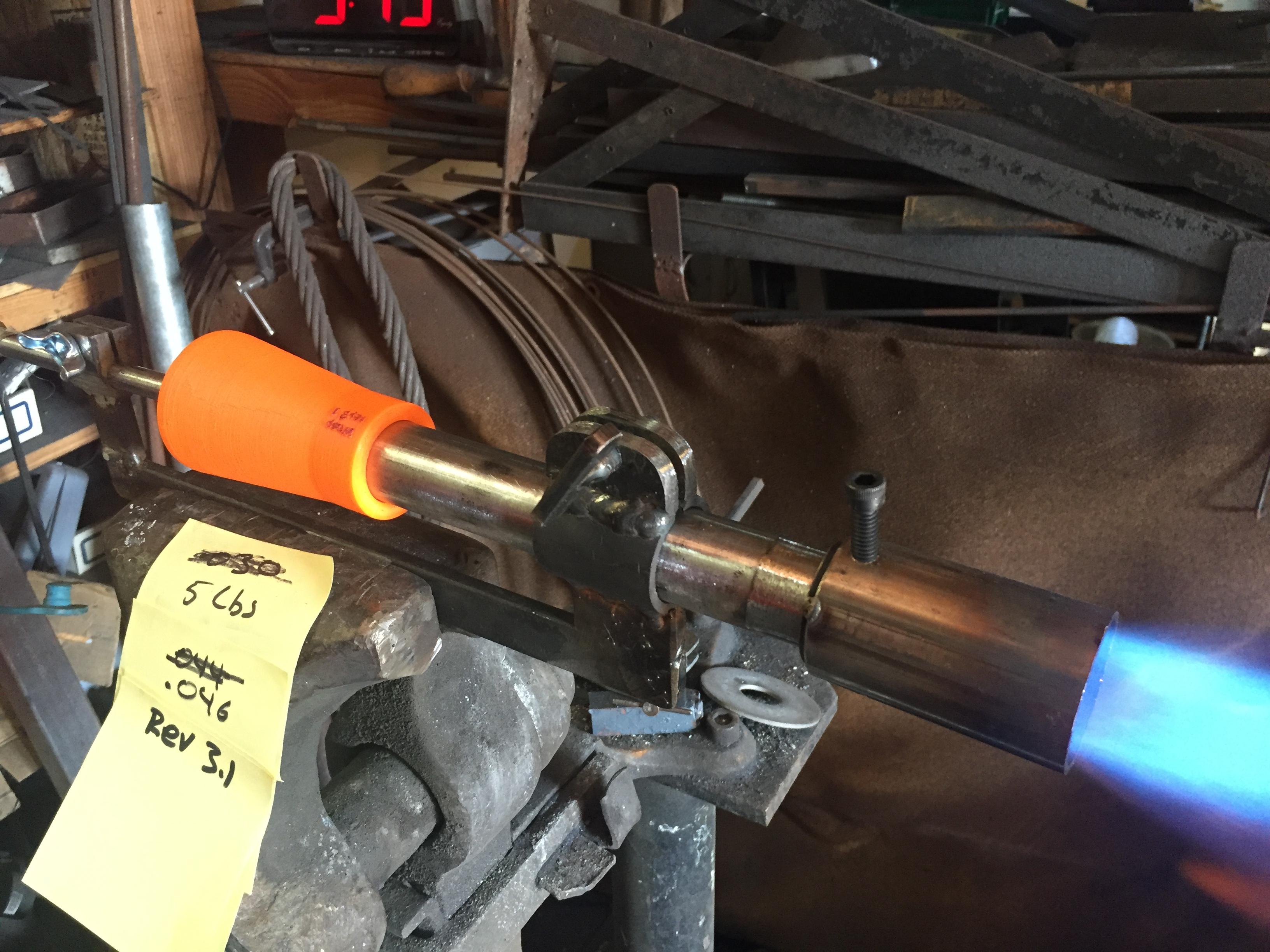

Well, here's the latest iterations. Those below plus rev3.1 with AFB's Fancy Intake.  If you can't read the plans below; from left to right rev 3.1, 3.2, 3.3. second row: original 2 degree wasp, rev3.4 (it is mis-marked 3.3).  I made one change from the original 2degree wasp injector and that was to change the intake funnel from a spline made funnel to a simple arc with diameter of 1.25".  This did work better then the original, it pulled more air.
On most of these I would have liked to go with a slightly larger mig tip.  The next size up I had was .052, and that gave a rich green flame.  I think just a thousandth or two larger would do the trick.
Here's pics of all the burns.  Same .046 mig tip @5lbs.  I tuned them by choking them til the flame turned slightly green, then pulling back til the green was gone - aiming at a neutral.  I used a tripod so the camera was the same distance from each flame.  I also set exposure to the flame as it seemed more accurate to what I was seeing.  Conclusions on bottom, but most of these worked easily.

Rev3.1 vs rev3.1s (with spiral intake).  I really noticed little difference.  There didn't seem to be much swirl.  3.1s seemed a little more stable, but when I pulled the choke back to allow for more air it didn't go as lean as rev3.1.
Rev3.1 was pretty awesome, I need to try it with a slightly larger mig tip.
Rev3.2 and 3.3 have progressively shorter tubes after the intake hole, and larger intakes.  I didn't notice much difference, but I'll have to play around with some mig tips slightly bigger to see if they tune in.  I need to buy some # drills.
Rev3.4 was a surprise.  I just experimented and ignored the 2 degree slope.  Instead I made a spline curve.  The intake hole is bigger then 3.1 but smaller then the other two.  It had a flame that was very good looking, no inner cone at all. It is small and would be easy to cast.  The flame was smaller then the other injectors but went from lean to rich easily.  It bears more work.
