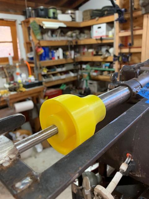

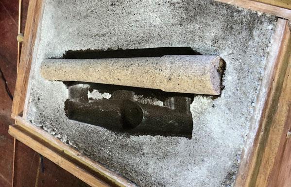

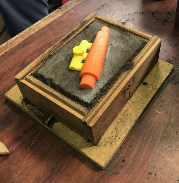

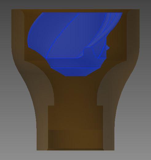

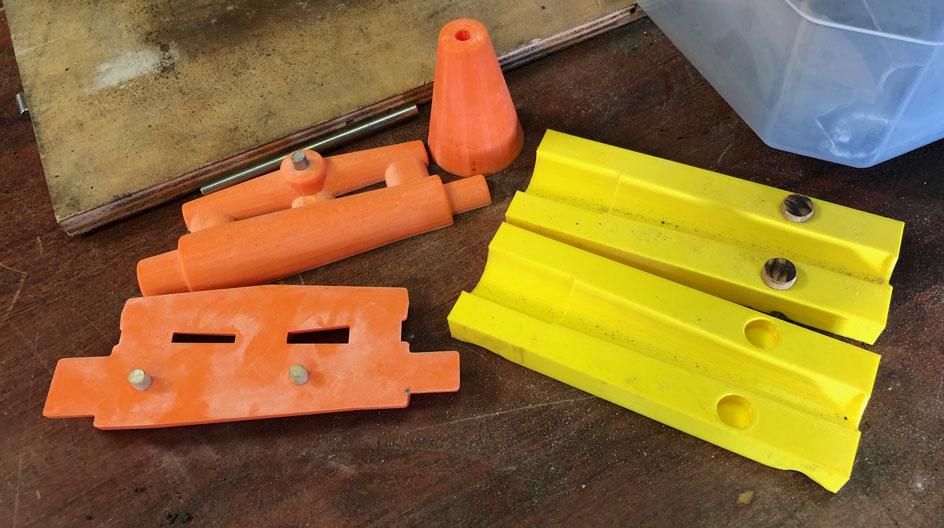

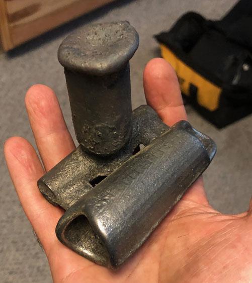

Another FrankenBurner Posted September 4, 2019 Author Share Posted September 4, 2019 I am after a tapered iron mix tube. I designed it in CAD and then 3D printed a pattern and core mold. We also 3D printed the runner and gates. This cast failed. If you click on the image to see it's full resolution, you can make out the 3D print lines in the surface finish. We decided to make the runner longer, the gates larger, and the sprue tapered. We CAD it up and printed again. 3D printing and sand casting are a good combination. The pattern was easy to produce, splits, and has pins for alignment. The sprue has it's own alignment pin, it's tapered shape makes it easy to remove from the cope, and the taper gives us a larger target when pouring. The core mold produces a core which fits the pattern void and has exactly the taper I am after. This cast also failed. We suspect the failure was pouring too soon. Gray cast iron pouring temperature is several hundred degrees above it's melting temperature and we think we didn't give it enough time to heat far enough beyond the melted point. We will be patient on the next attempt. If that fails still, we may have to bring up the wall thickness. If you are looking to learn sand casting, I highly recommend Dan's website. I learned a lot from it. I also peppered him with questions which he happily answered. While the failures are disappointing, we are enjoying playing in the sand and pouring iron. Link to comment Share on other sites More sharing options...
D.Rotblatt Posted September 4, 2019 Share Posted September 4, 2019 11 hours ago, Another FrankenBurner said: We suspect the failure was pouring too soon. Gray cast iron pouring temperature is several hundred degrees above it's melting temperature and we think we didn't give it enough time to heat far enough beyond the melted point. That looks right from the first image of the failed cast - I've had the exact same results with failed casts on bronze that's too thin or the metal too cool. The differential in the temperature from the molten metal to the mold material is 2500 degrees - the heat gets pulled out of it fast. With bronze pouring temp is a couple hundred degrees over melting temp too, I allow 5 minutes time to heat after melting (unless I'm impatient...). You might need more with iron because it's pouring temp is closer to the temp of the forge. Seems it's the opposite of aluminum, which has problems if it gets too hot. With Bronze it doesn't matter if its a little extra hot, you'll have to see with iron. Head pressure will also push the iron into the mold, but your pouring sprue looks plenty large and high, so I don't think that's the problem. With good sand casts you can see finger prints - it's gets surprisingly fine detail as long as the sand can release well. I'm impressed that you're pouring iron! Never did that, but you are making it look easy. I also like your use of tongue and groove to make the box alignment - good thinking! DanR Link to comment Share on other sites More sharing options...

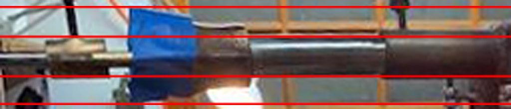

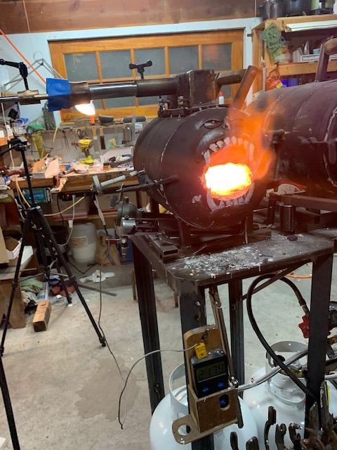

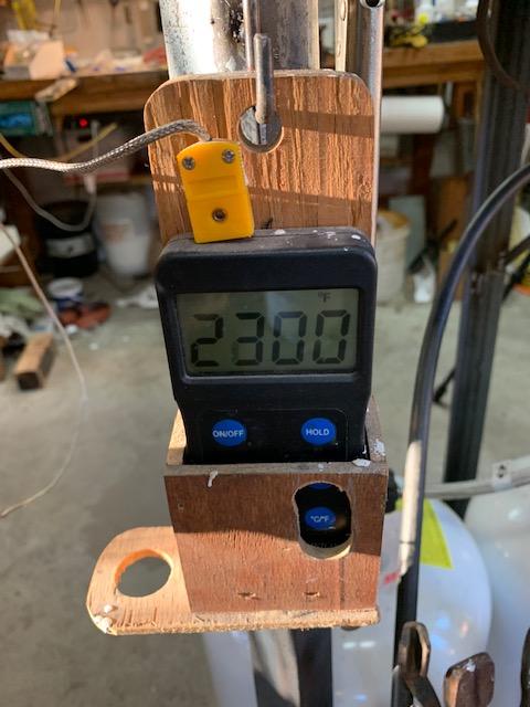

D.Rotblatt Posted September 5, 2019 Share Posted September 5, 2019 TINKERING UPDATE: Great success today! I tried two ideas we had talked about, and both helped. I got the bronze burner up to 2290F. The Reil went up to 2230F. The cast burner also ran well with a .046 mig tip. Here's what I did: On 8/30/2019 at 9:13 PM, Another FrankenBurner said: With the Bordeaux modification, you have got some straight pipe before the convergent section. I wonder if this is helpful to the Reil burner performance. I simply ran some tape around the bronze burner to make a lip. One width of tape didn't do much, but two did (standard sized blue tape). It was rough, but the sound changed and the flame became more lean. I had a small choke plate, and i put it on. Mikey, the sweet spot for this was with the choke plate about 1/2-3/4" back from fully closed. If I moved it back or forward it didn't seem to change the quality of the flame much, but the temperature went down. Might be a mixing thing. It occurs to me that if I am putting a tube on the back of the burner, I can put fins on the choke plate that extent to the edge of the tube (i.e. the choke plate is about 1" diameter, while the tube is 2" diameter). On 9/1/2019 at 9:20 PM, Another FrankenBurner said: as the length of channel is increased, beginning with a sharp edge, the gas rate rapidly increases and reaches a maximum at a certain length of channel and then gradually decreases. I also tried shortening the MIg top to about .3". This was also very effective. With a long .046 mig tip, I got a very rich flame. With the shorter tip the flame became much hotter and leaner. Off to bed! Was a good day. Now to play with some new designs that add a 'Lip' before the reducer. Several ideas come to mind.... DanR Link to comment Share on other sites More sharing options...
Another FrankenBurner Posted September 6, 2019 Author Share Posted September 6, 2019 On 9/4/2019 at 10:35 AM, D.Rotblatt said: I'm impressed that you're pouring iron! Never did that, but you are making it look easy. It's easy to make failing look easy but we are getting pretty good at it. I am glad to see the improvements in your flame. I will have to tinker with adding a section of straight before the reducer as well. I am also following the others down the 3D printer nozzle as an orifice rabbit hole. It looks like your tape may be tapered out. You may have increased the size of the reducer more than adding a section of straight. Link to comment Share on other sites More sharing options...
D.Rotblatt Posted September 6, 2019 Share Posted September 6, 2019 1 hour ago, Another FrankenBurner said: It looks like your tape may be tapered out. You may have increased the size of the reducer more than adding a section of straight. Nah, it was proof of concept. I was changing tips over and over, and the tape just got crumpled. It started as a straight tube, and I imagine it will work better if it's not a crumpled mess. Even if it did increase the size, that would be a solution... I'm going to try this one next: Walls on the side 1" high with a choke that has either 0, 2, or 3 fins on it. They are all printing up now. Same trumpet shape as the cast burner. We'll see how that works. All of it is castable in sand (although fins are harder, but it's small, I should be able to unscrew it from the sand....). DanR Link to comment Share on other sites More sharing options...

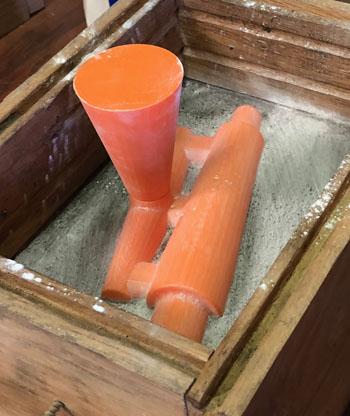

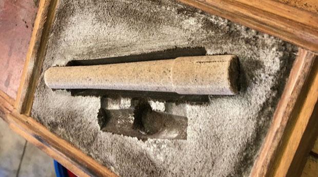

D.Rotblatt Posted September 6, 2019 Share Posted September 6, 2019 Just give it a few taps to loosen it and slide it out (at least that's the theory...). In the "old" days, one of the foundry tests was to sand cast a spoon, cup and saucer in one piece. http://schoepp.hylands.net/coffecup.html if you want to see how it's done, pretty impressive. DanR Link to comment Share on other sites More sharing options...

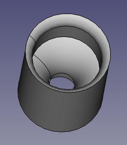

Another FrankenBurner Posted September 6, 2019 Author Share Posted September 6, 2019 Wow. I will not be attempting it any time soon. I just finished CAD on v74 which is v46 with a 1 inch straight section before the reducer. We'll see what happens. Link to comment Share on other sites More sharing options...
D.Rotblatt Posted September 6, 2019 Share Posted September 6, 2019 I'd love to see. The straight section after the intake fins? Your burner is so different that I'm not sure what it will do...will be interesting to see! Link to comment Share on other sites More sharing options...

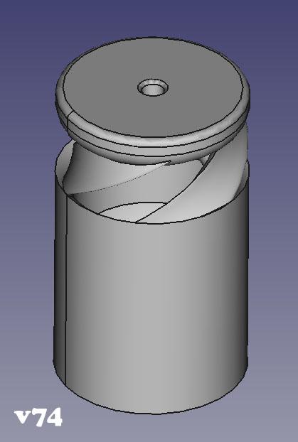

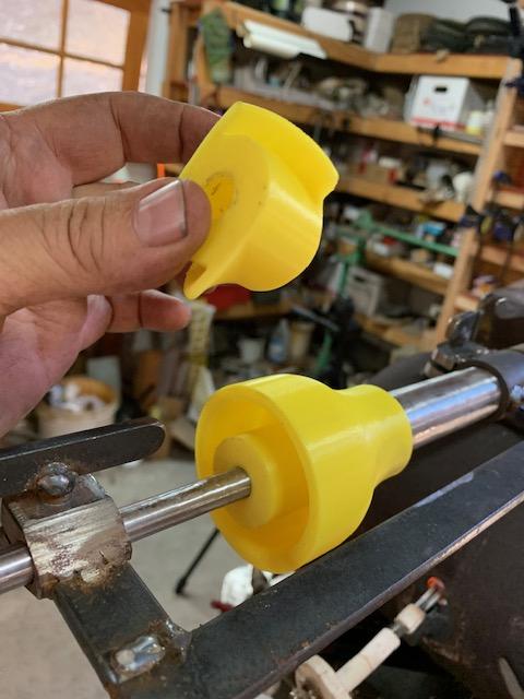

Another FrankenBurner Posted September 8, 2019 Author Share Posted September 8, 2019 Here is version 74. Straight section is after the intake fins. I have it printed but have not tested it yet. Link to comment Share on other sites More sharing options...
Another FrankenBurner Posted September 9, 2019 Author Share Posted September 9, 2019 I tested v74. It's flame is in the richer range and the secondary flame is fluffy. Not so good on this burner. Link to comment Share on other sites More sharing options...

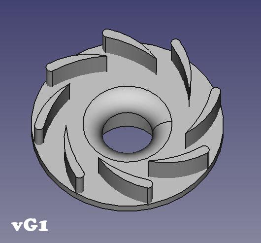

G-son Posted September 9, 2019 Share Posted September 9, 2019 Tried anything along these lines? Starting with many vanes at a large diameter, probably overlapping each other to really force the air to follow their angle - even if the space between each vane is small the large number should let plenty of air in, and at fairly low speed. It starts rotating rather slow out by the vanes, as it goes closer to the center it rotates faster, and once going down the funnel it might just be a lot faster than in the small diameter versions. Or it might not. Link to comment Share on other sites More sharing options...
Another FrankenBurner Posted September 9, 2019 Author Share Posted September 9, 2019 I expect it would have more rotation but at a cost of a air volume. You used the word force, "really force the air to follow." I have found that every time I think this way, I get less air. I now think with the word encourage instead of force. As stream line as possible with the smallest resistance needed to encourage the air. I have forced a bit more vortex than my current golden versions(v46) but it was so much that the flame started to shorten and spread. A tornado flame. I don't think that it was productive past a certain point and it cost me air volume. I think the vortex helps with the mixing more than air volume. I have a few versions of burners with less vortex which exceed the air induction of v46 but their flame color is not nearly as uniform in color and the flame is not as violent/turbulent sounding. The v46 flame has enough spin still in the stream that the flame is shorter, bushier, and louder. The other thing that probably works against your idea is the air induction does not behave the way we think it does. Instead of gracefully coming into one air inlet to meet the inside of the next vane, the air wants to pull straight from the outside to the center. The throat is at a lower pressure than ambient. Ambient pressure being higher, pushes air in. Imagine a vacuum cleaner drawing air down the tube. The air goes as straight to the low pressure zone as possible. The vanes being angled cause the air to go to one side easier than the other, path of least resistance. This gives angle to momentum which is the initial nudge to vortex but the vortex only has as much rotation as it has to. I see something more like the red than the yellow when playing with smoke. The other problem I see with this idea would be supporting the long flats while printing. I could use supports but then I wouldn't know how to get them out it. I could print in two pieces and glue them together. Of course, I could have it all wrong. Hopefully I do. I will give it a shot. It's a good test of my understanding of things. What OD were you thinking? Link to comment Share on other sites More sharing options...
G-son Posted September 9, 2019 Share Posted September 9, 2019 You have some interesting points. Would be very interesting to see an actual test. These vanes is more along the lines of what I was thinking, with overlap so the air must go diagonally between them - the large total area of the openings compared to the mixing tube should still mean there's little restriction to flow. Once it's moving that way, it's easier for it to keep rotating than to change direction straighter towards the center - or that's my theory anyway. I can't quite tell what OD would seem right, but say something like 2x funnel diameter to the inside of the vanes, and then let the vanes have as much size as they need at an angle that looks good and gives them enough overlap to direct the air around, preventing the air from going straight towards the center. In this picture it looks like 3x funnel diameter may be good for outside diameter, but better drawn in a more aerodynamic shape that might change a lot. Link to comment Share on other sites More sharing options...

D.Rotblatt Posted September 10, 2019 Share Posted September 10, 2019 23 minutes ago, Another FrankenBurner said: Not so good on this burner. Our two burners are different beasts. I ran another temperature test with my burners. Same jet assembly (except on the reil burner), and same 5 lb gas pressure exactly (used the ball valve to turn it off, same forge. Tried a quick test of my ribbon burner vs a straight single burner (the ribbon burner was far superior - a couple of hundred degrees). A summery of the results: -The new burner (3D printed with 1" lip), with a choke without fins was the best so far getting to 2300F. -Adding fins to the choke on the new burner decreased the temperature. -The Ribbon burner far exceeded the single nozzle burner with the same injector assembly (the bronze cast one) by 200F. _____________________________________________________ The results of the test are below. The set-up is 5lb pressure, .046 mig tip ( trimmed to about .25" long), Modified NA ribbon burner (the one with 1/8" holes described in the NA ribbon burner section). I used the same jet set-up (which is removable) and just swapped it out between the test rig for the new yellow burner, and the bronze cast burner. Each test was allowed to run until the temperature stabilized. Bronze cast burner - 2260 Yellow Burner with 3 fin choke - 2268F Yellow Burner with 2 fin choke - 2272F Yellow burner with choke (no fins showed below) - 2300 _____________________________________________________ This is the best test. New burner on test rig with plain (no fin) choke: ____________________________________________________________ I also ran the burners with the ribbon burner out of the forge. Larger flames on the Yellow Burner injector. I got pics and can post if you like. DanR Link to comment Share on other sites More sharing options...

D.Rotblatt Posted September 10, 2019 Share Posted September 10, 2019 14 hours ago, Another FrankenBurner said: I would love to get away from investment casting for the fun/easy/quicker sand casting. After making the last casting with a core, I’m thinking that a sand cast of your burner head is absolutely doable. The core is basically the funnel with fins, a brass tube to hold it on center. Doable.... DanR Link to comment Share on other sites More sharing options...
