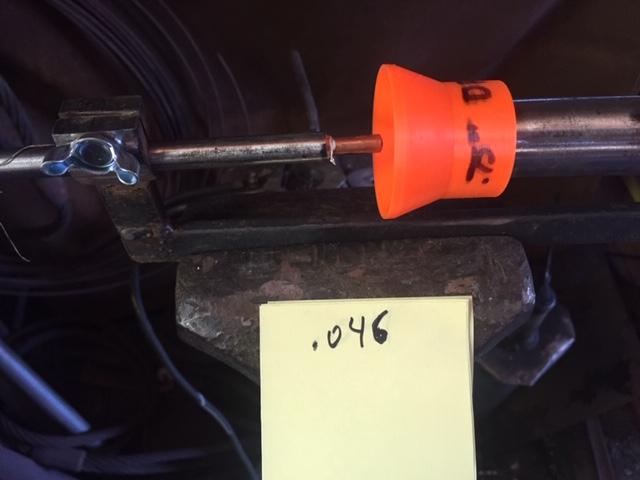

Continued experiments on printed injectors.  As I played with the designs, I found that the larger the opening the better it seemed to work.  Is the wasp waist even worthwhile?  So I ran a series of tests with the burners I had to see if I was going in the right direction - from no injector to a couple of my best.
Here's an overview of my thinking so far: there are 3 areas that area variables in the injector.
A)  I'll call this the intake.  This correlates to the bowl shaped part of the pipe reducer in the Reil Burner or other plumbing made burners.  The intake can be made in one of several shapes.  Either concave sides like a plumbing reducer, flat like the 1920 article pic below, or convex like in my burner.
a sample of my burner: 43718228_WaspBurnerDiagram.png.1fb687bfbb4e81d12e3d28ebee7947ab.png  Pics from a 1920 article:2090239882_Untitled2.jpg.51c49fd682488503d0af986c1f580598.jpg
b) The size of the opening, and C) the waist.  The waist can either be nonexistent (in which case the opening will terminate on the end of the pipe) or can taper like in a burner nozzle (or see both pics above).  A smaller opening then the size of the pipe will be required to allow the waist to taper.  It is a trade off.  If you want a lot of taper, or a long waist, you need to make the opening much smaller then the pipe. The idea of the waist is to create the bornouli effect and increase the speed of the gas, decrease the pressure in the opening and pull in more gas and hopefully mix the gas.
Here's the problem in real life, as I was playing with different sizes in the variables, I found that in order to make a waist or much of a taper, I had to make a smaller opening. All of the permutations had very good flames, but as the opening increased, more air was pulled in and I had to move up to larger and larger mig tip sizes, from .030 with a .5" opening, to a .048 jet with a .75 opening.  It appeared that the larger openings were more efficient.
I began to wonder if a waist was necessary at all.  So I tried a series starting with no injector at all and adding the variables one by one (if possible).  All were at 5 lbs psi on the gauge with the same jet size, I tried to position the jet around the same distance from the injector.  All the injectors work well from nearly 0 psi to 15 psi on the gauge.   I don't know what the yellow flames were.  Something burning or being blown through the burner.

1-No injector at all.  Just a jet in front of a pipe.  Actually a rather decent flame, considering.  Primary flame is feathery but a bit unstable.
IMG_7975.JPG.bc60f7fde04b7c178361334ebfcd1f8f.JPGIMG_7977.JPG.5fb46e31b65747afa7d6a8df94b58d23.JPG
___
2-I added my choke plate.  It didn't make much difference, but it did allow me vary the fuel mixture if I wanted by moving the jet forward or back.
IMG_7978.JPG.a1fe430016f9c03236c8c157ec5a9c54.JPGIMG_7980.JPG.32242ce6515d4a93af2529a0cfe472a6.JPG
___
3- This injector is an early one.  It has no waist, and a .84" opening (the ID of the 3/4" pipe) and convex sides (much like my picture above).  The .75" marking refers to the length of the intake.  If you compare it to pic #1 you can see it created a larger and much more stable flame.
IMG_7981.JPG.7a4749860ea69a96dc4a1b6a98b353d9.JPGIMG_7984.JPG.f759e4b40d9d5f1eb5cdb7a7f4d8740e.JPG
___
4-Here I added the choke.  This produced an even bigger and smoother flame.  I seems the combination of the two focuses the air even better then the intake alone.  The flame went a bit lean here, so a larger jet size would be possible.  Maybe .048".
IMG_7985.JPG.a3f7992c4586674f32501cc71e289692.JPGIMG_7987.JPG.44eedf049352cf7b8bbe51f7c24c5b09.JPG
___
5- in this test I used the best of my wasp injectors.  The flame is a bit smaller, and a bit rich, but the opening is only .69".  This burner works best with a .042 jet rather then the .046 jet I have on it.  The smaller flame is due to the smaller opening.
IMG_7988.JPG.95c6f566e5a1bec635eb797366e95bb7.JPGIMG_7990.JPG.38c08c995c247c97055750702cd23d86.JPG
___
6- Not a good comparison, but this is similar to the burner above, but with a spiral intake, .5" opening and 1" long waist.  Because of the smaller opening (and the spirals which also restrict air intake), this burner uses a .030 jet size.  I found the spiral intake produced a fine flame, but not at low pressures where the spiral motion of the gas down the pipe caused the flame wobble and to be more unstable.  It would probably work fine inside a forge.
IMG_7950.JPG.a9b3f240f3d8979670da4dceb37d5092.JPGIMG_7954.JPG.c223f4d0822858279f9d2fac832e3075.JPG
_________________________________
CONCLUSIONS:
1: To my relief, the injectors are increasing the intake of air significantly.  The shape of the intake may be important (the next variable to play with).
2: The choke also added to efficiency a surprising amount and is a fortuitous discovery.  I don't know why, but this is good since I really like to be able to reduce the mixture of the gas.  The concave sides of the choke pretty much mirror the convex sides of the intake creating a kind of funnel for the air.
3: A waist, because it requires a smaller opening, decreases the volume of air being pulled in, thus creating a smaller flame.  The characteristic of the flame is, never the less, very good.  But the flame is not better then a similar injector with no waist and is thus, less efficient.
4: The spirals around the intake restrict air flow (I tried a few exact same burners with and without spirals and the ones with spirals required smaller jets) and cause instability at low pressures (under 1 lb PSI).  This is contrary to Another Frankenburners experiments, but my spirals may be different than his - I copied them from his pictures.  Further, I have a moveable choke while he doesn't.
***A burner like the one pictured in pic #4 had the largest flame at the same psi and jet size.  It would also be very easy to sand cast (which is one of my requirements for this experiment).  The larger the opening, the more air the burner can pull in, the larger the jet size required, the more efficient the burner.  Thus a burner with the largest opening is ideal.
***The moveable choke/jet design allows both for adjustment of the mixture and for ease in casting.  The burner and choke can be cast in two pieces.  This would have worked even with the spiral style of burner, but I don't think I'll be moving in that direction.

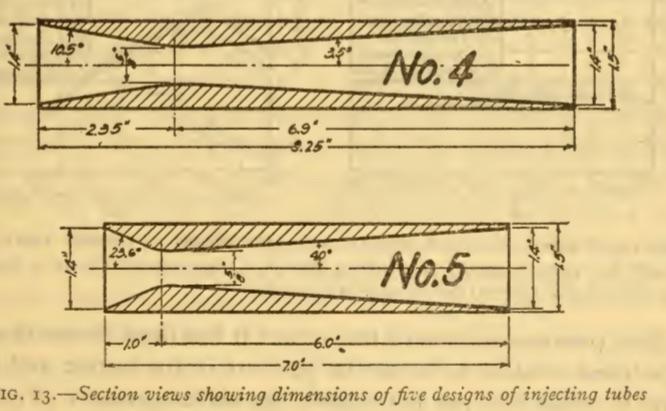

Have you considered ditching the straight mixing tube, and follow the 1920s design more? The expanding cone seems to BE the mixing tube in that design. A shallower angle may be in order to keep the flame from going back in there at low pressures, but that means a standard pipe mixing tube may be useable, a slight angle could be cut in it with a lathe.
I would, but one of the primary parameters is that the end result be easy to sand cast.  I have a CNC mill, but no lathe. There is also a limit to the length that I can print on my 3D printer.  I could fabricate a sheet metal cone to try it, but it would not be an easy build to replicate.  That was the idea in what I call the "Wasp" burners...those with a waist.  Some of the 1920 designs are shorter and my longest ones replicate these.  According to the 1920 stats on them, they are almost as efficient as their best ones which are longer.

Good evening all.
Been lurking for a while, so my first comment is - Frosty and Mikey, I already have. =D
Reading AFB's and DRottBlatt's discussion on the trumpet/bell reminded me of some older YouTube videos put out by a turbine engine repair mechanic. He explains why they install a bell mouth on the static test stand.
https://www.youtube.com/watch?v=3DQdcvzf9RM starts at 6:00
https://www.youtube.com/watch?v=eB3f_Idkiow starts at 7:45
Good luck gents,
Brinton
Thanks Brijasher!  Inlet air depression...got it!  Interesting explanation, Thanks!
