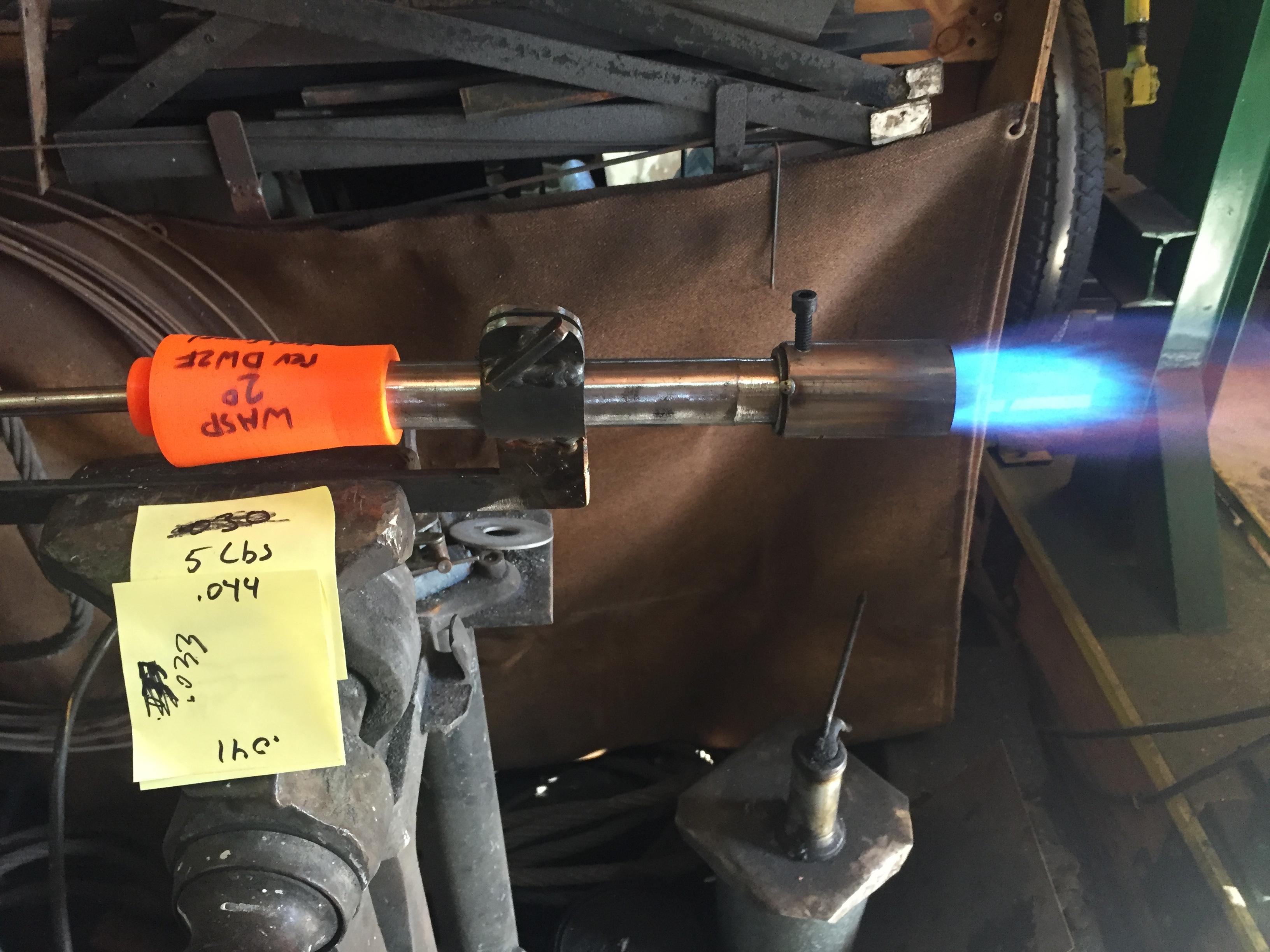

Update: Played around with some other burner designs, and looked at the last batch.
All injectors were tried on an 8" x 3/4" pipe either ending in a nozzle or attached to the NARB.
Correction on the last burner test:
Turns out the 2 degree wasp was looking bad because the flame was so lean, this burner really pulls air.  Moving up to a .041or .044 tip really made a difference, and it seemed better than the 4 degree wasp.  This wasp burner has the biggest intake hole at .685".  It definitely pulled the most draft.
New injectors:
I tried a longer burner at 2 degree slope.  Basically I elongated the 2 degree section of the 2 degree wasp with the same intake funnel.  Because it's twice as long, the intake hole is only .545" vs .685" diameter.  This was a very stable injector and showed easy adjustment with the choke.
On a single burner the 2 degree wasp performed the best. On the NARB I got good results with anything.  Seems it is a much more stable platform for the flames.  I ended up switching mig tips between .044, .041, .033, .030 until I got a neutral flame with maximum air allowed.  The largest flame I got at 5 lbs was 5/8" with the 2 degree Wasp injector/.044 mig tip.  The long 2 degree injector was happy with the .041 mig and had a 19/32" flame - a little smaller then the shorter 2 degree.
Conclusions (at present): the shorter 2 degree wasp seems to work best, while the longer 2 degree wasp was also very stable.  The shorter had a larger opening which allowed for more air and thus a larger mig tip and more BTU.  The wasp shape definitely pulls more air then a simple funnel.  A larger opening is better.  This opening is limited by the ID of the 3/4" tube (.84" or so).  Two questions come out of this: 1) is this the most efficient shape to maximize air flow, and 2) is there some way to cause a vortex, and would that help or hinder air flow - yes AFB, your spiral intake is genius, but I'm still wanting to see if this can be sand cast.
Next up: Play with some short designs that have large intakes and wasp bodies.
Short 2 degree Wasp injector @5 lbs, .044 mig tip:
___

Those are looking great Dan.  The outlet taper is fun to tinker with.  It dramatically changes induction.  I am printing another experiment today.
I know exactly what you mean about the outlet diameter limiting the inlet diameter, I am fighting with that as well.   The inlet diameter is the major dimension controlling throughput.  Just to state the obvious, as you increase mig tip size, if pressure and flame quality are constant, your fuel usage and output energy increase.  The difference in fuel usage between the 035 and the 044 will be quite noticeable.  In pipe burners, this would be comparable to stepping up a couple of sizes.
To clear something up, when you say 2°, are you meaning the angle to center line(red)?  (Not the included angle, yellow)
Thank you for the kind words.  I have tested with/without the fancy intake with the outlet taper and it is still doing great things.  About a single mig tip size difference.  I think it is all about causing a vortex.  There is probably a simpler way to accomplish this but I haven't thought of it.  I think streamline is key here, anything aggressive hinders flow.  Simpler would be better even if it didn't look as good.  :P
I am more than willing to abandon everything I have done to follow a better path if we find one.

Yes, the red dimension.  Seems I've been making all my tapers twice as wide as necessary for decades.  I always think of 1:12 on roofs and such, so when I first made tapered nozzles 20 years ago or so, I didn't use the included angle, just one side.  Probably explains way the flame pulled so far into the nozzle and burnt them up over time...sigh.

The wasp style was very stable at nearly 0 pressure. Low enough so the flame went lazy orange.  If true in a forge, that means I can just turn it down lower and it has a higher upper end!
