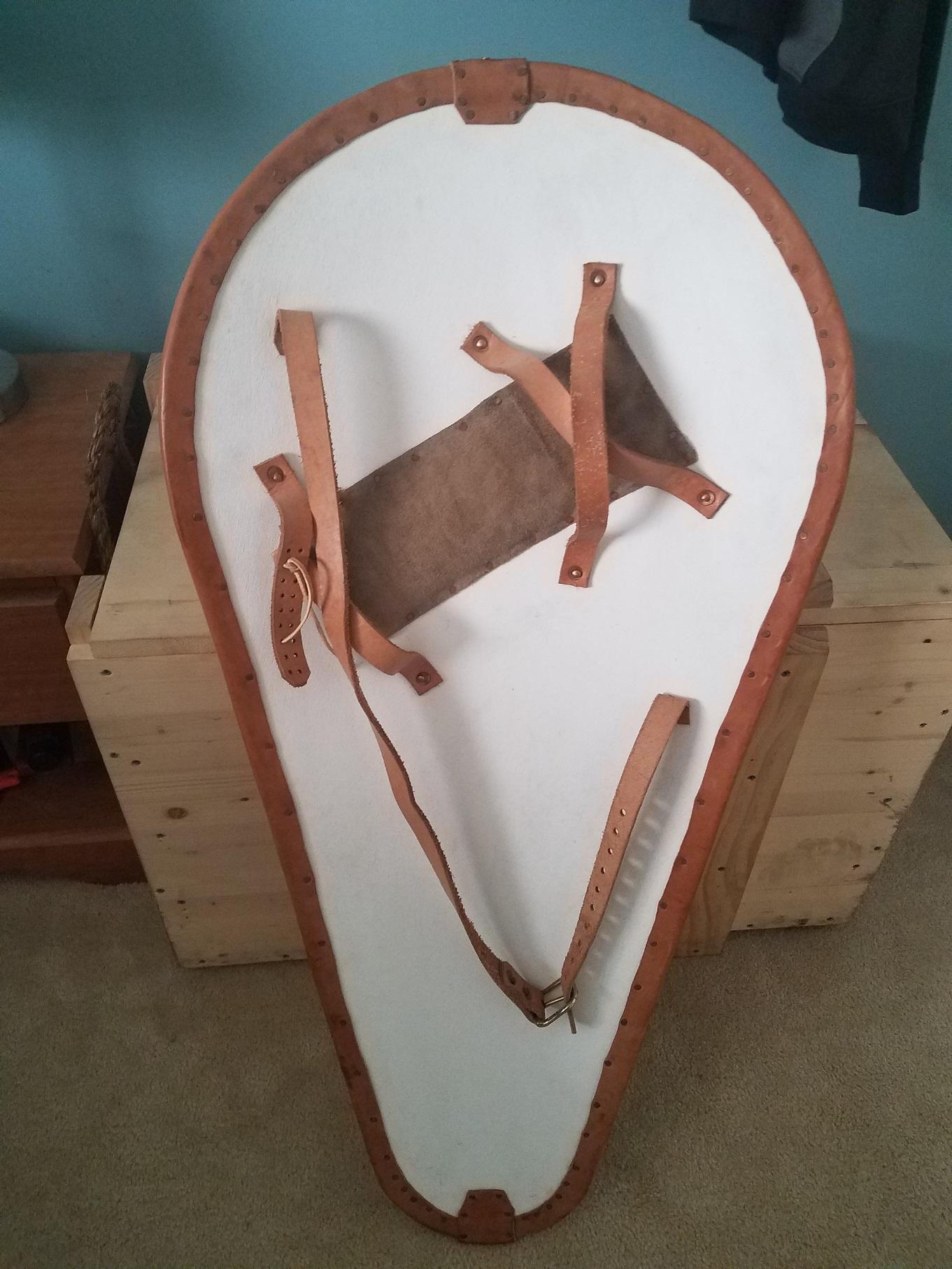

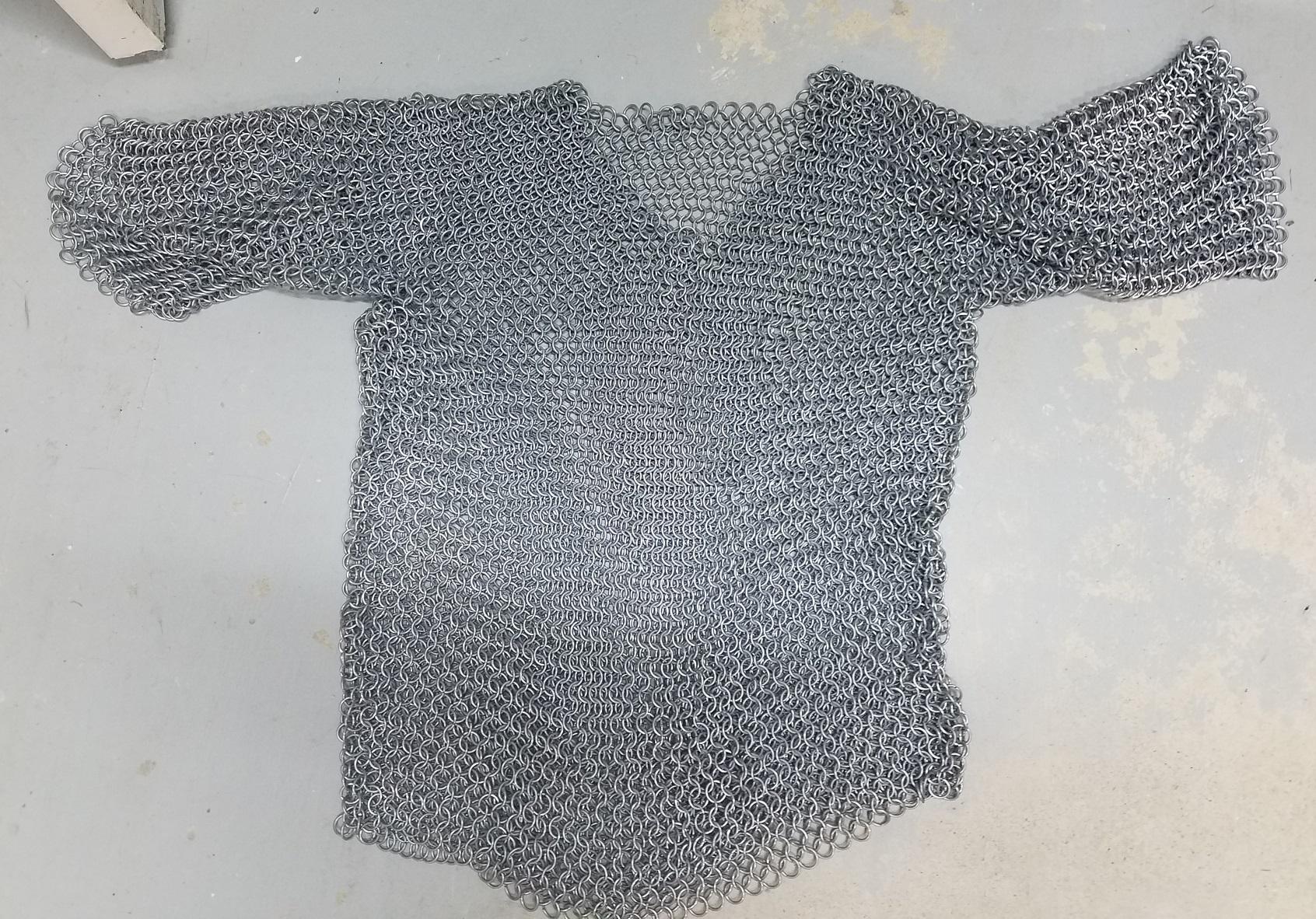

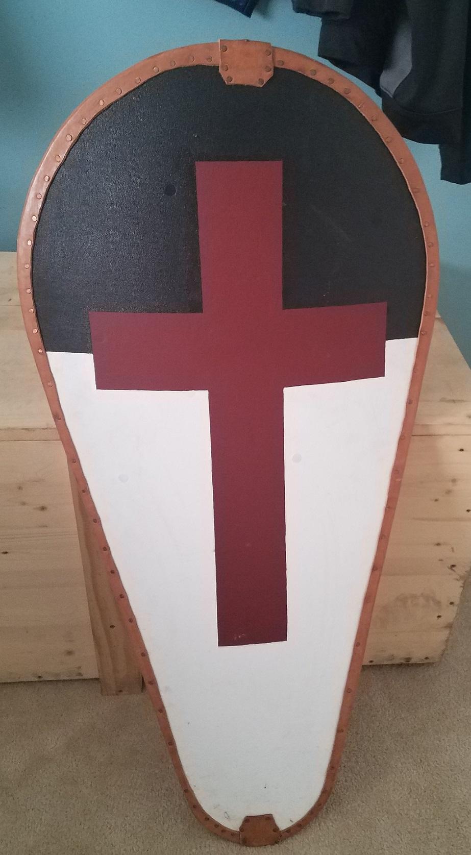

I can attest to this - time consuming!  I made a coat of mail for my son who wanted a Templars outfit.  I spent probably 40 to 50 hours researching the mail and shield.
I made the shield by bending three 1/8" sheets of plywood around a curved frame, covering in canvas, and trimming in leather.  At the same time made the mail by wrapping electric fence wire around a dowel and then cutting the "spring" of wire into links - making making several thousand of these.  I then spent probably 100 to 130 hours weaving these together to make the shirt - learning as I went and making mistakes along the way.  Part of this was to make him this costume and have him help me and part of it was to satisfy my curiosity about the historical background of the period.
As everyone has said, this was VERY time consuming and involved a lot of research.  It can be done but not quickly.  Plus when you think that some of the better chainmail had the links pinned (which I did not do) - it must have taken the original armours a lot more hours.
Ahhh "when you think that some of the better chainmail had the links pinned"  Sorry but that's pretty much all maille was riveted or a combination of riveted and solid links---punched or welded. Butted mail is basically a modern cheat, though a couple of battlefield repairs were done that way and IIRC there was a parade coat made of coloured butted links.

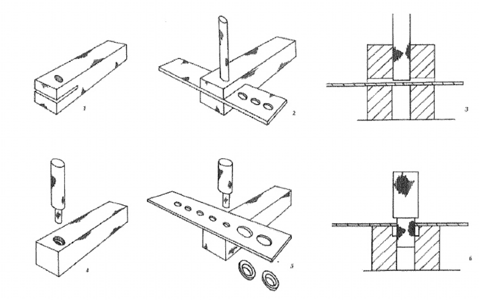

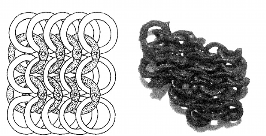

True - I was talking about some of the mail that combined both.  Considering this was for a kids costume - I wasn't going to go that far - one shirt with butted links was enough.  In the end my son loved the mail shirt and we got to spend time working together on the project.
The images are from the paper - The manufacture of a chain mail from the Iron Age found at Fluitenberg - including how they punched the links you mentioned.
