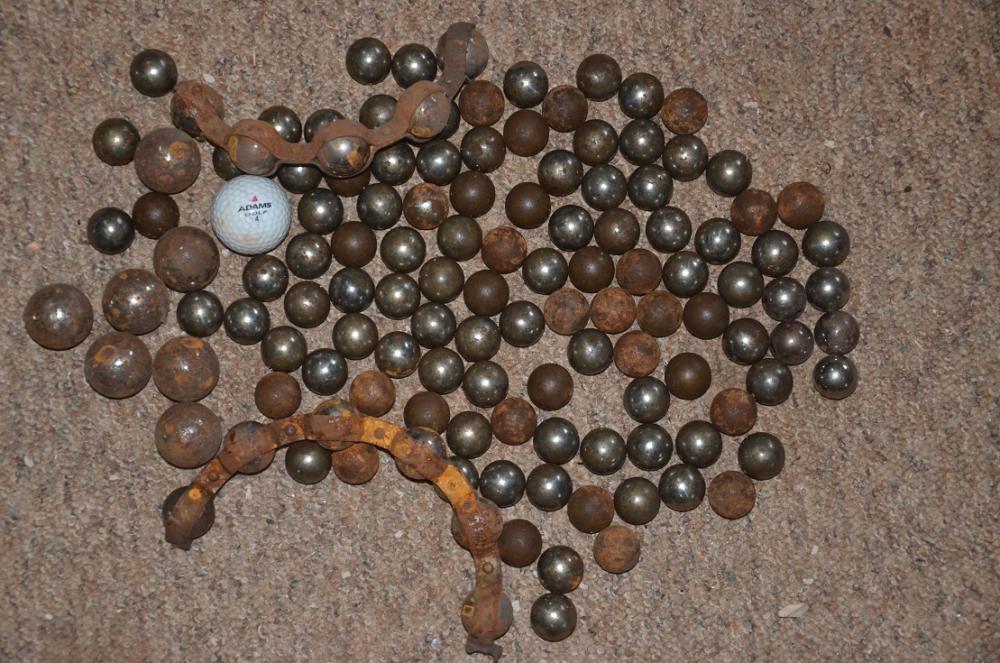

ausfire Posted May 4, 2018 Share Posted May 4, 2018 Surely in Michigan you would have machinery shops or factories that would have oodles of ball bearings. It's an easy job to cut them out of the races. Alternatively you can buy single big ones pretty cheaply on your on-line auction sites. I would happily send you one of the one inch balls in this pic, but you are a bit far away. Quote Link to comment Share on other sites More sharing options...
