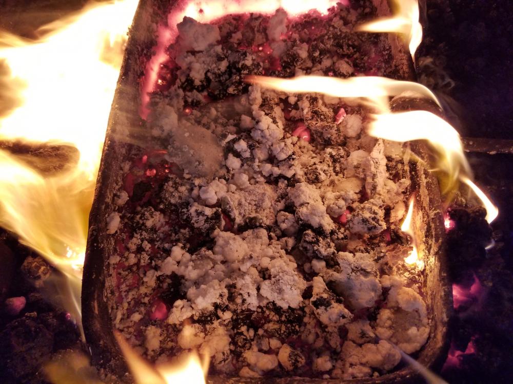

Originally I was playing with some old leaf springs from a 78 Chevy truck to my surprise I learned it's real hard to weld high carbon steels to each other. Now I have quite the stock pile of steel (my father is fabricator brings it me from work) so I've tried to forge weld a pieces of angle iron into them selves a few times only to find myself angered at the failed attempts

 Well I was told this by a successful experienced smith as well the same man told that my forge very well could be polluted apparently it's possible I'm not sure. I've grinded and wire brushed it clean over and over again
Sorry, but; High carbon steels are easy to forge weld.  Chromium steels are harder to forge weld especially to themselves. So automotive leaf springs would fall into that group especially if you try to weld them to themselves. Welding "high alloy steels" may call for a very aggressive toxic flux; but you are way before that stage of the game.

Stop making guess's. Start with the round like I suggested earlier. To play Baseball, first you must get to First base. This is no different.
Neil
Thanks Neil as we speak I am lighting a fire got a few pieces of small round cut at about 8" with luck I'll have forge welded successfully today
Small round stock will just stick to itself at the right temp, no hammering required.
If you have a few pieces in the fire, let them get nice and hot, wait for a few sparks to fly, then lightly touch them together.
They should stick and it cools over the next minute, try and pull them apart... Should be one piece and just bending around the welded part.
Once that works, you now know what look for.
Next time try sticking them together and hammering a bit to weld more of the bar together.. Hopefully that works out and you're on your way to successful welds after that.
Start simple and work your way up, just experimenting
here is a recent thread that was about 10 topics below, covers some stuff that hasn't been mentioned yet.
Success!!! I did it scarfed the ends and tapped them together into one piece after words I got a little squirrelly and split a piece of the same round stock down the middle and inserted an old Nicholas file (grinded smooth) and managed to get it to stick without any major issues  thank you all for your advice I don't know if it has been covered but my dad stopped by the house today watching me work with the 20 mule team and suggested maybe nocking the flux off off some of the "farmers" welding rods would it work........ Would not be a good alternative just seen it on this forum
