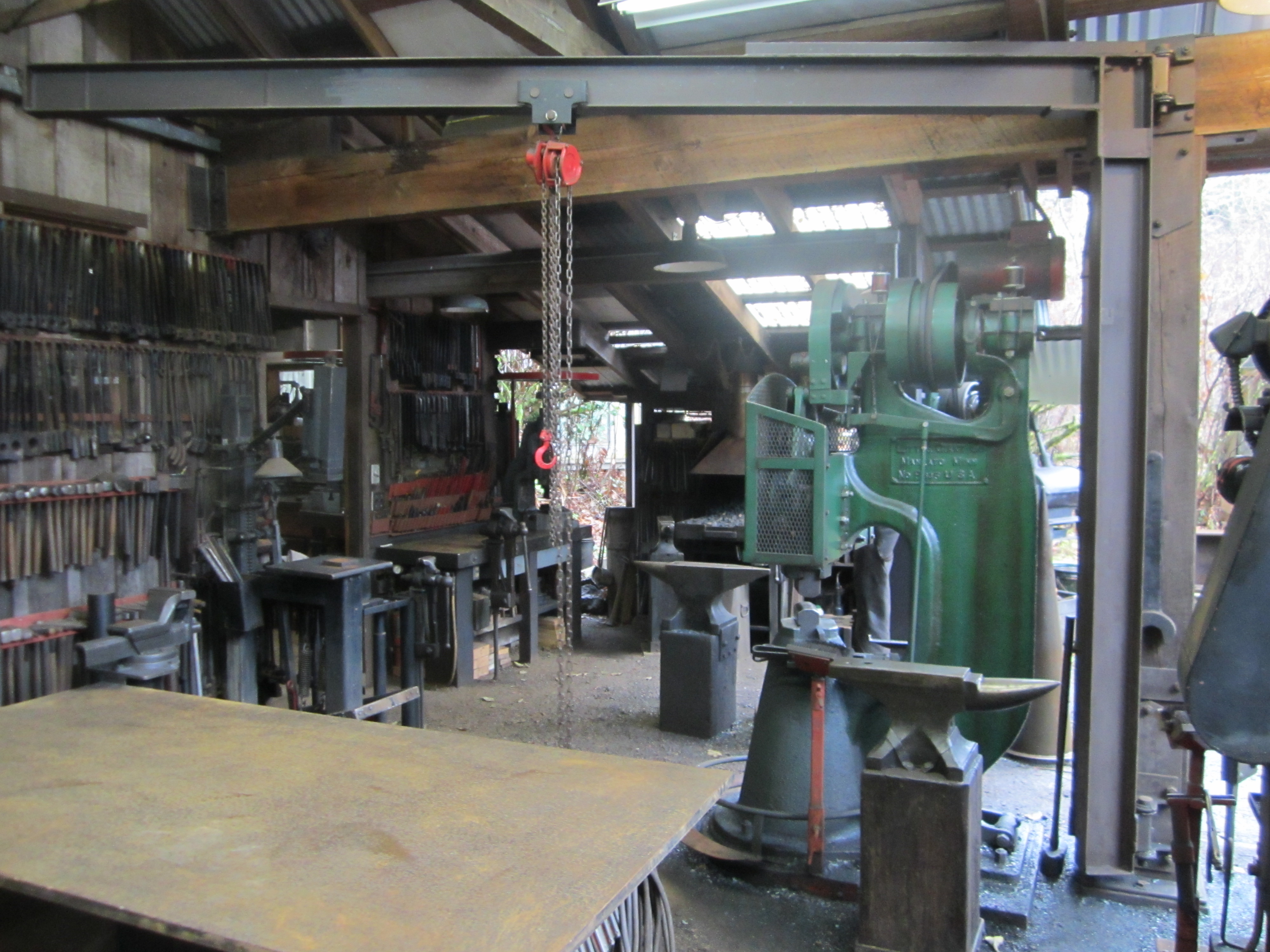

beaudry Posted December 2, 2017 Share Posted December 2, 2017 Here's a few shots of a couple of cranes I built in my shop to make it easier and safer to move big projects around. These are the jib crane design which give the most useful swing and reach with the least amount of space being taken up. There is a factor 3 pulling load at the top of the vertical leg with a correspondingly large thrust load at the bottom, so the building structure has to be built to take it. The pivots are oversized hinge barrel and pin bearings with grease fittings, easy to turn but with enough drag to keep things from swinging out of control. A crane would have been handy for installing these and welding the arm to the vertical leg in place, but careful planning and a temporary hoist got everything up and in position safely. All welding was done with a MIG that was powerful enough to do full deep penetration welds. The horizontal arms were welded with about a 1'' lift over the length of the beam to allow for any sag, but so far none has been detected , even under full load. With these two cranes I can move heavy completed projects all the way from the back assembly /finishing part of the shop into the back of my truck. A plate clamp and a selection of slings hooks and chains are handy for rigging . The beam trollies and chainfalls are rated for a minimum of 1,000 lbs. These aren't strong enough to pick up all but the smallest power hammer , but are really useful for handling the heavy parts when assembling and rebuilding the bigger machines. They have made a huge difference in the scale and size of the jobs that I can take on in the shop. Crane in main shop . Crane with swing from lower assembly area to upper level. There is an overhead track with a pair of trollies and hoist that runs the full length of this part of the shop . Bottom bearing and thrust plate Top bearing tied into header beam and roof truss. Quote Link to comment Share on other sites More sharing options...

beaudry Posted December 3, 2017 Author Share Posted December 3, 2017 The advantage of a swinging jib crane is that it can reach all around and lift anywhere within its swing radius regardless of anything else in the shop . It's not a simple project to build one however and the building needs both a strong enough structure to support one and sufficient headroom for both the beam and the trolley and hoist. I do mostly large architectural commissions, like railings, stairs, wall panels and gates so this enables me to forge and fabricate and finish large projects and load them into my truck for delivery to a jobsite. Once there I can usually use the onsite crew and equipment to unload and get things into place for installation. This is probably far beyond the scale of most of the users on this forum, but is worth considering when designing or expanding a shop. Quote Link to comment Share on other sites More sharing options...

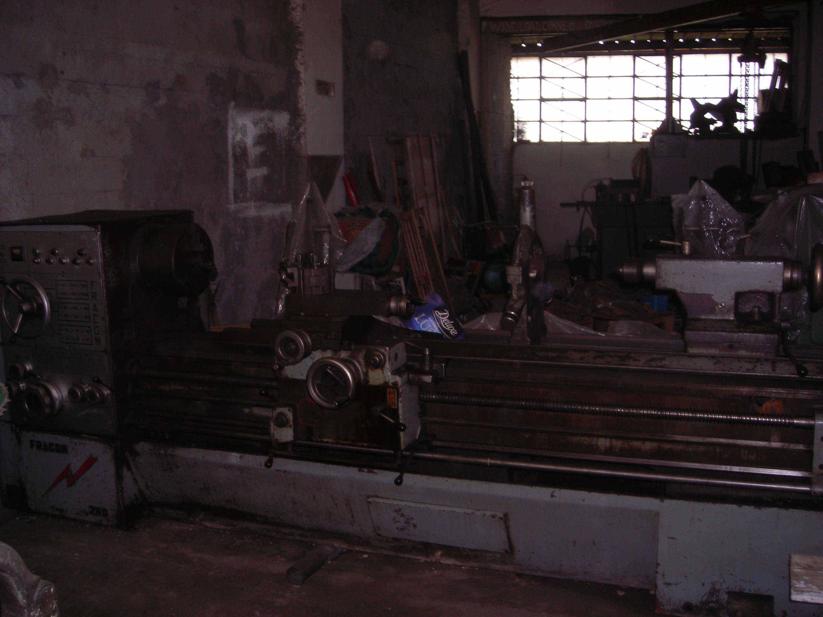

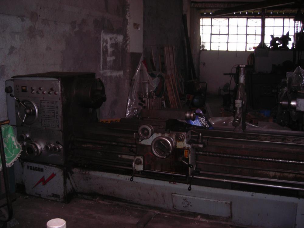

angiolino Posted January 30, 2018 Share Posted January 30, 2018 I have to build a similar one, you could give me some suggestions I have to use as a service crane for my lathe you could attach project with necessary measurements and materials, I have to realize the rotation ring do not know how to build it how to make hinges and hinges i gangheri Quote Link to comment Share on other sites More sharing options...
beaudry Posted January 30, 2018 Author Share Posted January 30, 2018 You'll have to figure it out yourself for your situation and the expected swing and load requirements that suit your needs. You can mock it up with some sticks screwed together to figure out the most useful dimensions and location for your anticipated application. The only rule of thumb that I know of for a wall or post mounted jib crane like the one I built is that the pull load at the top and the thrust load at the bottom is three times the maximum load on the end of the horizontal beam of the crane. If in doubt , have it engineered for your application or buy a reputable manufactured unit with that already built in. Anchor it solidly . Quote Link to comment Share on other sites More sharing options...

angiolino Posted January 31, 2018 Share Posted January 31, 2018 you would have the mathematical formulas or calculations, my would like to bracket it on a reinforced concrete pillar of the building measuring 55 cm x 55 cm is armed with iron inside the concrete, for the hinges of rotation what you advise me, how you built them I'm sorry if I take advantage of your experience thanks you would have other photos or drawings with measures to take inspiration, I'm sorry if I make you waste precious time and patience thanks again for the attention to the next Quote Link to comment Share on other sites More sharing options...

BIGGUNDOCTOR Posted February 1, 2018 Share Posted February 1, 2018 Curious why you went with I-beam as oppose to pipe like most of the commercially made ones? Quote Link to comment Share on other sites More sharing options...
beaudry Posted February 1, 2018 Author Share Posted February 1, 2018 I'm not sure where you think a pipe section would be better for this style of crane ? All the commercially manufactured wall or post mounted jib cranes I looked at for inspiration were basically made like this . As it was ,It worked out that I could buy a full 20' length I beam cut to make both legs. The free standing cranes that rotate around their own post often use a large pipe section for the upright member. The trolley is made to run on an I beam section learn how to post please Quote Link to comment Share on other sites More sharing options...

beaudry Posted March 31, 2018 Author Share Posted March 31, 2018 Some good designs here except the rendering of the one with just a pivot but no support for the arm either above or below. Having a diagonal strut coming down from above to support the beam simplifies the design, but loses some headroom. It seems the most useful design has the maximum height under the hook . The first design with the open frame diagonal brace with rom for the trolley and hoist to pass through is an ingenious solution . Quote Link to comment Share on other sites More sharing options...

beaudry Posted March 31, 2018 Author Share Posted March 31, 2018 ^^^ If was going to do it again in MY shop, I would do it just like I did in my original post. Looking at all the factors involved in my shop set up , it was the best solution to give me the lifting capacity , height and reach for MY shop. I copied a proven commercially available design, bought good components and used heavy enough steel sections, welded it all with a powerful welder and mounted it to a solid building structure with an overabundance of heavy fasteners. There are a number of good designs out there, but they all have to address the load on the beam as well as the pull on the top of the mast and the corresponding thrust at the bottom. If the building structure that it is mounted to isn't up to the task , then it needs to be reinforced. Quote Link to comment Share on other sites More sharing options...
Frosty Posted April 1, 2018 Share Posted April 1, 2018 I've built a couple jib boom cranes on the same pattern as the one in yellow above. The tension reinforcing cable does NOT need nearly so much height. I simple extended the hinge pin 12" above the boom and gave it a bearing. From there I used 5/8" rnd. steel rod rather than cable. Not because rod is better it's what I had. A later one I used 3/4" rd. rod again it's what I had. I tensioned it by threading the ends and and double nutting it. They were simple fast and easy to build, making sure they were secure to the posts in the shop was the only real issue for calculations. You want to be careful connecting things like this to a building's support structure, especially when someone else is going to be using it and they don't have a lick of sense about how much weight is too much. I don't have a pic though. Frosty The Lucky. Quote Link to comment Share on other sites More sharing options...
