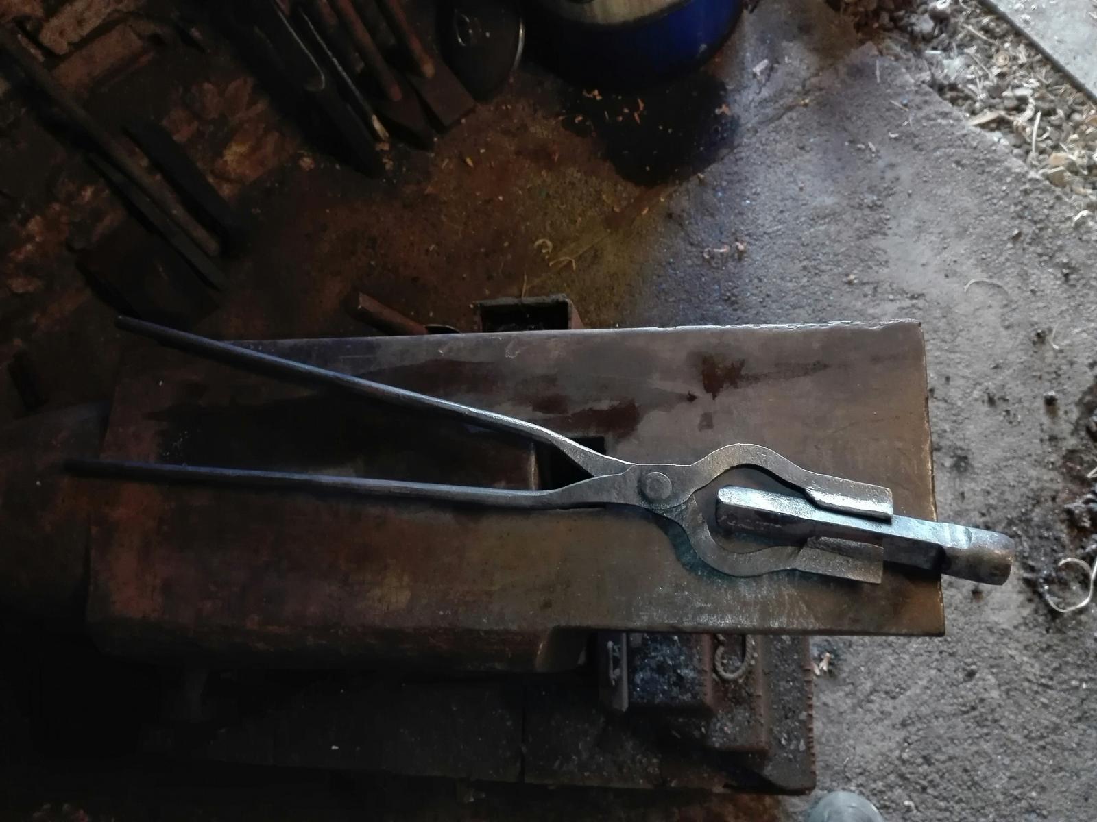

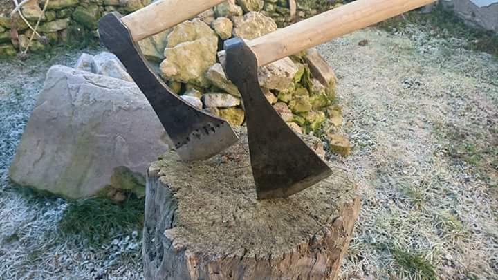

I badly need some help! I'm at my wit's end. I already made so many things successfully.
Tongs...
Knifes...
Axes in different sizes...
And many other tools and things. But I'm currently not able to make a simple nail! :(

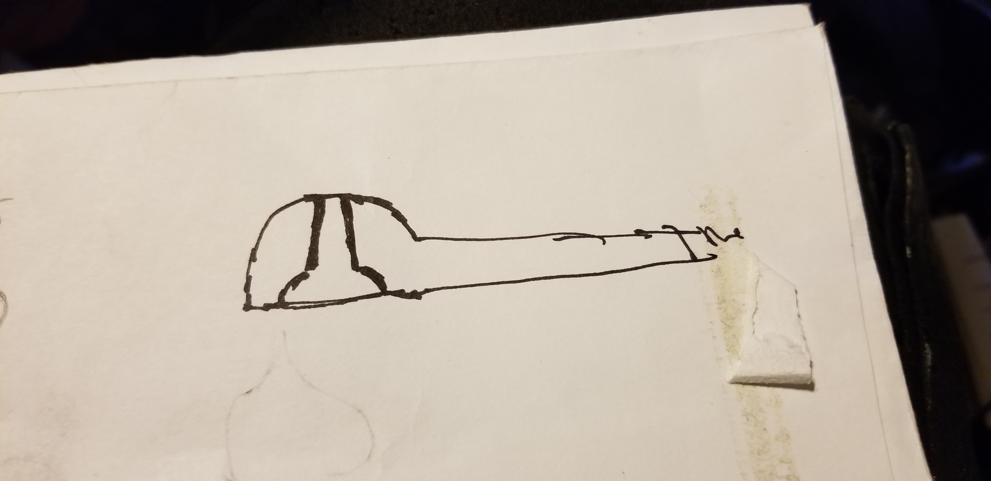

The header should be domed. The nail hole should be hour glass shaped. This holds the nail at the top side, but does not hold the nail on the bottom side of the hole.
taper the stock to the length you need for the nail, and notch the stock as shown at a length of about 1-1/2 the diameter of the stock. Put the stock into the fire and warm it up to orange. Place the nail into the header and twist off the parent stock. Immediately take careful aim and hit the nail perpendicular to the nail shaft with a strong hit. This will drive the nail into the header and form a round head. Now hit the nail head N, S, E, and W making a flat on each side with the top of the nail as a 5th flat surface. (a 5 flat head). Quench the nail and header in the slack tank. This will keep the header cool, and shrink and release the nail from the header. It should fall out of the header or fall out with a gentle bump of the header.
I'm sorry Glenn, but I don't agree with the double taper on the hole.. There should be a long taper from the work side all the way to the bottom but with no double taper.. Reason is if the nails is worked hot and you move the header sideways against the pritchel hole you can actually bend the shank of the nail into the bottom taper and will be tough to get out.
on larger nails there is usually enough shank cross section to not cause as much of the problem but on smaller sizes used in hardware and such it really can make it a problem to get the nail out of the header, never mind having the nail remain intact in the process of removing it..  I speak this from experience as my early nail headers were of the double bevel variety..
After getting a few stuck during money jobs I changed into only one side taper.. Works worlds better..
Let us say the nail hole is a single V shaped and goes clear through the header.
