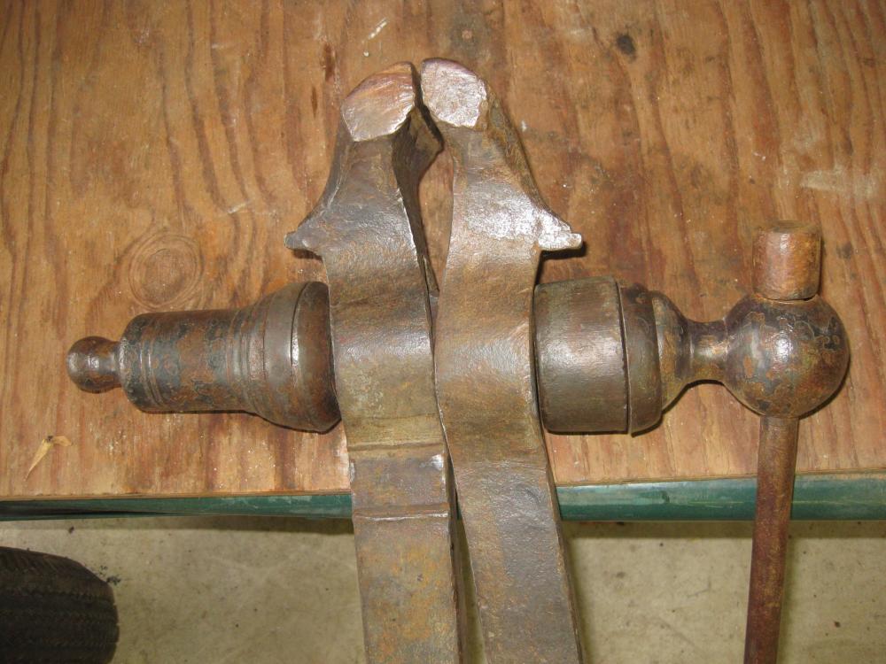

No spring or mounting bracket
Oh no, what should I do?  I found a cute 3 1/2" vise that seemingly had a hard life. Not only the missing parts, but the legs were bent in as if someone had cranked down on the handle with a cheater bar. I'm guessing the screw box also blew apart, because the current one doesn't quite look like it was original. The current screw and box is in excellent shape, however.
So, I pulled it apart, the first step was to straighten both legs. Got them hot, laid them on the anvil and beat them into submission with a flatter and a small sledge.
I then fabbed up the mounting bracket, keys and spring. All material was A36. Spring was 1x 3/16', bent cold. Saddle was 1x 3/8 drilled, hot punched and hot bent. Body blank was 1x 1" drilled and hot punched, then drawn down, saw split and formed. Keys were 1 x 1/4" chisel cut cold and filed.
Put everything back together, and it all works a treat. I could do a little more tweaking, but it works pretty well at this point. I'll mount it somewhere and some how, use it a whill and take it from there. All in all, a fun satisfying little project.

One question, why A36? My metallurgy knowledge is very weak.
It'll do the job and it's common and cheap would be my guess. (For a new smith it is also less likely to fail in the forging/heat treating or use than a higher carbon alloy)
Eh? 36? Eh!  Don't look for anything Magic, simple is best!! The material you have is the right stuff!!

If you don't mind could you show the tool you used to hot punch the 1X1 stock after drilling?
Don't have a pic right now, but it is a 1/4" x 1" flat bottom slot punch, forged from 3/4" 5160 and normalized. It is ~5" long, I hold it in tongs , cooling it every 2-3 blows. Punch 1/2 way through, or so, flip the piece and punch the slug(s) through the hardie hole. I just did a little touch up filing inside the hole, and flattened out the swelling on the bottom of the piece.
 Does that help?
Steve
It helps a lot. I have not done any sort of heat treating or normalizing yet (with the exception of annealing some copper) but I am going to make a crude attempt at making my leg vise hardware from looking at yours. If it doesn't turn out well I can always try again. Right now it's just functionality for me, the pretty stuff will come later, I hope.
