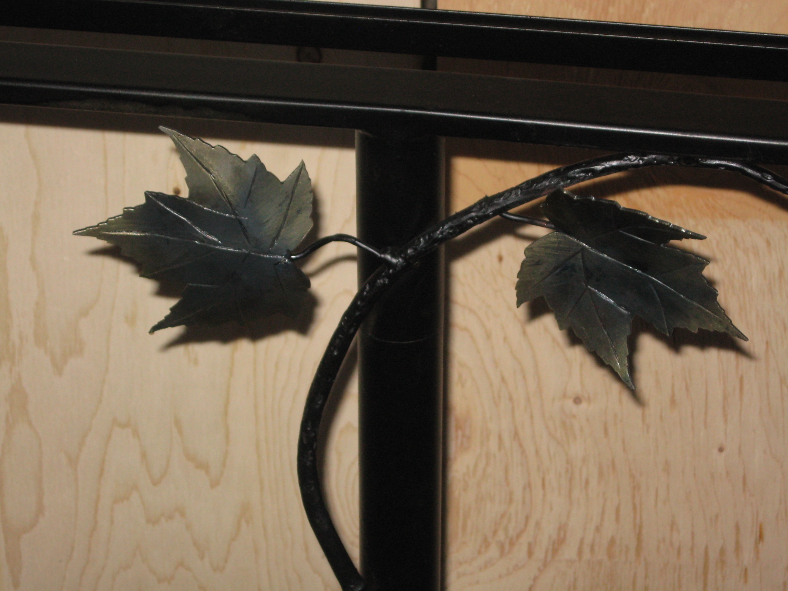

Here are are some I did  a while ago, laser cut for me then used in  project .Looking at them now I see that I might have put a little more in to forming them to look more alive . Sheet was just under 1/8"

I think the real challenge is to get " life" into botanical forms . Getting just the right twist or bend can make a lot of difference .
