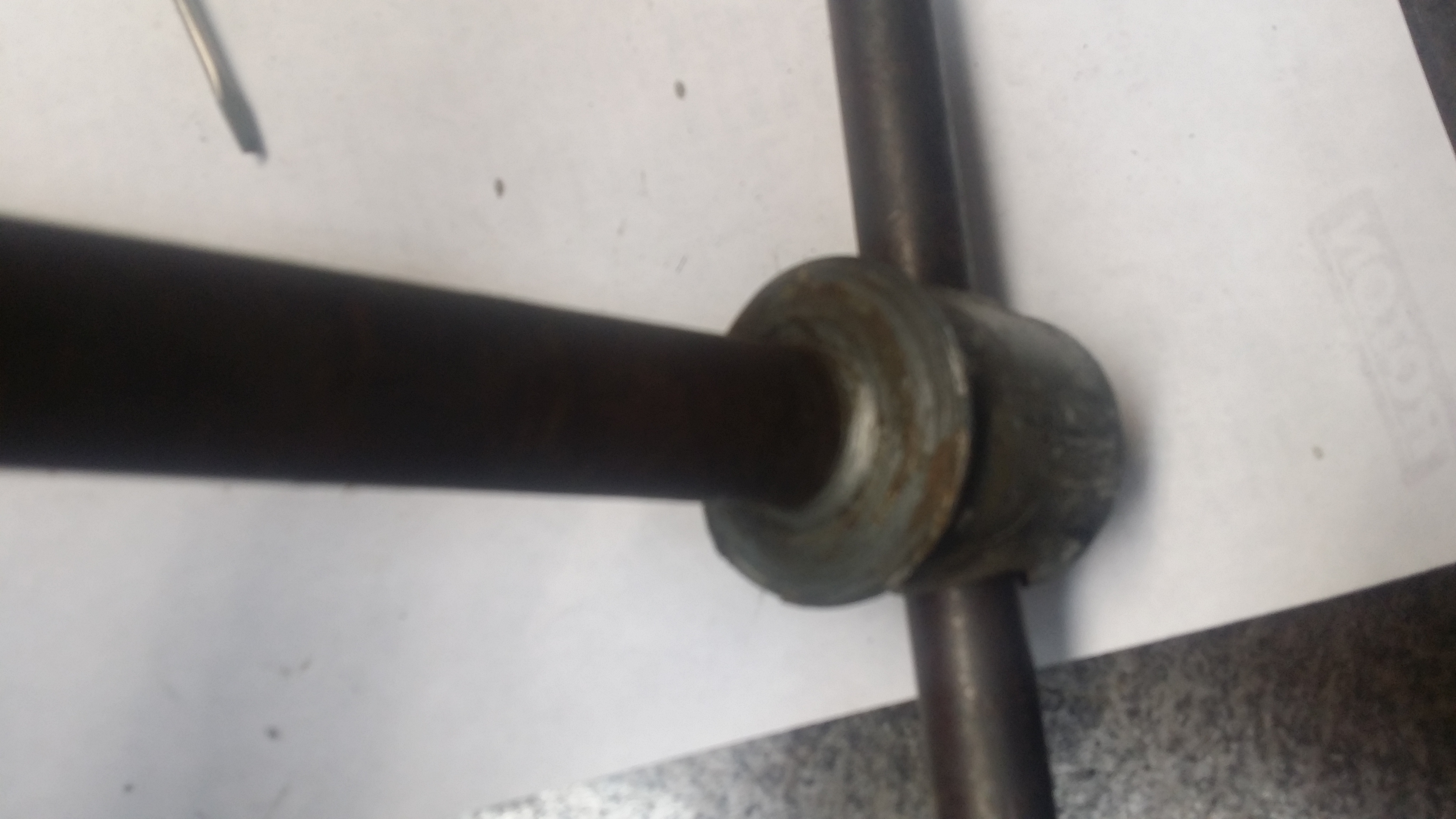

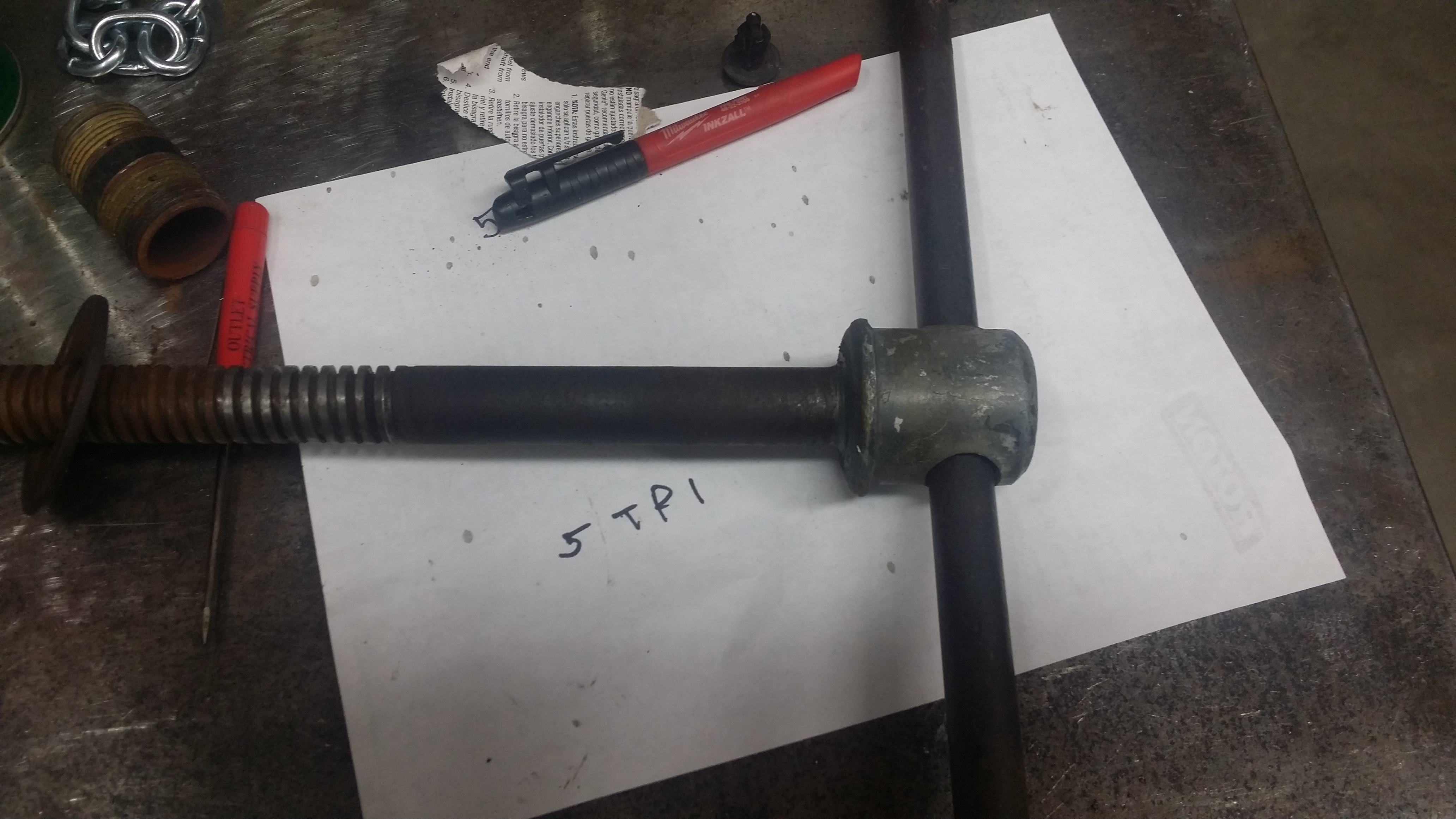

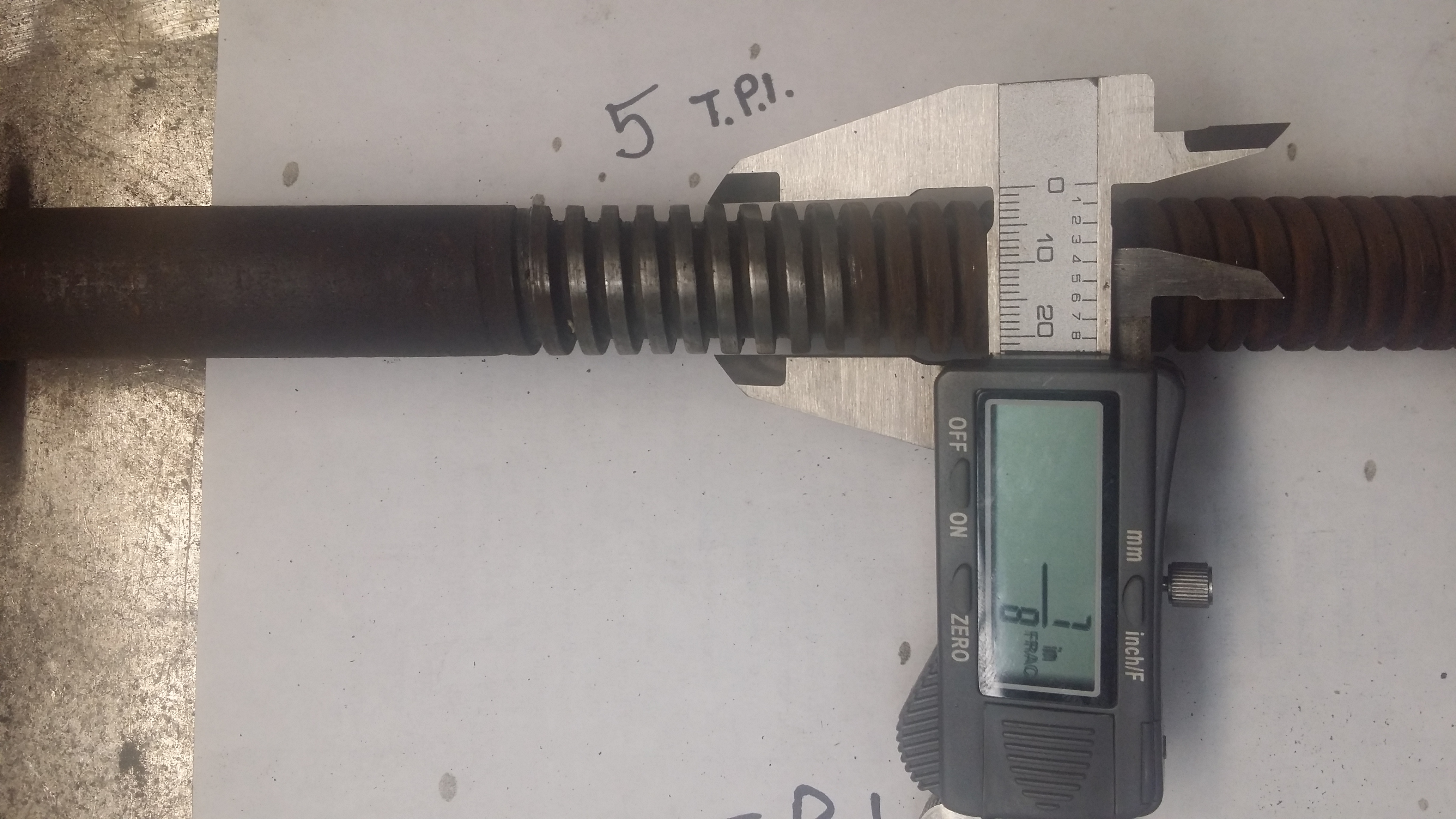

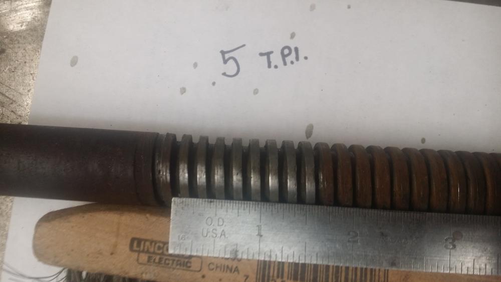

bigb Posted August 16, 2016 Share Posted August 16, 2016 Trying to find a nut for this screw but I don't think its Acme, the threads appear to be square cut. If my measurements are correct the major diameter is 7/8", T.P.I. is 5 and pitch is .2 .........I just don't know what kind of nut to look for that will work with the square cut threads, any ideas where to find one? Quote Link to comment Share on other sites More sharing options...

D.C. Posted August 16, 2016 Share Posted August 16, 2016 Most acme threads look nearly square when they're new/not worn. Technically they are trapezoidal threads...but definitely square at the top. We use ALLOT of acme in our shop. Quote Link to comment Share on other sites More sharing options...

Smoggy Posted August 16, 2016 Share Posted August 16, 2016 It's a square thread, typical of a lathe feed screw, what is it from? What is it being used on? There may be options on where to look for or make a nut depending on what you need. Quote Link to comment Share on other sites More sharing options...

bigb Posted August 16, 2016 Author Share Posted August 16, 2016 It is off an old leg vise but most likely a replacement screw, not the original. There is no ID on the vise.There was no screw box, just an aluminum nut in bad shape, Quote Link to comment Share on other sites More sharing options...

Kozzy Posted August 16, 2016 Share Posted August 16, 2016 Square thread form as others have said. Taps are really hard to find and expensive so you are looking at big bucks if you need a nut--and probably best to thread it on a lathe. We make forming dies that are basically square thread form nuts in a variety of sizes--it's all lathe worth and a pain in the keester, taking LOTS of passes. I wouldn't wish that on anyone. So...again as others have mentioned, you'd be ahead of the game to start from scratch with ACME or similar instead. It'd be nice if you could find some existing object to steal parts from but that too might be chasing your tail vs the ease of just switching to ACME. There is a way to cast the nut using the existing thread as the form (as ThomasPowers mentioned regarding babbit)--One modern material is moglice which is theoretically supposed to be as strong as the parent material. There is a little info on thread re-casting with the stuff at their site http://www.moglice.com/articles/replication_techniques/wrotethebook.html. I haven't used it but I have spoken to several machinists who swear by the stuff for shaft build-ups. Quote Link to comment Share on other sites More sharing options...
bigb Posted August 17, 2016 Author Share Posted August 17, 2016 OK sounds like I should start new and go with Acme. Any recommendations on where to order the parts? We do have a nut and bolt supplier locally I can check with for the Acme screw and maybe a bronze nut. I imagine I will buy a length of Acme rod and cut it to size. Thomas, good idea about the VoTech, would have been easy when I was taking welding classes at the local community college in their machine shop. I never see good old house jacks or RR jacks around here. Quote Link to comment Share on other sites More sharing options...
bigb Posted August 17, 2016 Author Share Posted August 17, 2016 If I start with a new screw how can I make the part at the end that the handle fits into and what is it called? My present one appears to be zinc or some non ferrous metal, not sure if I can weld it. Quote Link to comment Share on other sites More sharing options...
