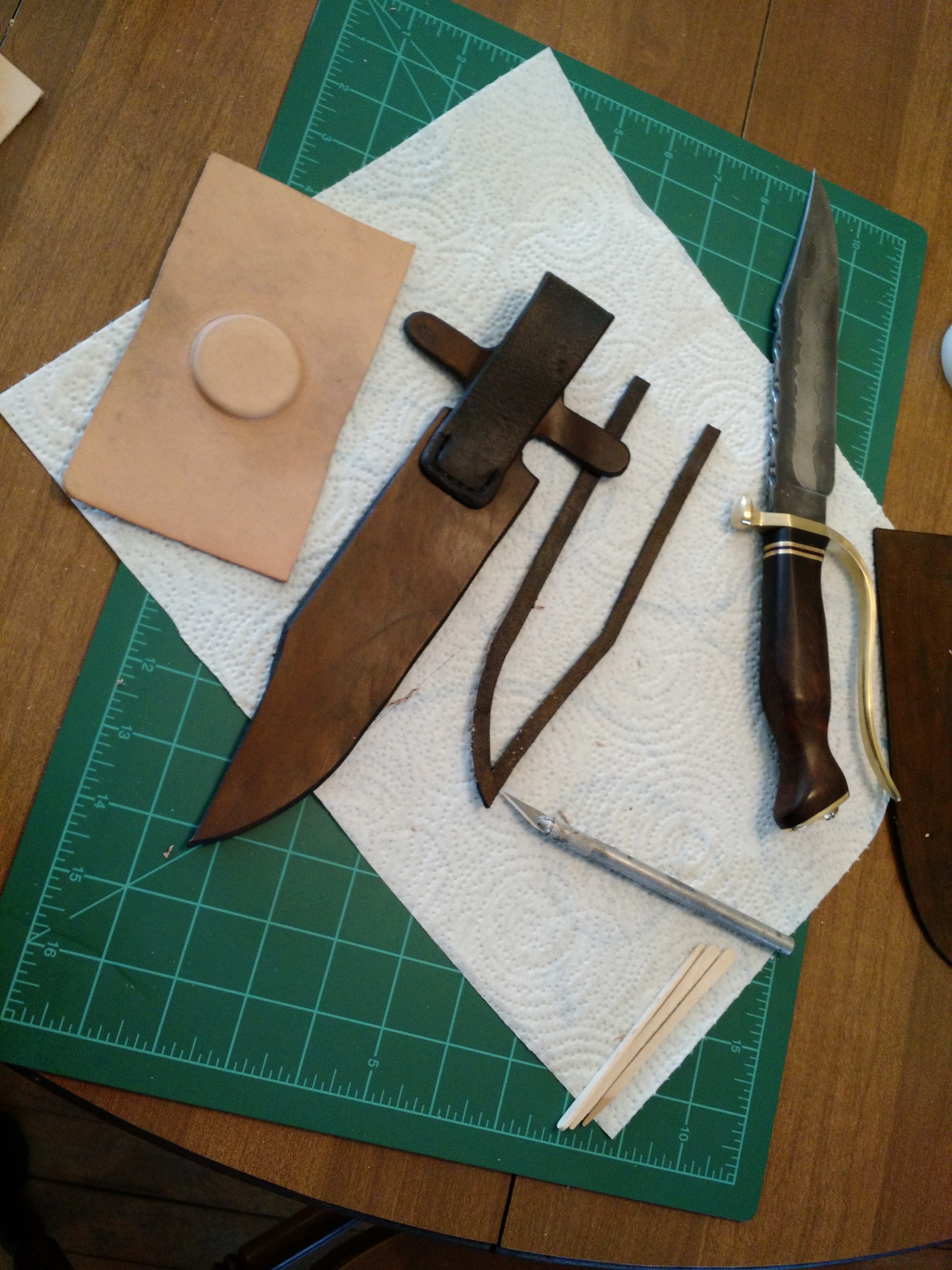

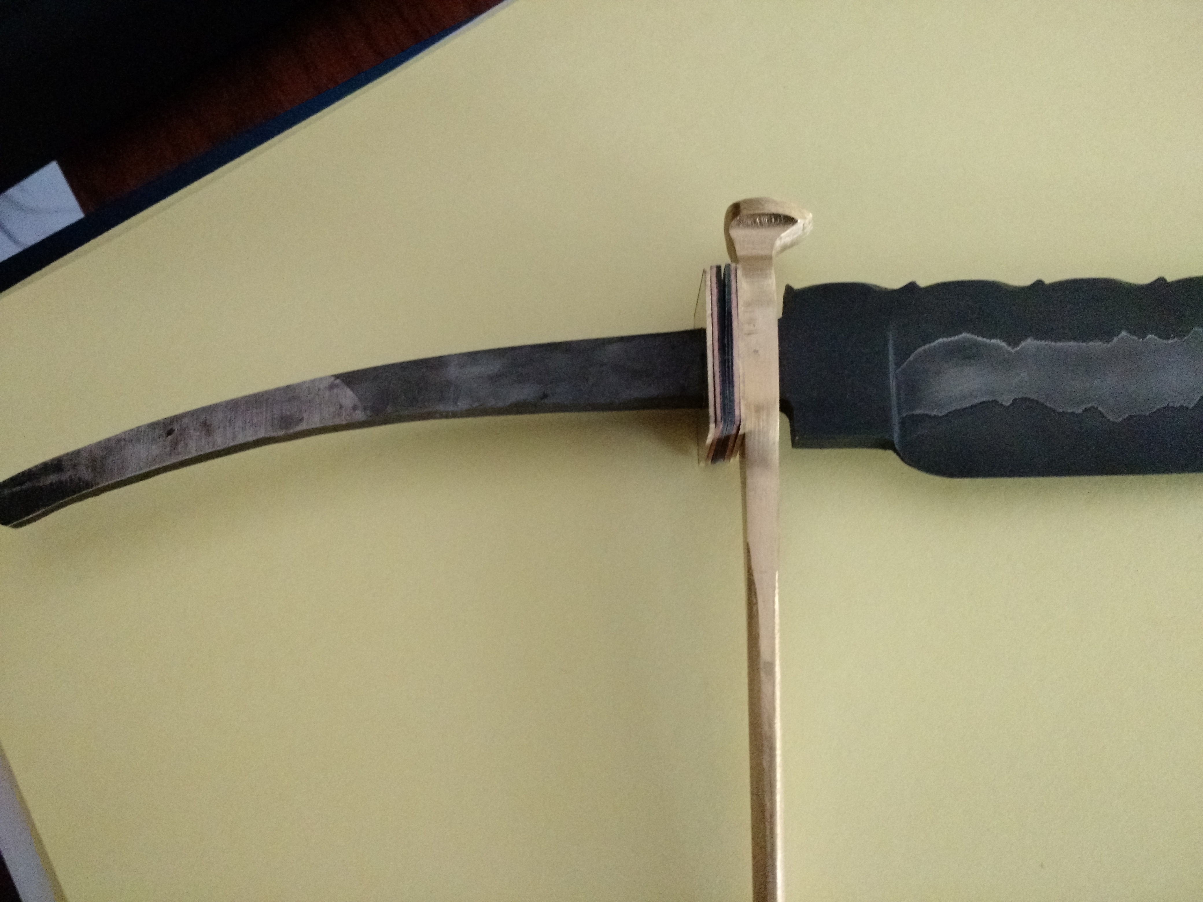

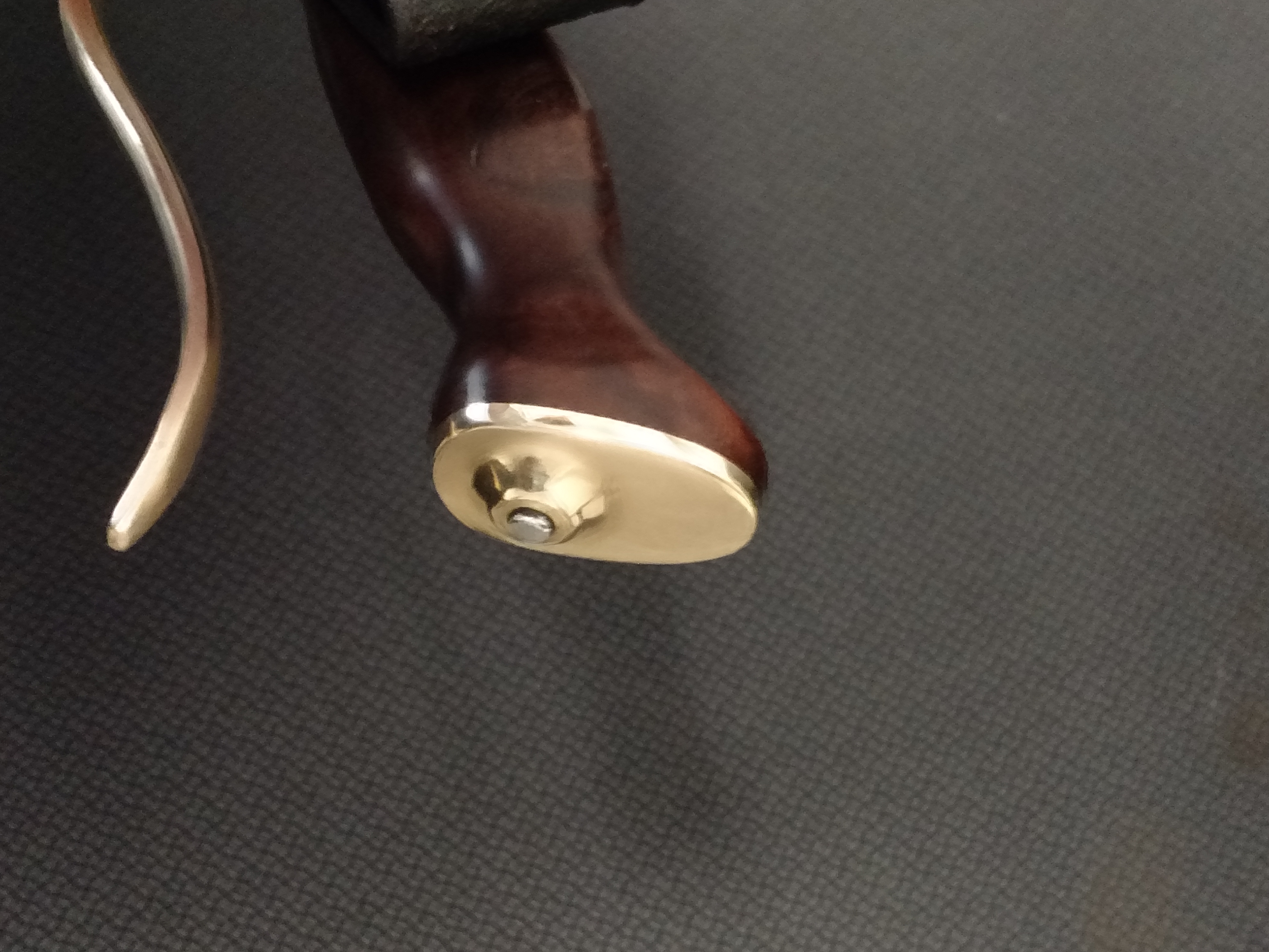

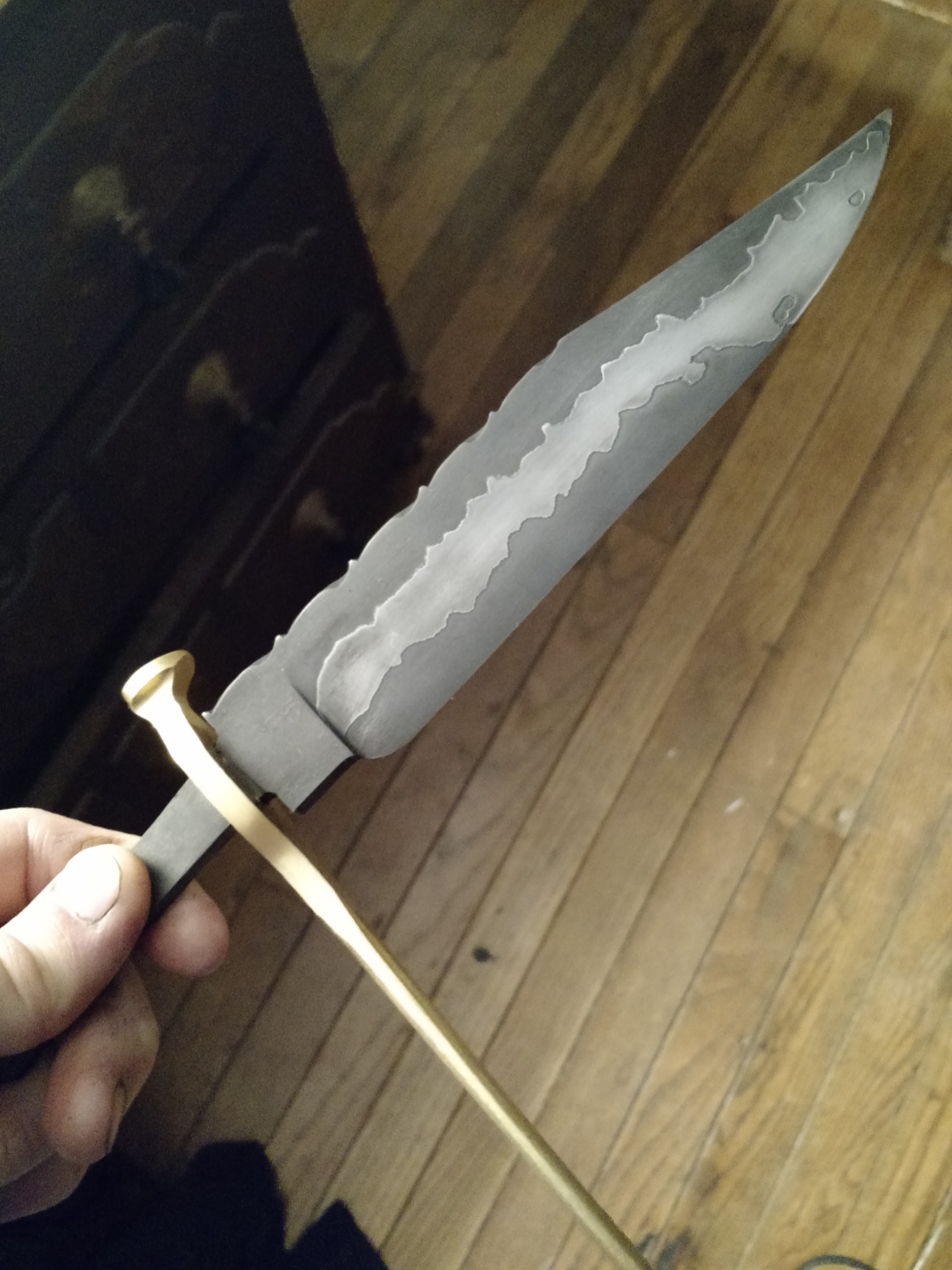

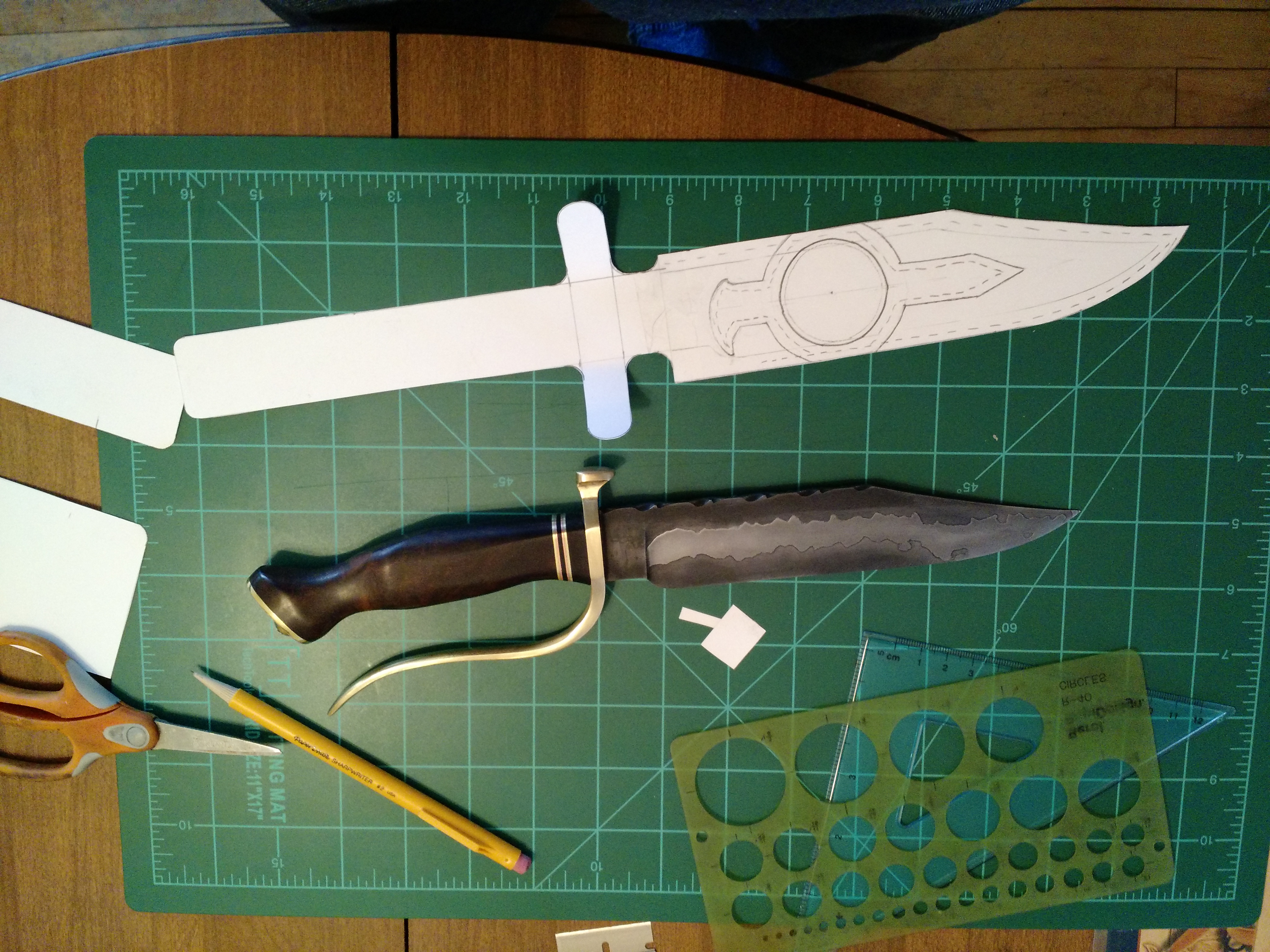

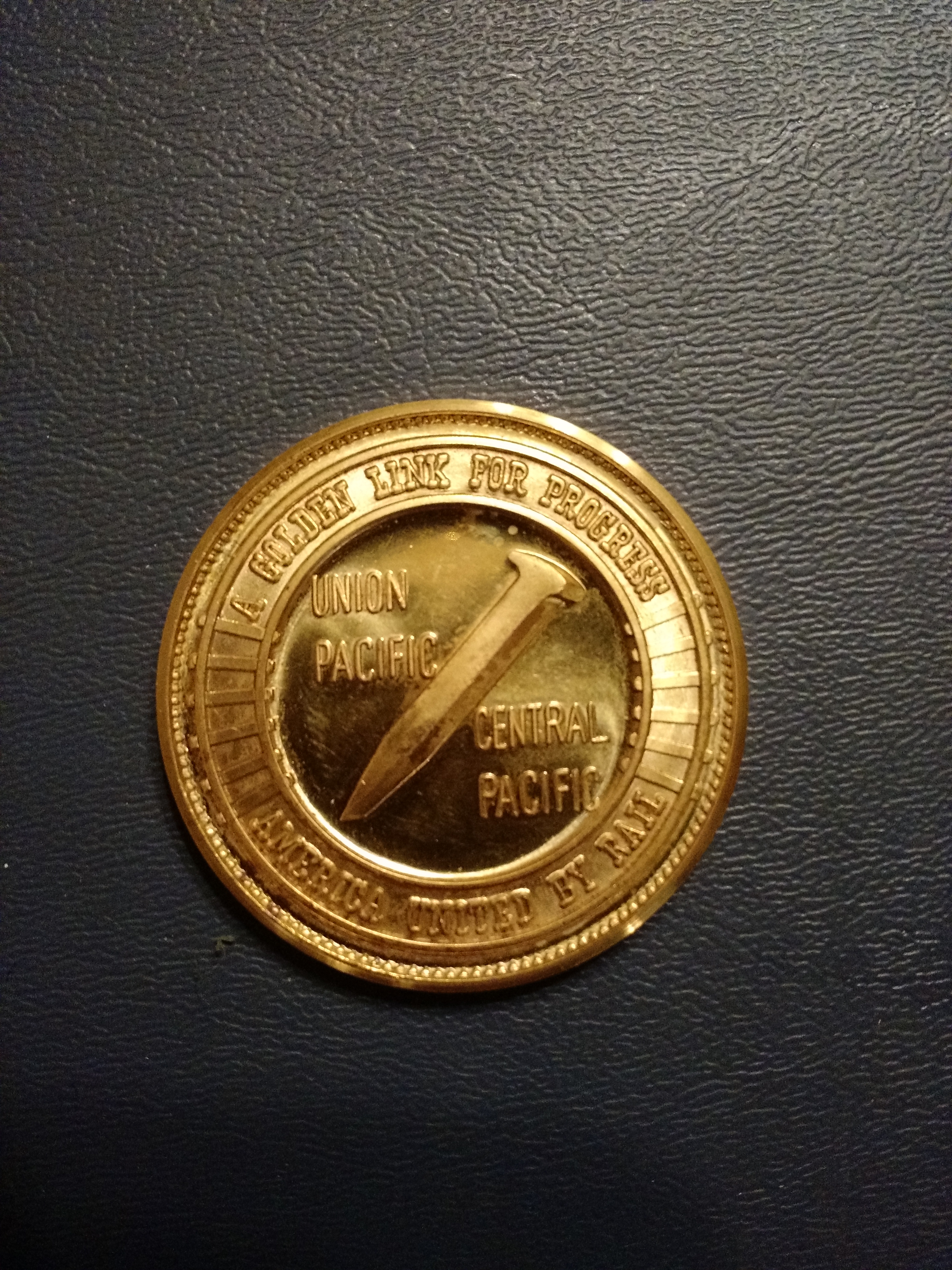

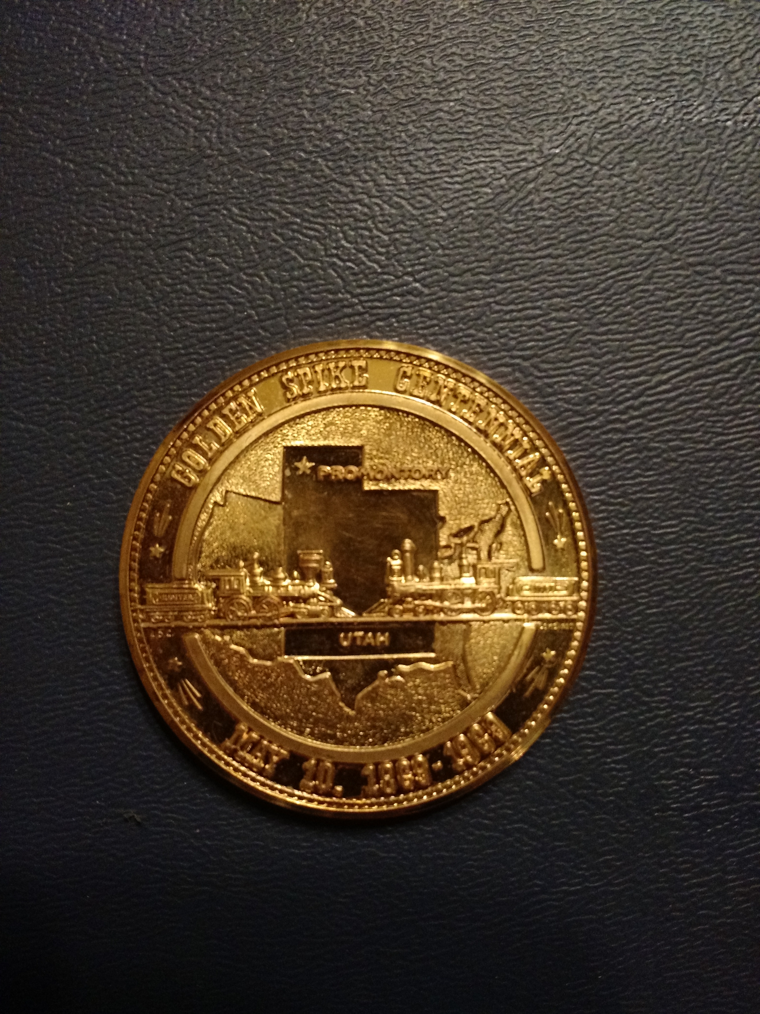

rhitee93 Posted March 8, 2016 Share Posted March 8, 2016 A friend asked if I would help her with an anniversary gift for her husband. She wanted a railroad spike themed knife... ...yeah, I wasn't going to go there. What she really wanted was a knife to go along with a rifle and pistol he already has that were made in 1969 to commemorate 100th anniversary of the driving of the last (golden) spike at Promontory Point, Utah. This is what I came up with. The blade is 5 layers of 1095 and 15N20. I was hoping for a narrow skunk-like stripe. I like what I ended up with, but will use much thinner 15N20 next time I try to achieve that effect. The Spike themed guard was forged from 464 brass. I've had a hard time forging 360 brass lately so I tried the 464, and it was much easier to get along with. The handle is desert iron wood with copper, brass and black-wood accents. The coin in the sheath was minted in 1969 to also commemorate the Promontory Point event, so I created a pocket in the sheath to display it. Quote Link to comment Share on other sites More sharing options...

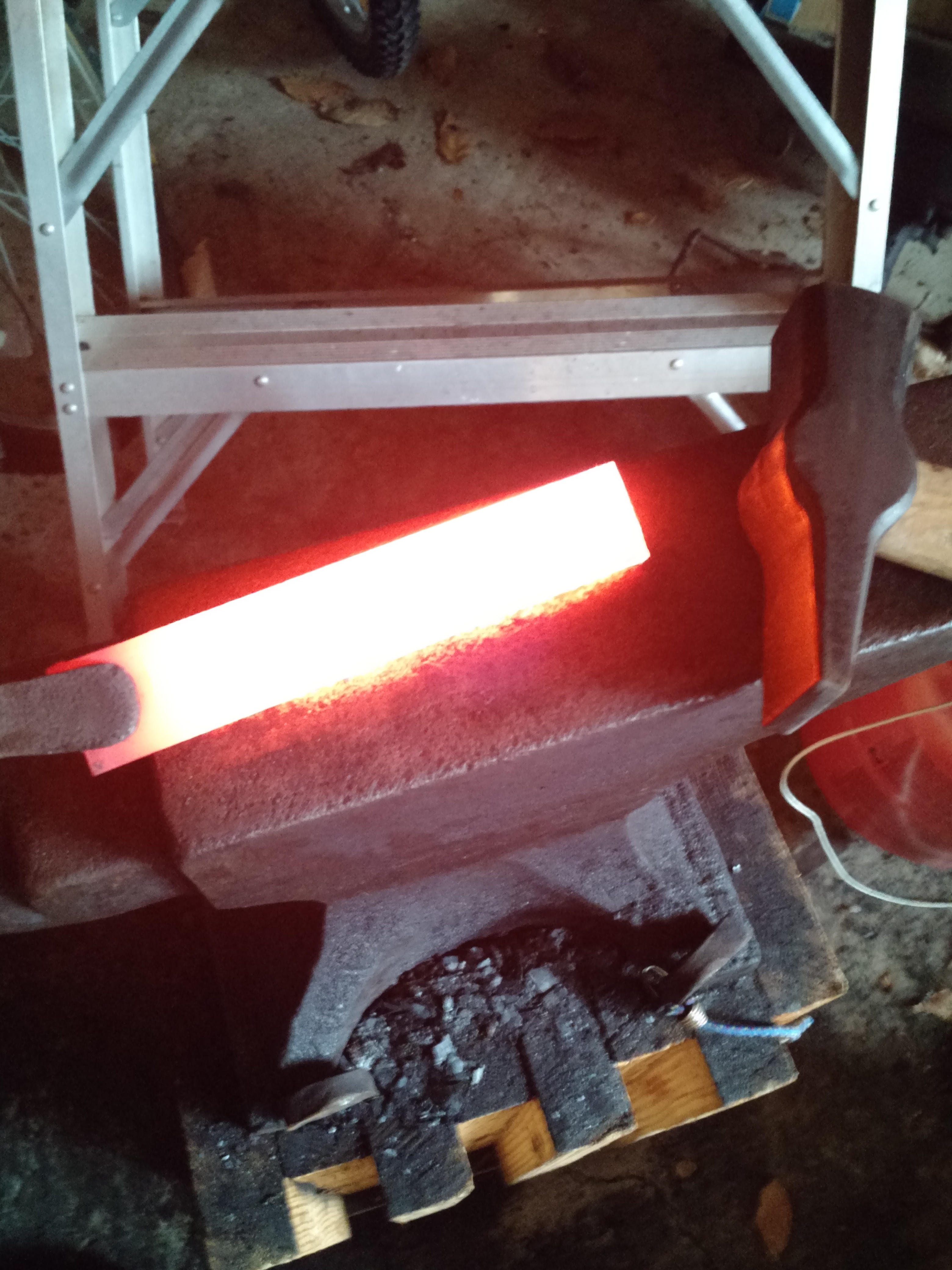

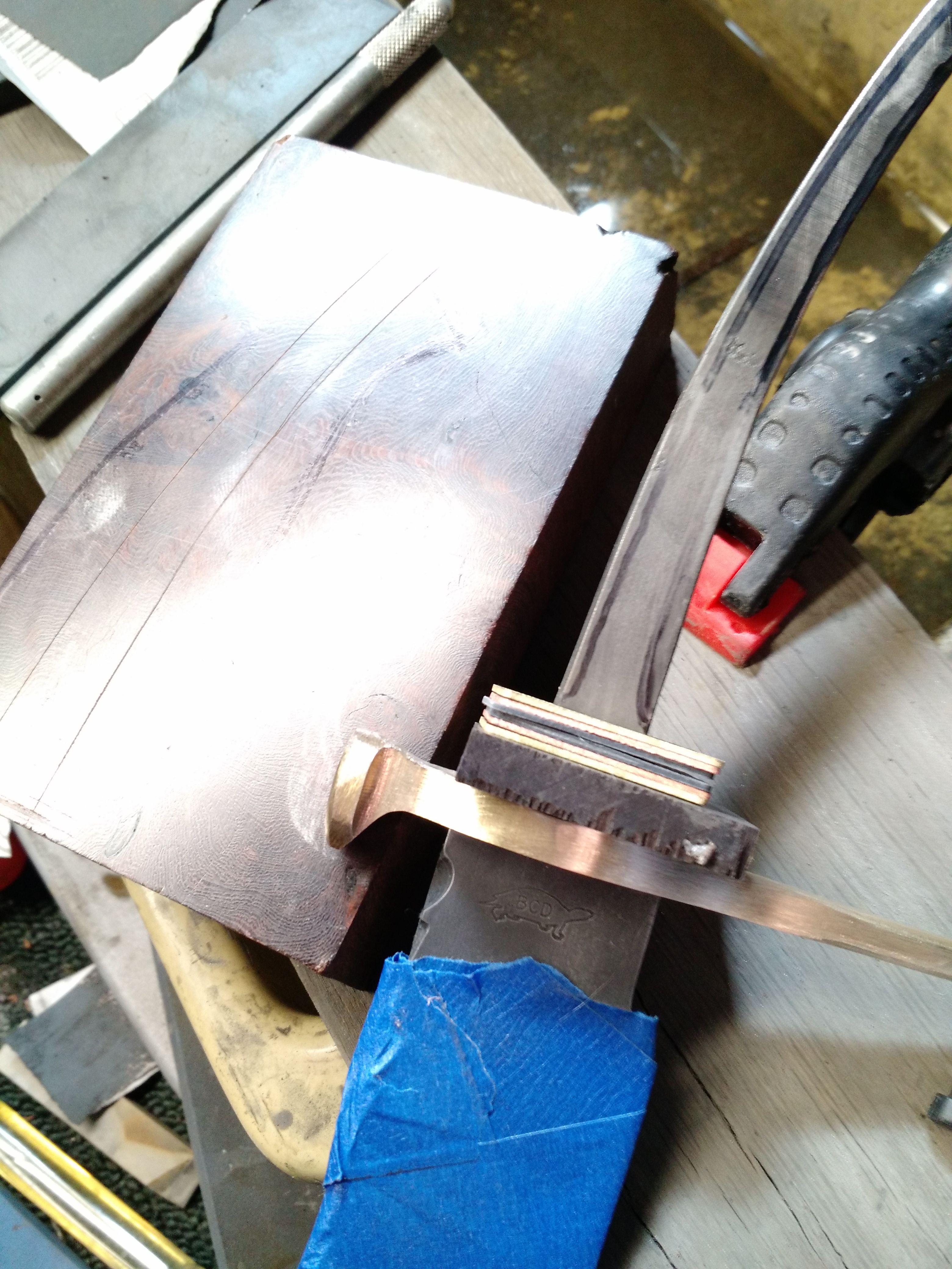

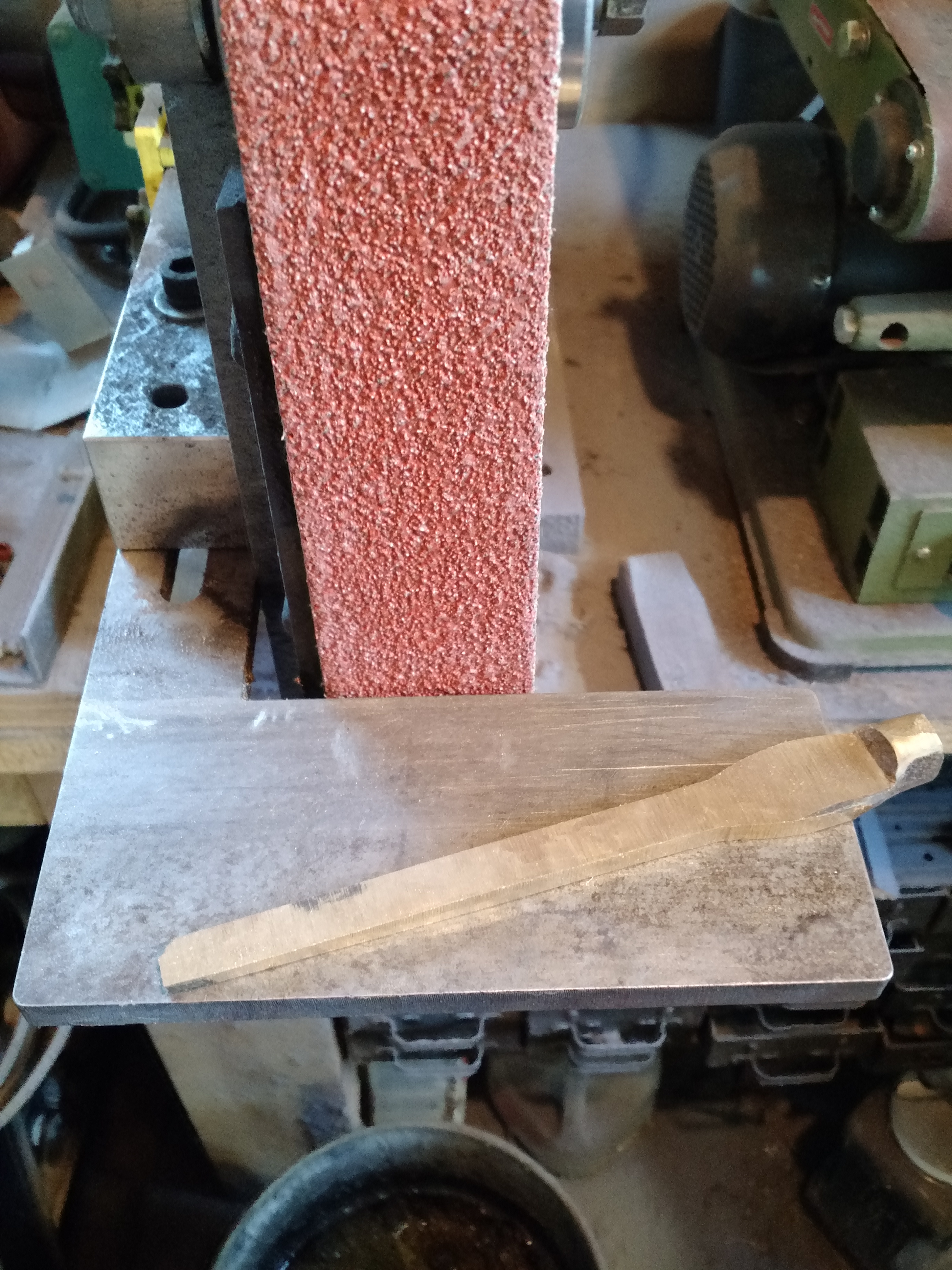

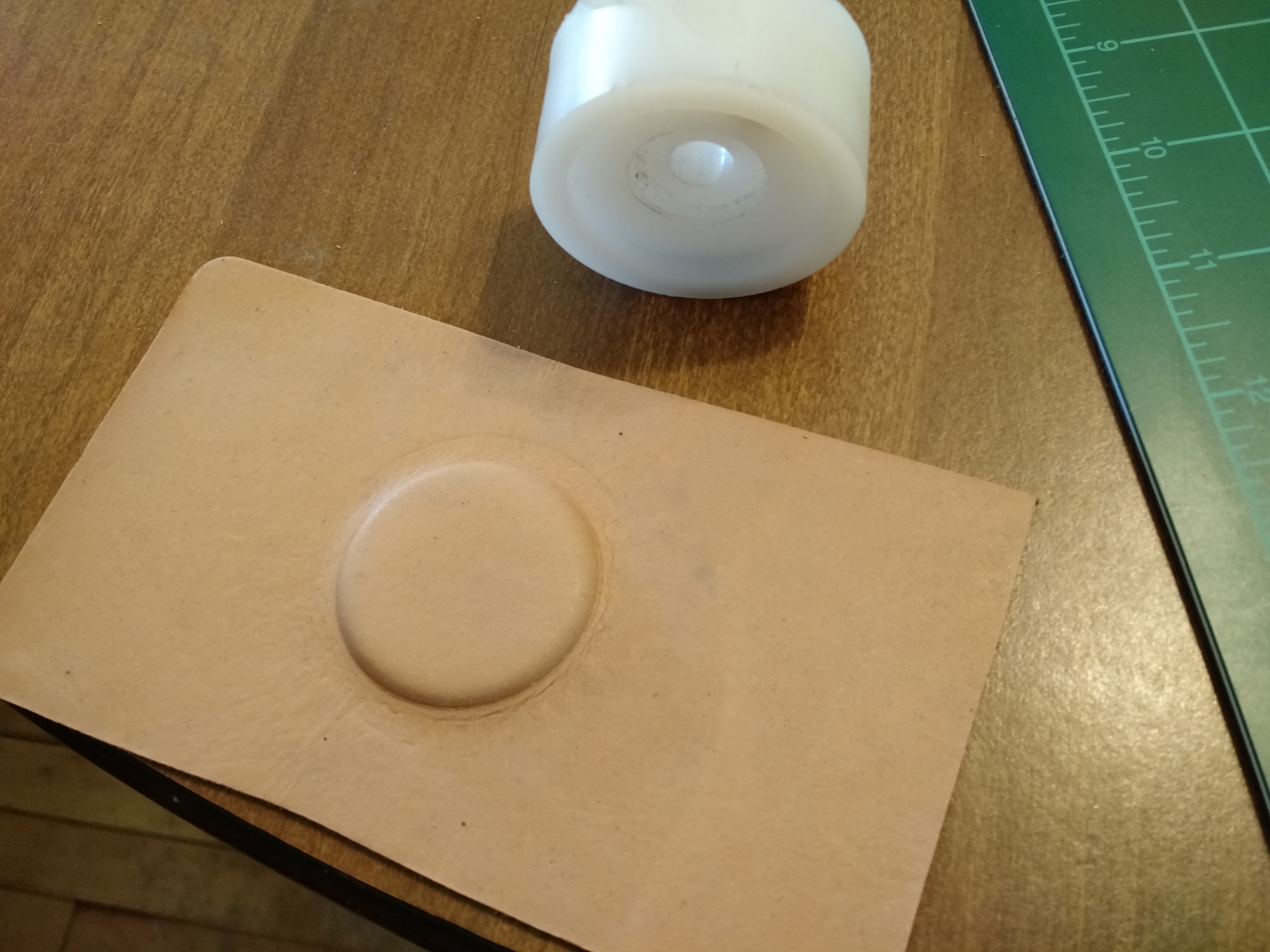

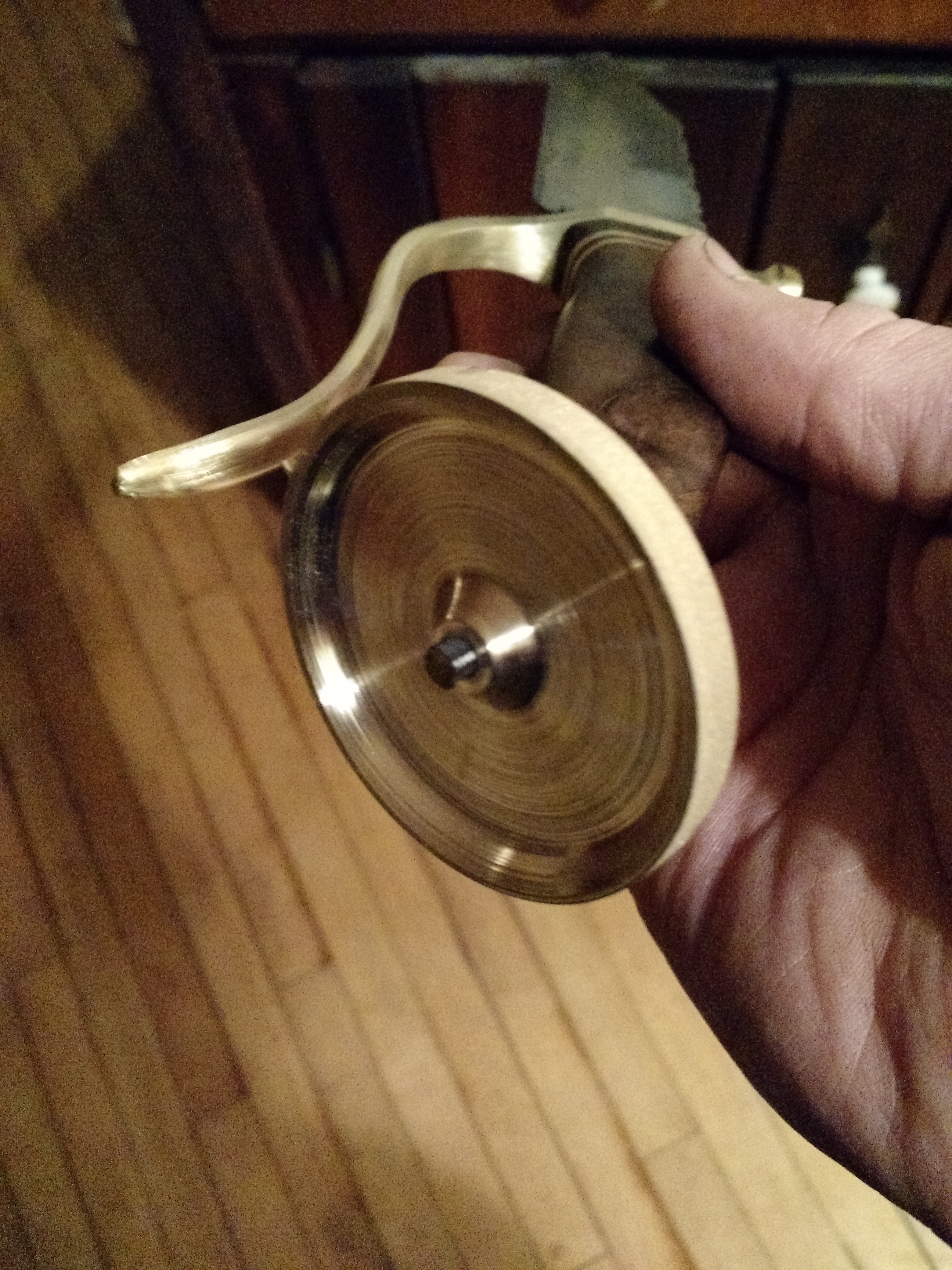

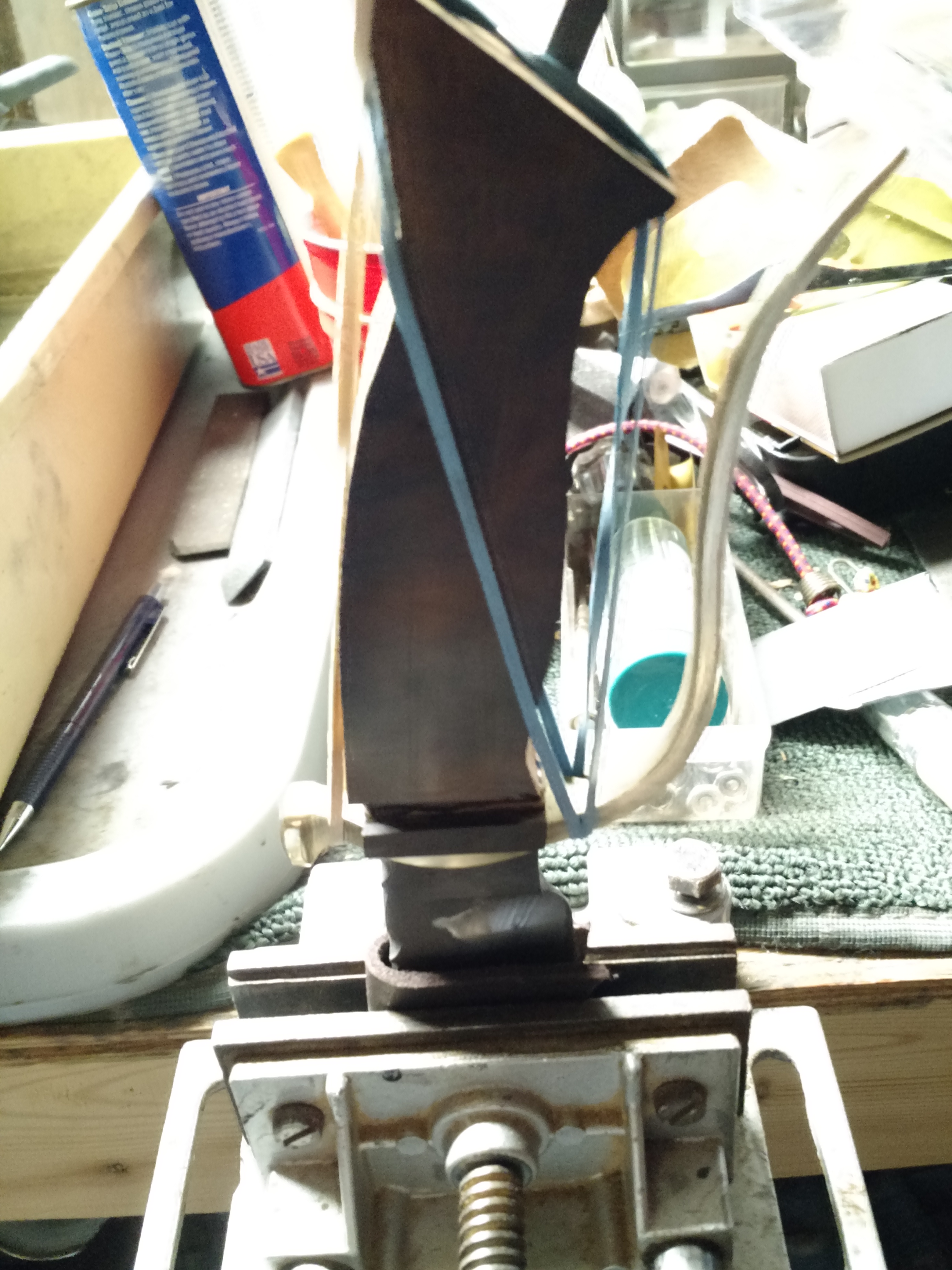

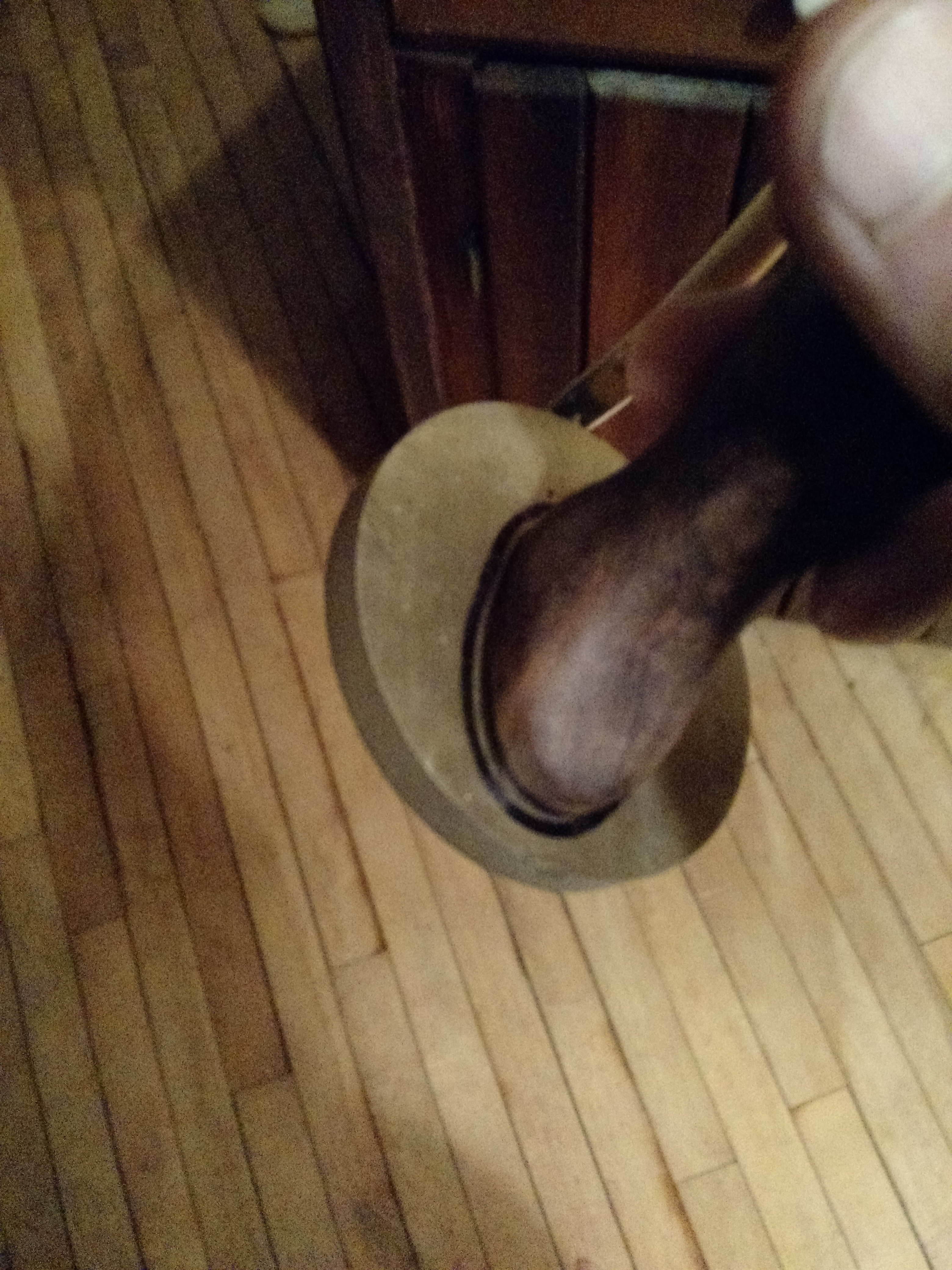

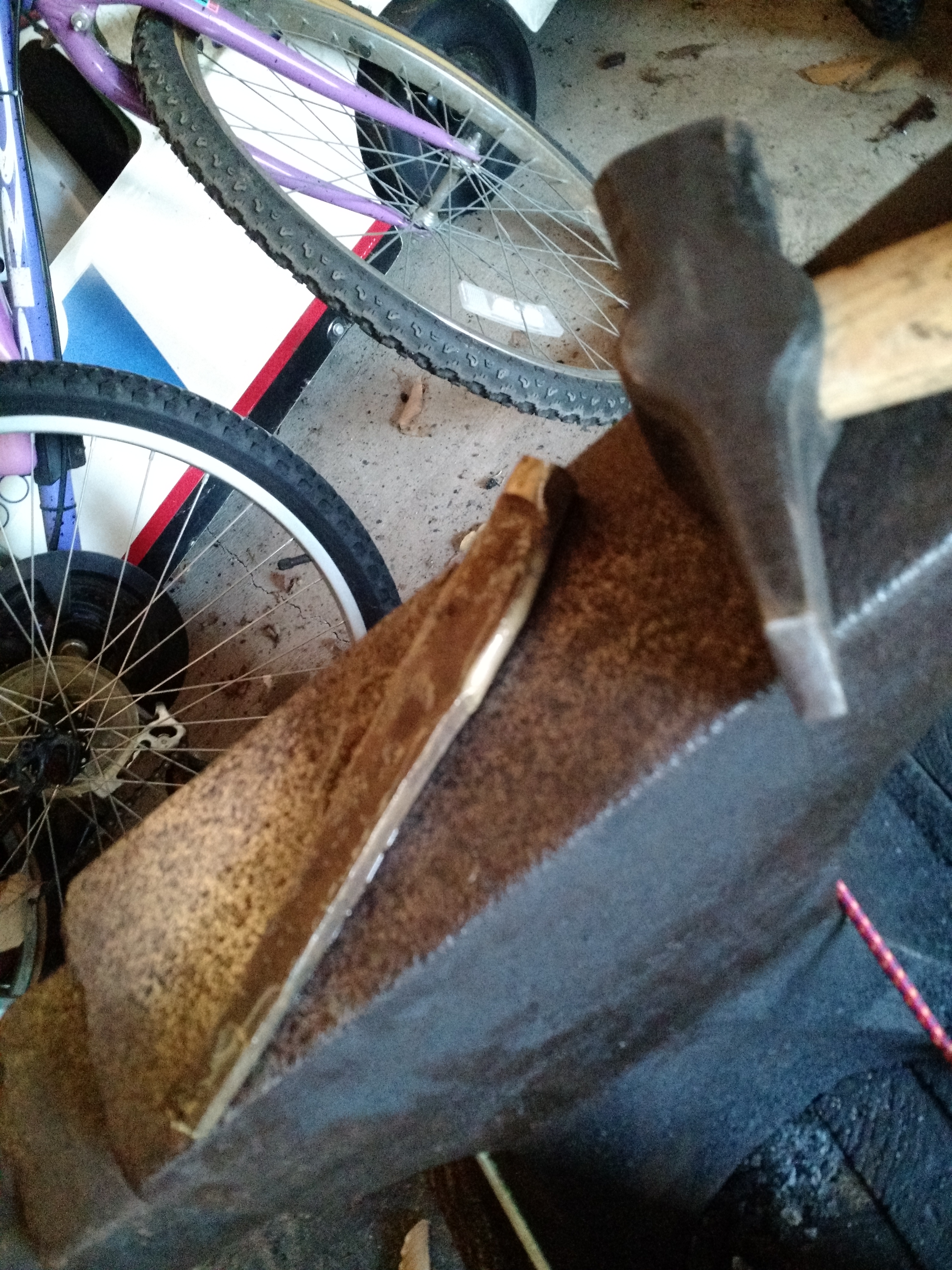

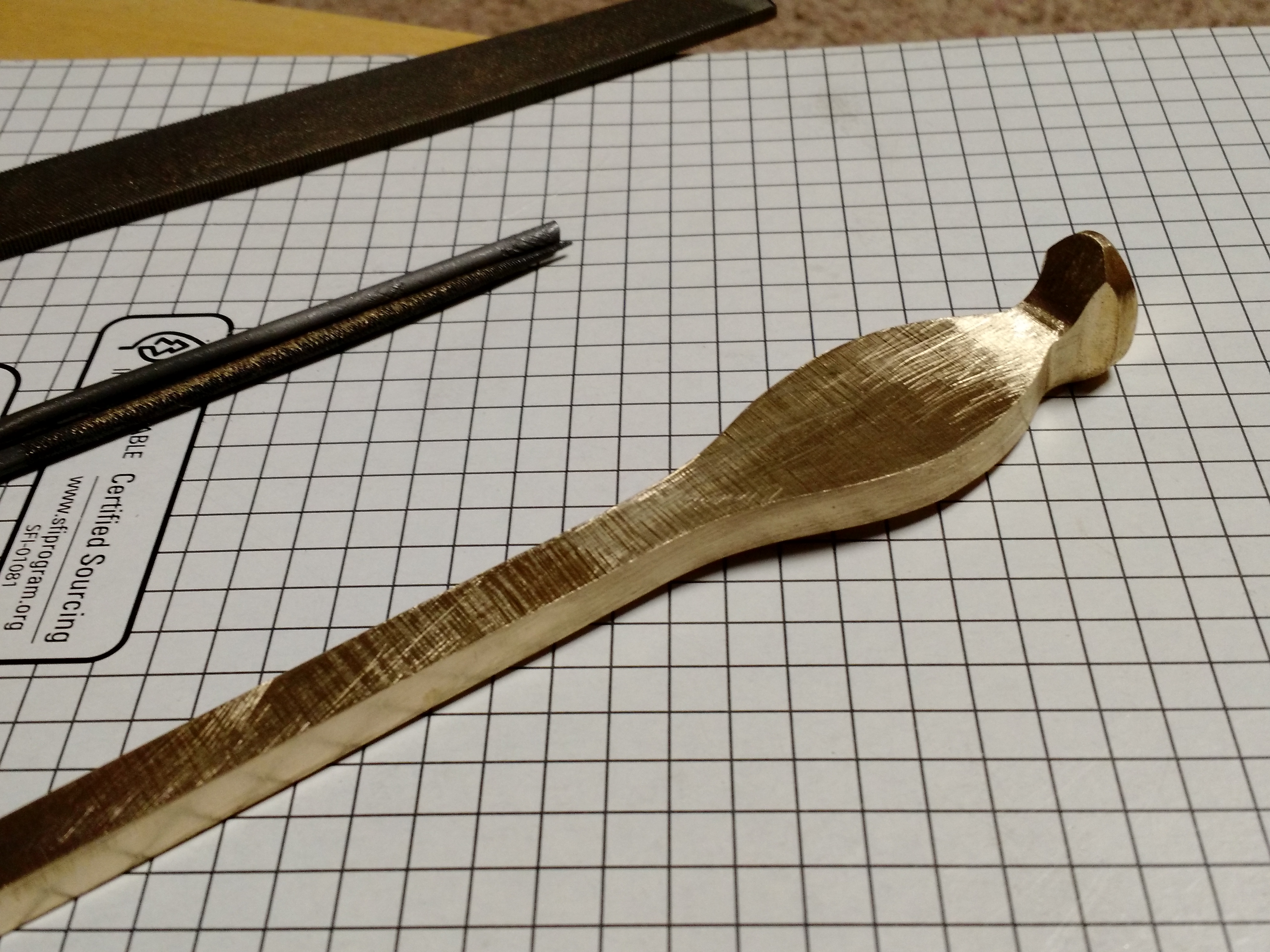

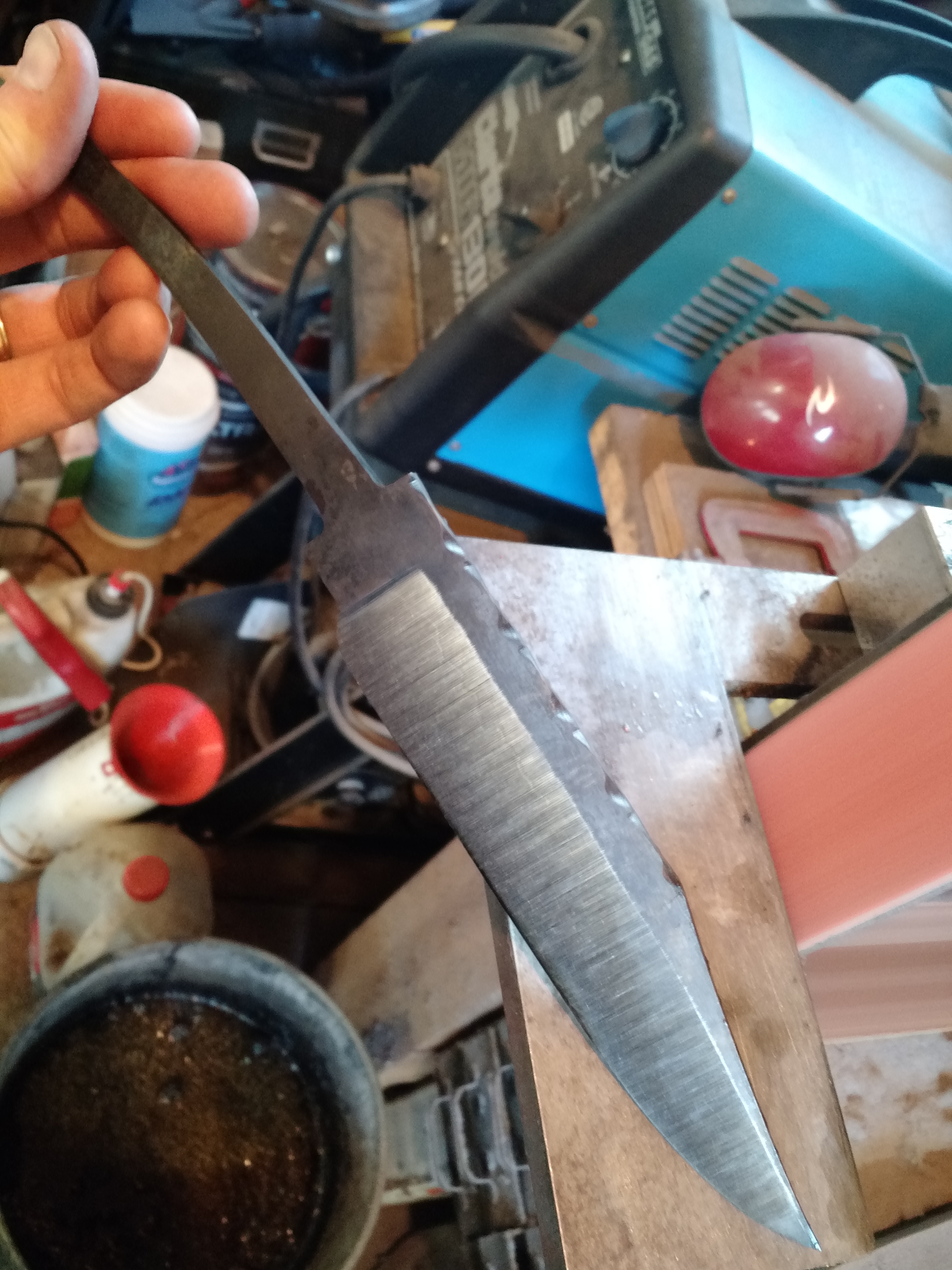

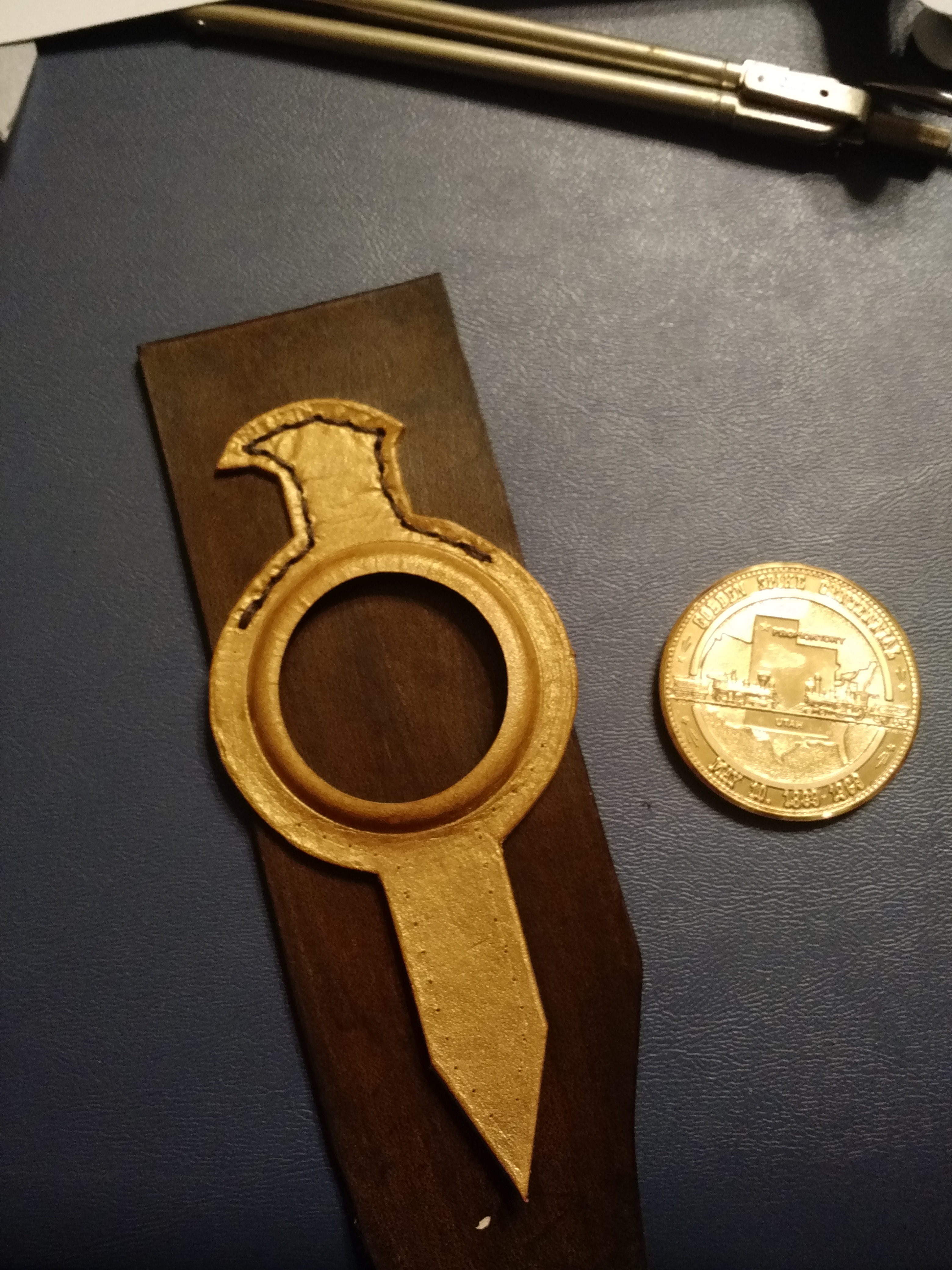

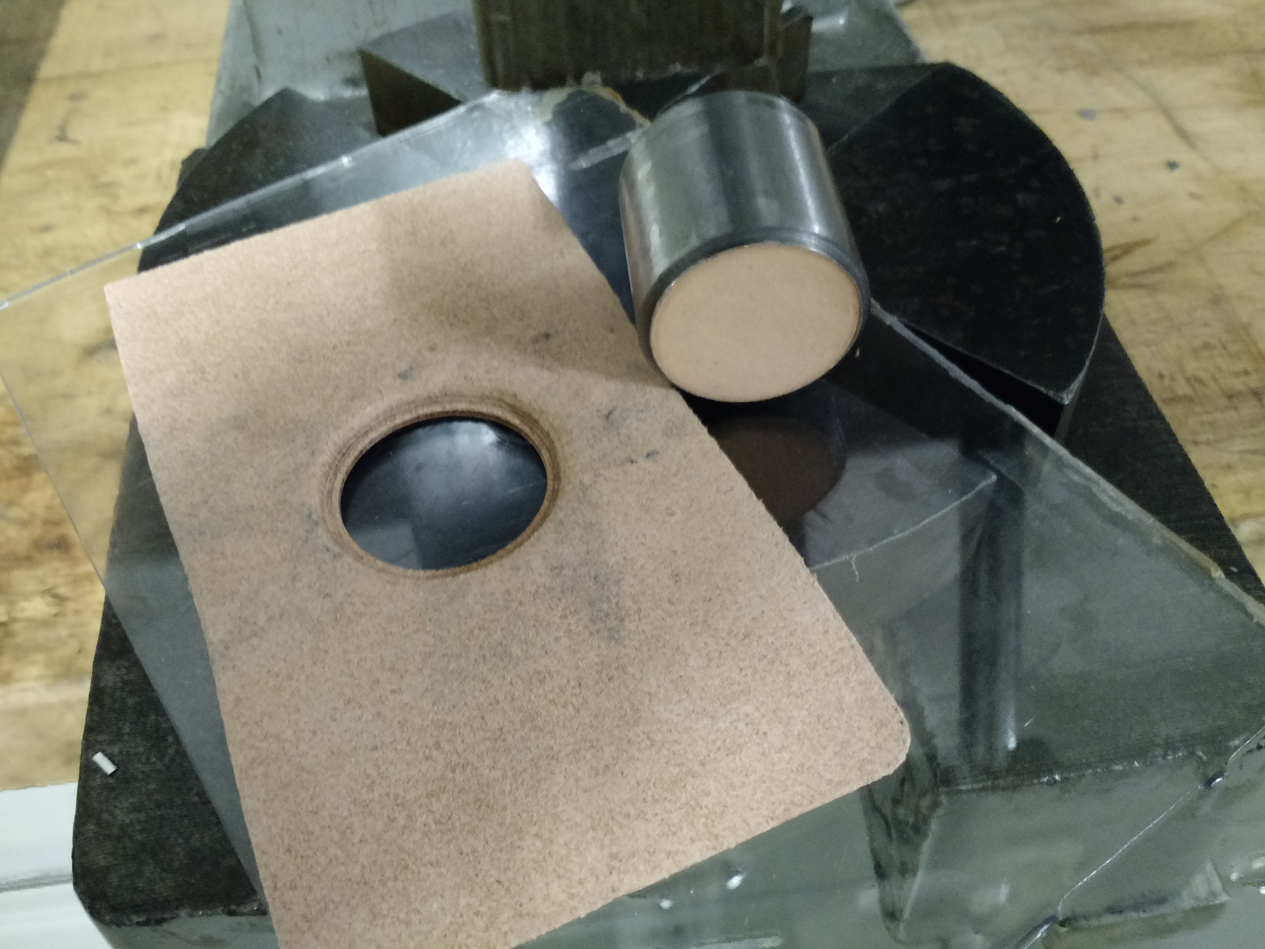

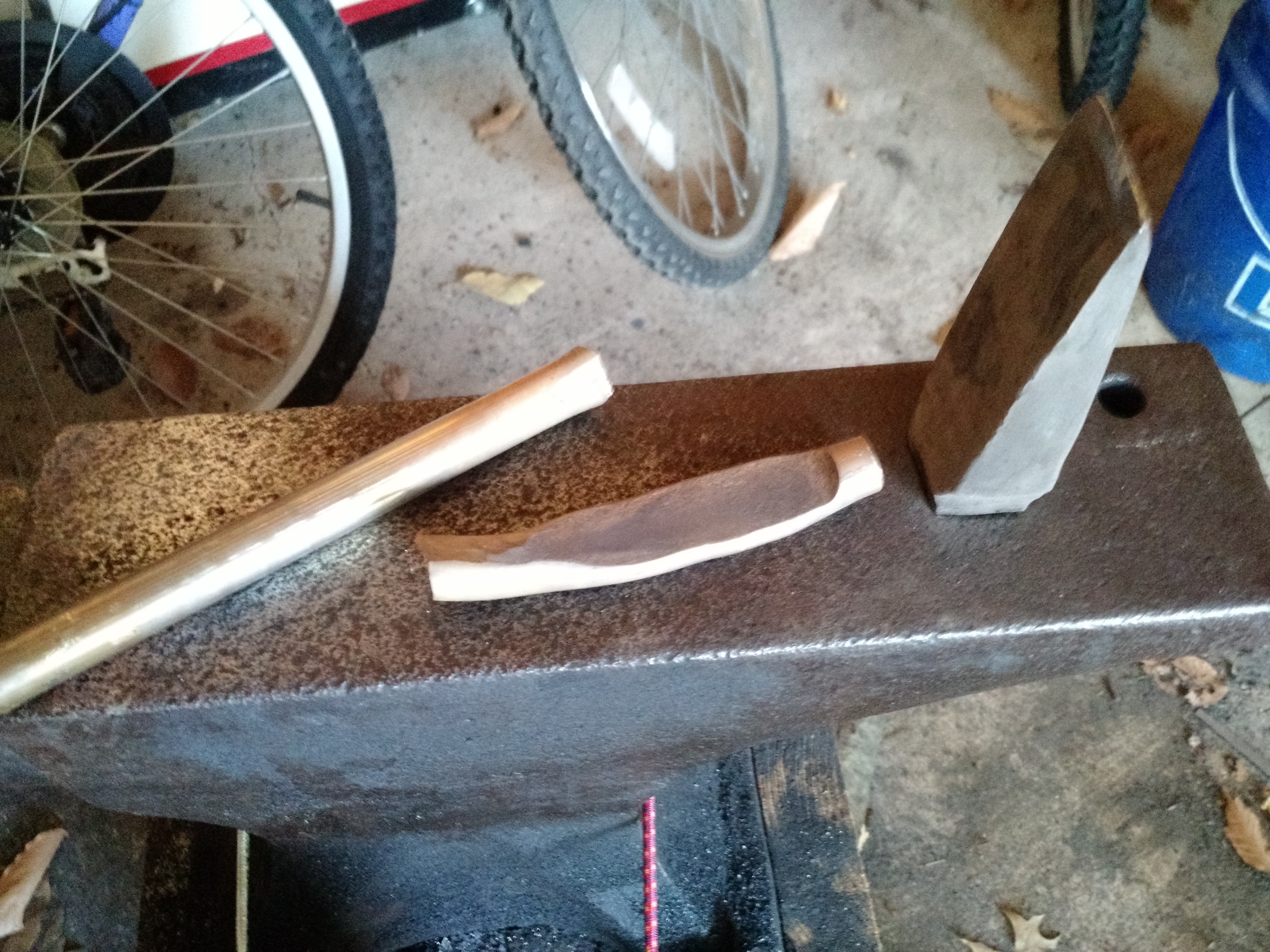

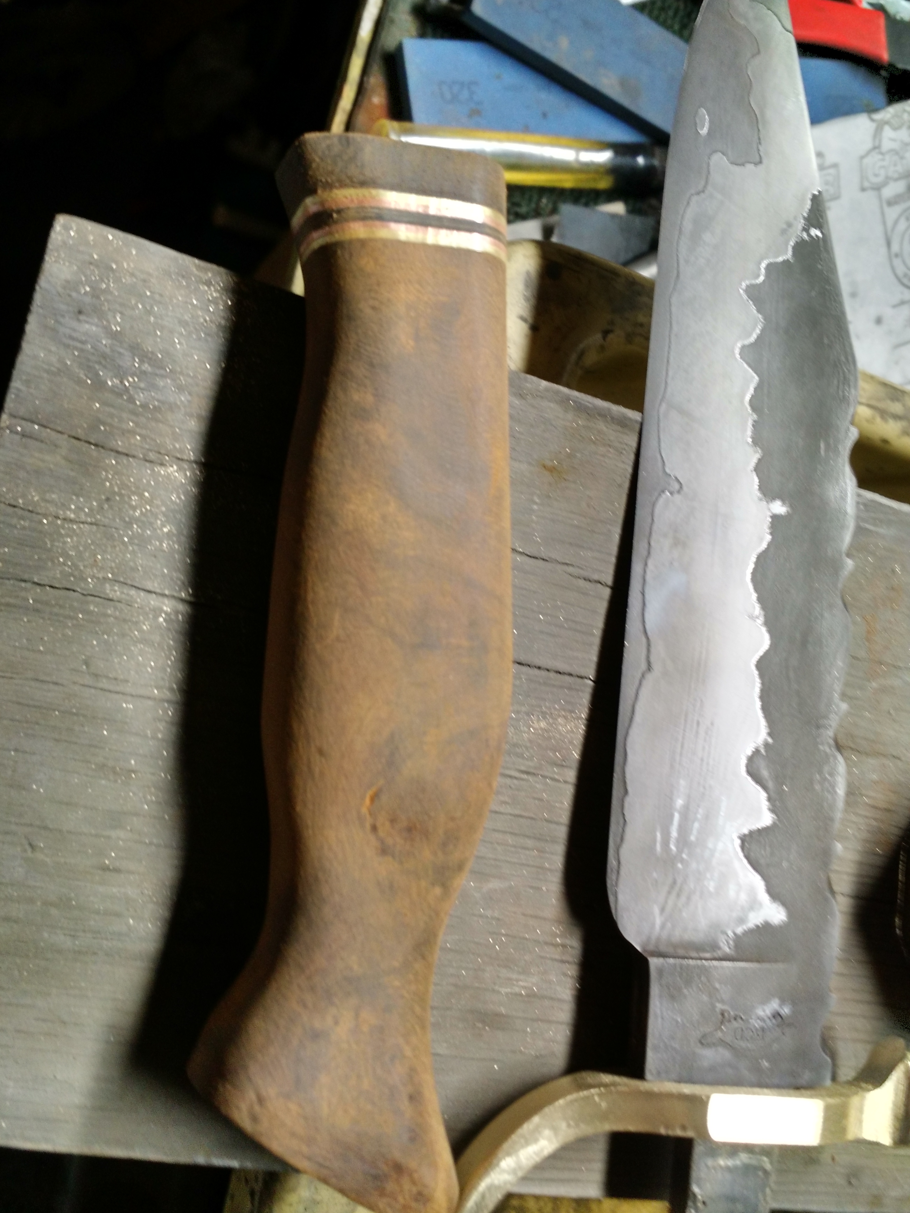

rhitee93 Posted March 9, 2016 Author Share Posted March 9, 2016 Well, most of the WIP pics are of the more boring parts of assembly, but I'll trow up a few if you want. Here are a few of the guard being formed: Here are a few of the handle fitting. Because of the way the handle buts up against the guard at the spine, I had to be able to take the roughly epoxied handle stack off so I could shape it. As a result, the spacers at the guard end are held in place with 1" brass pins in addition to the epoxy. I reverted to my machinist tendencies to make the pommel/peen block. I turned a disk with a raised center and then cut out what I wanted for the knife. To form the pocket for the coin, I machined a die to press the wet leather around the coin, and then a second die to punch out the circular window. Various other bits. Quote Link to comment Share on other sites More sharing options...
