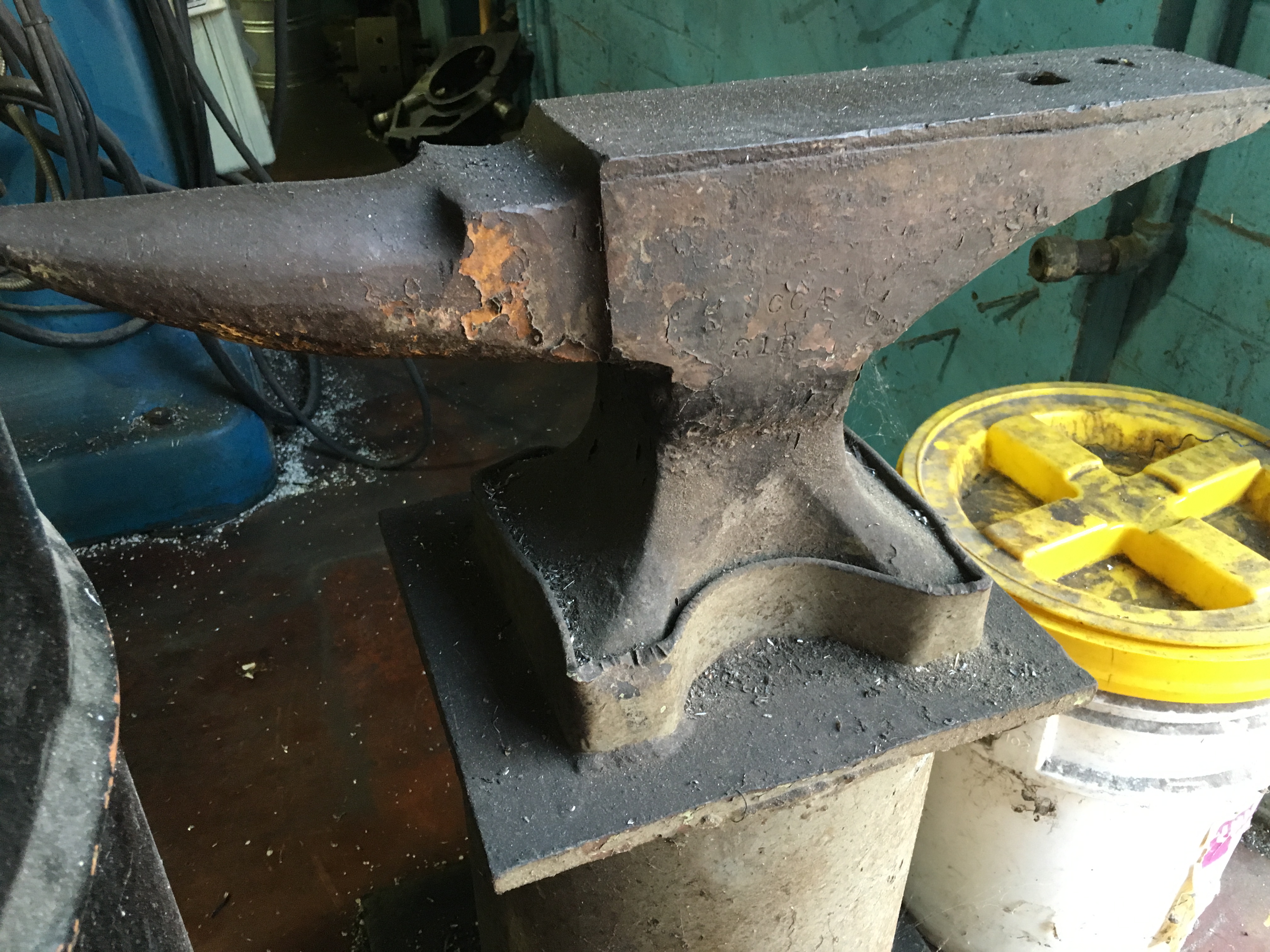

  3. There is a logo or something cast into the other side of the anvil, but I wasn't able to take a picture... I'll try to get one tomorrow morning before I leave work.
  4. Hey guys, saw this little guy in the machine shop at work this morning... Maybe 75-100 pounds, cast body. Bought new by the plant where I work probably in the past 25-50 years ago. No more than 75 years ago when the plant opened. I can make out CCA with what looks like 21B under it. Any idea on what make it might be? May try to see if they'd let me buy it and take it home...

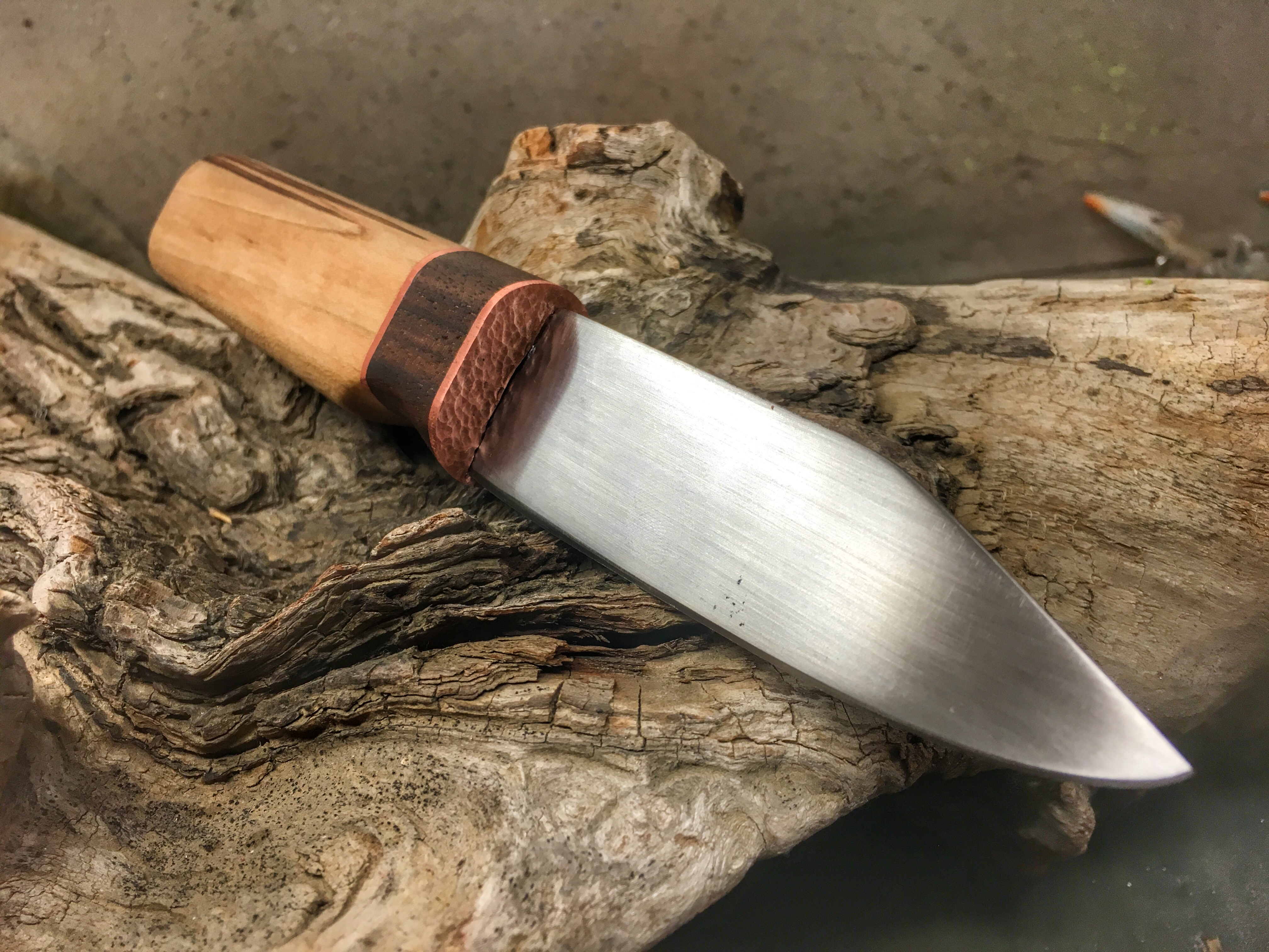

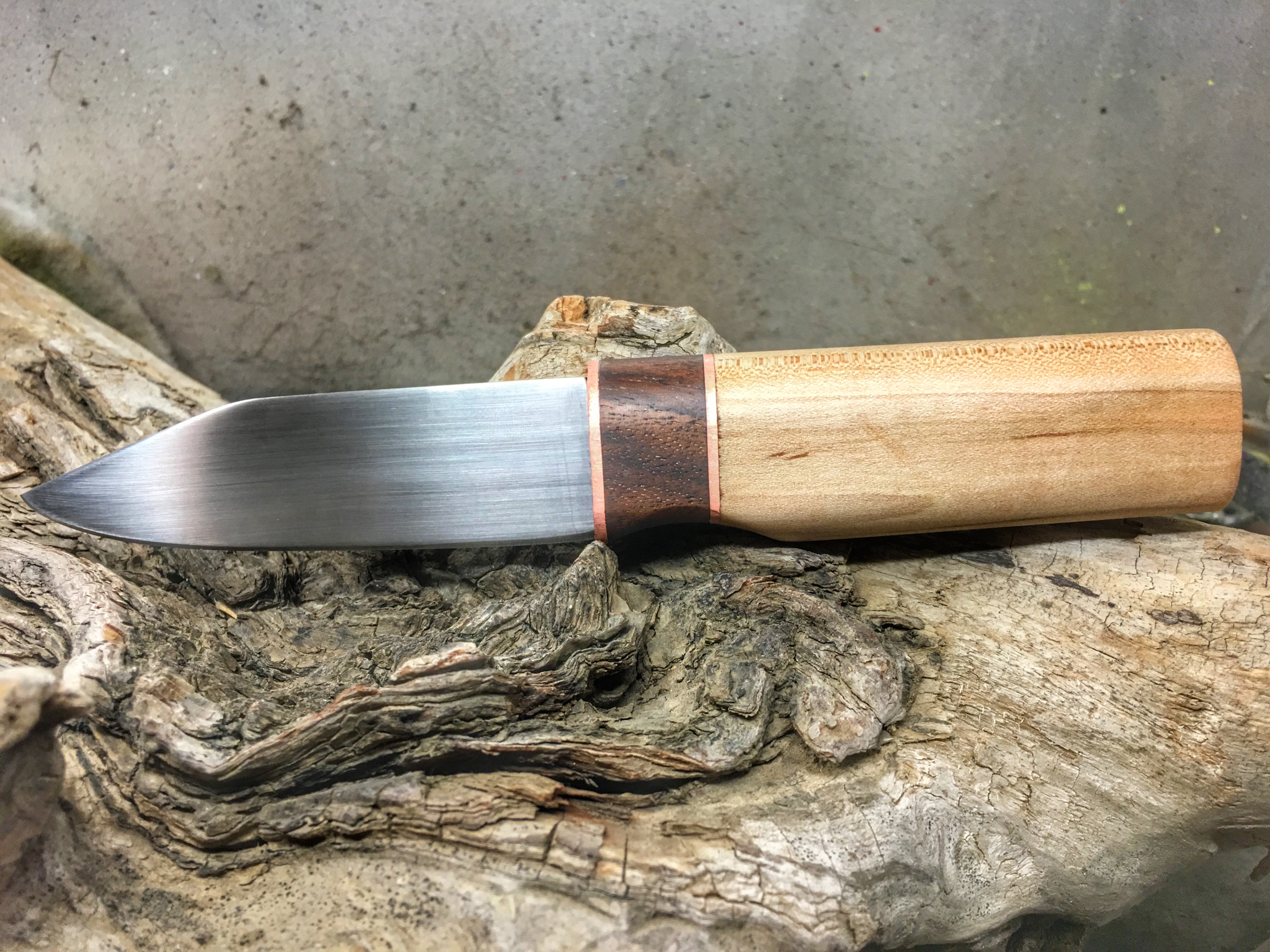

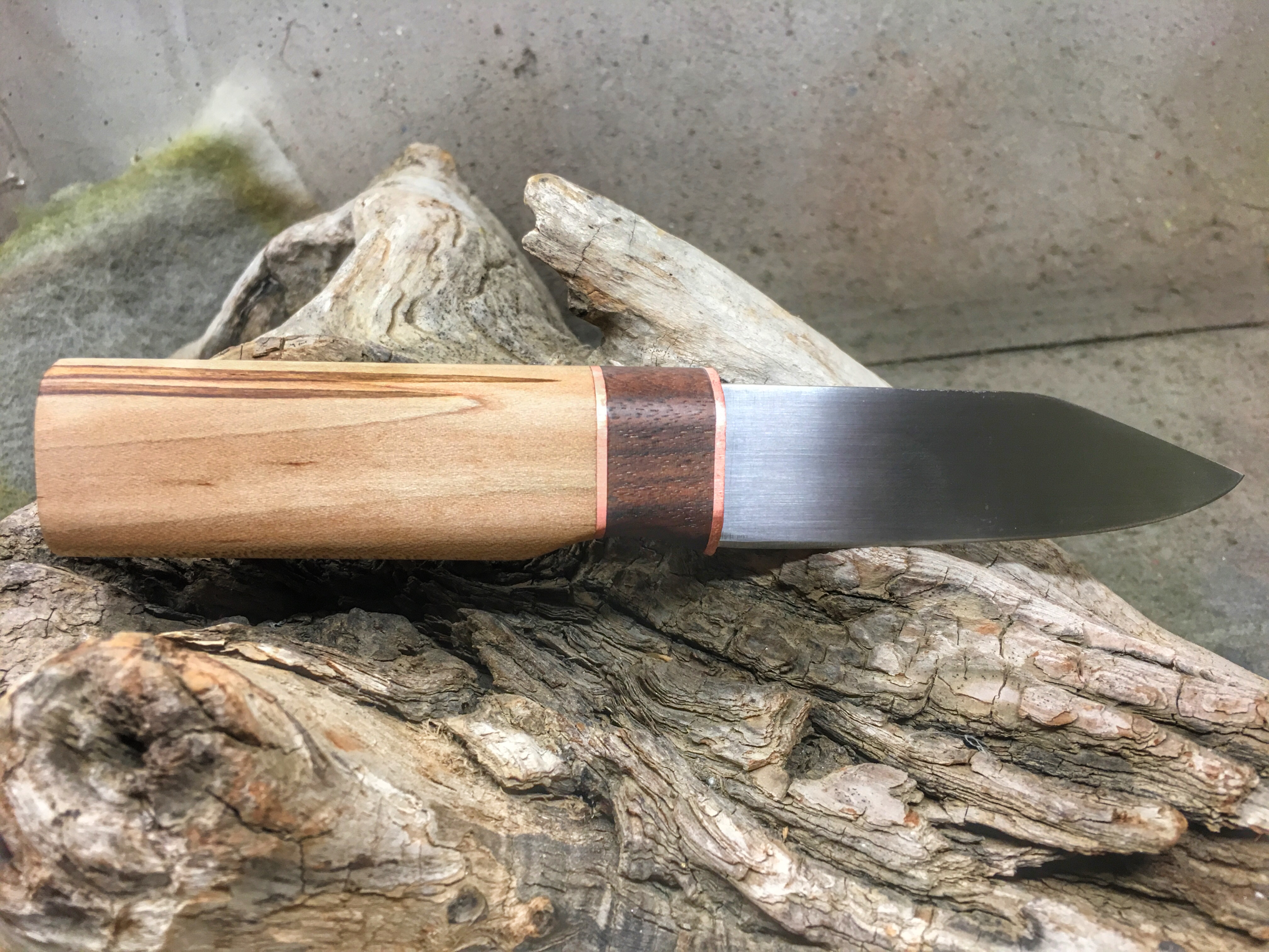

  6. Finished her up today... Decided against a butt cap, as the wood had a nice dark streak in it that gives the maple some extra flair IMO... I I know it isn't perfect, but it's the first knife I've finished with a handle (my first was a "blacksmith knife" and the second didn't survive heat treatment) and I'm proud of it. I'm sure in time I'll look back and wonder why I would show it to you guys, but I think I may have worked my way through at least a small portion of the learning curve with this project. I would like to add that I have never done any woodworking in my life, and ironically, I think the handle turned out better than the blade did almost lol

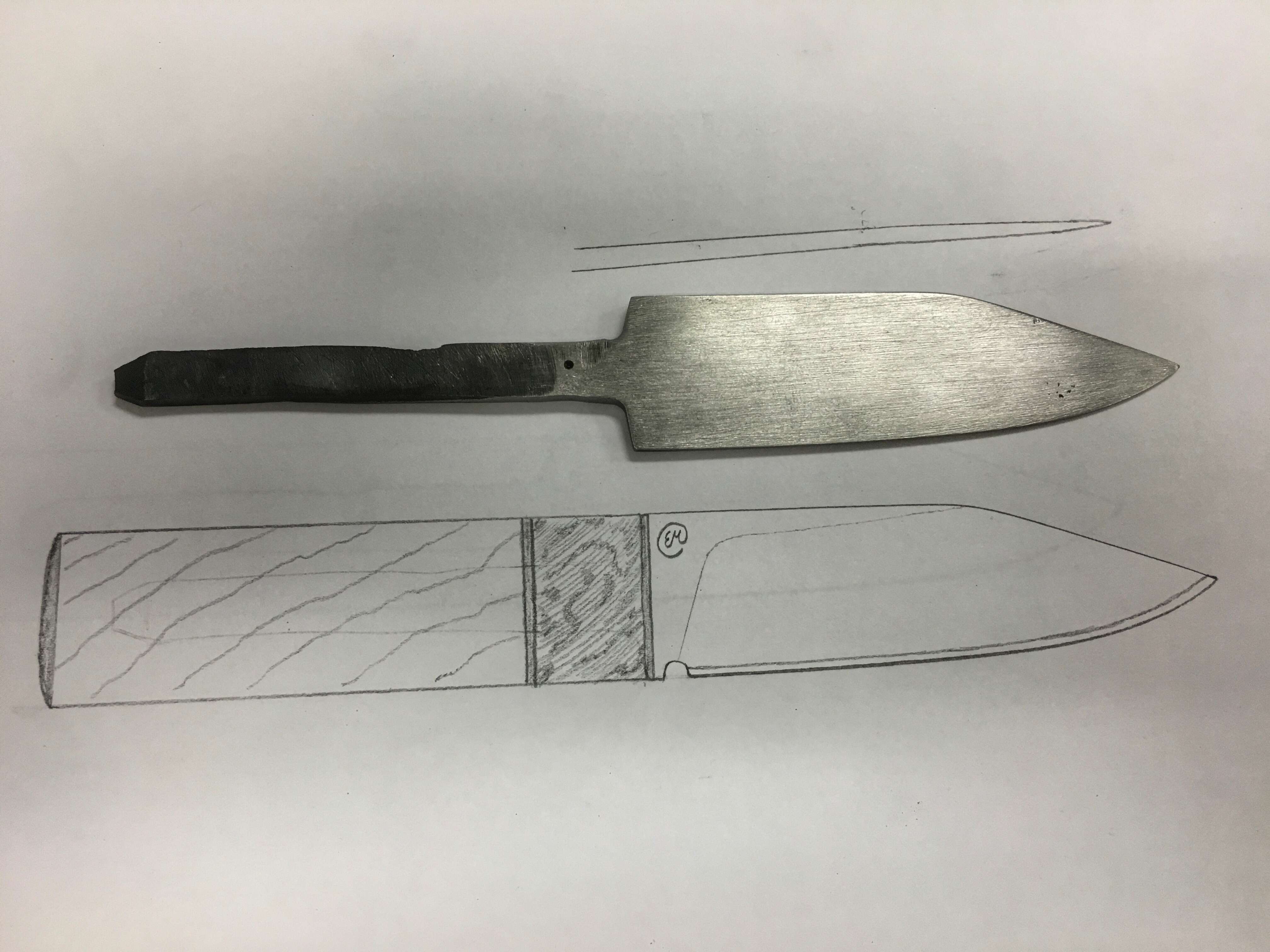

  8. Decided to not go the wild cherry route... Got some walnut and maple for another project, and thought I'd use a bit of both of them... I've attached a pic of the blade draw-filed before heat treatment, and with a concept sketch of what I was going for. I have decided to not have a plunge line or choil. I figured a full flat grind will give me more of the look in wanting with this piece.
