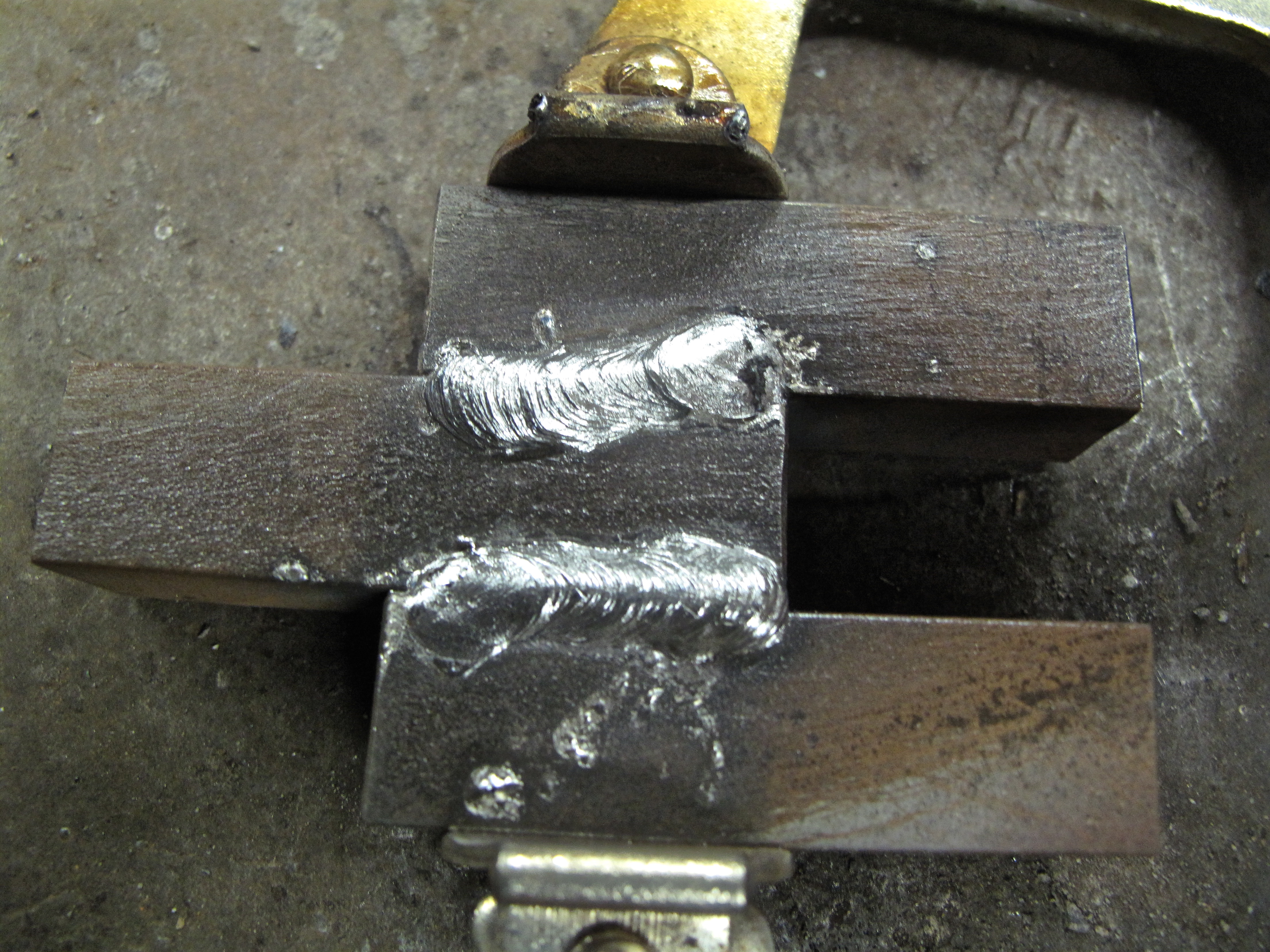

VaughnT Posted February 12, 2016 Share Posted February 12, 2016 Since I'm banned from posting any more in my other thread.... I checked my rods again and they're rated for 120-145 amps +-. 1/8" 7014 from Tractor Supply because it was cheaper than the 7018 they had and I couldn't figure there'd be any difference between the two. Switching my machine over to run electrode positive made all the difference in the world. I never would have thought it would be a thing, especially since the stinking rod company said their rods were good for either polarity. Why say that if it's not true? Anyhow, I turned the arc force knob down to 2 because that was mentioned in the pdf linked in the other thread. I have no idea if this made a big difference in anything, but it sure didn't seem to hurt anything. My first run.... Looks like the first beads were undercutting the vertical coupon. Not sure exactly, but then I'm more of a grinder than a welder. Right now I'm only good for welding a few inches before the shakes set in and I loose sight of things in all the smoke and such. Bad eyes certainly don't help. So, I ran l-to-r and r-to-l, meeting in the middle. Here we can see just how bad I get. I'm still in the warm-up phase, but trying to see where I'm going is a bear. Instead of a straight drag, I have to do a zigzag so the light from the arc gives me a little illumination... and it's still not the high-beams I'd prefer! Any idea what caused the explosion at the end of the bead? I love the look when I'm doing a dragon's fang, but I'd really like to be able to do it on-demand rather than just having it happen. This is the only instance in all the rods I burned and I didn't catch notice of anything odd when I pulled away. After three layers of beads, I decided to call it quits and do some forging. All told, I'm very happy with how I ended things. I still need to work on my starts and stops, and find a way of dealing with the edges of the metal. I like the big ol' thumbprints at the end of my runs. The plan is to keep welding this sucker until it's a chock full of beads. Then I'll flip it over and start welding on the other sides. Between the 7014 and 6013 rods, I think I can weld up just about any project that comes to mind. So, I'll keep welding on this, practicing for a few rods every time I get a few minutes in the shop. Certainly can't say enough about all the help, gents. Never would have known about that arc force thing or trying E+. I should have posted my questions a long time ago and saved myself no end of frustration! Quote Link to comment Share on other sites More sharing options...
arkie Posted February 12, 2016 Share Posted February 12, 2016 Vaughn, you'll find that the more common rods (6010, 6011, 6013, 7014, 7018) run best on DCEP, but the 6011's will run equally well on AC. For lower penetration run the 6013's on DCEN. Drag rods are usually 6013, 7014 and 7018 or maybe run with a very tight arc. Your beads are coming along. The explosion at the end of one bead may have been long arcing. Quote Link to comment Share on other sites More sharing options...
John McPherson Posted February 12, 2016 Share Posted February 12, 2016 Tar and feathers? Check! Torches and pitchforks? Rodger that! Advice warning ahead. Don't take it personally. (1) If you are holding the right arc length, you should not have a bright light, but more of an eclipse effect. A ring of fire peeking out from under the flux. The ends of the finished rods should have a rocket cone effect, with a rounded half ball on the end of the wire inside the cone of flux. If not, you are most likely long arcing. If your bead gets wider at the end, definitely long arcing. (2) Try not to leave that "thumbprint" at the end of a bead, instead do a little swirl like you are topping off a soft serve ice cream cone. Those craters will lead to crater cracks, which can spread along the weld bead and base metal. (3) Run the rod right at the edge of the previous bead (called the toe), so that half of the bead washes on the face of the previous bead, and half washes onto the base metal. This makes your welds overlap like shingles on a roof, giving you a flatter and stronger weld. Quote Link to comment Share on other sites More sharing options...

VaughnT Posted February 13, 2016 Author Share Posted February 13, 2016 42 minutes ago, John McPherson said: Tar and feathers? Check! Torches and pitchforks? Rodger that! Advice warning ahead. Don't take it personally. (1) If you are holding the right arc length, you should not have a bright light, but more of an eclipse effect. A ring of fire peeking out from under the flux. The ends of the finished rods should have a rocket cone effect, with a rounded half ball on the end of the wire inside the cone of flux. If not, you are most likely long arcing. If your bead gets wider at the end, definitely long arcing. (2) Try not to leave that "thumbprint" at the end of a bead, instead do a little swirl like you are topping off a soft serve ice cream cone. Those craters will lead to crater cracks, which can spread along the weld bead and base metal. (3) Run the rod right at the edge of the previous bead (called the toe), so that half of the bead washes on the face of the previous bead, and half washes onto the base metal. This makes your welds overlap like shingles on a roof, giving you a flatter and stronger weld. John, I'm always up for advice so don't hold back. My skin's thick enough and I appreciate a good critique. 1) Arc length seems to be one of those things that experienced welders know, but you can't get it across in a video or text. I did what I did, but I couldn't tell you if my arc length was good, bad, mediocre, or a combination of all three. Aggravating stuff! From what I recall, I was trying to keep the fingernail of flux just lightly scraping the steel as I dragged the rod along. This fingernail kept catching on the uneven surface of the previous beads, but does that mean I was short-arcing and too close for that application? Does that mean I need to turn up my "arc force" setting to get more oomph? Or do you just need to hold the end of the rod farther away so you're not using that fingernail of flux as your guide? 2) I'd love to not leave those thumbprints. I think they look neat, but I'm going for that perfect stack of dimes. I'll try swirling next time I run a rod. 3) Please feel free to have a conversation with my welding rods. I tried my dangedest to get them to run right at the edge of the previous bead, but they just flat refuse. I have a self-darkening helmet and will play with the settings to see if I can get it set in a way that helps my eyes. My eyes have a hard time focusing through multiple layers of glass and such, so I need to weld without my spectacles (or look over the top of them) while trying to keep the bead in that sweet spot where things are visible. Quote Link to comment Share on other sites More sharing options...

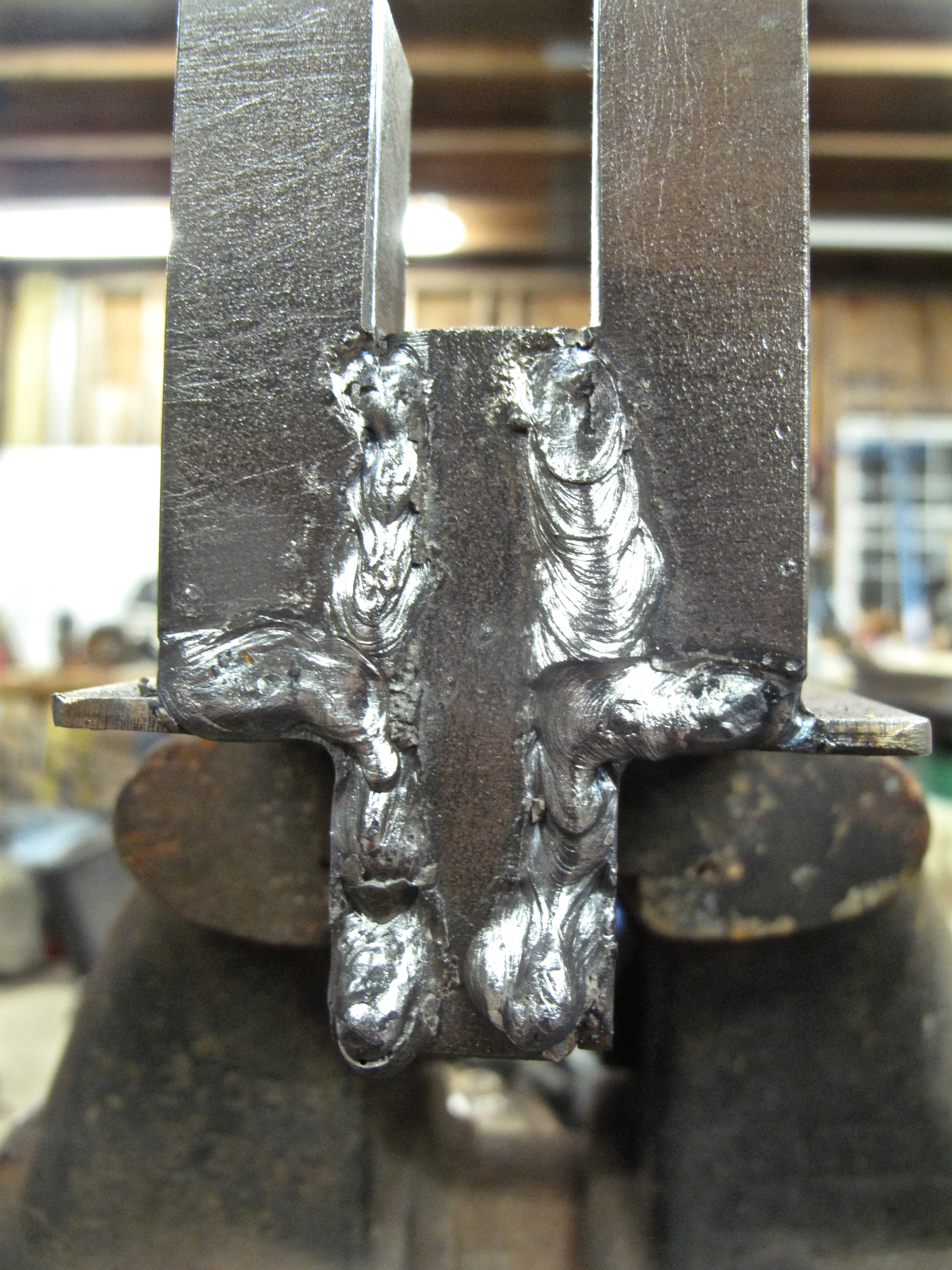

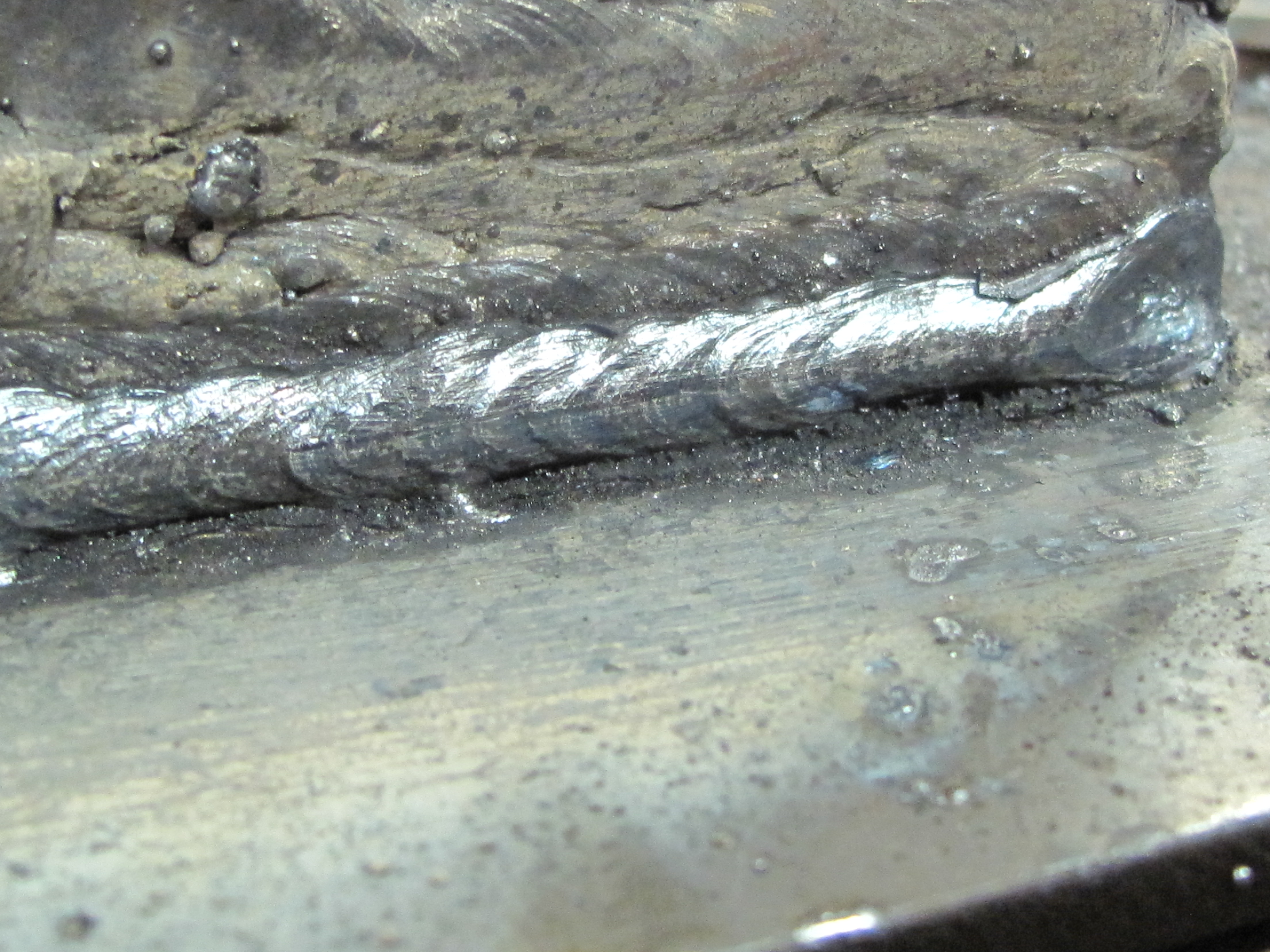

VaughnT Posted February 23, 2016 Author Share Posted February 23, 2016 I needed to tack a few pieces in place for a project, so I decided to run a quick warm-up bead. Straight across, with no breaks, and I got a decent looking bead. Seems like I'm getting some undercutting and the slag is hard to get off. Why? This was 1/8" 7014 rod with the machine set to 122 amps and the arc force set at 2. Is the undercutting indicative of going too slow? Why is the scale so hard to remove? Do the air bubbles in the scale point to anything in particular, or is that the nature of the beast? Some times the scale is really thick and has a lot of air bubbles, other times it's really thin and comes off with no problems at all. Sometimes it's both on the same bead. Quote Link to comment Share on other sites More sharing options...
DSW Posted February 23, 2016 Share Posted February 23, 2016 What I see there is failure to tie the bead to the lower plate. It's could be one of two things. #1 you are aiming to "high" and aren't washing the bead down onto the lower piece. #2 you are laying down too much material and the bead is simply building up and rolling over onto cold plate ( cold lap). I'd bet on aiming too high myself. I can't really tell what you are trying to do here. If you are doing a pad with overlapping beads, or a muti pass fillet joint. If you are doing a fillet joint you look to be doing it "backwards" from how I'd do it. It looks like you started high and are working down vs building a "shelf" and stacking each bead on top of the last "row". What you are calling "scale" is actually slag. Bubbles in slag can come from several reasons. One being impurities, dirt etc on the piece, another being the fact you may be holding the rod excessively far from the piece causing a long arc. I tried before to reply on your comment about being able to see well, but the disappearing post issue wouldn't let me. Light coming in from behind your hood often can cause reflections on the glass inside making it hard to see. Some times it can help to cover the back of the hood with a flap or something to block the light. Different hoods block light better or worse. I know a number of guys who have bought a cheap HF leather apron and cut it up to cover the back of their hood. At some point I'll probably do mine as well. Additional lighting can also help. I often suggest to students they buy a cheap reflector spot light with a clamp and bring it with them to class. The lighting in the schools weld shop sucks. In many booths you either end up with light from the new overheads in the back of your hood causing reflections, or the dim lights in the booth make a lot of shadows that make it very hard to see. Pointing a good bright light where you need it can be a huge help. Quote Link to comment Share on other sites More sharing options...
VaughnT Posted February 24, 2016 Author Share Posted February 24, 2016 DSW, that picture is actually inverted so I could get a good shot without a lot of glare. When I was welding, the bead was flat on the table. I might try weldling across a vertical coupon in a couple months when I get halfway decent, but right now everything is done flat. The goal is to practice on this bit of homemade angle until I fill it up. Jody on weldingtipsandtricks.com mentioned padding beads for practice, and it sounded like an easy thing, so..... Slag! I keep thinking of the scale piling up around my anvil. Glare off the inside of my hood is a problem. I'm thinking about hot gluing a bandanna over the hood to fix that. Or I could use some scrap leather I have. That'd be hot, but it wouldn't burn through or snag like a bandanna will. And I need to get a small fan to blow the smoke away. Question--->> On my machine there doesn't seem to be any way to adjust the volts. Is that normal? Jody talks about it like it's something to factor into the equation, but I can't figure out how to move the number. When it was set for 125 amps, the volts were automatically set to 77.3 and flickered up as high as 77.5. Is that just how this machine is designed or am I missing something? Quote Link to comment Share on other sites More sharing options...
John McPherson Posted February 24, 2016 Share Posted February 24, 2016 While SMAW (MMA for you Brits) or stick welding, there are two levels of voltage. It order to get a hot start and not 'stick' the rod to the work, there is a high open circuit voltage, typically between 60 and 100 volts. Then, after you strike an arc and start to weld, the arc gap distance between the tip of the rod and the work determines your working voltage. The closer you can hold the arc, the lower the voltage, and more stable the arc. Plus, the puddle is cooler and less agitated. Counter-intuitive, I know. Quote Link to comment Share on other sites More sharing options...

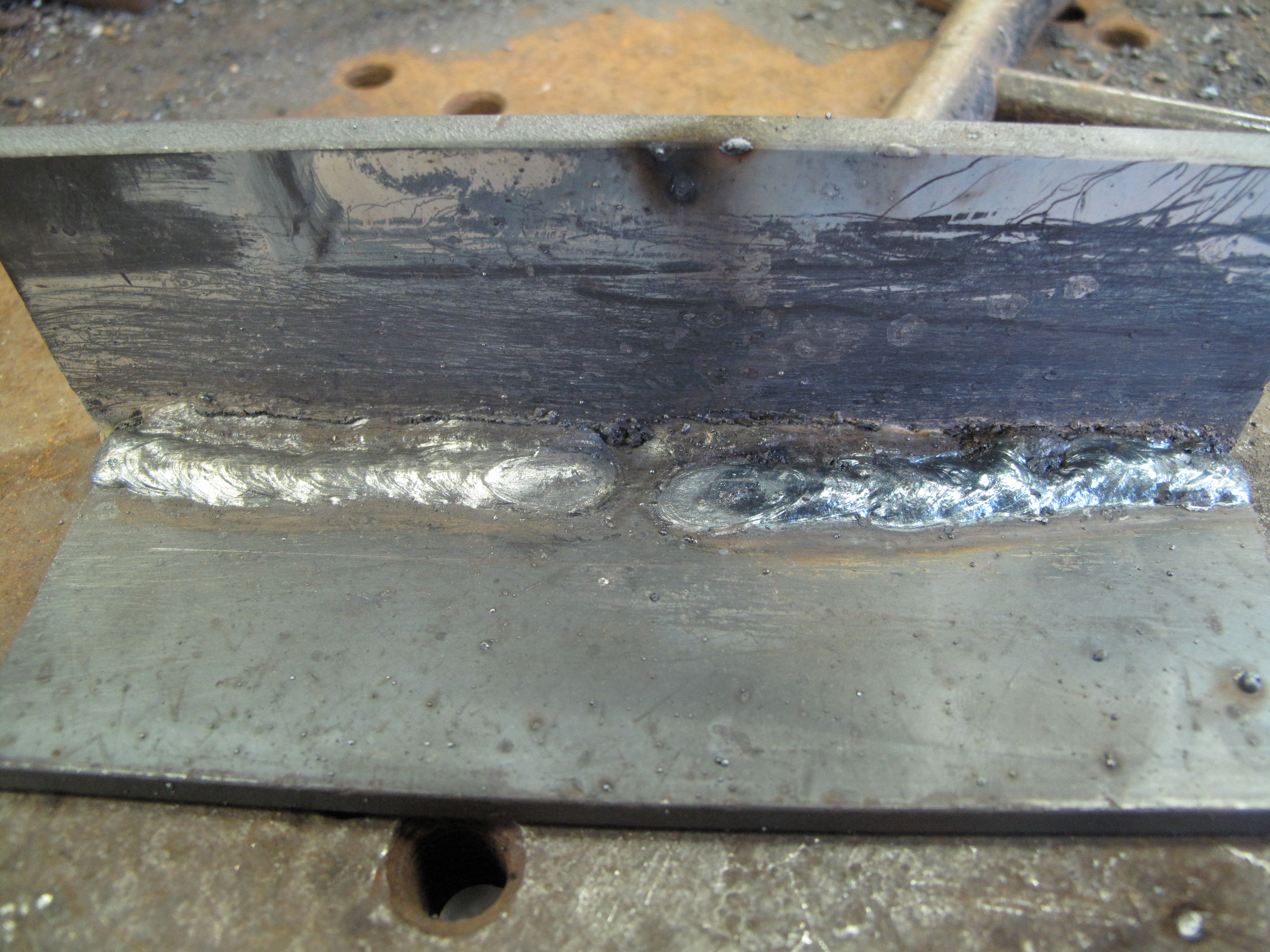

VaughnT Posted March 8, 2016 Author Share Posted March 8, 2016 Still having trouble with those blasted fingerprints. No idea what's causing them so I can't really be proactive to prevent them. 7014 1/8" rod, 125 amps. Any lower on the amps and I stick the rod a lot on the start. Even at only 125 amps, I'm burning really deep into the metal, ruining the corners. It seems like I'm going too fast, but the ripples look decent and the beads aren't too wide. On this little job, I didn't do any zigzagging of the rod, just a straight drag with minimal angling of the rod. Quote Link to comment Share on other sites More sharing options...
John McPherson Posted March 8, 2016 Share Posted March 8, 2016 Don't be too hard on yourself, it looks pretty darn good. Gouging into the base metal under the bead is your depth of fusion: if there is no gouge and fill, you are glueing, soldering or brazing, not welding. If a perfect bead from edge to edge is required*, then you can always add a sacrificial run-on and run-off tab at either end, and then grind them off when done. *By the client, or by your own OCD. Quote Link to comment Share on other sites More sharing options...

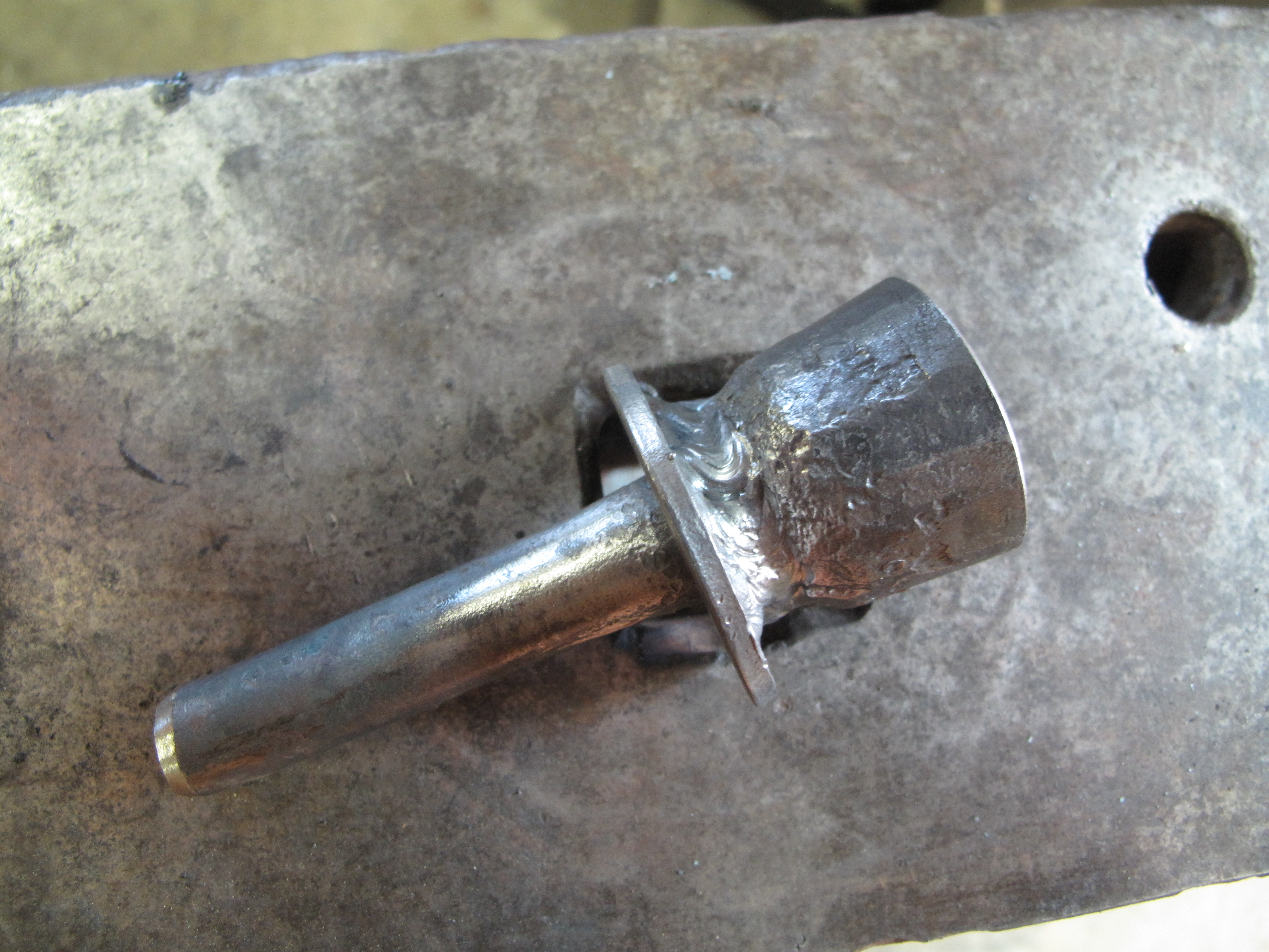

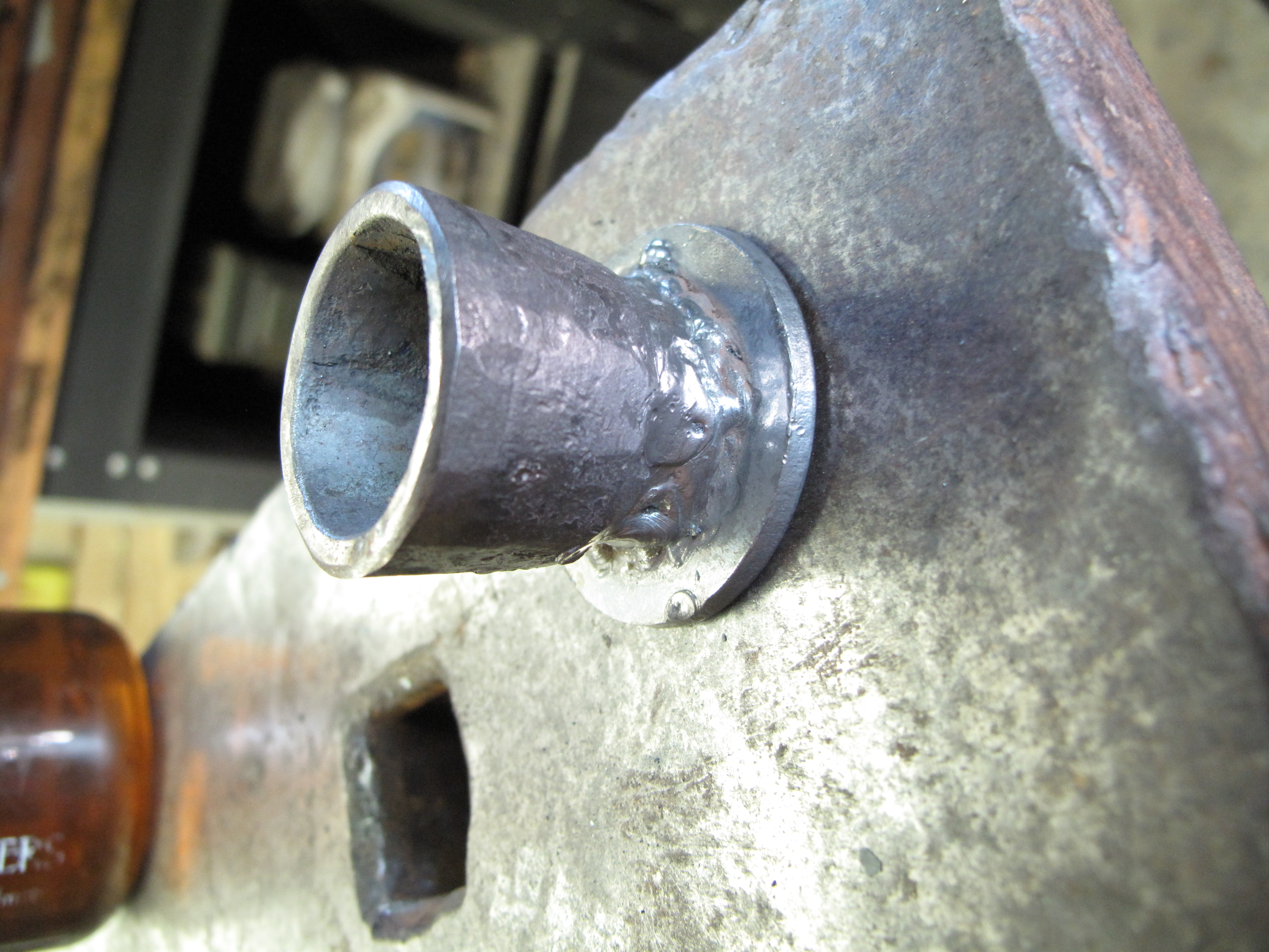

VaughnT Posted June 26, 2016 Author Share Posted June 26, 2016 My latest attempt at welding ---- 1/8 7014 @ 110 amps. Two passes were needed since the first barely got into the tight corner formed between the washer and tire iron. The second pass looks halfway decent for about a third of the way, then turns into bubblegum just to make sure everyone knows I'm not a welder. I had everything clamped up in the bench vice to hold it, but I can't seem to figure out how to make my body bend around as I'm trying to lay down the bead. It starts off decently, but the rod angle changes real quick because I forget to bend my wrist or elbow at the right speed...... Still, it's all solidly together and will get the job done. I don't know that I'll ever use the little dishing cup, but it was fun to build. Quote Link to comment Share on other sites More sharing options...
Charles R. Stevens Posted June 26, 2016 Share Posted June 26, 2016 A friend of mine passed on some advice from his grandfather, they are both special process weldors. "The difference between a good weld and a bad weld is a grinder" it's one of those multi faceted things, regarding weld prep, between pass cleanup and finish. Not to say that both theise characters don't lay down stick welds that look as good as my gas welds! I find that some times in a tight undercut instead of sweeping back and forth (or circling) pushing and pulling just a bit will get a bit cleaner base pass right in the corner that you can then clean up and lay a bead down that incorporates the two peices and the weld. Some times that transition will cause us backyard welders fits. I second the use of a helmet cover (even a clean shop rag) and a light. And don't forget to replace the lense cover! Spatter and smoke will make it hard to see your work Quote Link to comment Share on other sites More sharing options...

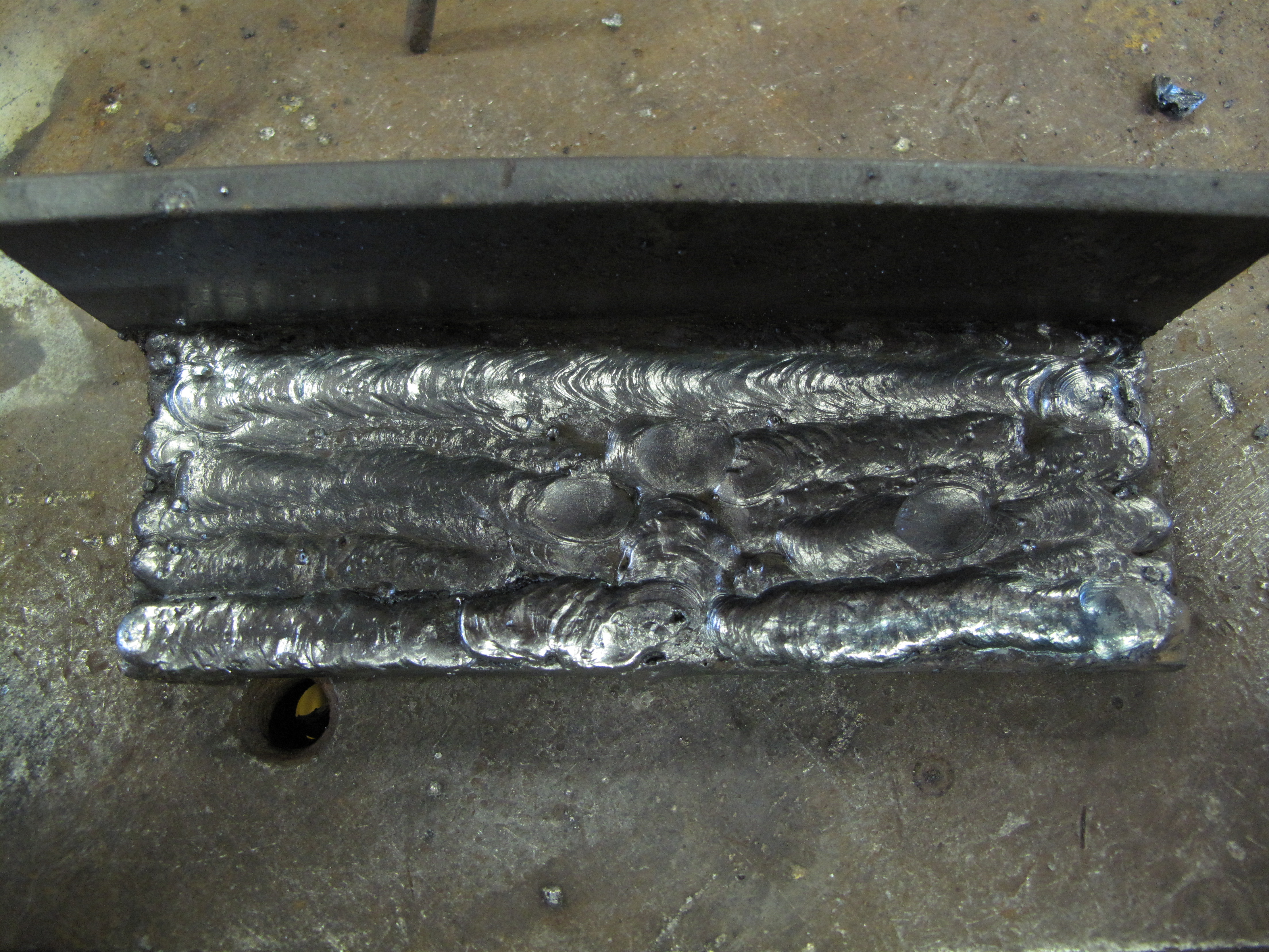

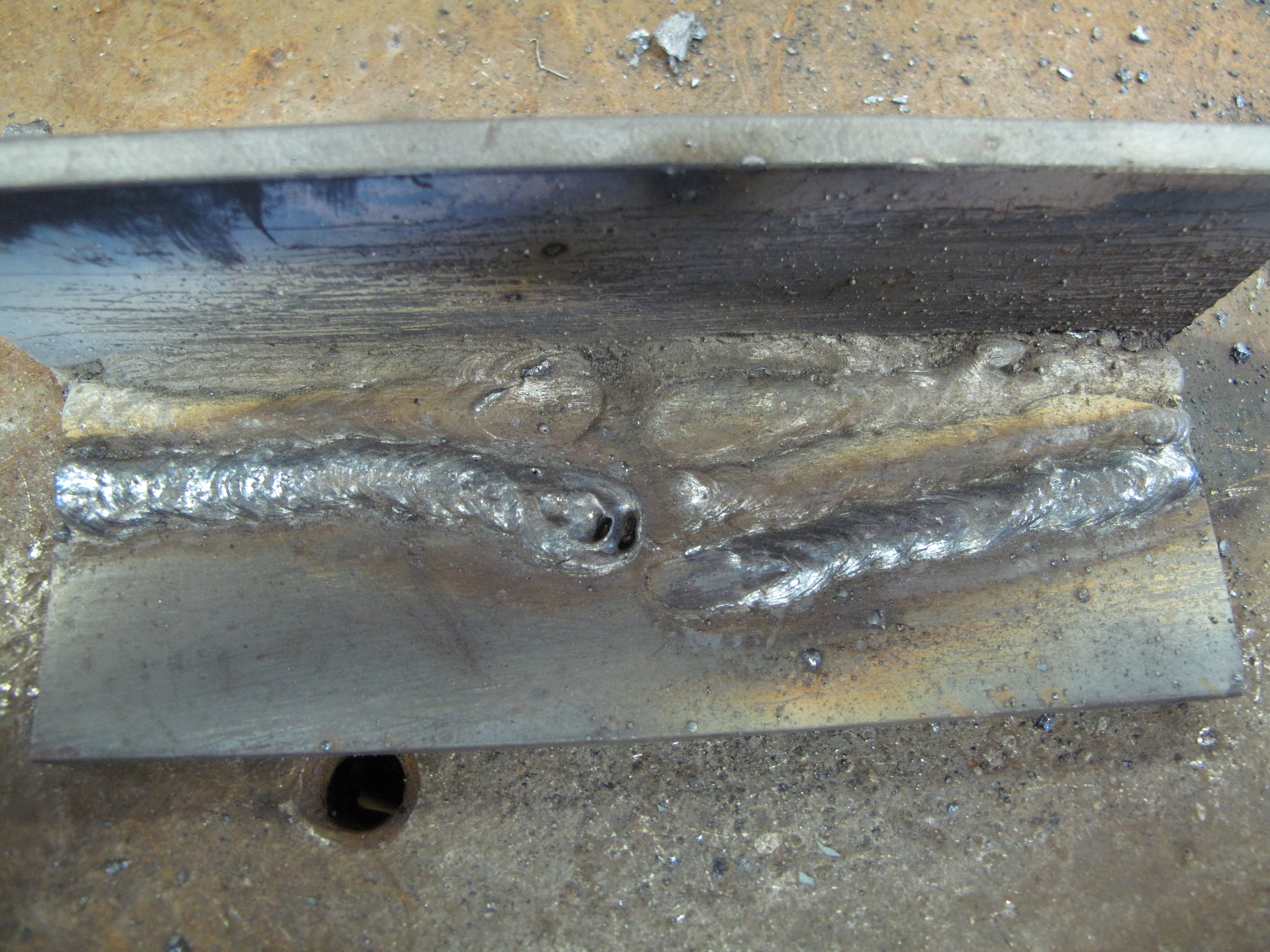

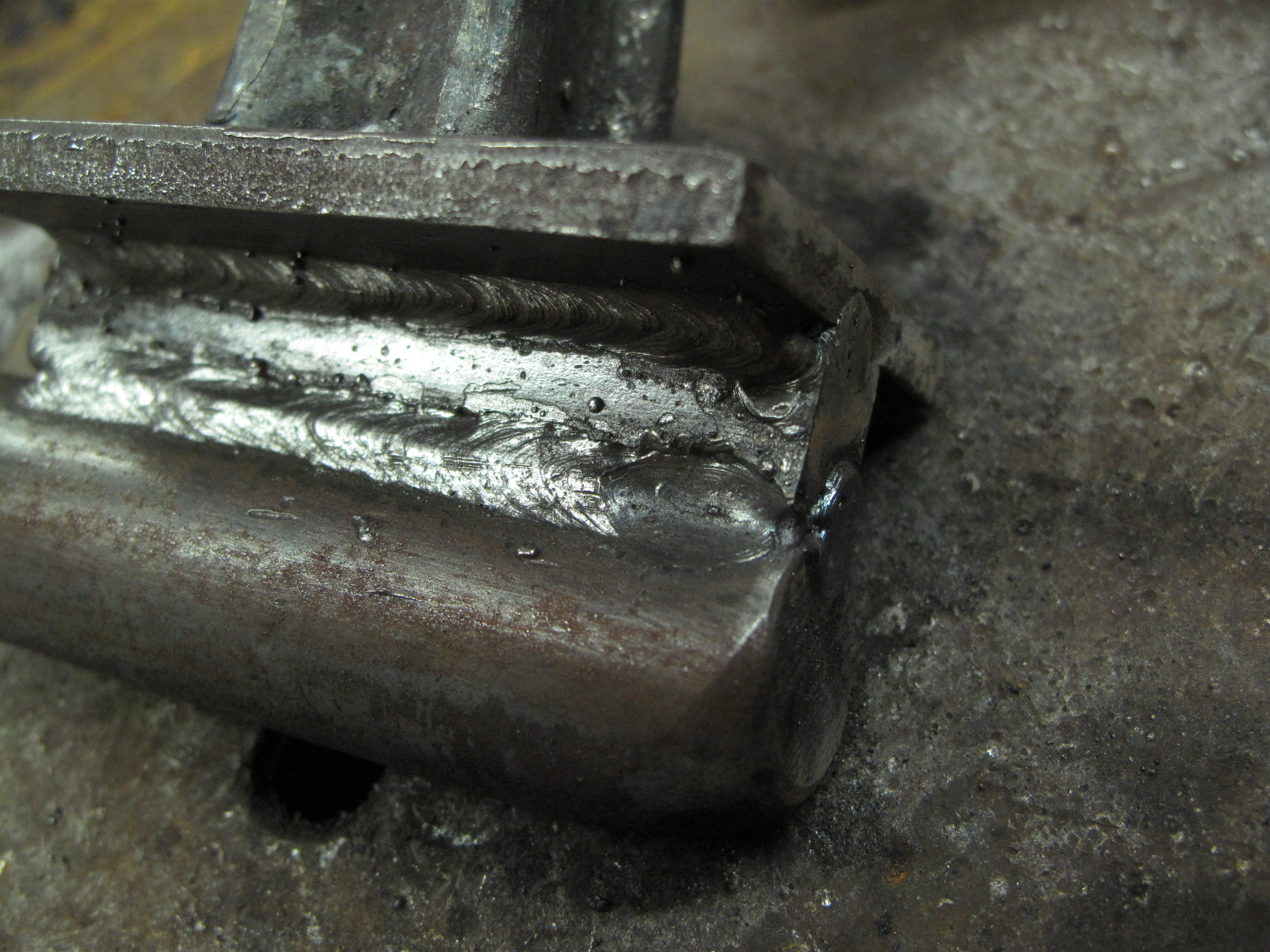

VaughnT Posted January 29, 2017 Author Share Posted January 29, 2017 Tried my hand at some vertical up last night. It didn't go anything like what you see in the videos you see on the internet! Laying flat on the table wasn't so bad, but still far from what I'd like to see. Both are with 1/8 7018 and the machine set at 125. The vertical up is one 1/8" wall angle iron and 3/4" square bar. I was having a heck of a time with the rod sticking as I first tried to strike the arc. Real bear of a time getting everything just right, and on the V-up, as soon as the arc got started halfway decent, the metal was running like a river. I tried pointing the rod upwards to push the puddle ahead a bit, but, well, you can see how masterful my work came out. I was kind of proud that I managed to make a right turn and continue the bead to the end. Aggravating no matter which direction I look at it. But, I've got a grinder and some new disks that will get it looking halfway respectable. Quote Link to comment Share on other sites More sharing options...
John McPherson Posted January 29, 2017 Share Posted January 29, 2017 Shops that take welding costs seriously know that the best quality work product and highest production rates come from doing all work in the easiest position possible: flat. Failing that, horizontal. Most of the really hot industrial processes only work in the flat and horizontal fillet positions. (SAW, GMAW Spray) To that end, they will spend whatever it takes on welding positioners, turntables, hoists, cranes, chain falls, jigs, etc. A new high end welding machine costs more than I paid for all three of the last used cars I bought. No one is going to turn a high rise building or an Interstate bridge on its side, so you have to hire better welders, capable of vertical up and overhead work, and the job just takes longer, per linear foot of weld bead. Period. Personal professional welding certs EXPIRE if not refreshed or proven to a reviewer every six months. Use it or lose it. Moral of the story: don't beat yourself up for not being able to hold to an arbitrary standard as a self-taught, part-time, hobby welder. You are doing just fine. My critique: grind a bevel on one or both elements before you weld, especially if you are going to grind it flush afterwards. Otherwise, you may find all the strength you put in is now on the floor in the shape of dust. You have to hold a really tight arc interval when stick or TIG welding, equivalent to the diameter of the electrode. Doubling the arc length doubles the voltage. More voltage = hotter, runnier puddle. What you should see is a solar eclipse around the flux with E7018. If it looks like a cherry on the end of a stick, you are long arcing. Quote Link to comment Share on other sites More sharing options...
bubba682 Posted January 29, 2017 Share Posted January 29, 2017 When you go to brake away with 7018 pause for a milly sec and go back a millimeter your break aways will look better less of a low thumb print and practice practice practice get good at one position then go to the next.Your flat is coming along the vert is a little harder you look a little to hot one heat does not work in every position.Keep practicen and asking ques it'll come. Quote Link to comment Share on other sites More sharing options...
arkie Posted January 29, 2017 Share Posted January 29, 2017 Vaughn, you'll find that most folks running 7018 uphill will use less amps than when running flat, horiz, or downhill. Try something like running uphill beads increasing from 90 to 110 amps on your 1/8" rods in 5 amp increments and see how it works. Not all welding machines weld the same and 125 amps on one machine might be higher or lower on another. Quote Link to comment Share on other sites More sharing options...
BIGGUNDOCTOR Posted January 30, 2017 Share Posted January 30, 2017 With 7018 you can bump the rod against the plates since the flux is nonconductive. Like John mentioned earlier, keep the tip stuffed into the puddle so you have a short arc and just see the edge of it under the flux. Undercutting can be from moving too fast, and not allowing enough time for the base metal to heat up and allow the puddle to flow to the edge. Point the tip in the direction that you want the puddle to flow, then give it time to do so. Just butting parts together isn't the best weld prep. Either grind a bevel for the puddle to fill, or sometimes I just leave a gap between the parts depending on the situation. 7018 is my go to rod. If it is laid down right the flux will peel off on its own, or it will only require a light bump to pop it off. I can see improvement in your beads, keep it up. Do you have any night welding classes at a community college? That is where I went and my welding improved tremendously in a very short time. It really helps having some right there watching over your shoulder. Quote Link to comment Share on other sites More sharing options...
