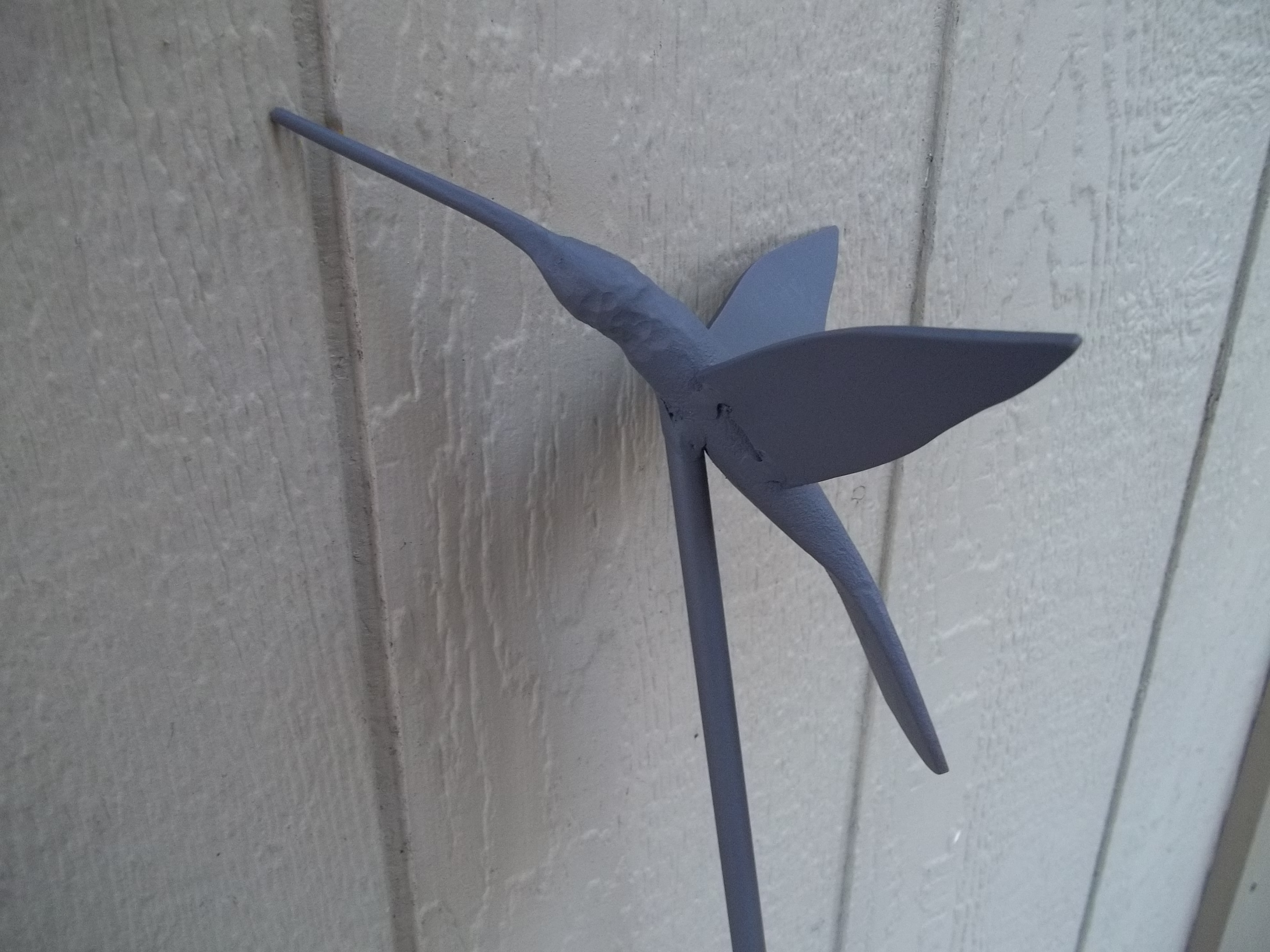

Recently, I've been making some hummingbirds for friends.  Made 4 so far.  Each one is a bit different.  I usually use scrap 3/4" long bolts or any 3/4" mild steel rod.  The wings are made from scrap 1/8" sheet for strength and tack welded to the body on the underside.
I wish I had taken photos of all of them in the raw state, but only have one or two.  After forging, I buff them down with a wire bench grinder wheel, spray them with grey primer then my wife paints them with outdoor acrylic and seals with artist's outdoor clear coat.  Usually, I weld a 3 foot length of 3/8" round rod to the belly at a 45 deg. angle so they can stick them out in their gardens.  On the last ones, I have been leaving the lengthwise fuller pattern on the tail to give a little relief when painted for a nicer feather effect.  I don't try to put in any detail or try to be super accurate on dimensions...they are yard art, after all.

Thanks, Charles.  They're fun to make.  No detail, that's the best part!!
You've showed us pics of hummers before haven't you? I like them as much now as then and still want to try my hand.
Very nice. Is anyone painting them? Hummers are bright colors.

​Frosty, I probably have posted pics before....but...I've slept since then.  Most likely a "senior moment". :unsure:
My wife has started painting them, being an artist and I am certainly NOT one.

Please do...that's why we post our work, to inspire others to copy and learn.  One tip I learned from a friend who is an "expert" on the hummers.  My first ones had straight beaks, but she informed me that their beaks have a slight curve to them, FYI
