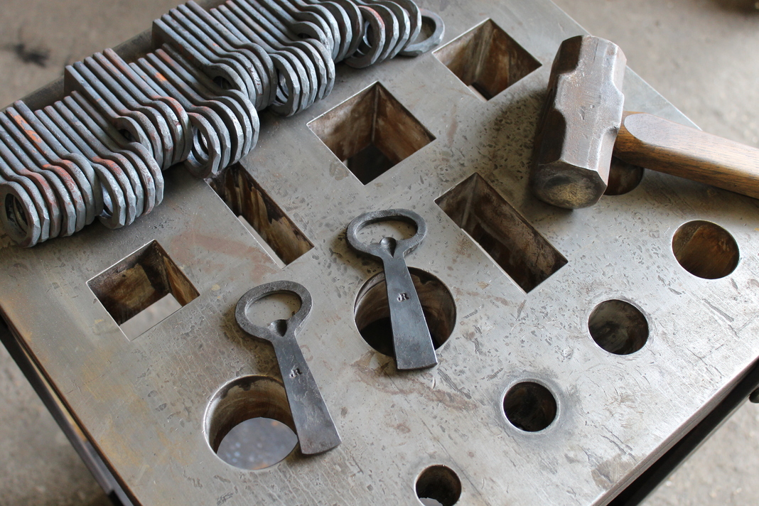

I homebrew.  I am a blacksmith.  This project was bound to happen.  Forged from 1/4" mild steel, here is my stab at the bottle opener idea.  The fly press tooling punches out a 1/4" slug in one heat.  I need to build tooling for the taper and then I'll post more.

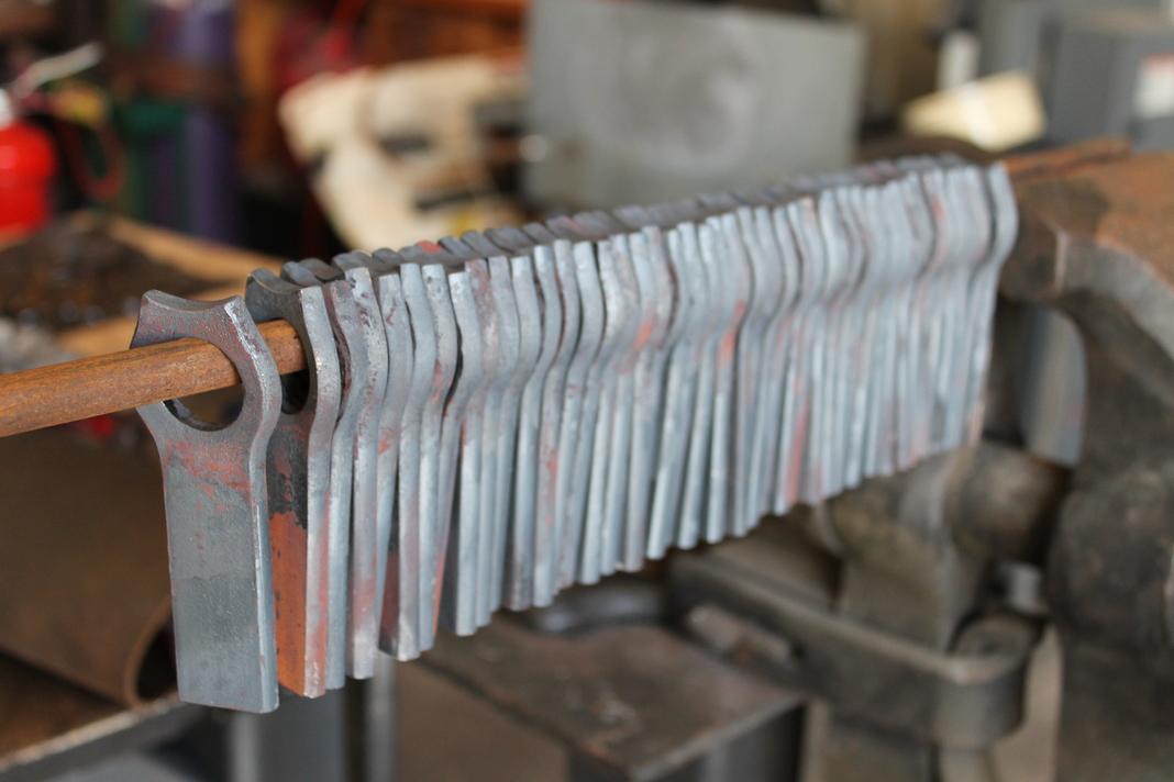

A person making one or two bottle openers like this would spend more time setting the screw press up than just punching, drifting and finishing a couple openers. Yes? If you're going to make say 10 it starts to cross the break even point where it takes less time to set the equipment up. Making 50? Heck, the first ones would be starting to rust before you got the last ones punched and drifted.
I'm betting Mr. Rigoni was able to blank, (Cut the stock to working lengths or blanks) punch & drift Them all in a couple hours. His screw press has professional looking clamping tools and should be darned fast to retool for the next step. Heck, he may have even designed production tooling and only need to shift the dies to the next position. In that case he can probably blank, punch and drift around 50-100 / hr.
Production technique gets a lot of negative attention with blacksmiths but the old timers know how important it is to plan and sequence projects, lay out the tooling, tools, plan where we're going to stand, how far we will move and when. This is basic production technique. For a good example of forethought look how Mr. Rigoni has hangers to hold the openers after each step ready for the next step. Yeah, they're just a piece of rod but they're exactly the right tool, can you imagine how long it'd take to take one from a box or pile on the table top, position it for the next step? Now multiply that few seconds by every opener. Seconds add up you know.

Thanks everybody, the punch I machined from a piece of 4140.  The swage block I designed, had the forms waterjet cut and built the stand.  I thought about removing the corners, but forging them in saves on material and time.  I made the punch undersized so that after breaking down the corners it came out the right diameter.  I'm having issues with the spring swage build so I might forge the rest of the tapers to size.
The quick method I use for cleaning up corners is a top swage on a bic. I've tried forging or cutting the corners out before punching but seeing as I have to drift it anyway and I can clean up the corners as I drift it seems like repeat work.

After looking at the tooling photo I can't figure out how the opener is held down when you retract the punch.
Do you have overheating issues with your punch?
Do you use the flypress to drift the hole to round?
Do you use the flypress to set the bottle cap lifter?
Thanks
I might make a youtube video of the process.  There are two bars that hold it down so the punch doesn't stick.  I cool the tool in oil.  I machined it from 4140 and there is no wear/warp so far.  I use a swage block and anvil to drift open.  The taper and ball depression are under the power hammer.
