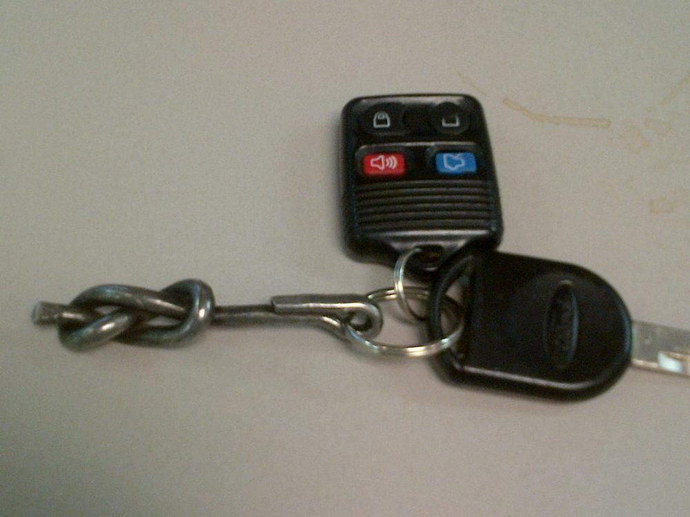

Take about 8 rods, break off the outer coating and bend them in half.  Put each one in a vice and twist them.  Sometimes they break and that is why you need about 8.  Take 4 twisted rods and join them together by welding them on the ends. Now heat them up in a forge and twist them all together and they make a nice handle.
You could make them into key chains.
