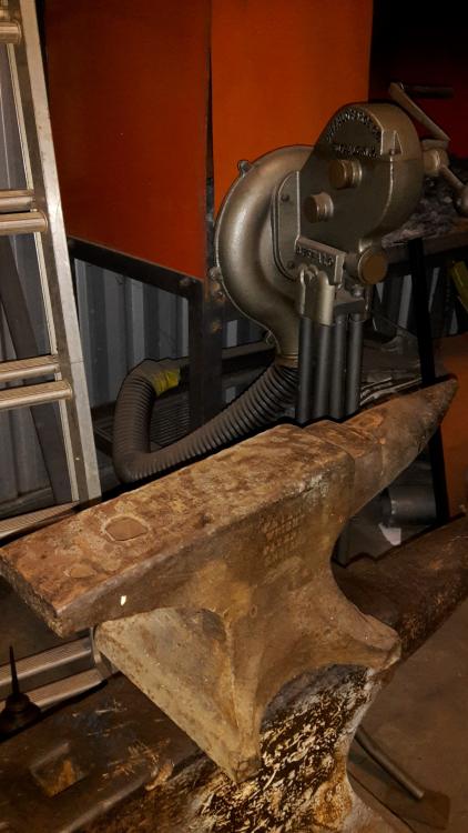

I recently picked up a 138lbs Peter Wright off of craigslist. I could only talk him down to $500, but I don't feel To cheated as it IS a fairly nice looking PW
the edges could be better, and she doesn't have that great of a ring, but I like her.
I couldn't find a tree stump I liked, so I made one out of 4"x6"x8' cut to 22inches, glued and bolted together
I ended up having 8inches of 4x6 left over, cut corner to corner to add stabilizing feet to the stump... just in case

Hi first post here. I just picked up a PW at an auction yesterday. It's my first anvil. I think I have the same anvil as smithatheart however it sure looks like mine is stamped with "T  T  T18".  Mine also doesn't say "solid Wrought" or "England" on it. Does that mean it was made in America?  Is there anyway of knowing how old it is.
I cleaned it up with a wire brush and it still rings like a bell with pretty good rebound. I'm pretty darned excited!
Edited by swdweeb
correct spelling
Welcome aboard, glad to have you. If you'll put your general location in the header you might be surprised how many of the Iforge gang live within visiting distance. As Thomas said in an earlier post there's no telling what folk stamped in the anvil from the maker, retailer, company, inspector, folk testing their stamp sets, etc.
What's it weigh on a scale? It looks to be in darned good shape, just broken in a bit generations of good hard work left in that fine old lady.

I had a wonderful surprise yesterday when I decided to give my anvil another close look.
I was so excited to see a "ETER" a "IGHT" and a "TENT" above the hundredwieght markings. So now I finally know what I'm working with, a 176lb Peter Wright! And it was just given to me, its like a sign from Thor that I'm on the right path!
