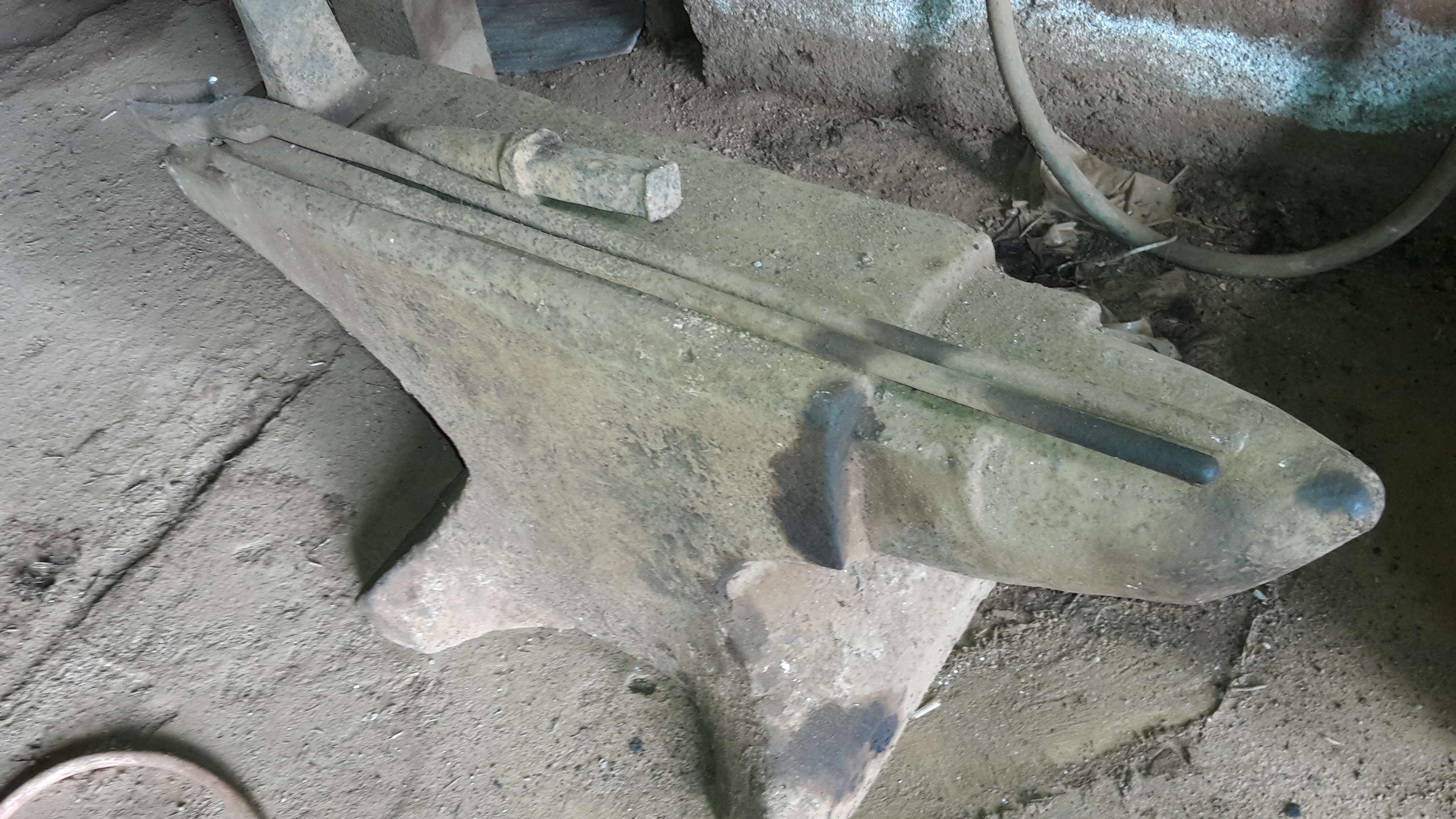

  5. Just added another to the collection , Picked up this no name cast iron steel faced pre 1950 anvil , it does have the cwt on it, 2-0-14 { 238 lbs or 108 kg }. Picked it up on Sunday from a farm in the Mena Creek area { FNQ , Australia } where it had been sitting in a corner of an old stables come tractor shed for many years collecting dust. I say pre 1950 because the family that is selling the farm now, took over the farm back in 1950 and the anvil was in the shed then, so I don't know how old it really is or for that , the brand either. The only other markings on the anvil is " 1 1 " in the centre the toe of the front foot. Came with 2 hardy tools and a pair of light tongs. One of the hardy tools has the brand of " PLUMB AUST. PTY. LTD." stamped into ,this company started using HYTEST FORGED TOOLS as a trading name in 1946 because of the usa brand Plumb inc. , and the company was sold in 1965 to the Trojan tool company. Cast iron is far from the best material for an anvil but I could not walk away from it . Now I own the best door stopper in the street.
