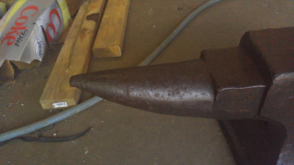

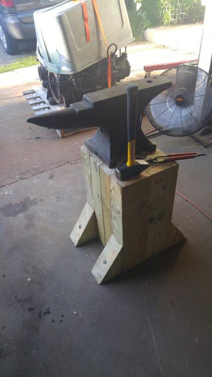

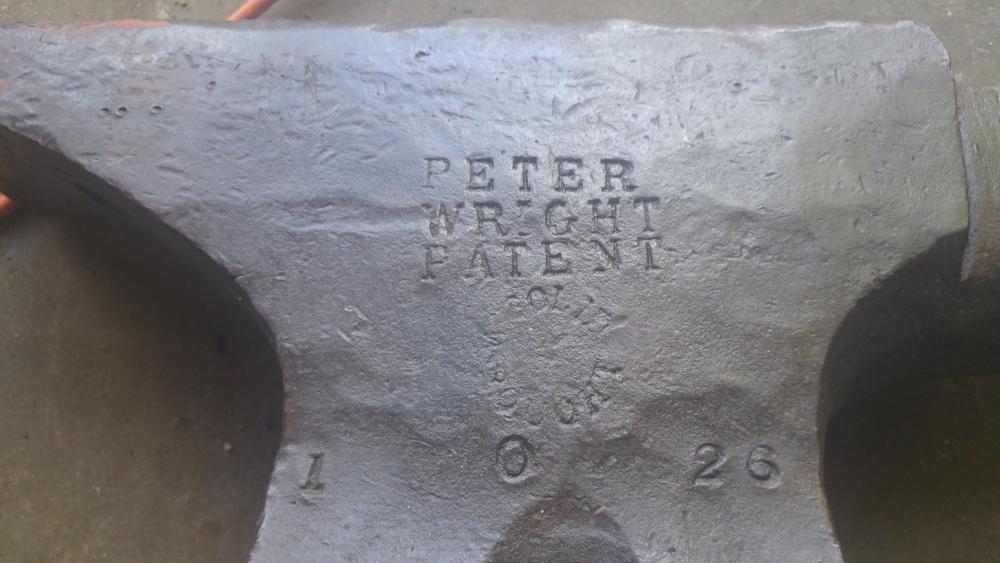

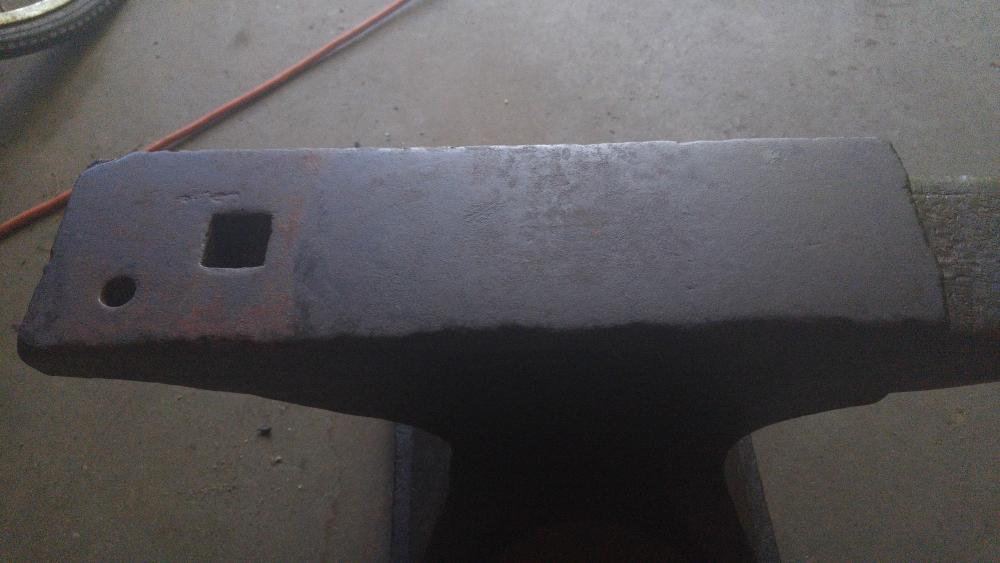

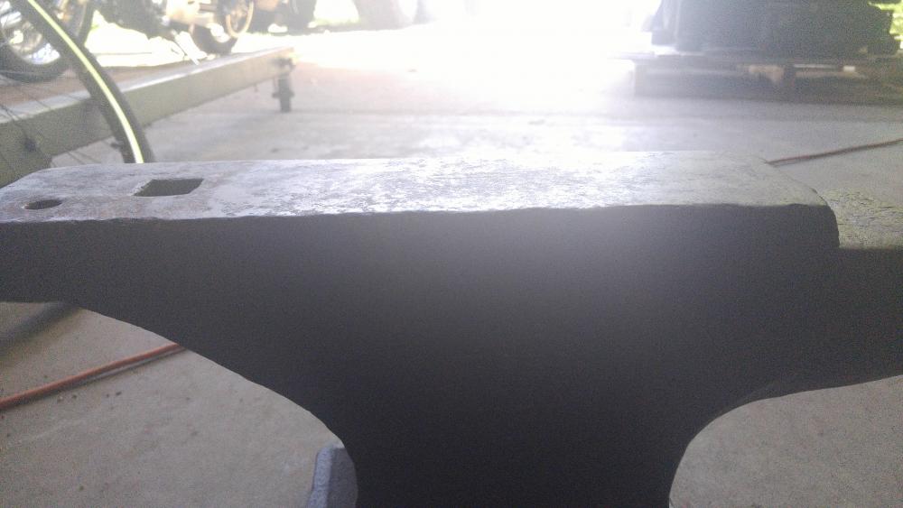

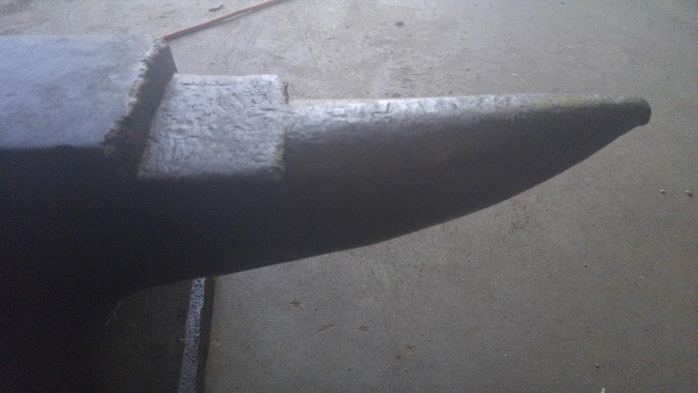

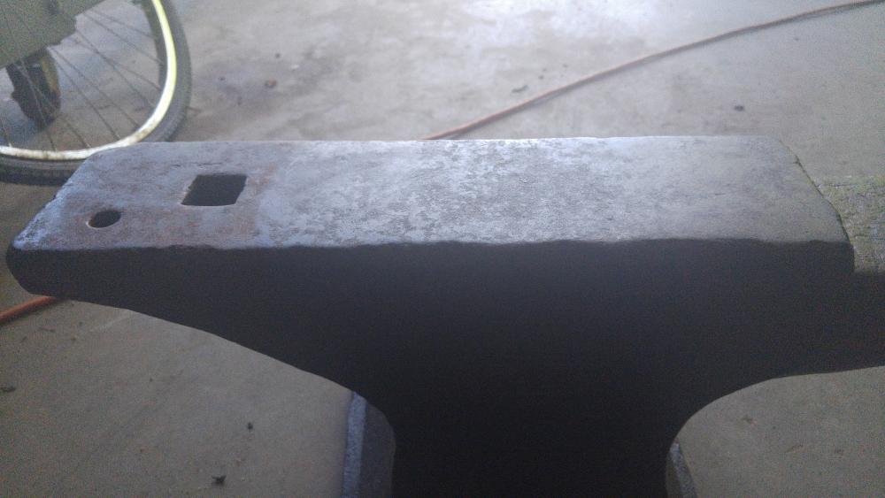

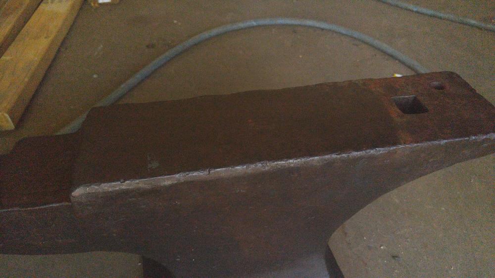

  2. recently I moved out and had to use a local mover on short notice. this weekend he unloaded my stuff after 6 months storage so I could finally get back to my life.(long story, not relevant) and my anvil is missing. my 138lbs 120+ year old Peter Wright Anvil, is "missing". it's one of a dozen things that didn't end up back at my place after the storage period. my heart is broken, and most of my home brewing equipment is as well.but my ANVIL. I wanna hurt someone. SO I am out of the forging thing... because I'm not good enough to actually SELL anything... until I can Power Hammer, or get my anvil, or a replacement. and JUST to rub salt into the wounds, I'm an over the road truckdriver, I have to leave in the morning and will not be back for 2 weeks. the mover has repeatedly claimed he was going to return my stuff, but I think he's just delaying sincehe's now trying to place a lein against my truck and my motorcycle "until I pay him" and I found out today that he has a criminal record

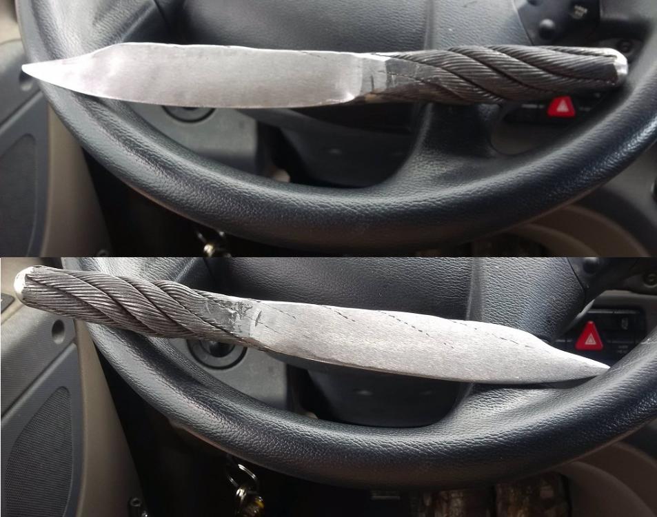

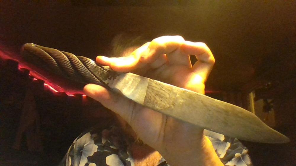

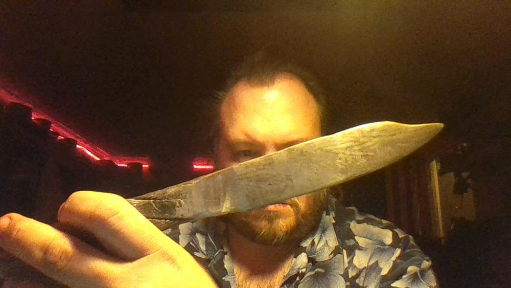

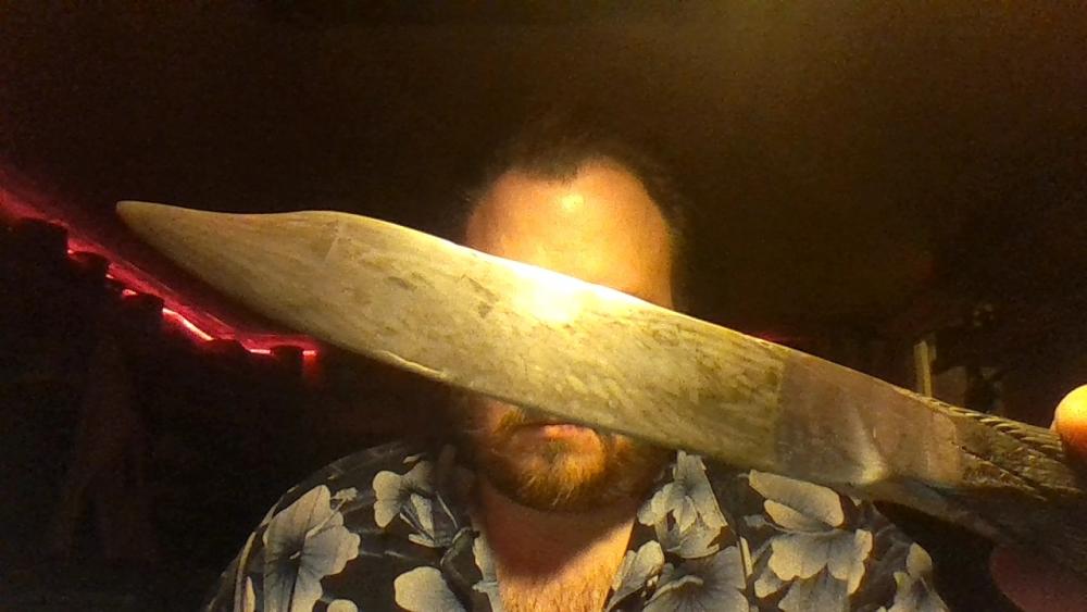

  3. trial etch on the cable knife. I also used it to chop a 2x4, and got a slight delamination on the blade edge that you can JUST see with the single exception, I thought this turned out pretty good it was actually supposed to be a leaf bladed dagger, but the steel wanted to be a bowie, so that's where I went with this WIN_20170529_21_46_55_Pro.mp4
  4. Nothing illustrates how out of shape you are from 17 years playing steering wheel monkey (17 years as a otr truck driver) than trying to forge weld a 1 inch piece of cable on your ONE day off this week >.< got half of it forge welded, one inch at a time, three cycles each... before I ran out of steam and couldn't lift the 2.25lbs rounding hammer I only JUST got in the mail yesterday I'll try to get some pictures on my phone when I can lift my arms again... also, twisting wrench I "made" with a one foot bit of rebar (only my second time welding with a wire feed)

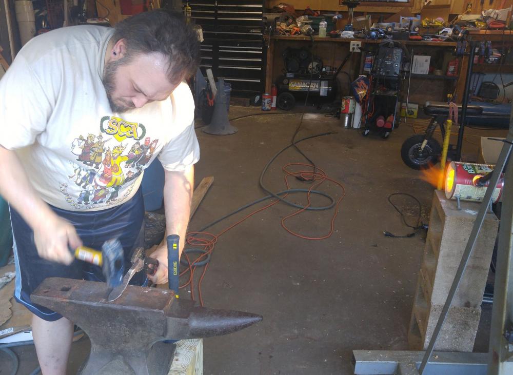

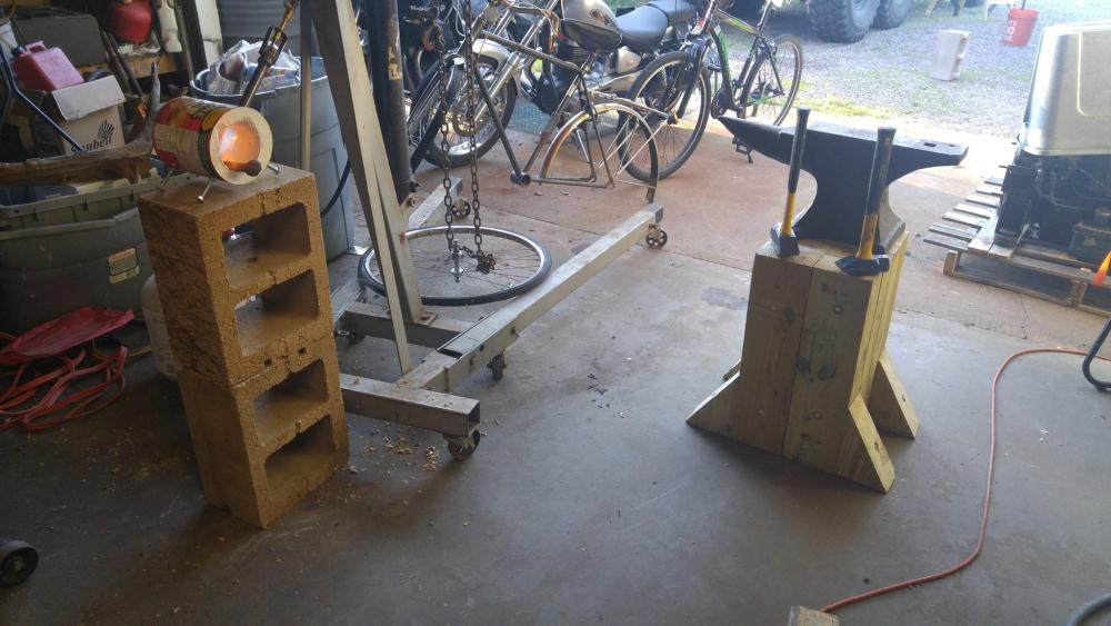

  5. my first forge I musta run for 10-12 hours off of a 20lbs propane bottle. I finally ran out the otehr day so I took my 40lbser to Ace Hardware to get it filled. Was cheaper than bottle exchange! swapping bottles (around here anyway) is $22-25 for the 20's, but getting a 40 filled was only $29! I run two 1/2" burners with .025 mig tips around 10-12psi as as long as the stuff I'm working on isn't too thick I can even forgeweld with it

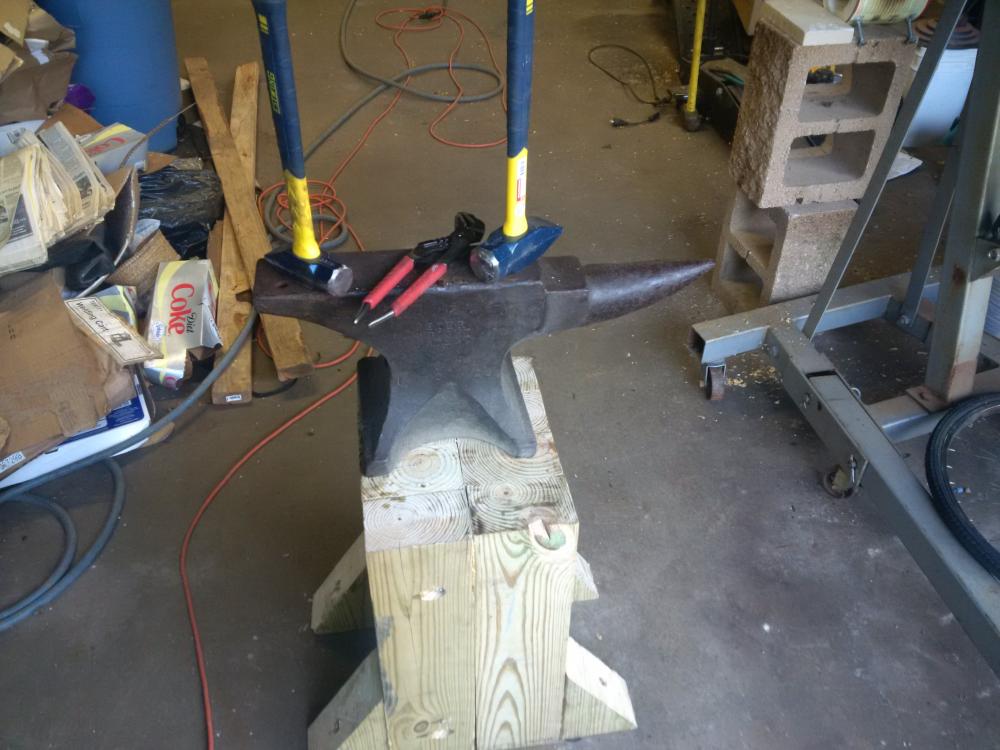

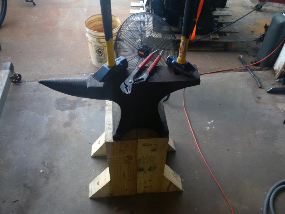

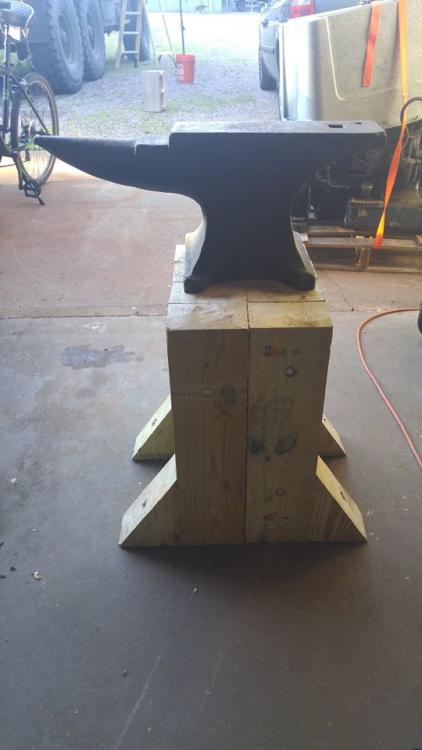

  8. I tried a RR-track anvil and was NOT happy with the results. my first "real" anvil cost double the "going rate per lbs" but was, I believe, well worth the money. first it's at least older than 1880 based on the markings, second it's in decent enough condition for a VERY used anvil and lastly, I've ALWAYS wanted a 'REAL' Anvil. granted, I could have bought a new one thru HD for $800+, but I didn't HAVE the extra $300 to spend at the time. could a GOOD smith do Good work on a RR-track? probably, but I'm not there yet, not even remotely close... better tools, less garbage to blame for when you mess up, cause a tool THAT expensive obviously CANNOT be the problem :3

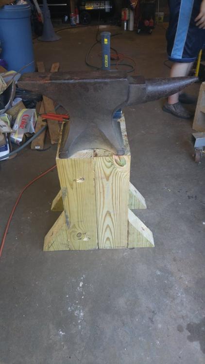

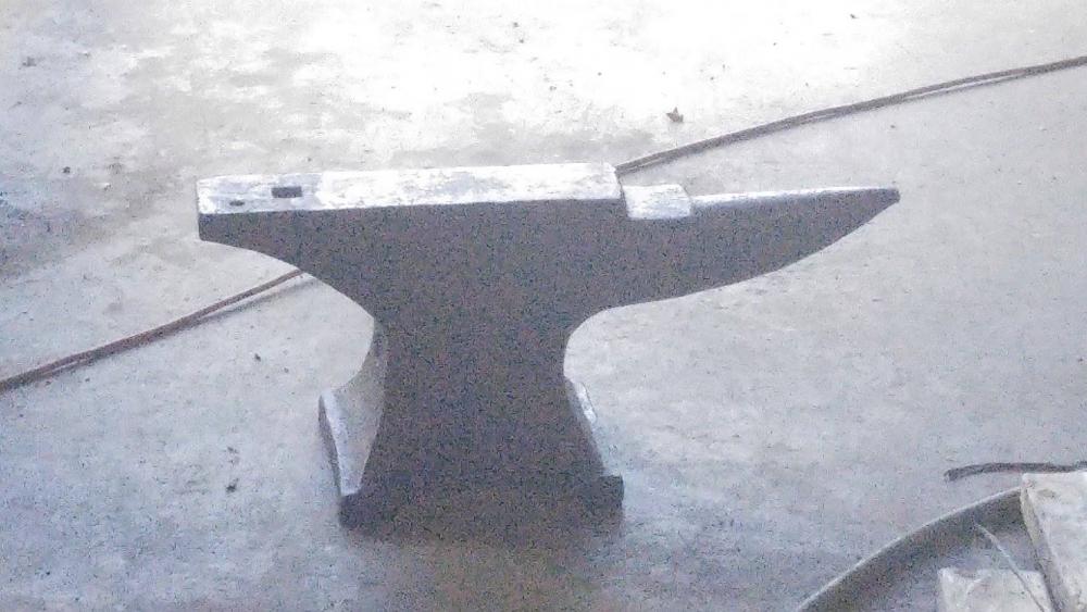

  11. here's my RR track ASO (anvil shaped object). turns out the weld on the bottom didn't take, and I had to add a brace to it and reweld it again. I don't have a pic of the "fix" but I'm still using the ford tractor axle as my base...

  13. POP: King Of Random on youtube. the metal I'm using for the forge is literally two Ravioli cans, and no. it won't last at these temps, but this was a "figure it out as I go along" kind of situation. my next forge will be Perlite/sodium Silicate and a used (rusted thru) propane tank. actaully I wanted to ask your opinion on perlite and sodium silicate as refactory... Tongs, I have a few but they are "some assembly required" and have to be finished... I don;t know how you feel about advertizing, but I got 5 sets of tongs what I found two professionally made tongs for... anvil height: yeah, I have some 4x6 laying around I am going to make a platform to raise it up 4 inches. I also need to secure the anvil to the stump yet. I work 70+ hours a week on the road, so I only get 60-72 hours off every other weekend... cooling off too much: when I was standing over it I couldn't hear a difference, maybe because I didn't Know you Could hear a difference? (newbie) and yeah, which is one of the reasons I'm using cheap xxxx disposable RR spikes so I can learn to move the metal the way I see in my head (also why I haven't made those tongs yet) before doing anyhing with Expensive metals. youtubes: I've added Mark Aspery and Brian Brazeal to my "watch sooner rather than later" list shorts: it was 95 degrees that day, and I sweat at anything over 70. an apron is in order, once this months bills are paid. now that it's fall, I'll be breaking out long pants and socks sooner. oh, and as for the damage the falling bit of steel caused, there was a deep scratch, but no burns. hurt because that was a fairly heavy bit hitting a tender bit, but no burns (fortunately it wasn't on skin more than 1/10th of a second) I live in the Wisconsin Rapids area (will add that to my profile in a bit) and I KNOW there is at least One Blacksmith int he area (the fastenal guy said so) but I am home so infrquently I don;t really know anyone in town, despite living there for over 10 years now... so I am open to the possibility of groups btw, thank you for taking the time to see how badly I'm xxxxxxx xxxx up (even if I'm not really doing all THAT bad) and offering constructive criticisms here's what the RR spike looked like after I cleaned it up on the grinder/beltsander. I know RR spikes don't heat treat well at all, but I think I wanna harden it when next I get home.
