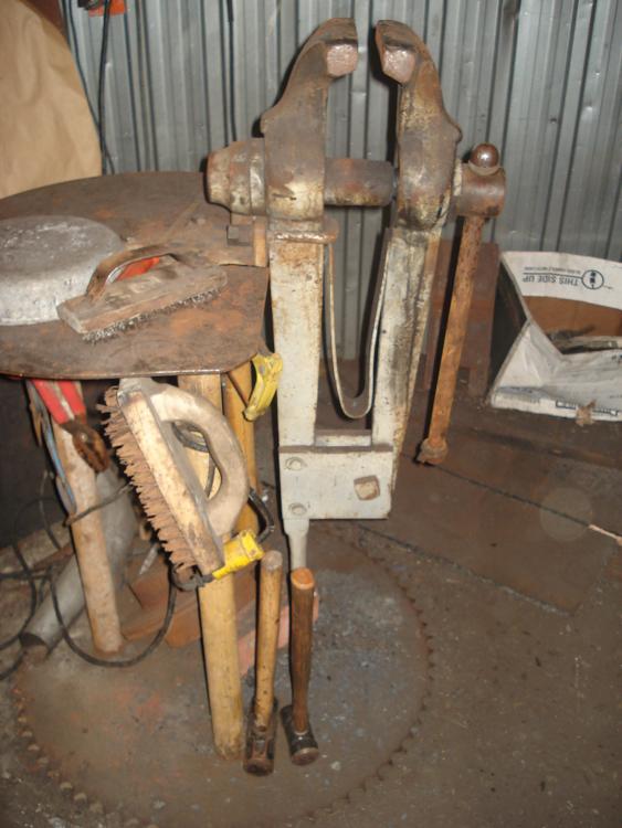

yves Posted January 4, 2017 Share Posted January 4, 2017 My work space is minimal. I work in a silo. I have this 6 inch vise bolted to the floor (concrete). I have a few more vises. One will be mounted so that I can move it outside when the weather permits. Link to comment Share on other sites More sharing options...
C-1ToolSteel Posted January 4, 2017 Share Posted January 4, 2017 13 minutes ago, yves said: My work space is minimal. I work in a silo. I have this 6 inch vise bolted to the floor (concrete). I have a few more vises. One will be mounted so that I can move it outside when the weather permits. Is that stand for training against barefoot smithing? Link to comment Share on other sites More sharing options...
yves Posted January 4, 2017 Share Posted January 4, 2017 C1, This a gear from an old steam shovel. The teeth are really worn down. So, would you come around our parts, you could forge bare footed. The dangers would be from above. You would thus need steel toes but no sole on the shoe. The teeth are forgiving … Link to comment Share on other sites More sharing options...

C-1ToolSteel Posted January 5, 2017 Share Posted January 5, 2017 Ahh, should've known it was a gear to an old steam shovel. Pst, get those hammers off the floor! Link to comment Share on other sites More sharing options...

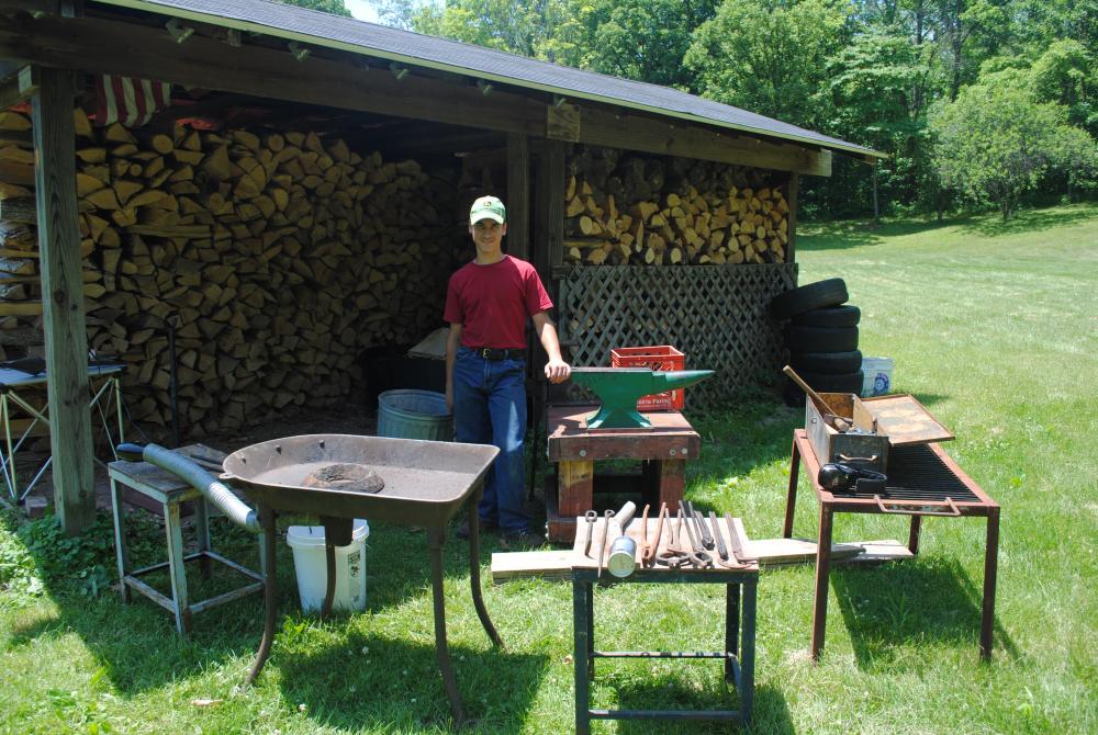

beech Posted January 7, 2017 Share Posted January 7, 2017 Mine, which was modified by welding some big square tube onto the mounting bracket, is mounted on the table the anvil is on. That's not how I set it up, that's how I got it, but I haven't had any problems with it getting in the way of using the anvil. Some time I'll get around to taking pictures and posting them. In the picture you can see the table (before I mounted the vise, this was before I actually started, so I now have a different setup). The vise goes on the far end, opposite the anvil, and would face toward the left if it was mounted. Link to comment Share on other sites More sharing options...
