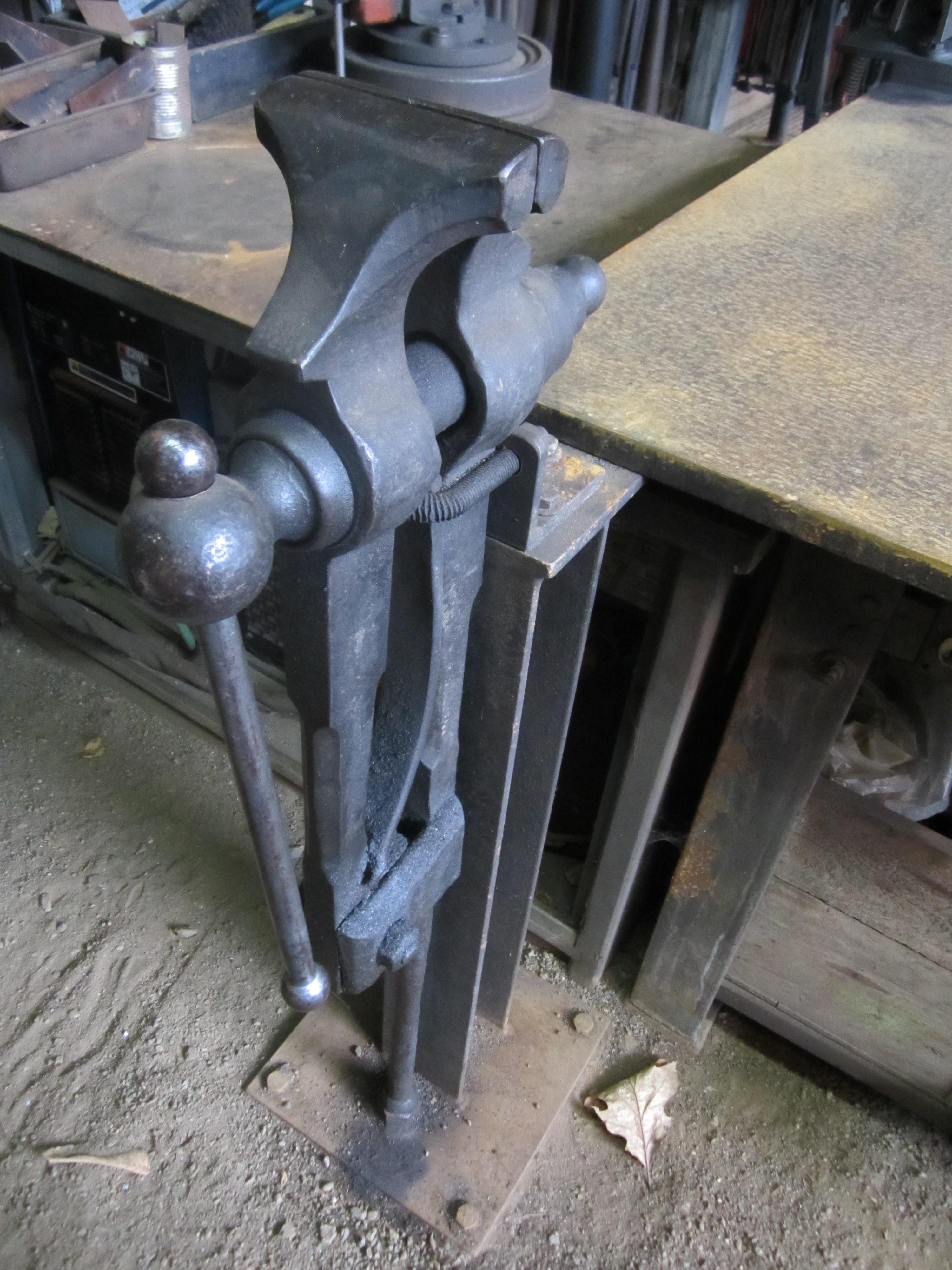

Tommytaptap Posted January 10, 2017 Share Posted January 10, 2017 Like this one here.....(the one on the left!) Hi KRS Thanks for your reply. Yes, I think that would be good. A strong piece of tube welded to the plate-just the right size for the leg to fit in without moving-don't think I would drill through the plate though. Just weld to the plate as it is so that the forces are striking the plate and not the concrete floor. I will stand on the plate while I work at the vise also-so it cannot move. I will also fill the upright square tube with sand and fit a small top plate to bolt the vise to. Are there any other suggestions which might help too please? thanks Tom. Quote Link to comment Share on other sites More sharing options...

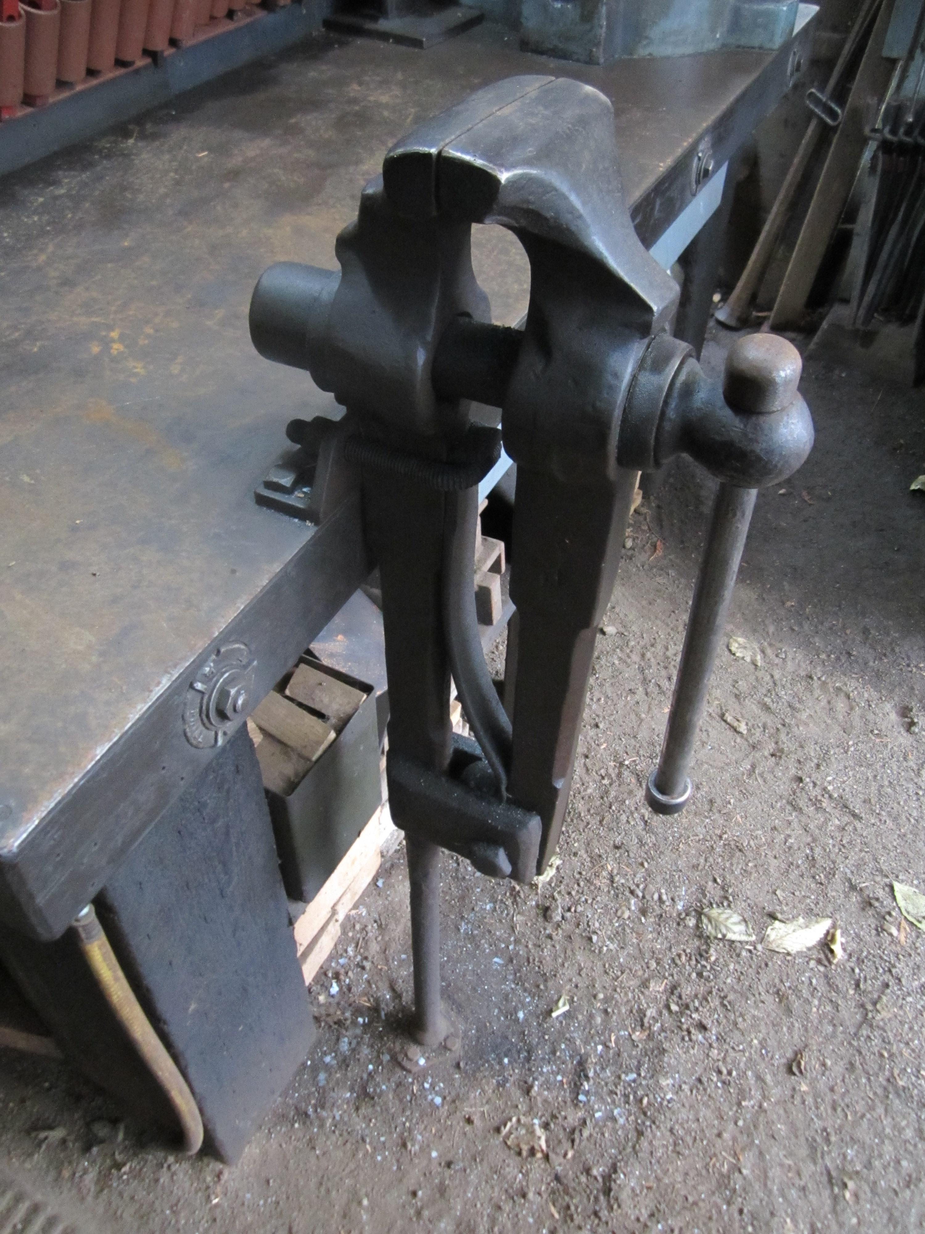

stockmaker Posted January 11, 2017 Share Posted January 11, 2017 My 5" Vise is mounted to an 8" I-beam with 1.25" plate on the bottom and 1" plate on top. Bought all at the scrap yard. Vise and mount weigh just over 300 lbs which is good until it's time to move the square bottom stand, then not so good, but it works well for me. Quote Link to comment Share on other sites More sharing options...
Tommytaptap Posted January 11, 2017 Share Posted January 11, 2017 Hi stockmaker, thanks for showing that. Some weight there boy! Rounded plate for me means I will be able to move it around if needed. I like the top plate mounted to one side. Are you right handed? I am a lefty and may put it off to the right. Is the leg just a tight fit into the tube at the bottom? thanks, Tom. Quote Link to comment Share on other sites More sharing options...
stockmaker Posted January 11, 2017 Share Posted January 11, 2017 Hi Tommy Tap Tap, great name! Another picture of the stand from the front. I had to mount the vise to the side so the vise mounting bolts would clear the Center I-Beam bar. I know I spent more time on the leg anchor than any other aspect of this post/stand. At first I was going to forge it so the leg final fit perfectly into anchor, but decided that was beyond my present tooling, I ended up using a 1.5" dia. steel pipe (I think). Than finding the perfect place to position the pipe under the vise was perplexing, the leg would move, left/right/up/down/in/out, depending on how tight the leg clamp was. I wanted the clamp to be very tight, but I also wanted the leg to come straight down. I went with a slight compromise, but mostly in the straight down config. The leg just sets on top of the steel pipe. I did debur the pipe edges in the hope it would not cut into the leg. Good luck with yours. Quote Link to comment Share on other sites More sharing options...

Frosty Posted January 11, 2017 Share Posted January 11, 2017 Tom: I REALLY like a round flat plate for stands but prefer the equipment mounted in the center it makes it a LOT easier to tip up and roll. It balances. I really recommend NOT welding equipment like vises to stands if you have any alternative at all. You don't need anything fancy to socket the leg. The hole doesn't need to go all the way through so long as the leg end can socket in and not shift sideways. You aren't likely to drive the leg into the ground through the plate. Another easy alternative is to find a nut that'll slip over the leg end and weld that to the plate. Almost anything that'll prevent the leg from shifting is all it really needs, seriously a leg vise works just fine with the leg poked into a packed dirt floor. Oh, my 4" leg vise is mounted to an inadequate, collapsible tripod stand. It seemed like a better idea than it worked out to be in use. My 6: leg vise is mounted to a table. Frosty The Lucky. Quote Link to comment Share on other sites More sharing options...

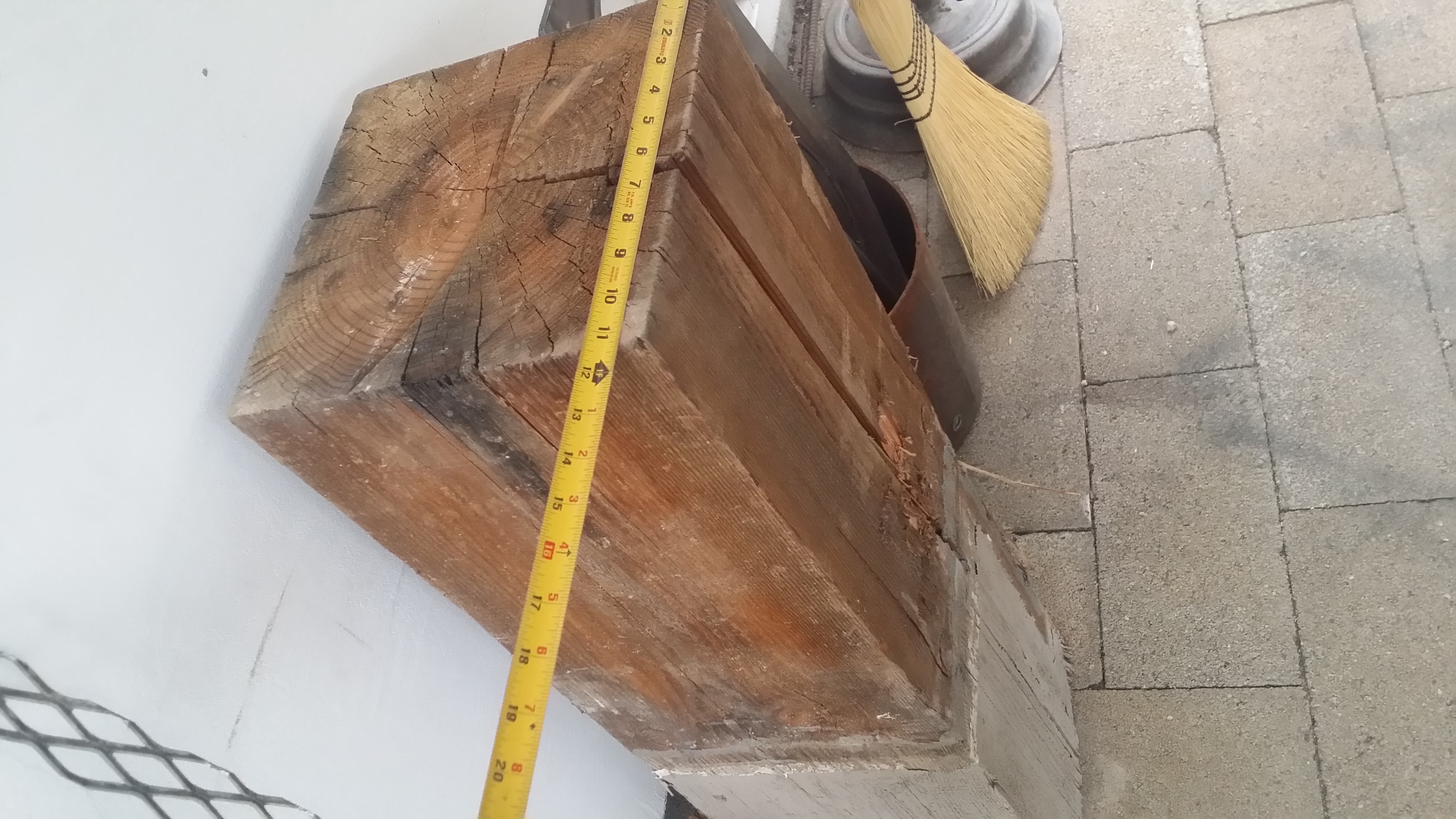

bigb Posted January 14, 2017 Share Posted January 14, 2017 I picked this out of the job site dumpster today, 12X12 and 36" tall. Thinking of using it for my post vise. I can make a base for it, I have several circles of heavy plate. I have a lot of 2" X 1/8" lengths I can use for strapping to stop the splitting and all kinds of angle up to 4X4X1/4" to mount it to the plate. Quote Link to comment Share on other sites More sharing options...

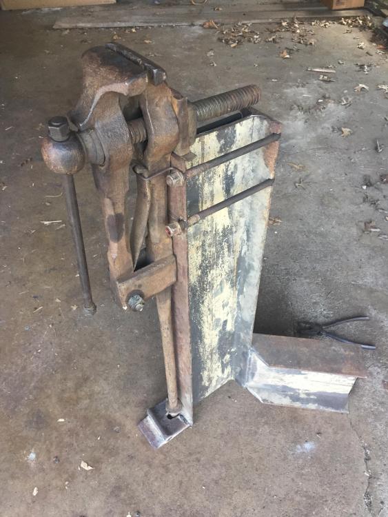

JHCC Posted June 12, 2017 Share Posted June 12, 2017 My stand is a vertical piece of 4x8 I-beam, with a base made from two pieces of the same. The above photo was before I made up two brackets to hold the vise to the post: I added some bits of pipe to hold chisels and punches: Not shown: the steel plates and buckets of scrap that I stack on the back of the base for additional stability. Quote Link to comment Share on other sites More sharing options...
