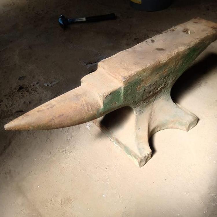

I found him in an old cavalry, some idea of the year? it's a Swedish kohlswa

Roinfante: There should be a date stamped in the side opposite name but if you're really interested you'l need to remove the paint.
I'm a HUGE fan of Swedish cast steel anvils, don't let the edge chipping bother you, stay off them till you've used it a while and develop good hammer control. Once you have some experience you'll know how much if at all you need to address the chipping.
You're in for a treat, that's an excellent anvil, wear and all. GREAT SCORE!

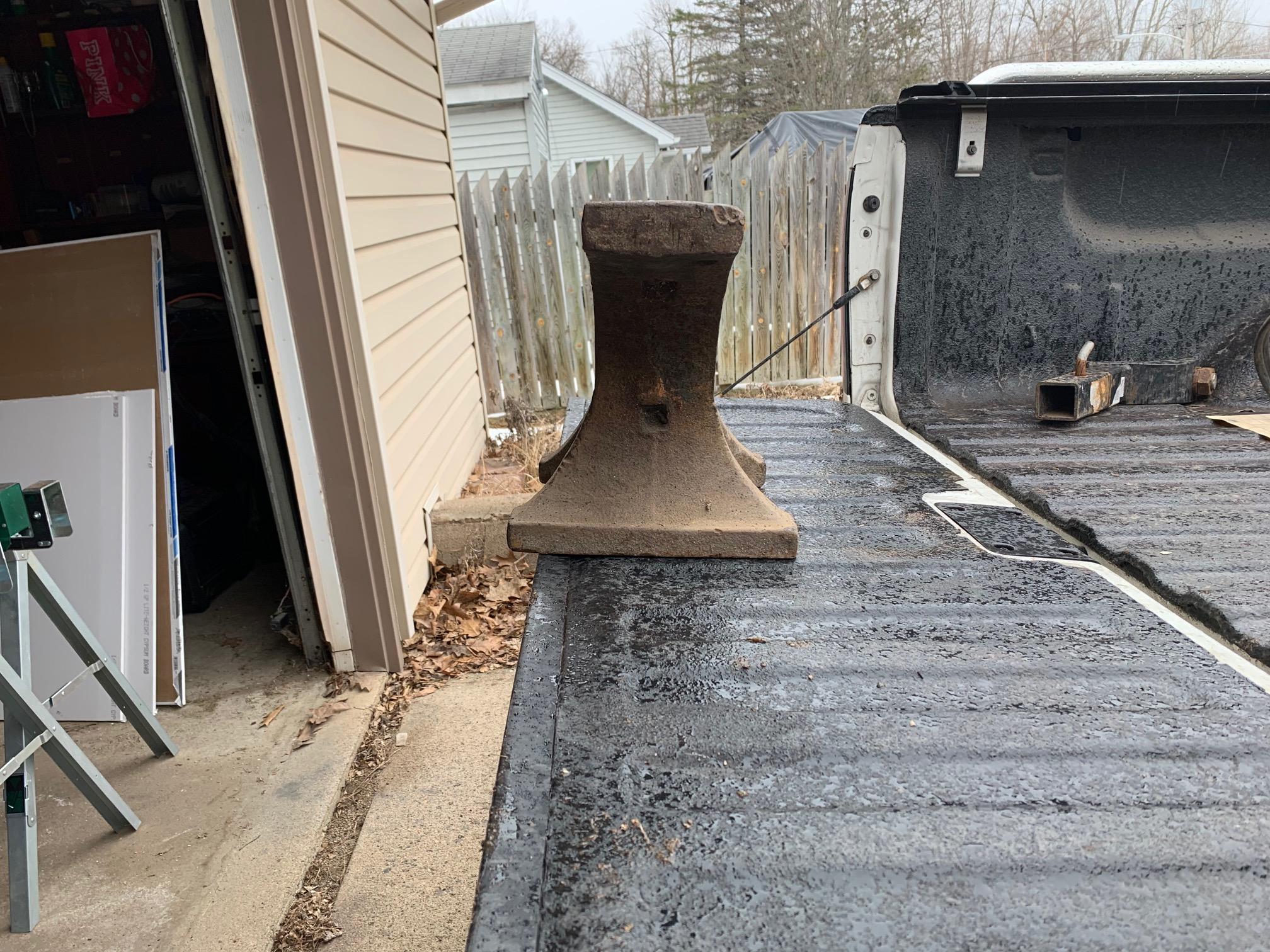

Hello!  Long time reader, first time poster.  I just picked up my first anvil in Milwaukee this weekend.  Wonder if anyone here can tell me more about it from the pictures?  So far I haven't found any markings of any sort, it seems to have good rebound but it looks like maybe it was nicked with a cutting torch in a couple spots and someone banged on the face with a chisel it looks like.  I plan on cleaning it up with a wire wheel once I get back from vacation.
IMG_7279.thumb.jpg.bd2019d9e1ca10d584495eecc2a70ef6.jpgIMG_7278.thumb.jpg.f9e50648bb6d60def6808454aaaf8b66.jpgIMG_7277.thumb.jpg.064dcb87267f53e9630761c40643f015.jpgIMG_7276.thumb.jpg.ab14ecbf9532eb98f72ce906690b11eb.jpgIMG_7280.thumb.jpg.bc1762a88e1190e5e8258a9aed9443b7.jpg
What were the ball bearing test results?
And a picture of the bottom please.
I will do both once I get back from vacation. The sale had several different anvils and I used a hammer to determine rebound between the different items at the time
