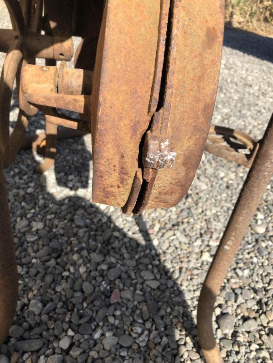

Yeah I use nasty cast rod made by Vulcan as a buttering later then 7018 and pre heat entire area to around 700 degrees because I find it helps burn up some impurities that has soaked in ( I’ve had oil like stuff a few times come ozzing out )and use temp sticks to verify . I always cleans the heck out of the area and and like ya said short welds with a needle scalper to fallow and don’t let the cast iron drop below 500 then when done depending on size I either put it in a large tub of carbon pellets I get from filters I use in my shop ( I get them for free from weeds growers and then hook up to a squirrel cage and they control odor and dust ) and if the item Is to large I wrap with a couple welding blankets then moving blankets and Nd I just don’t like the way brazing looks and silver braze is not friendly with large gaps -

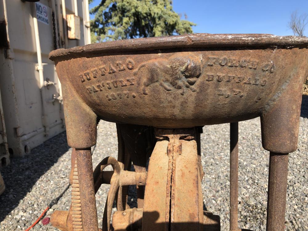

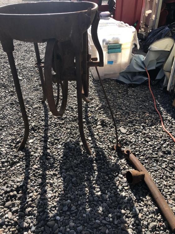

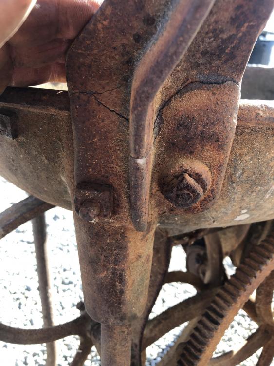

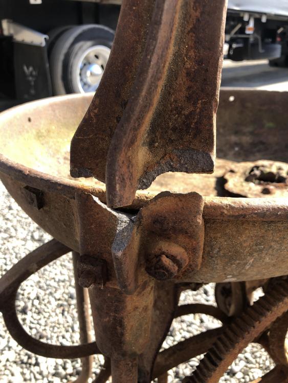

Another scrap yard find - pays to make friends with workers . They set stuff aside for me - i belive it’s been retrofitted - Handle doesn’t look stock many advice would be helpful . I’m not worried about welding rhe old cast iron I’ve welded allot of nasty old cast iron and havnt had any cracked welded or purosity or failed welds yet . i just don’t know what to do as far as making it function besides need a leather belt to drive the blower
