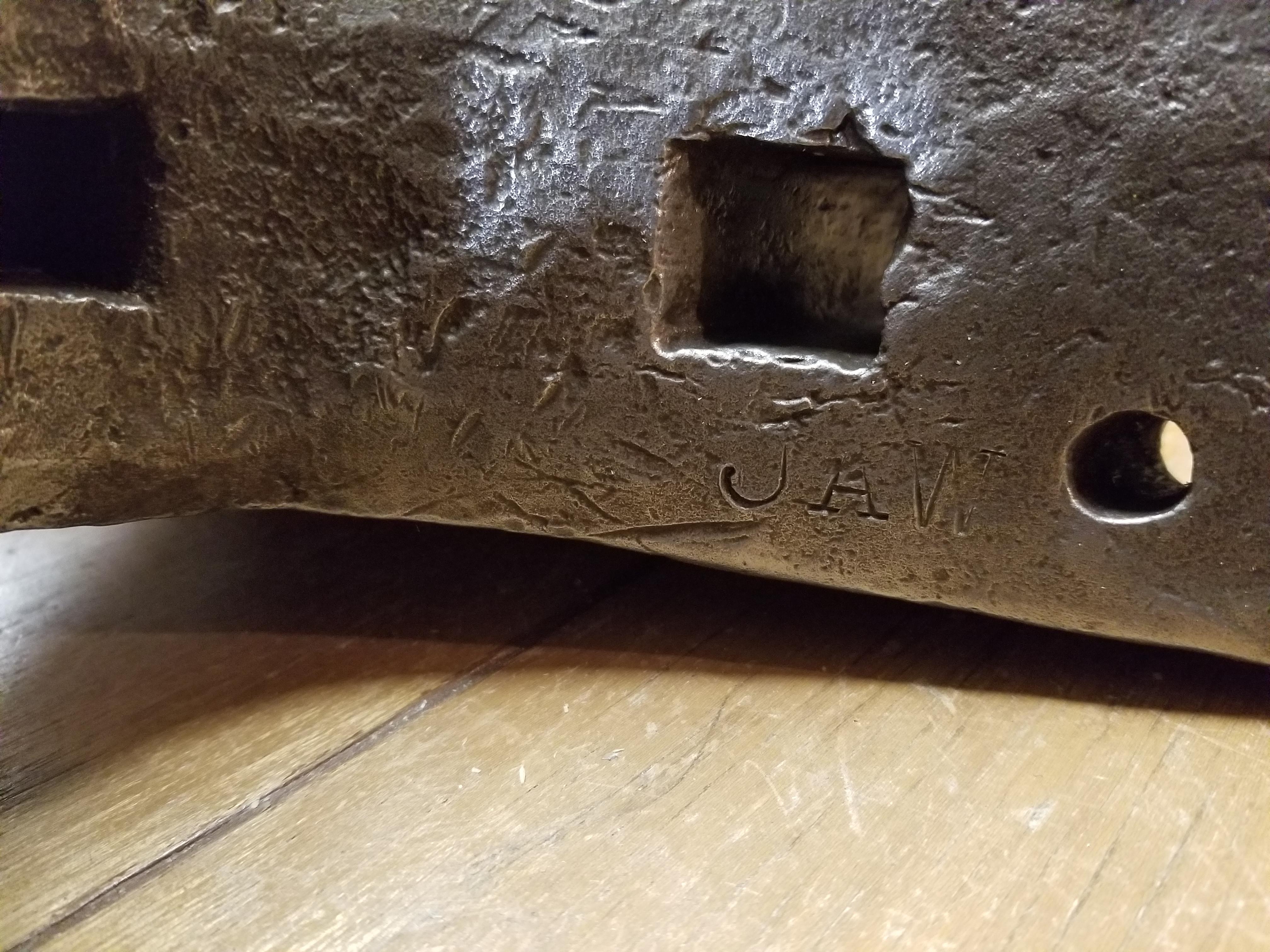

Chubby Posted April 22, 2019 Share Posted April 22, 2019 Picked up this anvil in Milwaukee to get me started in blacksmithing. No room to make a permanent setup, so wanted an anvil easy to store tucked away inside until I am ready to bring it out. Next I will start to build a small propane forge. Rebound seemed pretty good, dropping a bearing from 10" it would bounce between 8.5"and 9" over majority of the face. 'JAW' appears twice on the bottom and once on the back, what does this mean? Quote Link to comment Share on other sites More sharing options...
Frosty Posted April 22, 2019 Share Posted April 22, 2019 Welcome aboard Chubby, glad to have you. What do you mean, "get you started?" That lady is in fine shape, I don't see a spot on it I wouldn't use, just a little care and your Grandkids will be bragging about using their GrandFather's anvil. What's it weight? I'm guessing it's reasonably light. JAW was probably stamped into it as identification. I like paint of a color no thief would be caught dead with in his/er possession. My initials are JAF they get remarks from smart alecs. I just don't let mine out of my sight. SWEET score by the way. Have you skimmed the Burners 101 and Forges 101 threads? There is a lot of discussion of propane forge and burner construction, orientation, size, shape, etc. Plus lots of ideas some even practical! Frosty The Lucky. Quote Link to comment Share on other sites More sharing options...
Irondragon Forge ClayWorks Posted April 22, 2019 Share Posted April 22, 2019 JAW, probably a prior owners initials. Quote Link to comment Share on other sites More sharing options...
ThomasPowers Posted April 22, 2019 Share Posted April 22, 2019 Owner's stamp; hope they don't come a looking for it! Quote Link to comment Share on other sites More sharing options...

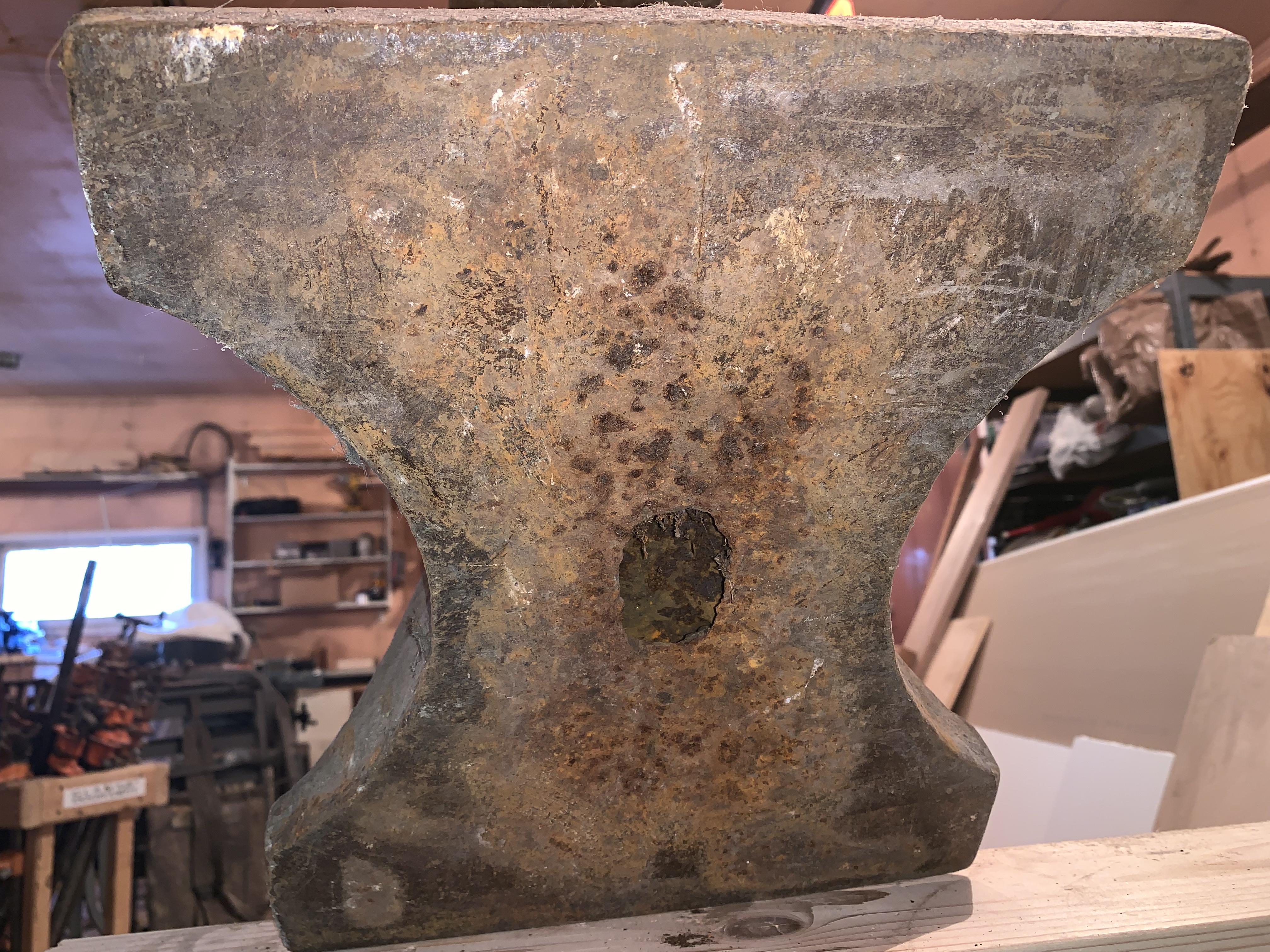

JMWW Posted April 25, 2019 Share Posted April 25, 2019 On 4/16/2019 at 6:40 PM, ThomasPowers said: What were the ball bearing test results? And a picture of the bottom please. I got 50-60% rebound by the horn, 40% over the center and down to around 30% by the hardy hole. It weighs 270 lbs. And here’s a picture of her bottom. Quote Link to comment Share on other sites More sharing options...
ThomasPowers Posted April 25, 2019 Share Posted April 25, 2019 Large hollow in the base---Buel Patent? (does it extend up into the body?) Those values are low for the ball bearing test; are you following the exact process? Clean face? Real ball bearing, (round mild steel balls give as lower reading than a real hardened ball bearing)? Quote Link to comment Share on other sites More sharing options...

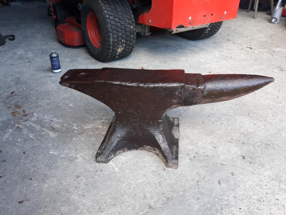

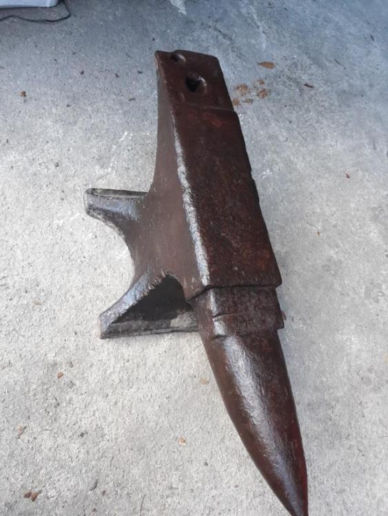

D Jones Posted May 9, 2019 Share Posted May 9, 2019 I need to see if I can find any info on this anvil. I am a total noob to them. Does it look like anything that someone has possibly seen in the past? What kind of markings am I looking for. Quote Link to comment Share on other sites More sharing options...
Frosty Posted May 9, 2019 Share Posted May 9, 2019 Well, in general it looks pretty beat up. The face plate is missing from just in front of the hardy hole to the end of the tail and the edges are kind of beat up. I usually recommend against "repairing" an anvil's face plate but this one's a candidate. This could well be one we've seen here before one of it's outstanding features was missing face plate in the same general location but there have been several different anvils with similar damage. About markings. How important are they to you? Do you want a historical artifact or a working tool? Sure, it's cool to know a little of a tool's history, I have a fair handle on my Soderfors' history but zero idea about my Trenton's history. Both work just fine. If you're looking for a good tool I'd pass on that one. I don't know the condition of the remaining face plate, it could be delaminating and have poor rebound and be ready to break again. It'd have to be a really good deal before I picked it up and I know how and have the equipment to repair that kind of damage. Serious PITA though. Be patient there are better anvils out there if you take your time and hunt. Are you using the TPAAAT method? It'll come right up in a search, it's an effective way to hunt most any kind of tool. Frosty The Lucky. Quote Link to comment Share on other sites More sharing options...
Daswulf Posted May 9, 2019 Share Posted May 9, 2019 I think I see a hunderdweight stamp in the first picture. Can you get better pictures of that side and maybe the other? Easy there Frosty. Yeah the tail section of the faceplate is gone but theres lots of life left in that old girl. Look up and try a rebound and ring check on it . The ringing or thud will tell you if the rest of the faceplate is solid, and rebound will tell you how good whats left is. Still, its an anvil. Use it. Just take it very easy on the heel. It could still hold a hot cut for not so heavy work. Quote Link to comment Share on other sites More sharing options...
Irondragon Forge ClayWorks Posted May 9, 2019 Share Posted May 9, 2019 It looks like someone has welded up the edge to me. I would probably pass on that one too, unless the ring & rebound was good and the price was fair. What does it weigh? Quote Link to comment Share on other sites More sharing options...
Daswulf Posted May 9, 2019 Share Posted May 9, 2019 Not sure, but being in the show me Your anvil thread, I would guess he owns it now. Looks more like mushrooming on the edge to me. Quote Link to comment Share on other sites More sharing options...
Irondragon Forge ClayWorks Posted May 10, 2019 Share Posted May 10, 2019 When I blew up the second image, the edge is a different color than the rest of the anvil and I see the arc bead of a stick weld. Quote Link to comment Share on other sites More sharing options...

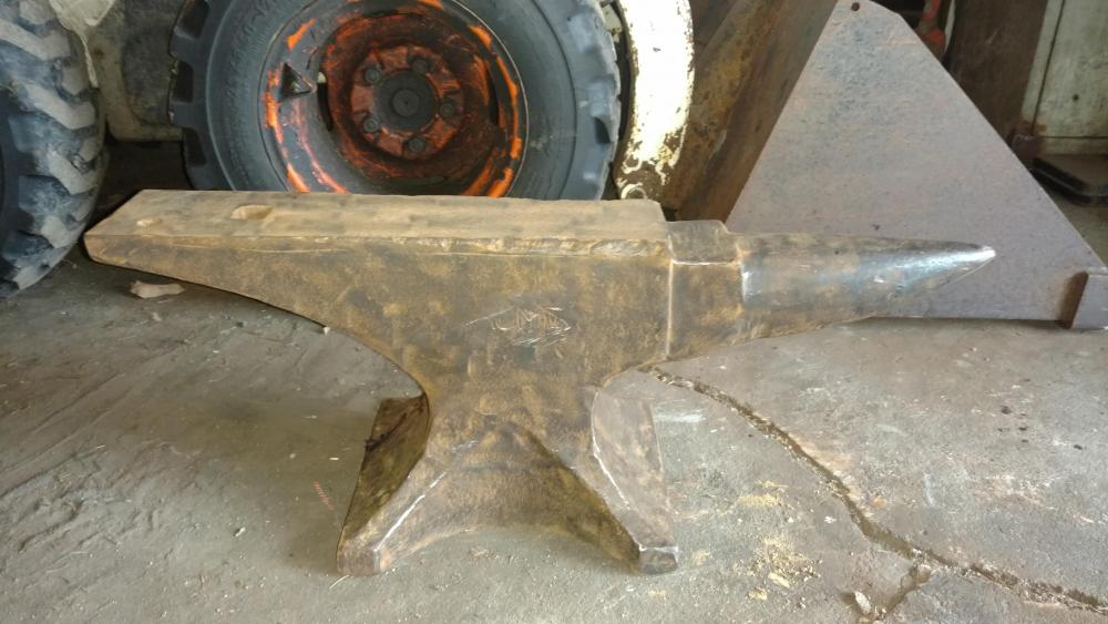

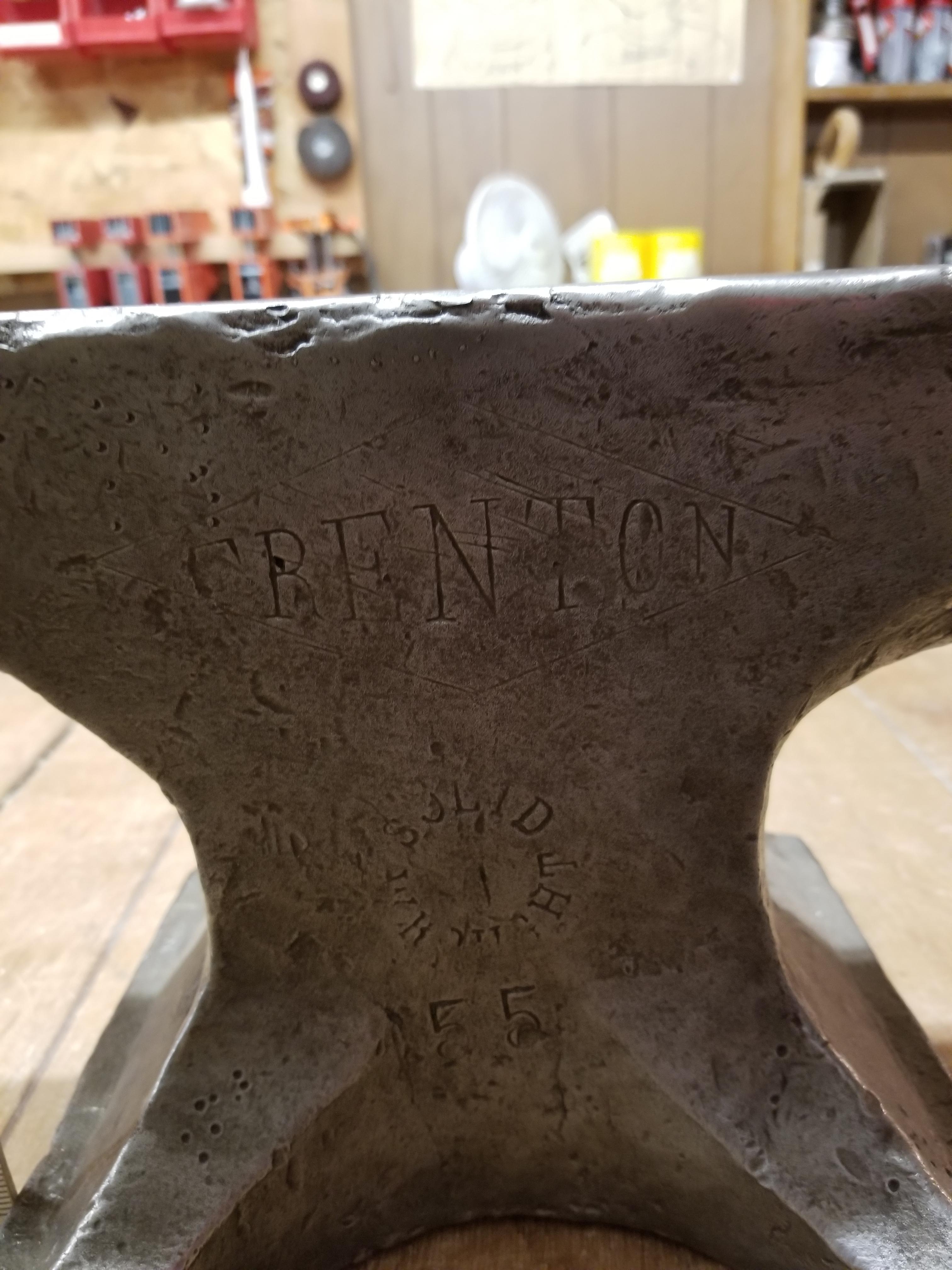

BV Forge Posted May 14, 2019 Share Posted May 14, 2019 I have a couple to share. My 112 lb Hay Budden, and my 200 lb Trenton/ACME Quote Link to comment Share on other sites More sharing options...

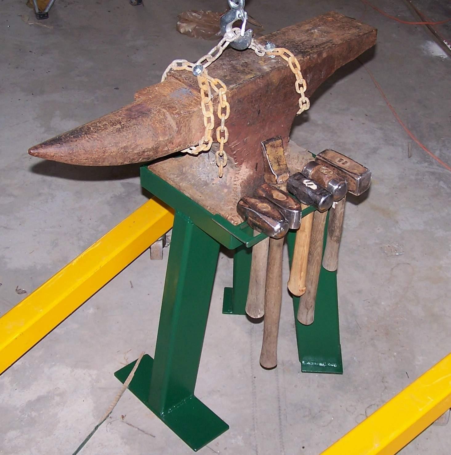

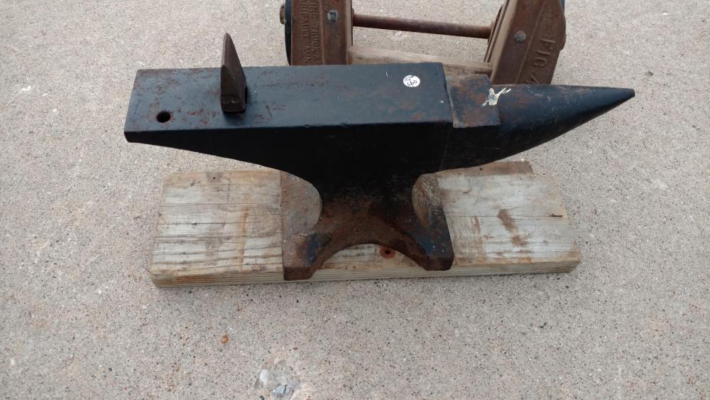

Old Crew Posted May 14, 2019 Share Posted May 14, 2019 I just got my first anvil and am hoping that someone here can tell me more about it. I have been a welder for many years but have never forged anything so I will be collecting and hopefully learning new [old] ways to work metal. here are a couple other pictures of my new anvil. I was told that it is a Bavarian armor makers anvil . When i first got it I put it on my welding table but it was much to high so I have started to make the stump base in the other pictures. Quote Link to comment Share on other sites More sharing options...
