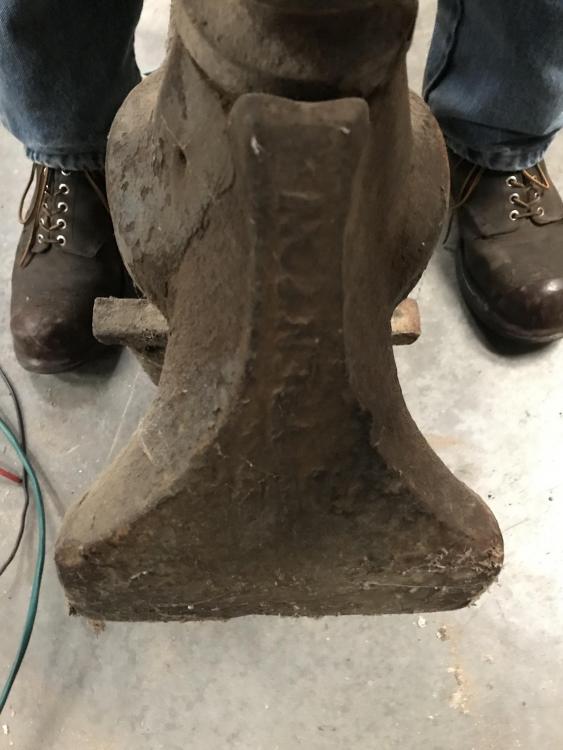

  2. Another scrap yard find - pays to make friends with workers . They set stuff aside for me - i belive it’s been retrofitted - Handle doesn’t look stock many advice would be helpful . I’m not worried about welding rhe old cast iron I’ve welded allot of nasty old cast iron and havnt had any cracked welded or purosity or failed welds yet . i just don’t know what to do as far as making it function besides need a leather belt to drive the blower

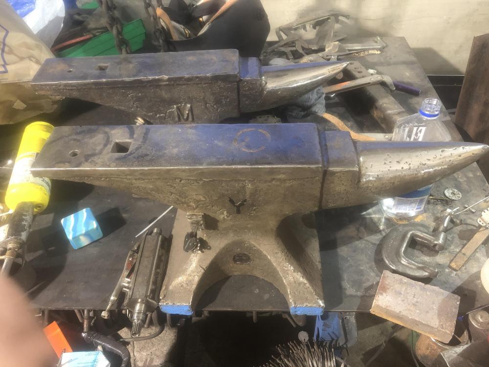

  8. Hello so my local Scrap yard is a frequent place I go to And one of the employees about months ago told me they had anvil at that time the owner was not willing to sell well yesterday I got this for 150 bucks I figured it be a lot better to get my hammer control down on this that it would be on my hay budden or Columbian’s and most will probably tell me a paid too much but locally I could resell around 300 once I fix the edges . I’m pretty sure it’s all right iron it’s got about 80% rebound and weight originally was 177 currently and currently without the hill is 157 it has warranted and what looks like to you FTS them printed on it as well as JF i’ve tried doing some research and I can’t find anything on it

  13. 172 hay budden carved out by hand a red wood block for a stand and have a 1/2” top plate bolted down with flat bar welded to some pipe that’s welders rk rhe plate so I have tong and hammer holders on bothbsides but now is to big and i want to change the stand but not bad first run That I fallowed the anvil mag write up on how to repair adds damage and repaired mine and fixed some top plate damage and am waiting to have a freind who has a mini machine shop and is going to use a surface grinder to give me the most accurate flat top plate but don’t want him taking more than a 1/32 off the original top plate and said he could clean up all the weld build up on the sides cause I was nervous to do it and mess it up cause it took 6 hours to fix and so far had bony lost any rebound what so ever but didn’t want to do it again I’d i didn’t have to . Also repaired 5 other anvils this way which paid for my 110 columbian and the 240$ in electrodes 120 columbian not mounted yet am going to build steel stand 110columbian needs stand

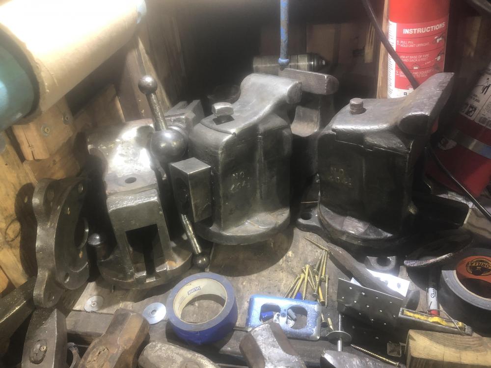

  16. MD Just showing collection. As of right I have 14 post vises and a few anvils. Today I am going to go pick up what I believe to be around 5 3:4” Peter Wright in Santa Cruz I have a lead on a 6 inch one in writing a 5 1/2 inch one in Turlock 34 inch ones for 65 bucks apiece in Nevada city actually Carson City and then a few more over in Sacramento if anyone was looking . Lately that’s been a hot spot thus will be the second blacksmith shop in the area in the last 30 days that I am lucky enough to get first dibs . Last one I spent every nickel I had and still only scratched the surface of what they had . I really enjoy digging though old shops not touched in 50-80 years . anyways back on topic I currently have 7” iron city 150 lb screw pretty worn and leg chopped short not by me though 7” Indian 150 lb amazing condition 6 1/2” Columbian 130 lb needs new rivets as it’s come loose 6” Peter Wright 100 lb screw box has all writing legible and the crest jn the center - in amazing shape 6”iron city 100 lb - got at last shop in Lodi and is the first one I’ve ever seen without chamfers on the legs and the dual arm bench mount . Is this a newer version ? Doesn’t lok forge welded 6 “ unknown manufacturer 110 lb some wear in sweet spot of threads but I’m good shape still 6” Indian 100 lb in great condition and crest somewhat legible but suffered at had pitting on brace supporting arm 5 3/4” Peter Wright 90 lb In even better condition than the 6” 5 3/8 iron city 80 lb with chamfered legs in great condition but I need to reassemble it just got done going through electrolysis bath 5 1/4” iron city 70 lb with chamfered legs pretty Much unused in amazing condition 5” unknown manufacturer has 62 1/2 stamped on jaw and some lettering but no one has been able to identify it yet 5” newer drop forged columbian 35 lb only keeping cause it’s xxxx near perfect condition 4 1/2” iron city 45 lb just got this one man was the screw stuck on this one so bad I had the whole thing cherry red and the force needed to break lose cracked the screw so I had to weld it back - currently is electrolysis bath 4 1/2” frankin vise . Don’t know weather I should order some acme thread and a nut and make a screw and screw box or fabricate the oversized one it come with that’s obviously not not meant for it 4” Trenton 35 lb I traded a banch vise Thad was in mint condition for among trent ones i've sold in last 6 months 5 3/4” columbian P5 3/4” Trenton 4 1/2 “ columbian 41/2” iron city 5” columbian 4 1/2” arthor O’Leary also so I have a 6” columbian bench vise I’m restoring model 506-2 and had new jaw inserts made for it - picked up for 50$ model 4041/2 swivel jaw and base reed vise only negative is the swivel base was cracked in half but I welded it back together Actually just picked up another one of them the base is tore up actually it welded the top to the base but the rest of it seems pretty good and intact I have a prentiss bench vice but I don’t know the model number and have had a hell of a time trying to clean up the cast-iron is so full of purities so I have to use an order nasty cast from Vulcan . But it has a pretty cool swivel locking mechanism Unlike anything I’ve seen does anybody have any insight I also have a couple anvils 172 hay budden i fallowed anvil mag way of fixing the edges and am waiting for my buddy to have room in the shop to put it on the surface grinder and get everything nice and clean and done as far as the edges and table or let me know if I need to fill more 120 lb columbian 110 lb columbian It’s amazing how 10 pounds softener and they ring it completely differently I must admit 110 pound one is annoying high pitch ring I have all parts to post vises some are not done being cleaned up /restored
  17. Iron city have the short chambered legs and extremely thick jaws and all have Avery distinctly well made springs . I wdtually copy their design when making. Springs for my other post vises both picture im confident are iron city’s . Iron city where one of 3 company’s I know of the did that type of bench mount but iron city are the distinct in their thickness and design
  18. Looks like a iron city . Nice vise !
  19. I may be getting a couple screws and screw boxes soon the post voices are badly damaged but I could repair them but it would not be as good as it should be so I figure part and out I’ll let you know if you want to sizes of the diameter of the thread and dimensions of the screw box in case you want to get on instead of making one .one of the Post vise is that will be dismantled id a 6 inche and the other was a 5 inch ones iron city and one I believe is an Arthur I’ve had to do quite a few repairs a different post versus the worst was one had been previously attempted be repaired poorly and because the job had been knocked off all the way down almost to the base where the screw box is actually actually went in a little bit into screw boxes so there’s a lot of chamfering and a lot of rods and passes when I did was clamp the two jars together and put about a 3/32 shim the bottom so that way they were correctly angled and just kept welding it was a think a 4 1/2 Iron city after all things said and done you couldn’t even tell and it was perfectly lined up I just took a lot of work inside the hole the screw box goes in a lot of time spent with the carbide bur cleaning out the area I. They go so that one for 125 bucks but I let the guy know what happened and what repairs have been done
