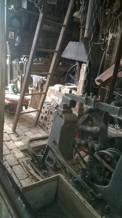

Hawkeye Helve
I used one a few weeks back. I suspect like all mechanical hammers, efficiency depends a lot on 'tune'. Example being- I moved the helve connection, back towards the pivot, more directly over the crank. Made a world of difference, compared with the previous 2 or 3 weekends on it. Hit harder and almost got the springs effective. Far more work would be good to do on it. A challenge with these unguided helves, is that the die faces are parallel in one position, only. This can be overcome with rocker or round-back tool.

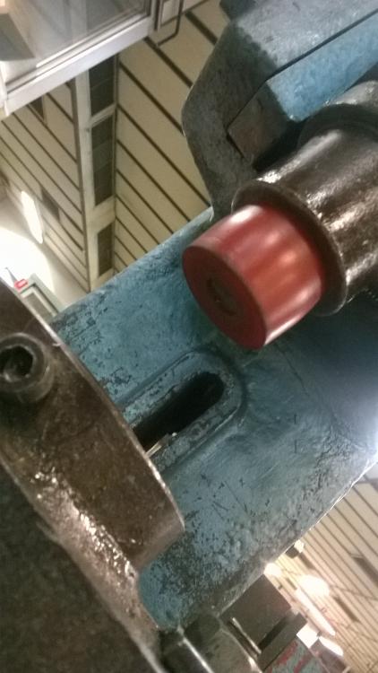

Hole punch for cold material, self 'stripping'.
Hi all, Prompted by a comment about tooling pics, here is a nice set-up I didn't do. Is at a local technical college I go to. Red thing is a soft plastic/ hard rubber that strips the job off the punch, after cutting. cheers, AndrewOC
