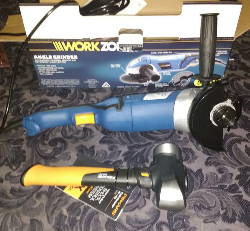

  1. I have the 3lb version. Cost me about $70 at the local hardware big box here in Australia (for my daughter to give to my on my birthday last year). Had it for about 8 months. Needed very little work on the face / peen to clean it up, I love the hammer, particularly the wide straight peen. It is definitely my go to 3lber. I thought I would be getting rid of the handle fairly early and going to wood, but it is just fine as it is. Just dont "hook" hot metal with the hammer to move it in to place, melts the handle pretty quick!

  5. I have the 3lb version. It is by far my favourite hammer in that size. Cost me $70 though here in Oz. I to just smoothed off the face, and the straight peen is a great size, far to many peens are to narrow for my taste. When I bought it I just assumed I would tire of the synthetic handle and get around to putting a wood one in it at some stage, but I love it, nice and comfortable.
