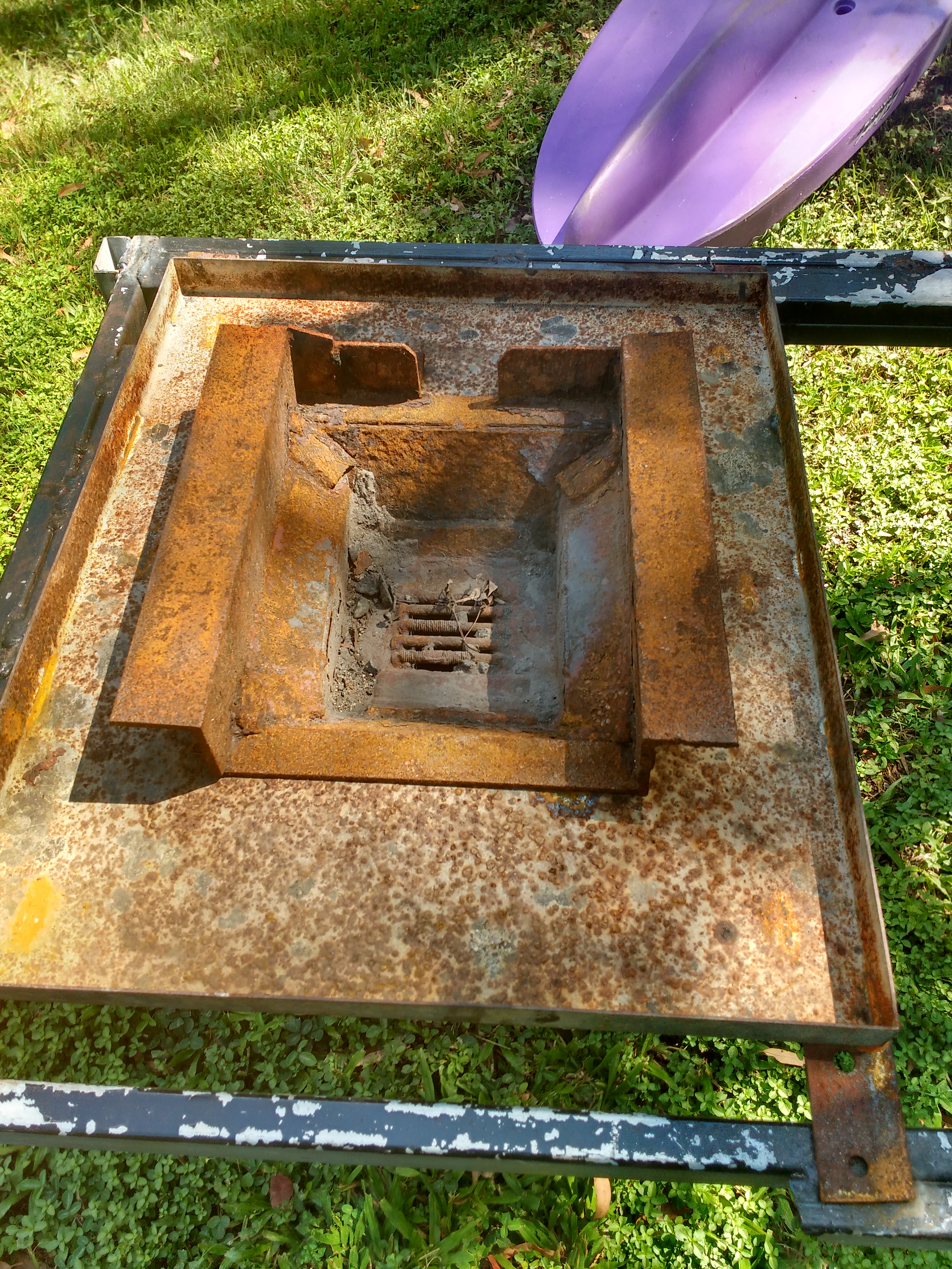

I'd say your outer two rows of drilled holes are probably redundant. No great issue just leaving them there (as long as nothing flamable is under your forge, as hot ash and small coals may drop through them) I'd widen up the entry slot / notch, (give you a bit more room to move) back side is probably fine as is. Otherwise looking good! I've just dropped my coke forge in to a similar tray. So I am really hoping your idea works well
