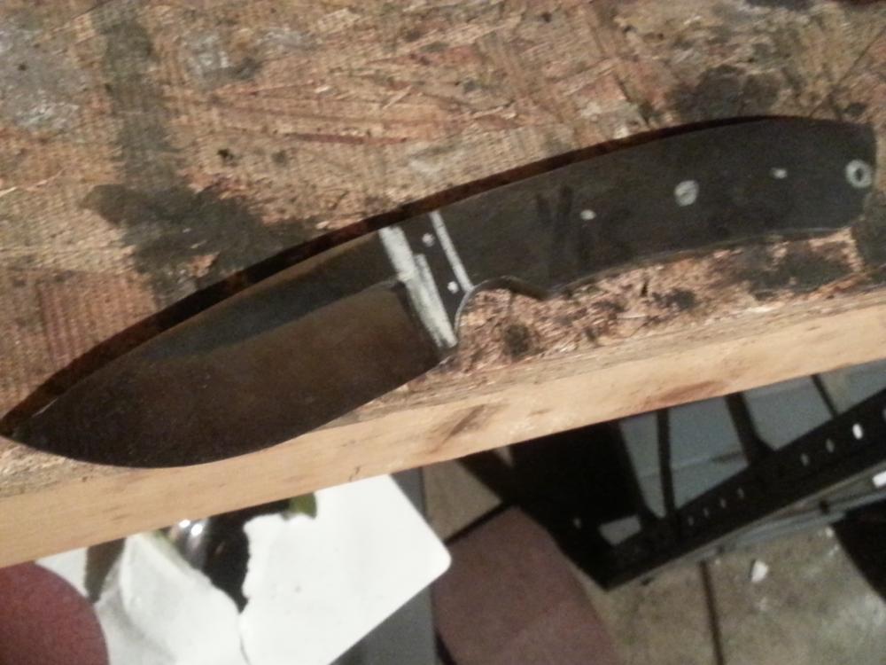

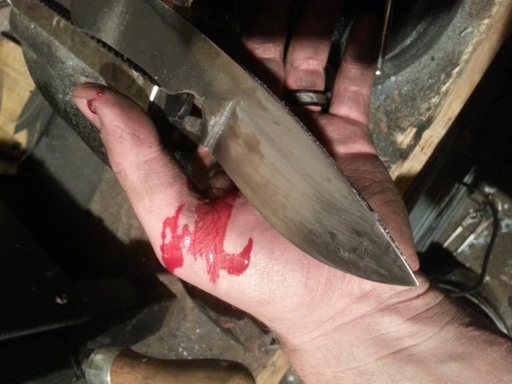

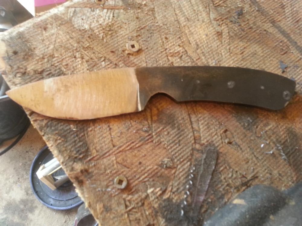

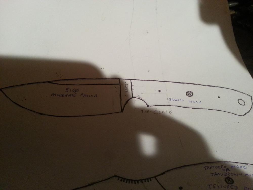

I've been talking to some of you about a skinning knife I'll be making with a checkered handle. It's part of a set themed around some of the great American explorers. The first knife in the set, "The Clark," is a pretty straight forward drop-point hunter. Here's the WIP. here's the design. Full tang 440c, with a brass guard, pins, and a mosaic center pin, and a lanyard hole. the beginning grind and rough work screwed up my grind line trying to cut corners, so I decided to take the grind clear back to the spine.and the obligatory injury photo. Working on the polish tonight. More pictures tomorrow. Feedback is welcome!- 5 replies

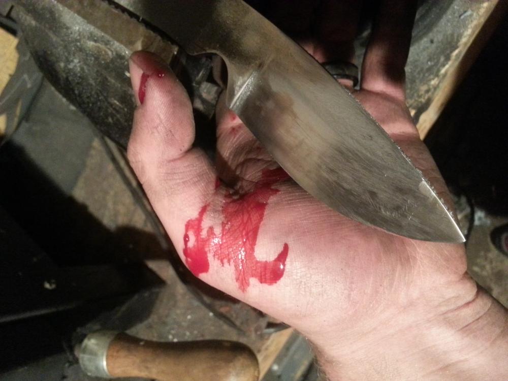

I've been talking to some of you about a skinning knife I'll be making with a checkered handle. It's part of a set themed around some of the great American explorers. The first knife in the set, "The Clark," is a pretty straight forward drop-point hunter. Here's the WIP.... and the obligatory injury photo. More to come tomorrow.
