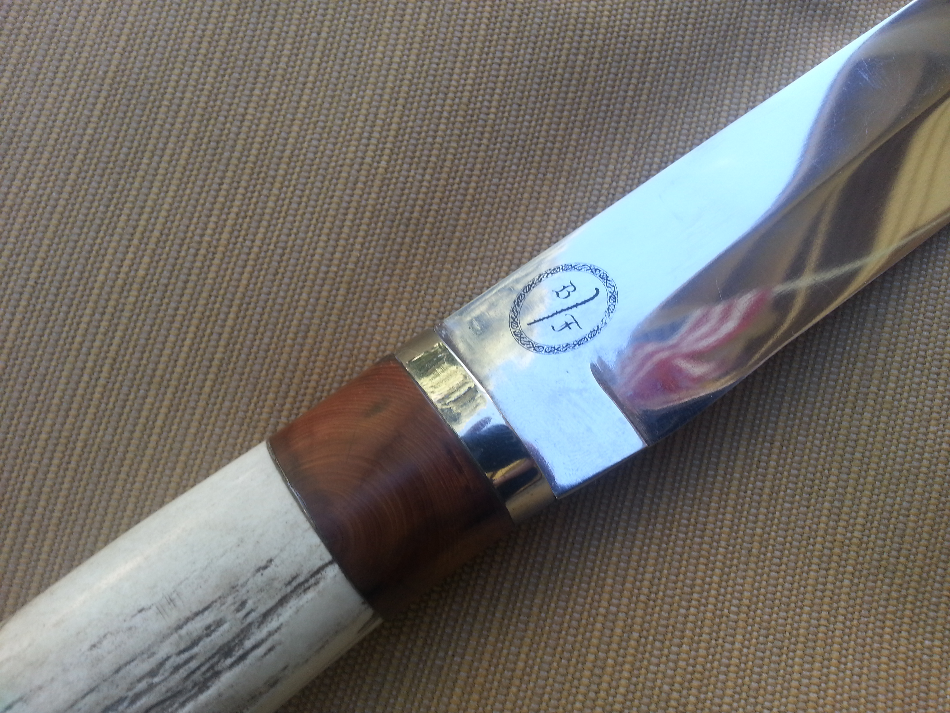

Hey all, Posted this in the blacksmithing critique section but I think it may be better suited here. The knife is a large Scottish dirk that I made a while back. The handle is made from some kind of antler (either small elk or huge deer), with Scottish yew wood and nickel silver accents. The tip got boogered up when I dropped it in a parking lot, so ideas on fixing that are welcome. I think the first picture makes it look a bit bent, but it seems pretty straight in person. All critique and advice is welcome!

This is a traditional Scottish Dirk with an antler handle. The blade is made from 440c stainless and has a mirror finish. It has Scottish Yew and nickel silver accents. The tip got boogered up because I dropped it in a parking lot, so I'm aware of that issue already. Thinking of carving an inset in the antler axis for a pewter clan badge. Also it's not actually bent, as the first picture suggests. Hope you can see in the other pictures that it's straight.

J.w.s, can you elaborate a bit more on the "sloppy" comment? Are you specifically talking about the finish and scratches or is there more to it? Not offended or anything-I want honest and brutal feedback. Also what can I do on future projects to fix "sloppy?"
Thanks for the advice. I had a feeling the minor things might kill this one. I rather like the modern-historic crossover so maybe I'll just keep this one both as a personal favorite, and a reminder about how important the small stuff can be in our art. I really like the input you guys had for me, and I think most of the critique was stuff I had identified too. It's definitely good to get an outside perspective. Thanks again!
