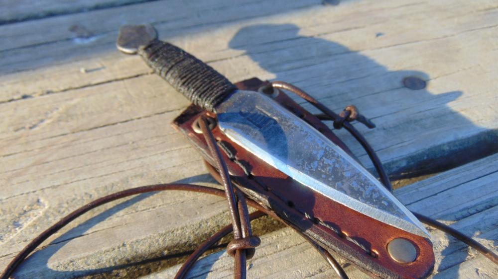

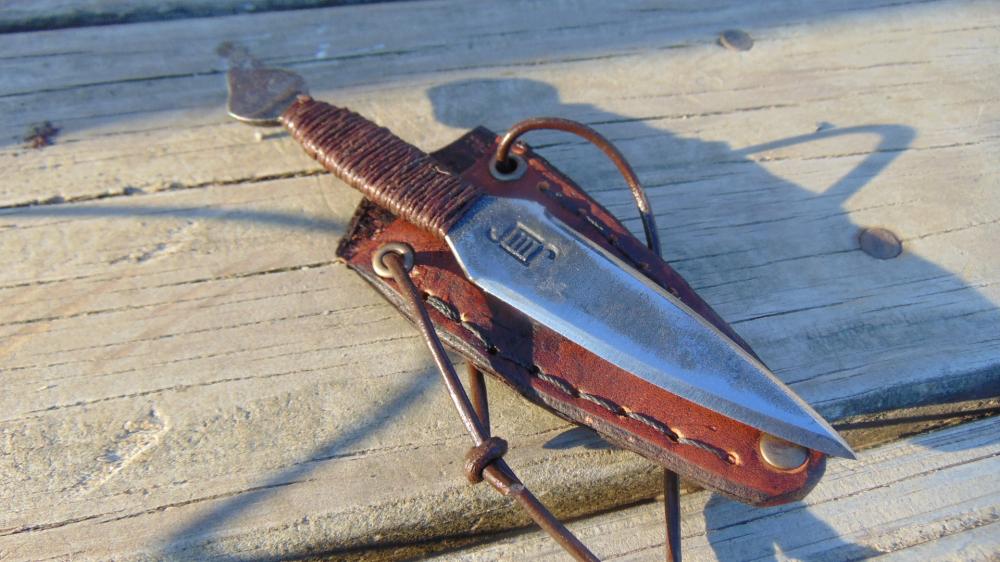

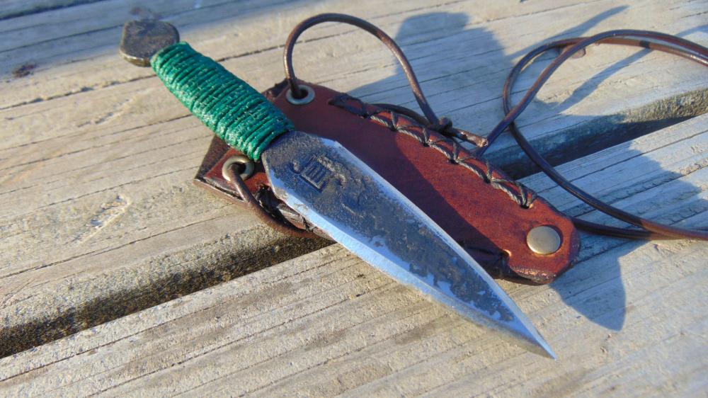

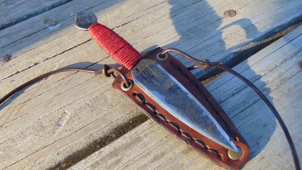

Here's a few neck knives I did out of 1080. I'm working on developing something relatively fast to make, a consistent look and with a low price point. One of the things about working the shows I do, just because there's 15,000 people on a weekend doesn't mean that it's 15,000 people willing to drop a few hundred on a hand forged knife, so enter the $60-$75 price range neck knife. So here's a few pictures of some of the ones I made this past week. Sold 3 over the weekend and it was torrential downpours for most of it, so I'll have to wait until PARF starts in August to really make a determination whether or not these are a "thing". :) I'm wrapping the handles with bamboo cord or hemp cord, then dipping them in clear lacquer to give it a little more resistance to abuse. Keeping the overall look on the rough side, just concentrating on the cutting edges with the sander. The sheaths are just two small pieces of leather, 2 eyelets and a rivet - even with the stitching and dying they take about 10 minutes to throw together from start to finish.

I like those,!  What is the blade length?
gives me an idea for a variation on that theme.
The sheaths are nice too.

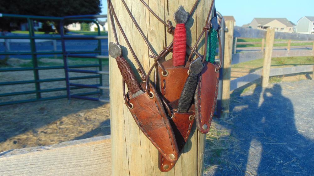

Overall is 5.5", the blade length is 2.625". I've got a couple variations in the works as well. The idea is to make 10 of them fast, little effort and keep the price marginally above the Pakistani blades for sale around the corner but far below most of my other hand forged fixed blade knives. Give the customer something made by a person they met and got to talk with that's a decent alternative to something cranked out en mass in an over sea factory.

I see what you meant by "sloppy" on my Kris post!  Very cool style.  My good friend uses 2-man saw blades for his knives and comes up with a very similar "rustic" look.
You know way more than I do, as apparent by your product! But I'd like to suggest something.
Have you considered folding the sheaths from a single piece? Putting the fold right where the rivet is? I think it would add a nice touch, and not cost you any time or money.
Anywho... I like the rivet in the sheath, I don't like the idea of it but it looks nice. Good job!
