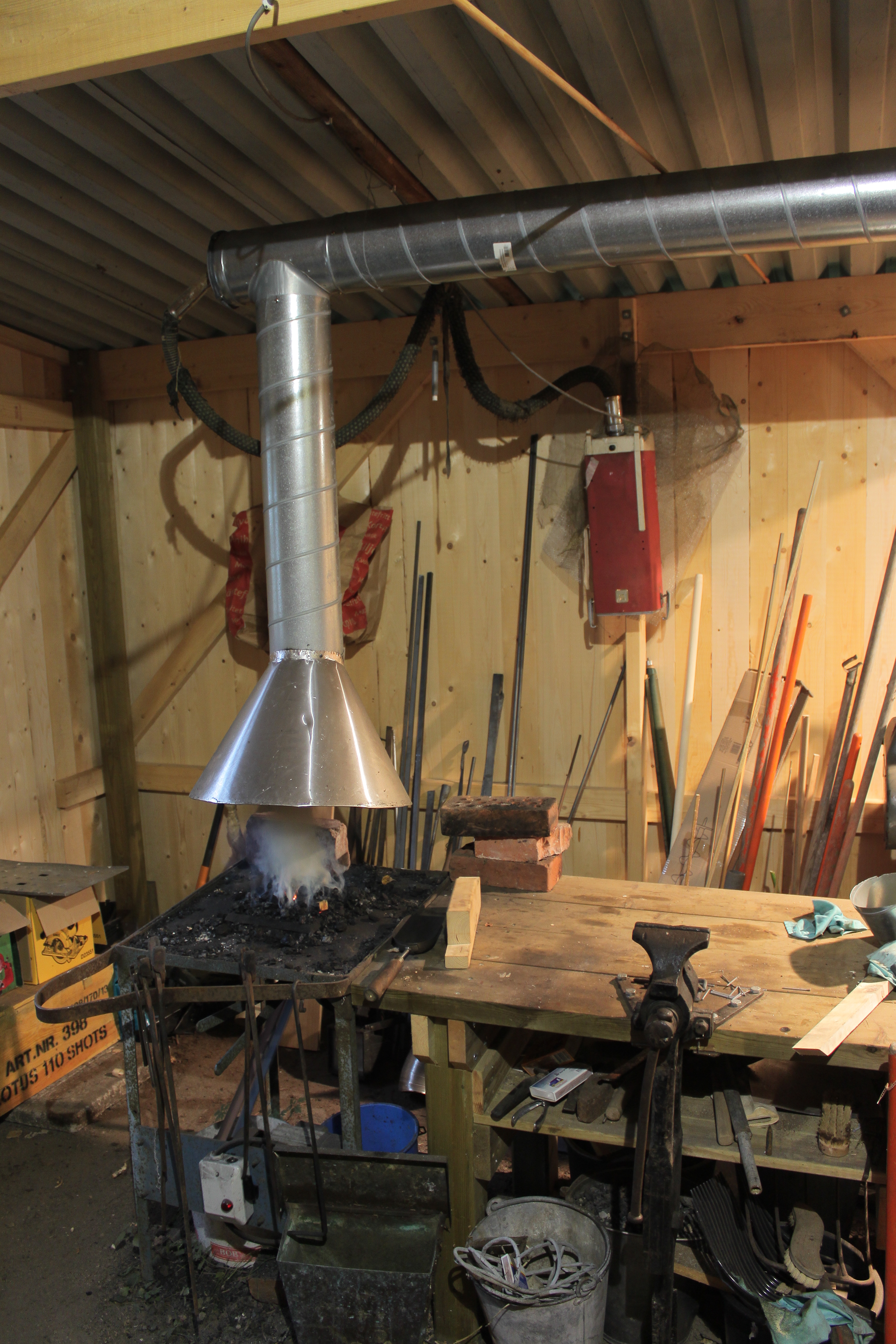

  7. my first picture Göte It worked! This shows my funnel with new coals added to show smoke Göte
  8. I am using an exhaust with forced draft. I have a conical funnel (8" back 12" front) above the fire. A 6"pipe (Yes sir only 6") up to 6" below the ceiling and then horizontally (I did not want to take hole in the roof) out of the building. At the bend -Tee actually - I blow air from an old vacuumcleaner. This way I get a kind of ejector that pushes the smoke out. A real exhaust fan for hot smoke is far too expensive for me. All air that leaves the shop goes through this funnel. All smoke is sucked into the funnel and pushed out through the wall. I have zero smoke problem. This works perfectly if I have the doors shut. As soon as I open a door, the resulting draft pushes the smoke to the side so some of it escapes the funnel and goes into the shop. If I were to have a second exhaust in the shop, that exhaust would pull the smoke back into the room. As I see it, the important "ventilation" is to get the smoke out. This means to have the exhaust close to the forge and no other air exit that competes. To put in a fan that pushes extra air into the building will of course improve the situation as long as it does not disturb the smoke from going into the funnel - an exhaust fan in the wall will pull smoke back into the shop. I do not believe that my ejector makes all the difference a good vertical flue would work the same way. I realize that your situation is not my situation but this is what works for me. Cheers Göte

  14. I certainly appreciate that you curmugdeons feel the need for this thread but I doubt that anyone of the targeted youngsters will read it. If they do not read threads directly answering their query why should they read this? I think that you are a bunch of very kind and sometimes humorous people. I would probably show more irritation than you do if I had to answer the same question again and again. I think that you do a wonderful job and I am very grateful. Someday I will even have time to show my bottleopeners, anvils, shop and perhaps contribute my own slant on the art of blacksmithing. In the meantime I am only lurking and do the odd post wihout any pictures. By the way I am unable to see the pictures which are referred to by URLs. I get a 404 error Sorry we cannot find.... All the best Göte
  15. C2H5OH can be helpful too Cheers Göte
  16. I do more or less what Frosty and Smooth Bore do. Most of my flue/chimmney is horizontal since I did not want to make hole in the roof. I use an old vacuum cleaner turned backwards as a jet to get the smoke out, I have a funnel above the fire that goes into a vertical pipe that is a meter or so and ends into a 'T' The cleaner is blowing into one side of the horisontal part of the 'T' and all smoke is blown ot through the other (which is around 3m long). It really works very well. I get away with 16cm spiro pipes They get a surface temp of around 100 deg Celsius. The vacuum cleaner is of the type that has a body running on the floor and a hose (which I used) connected to the business end. The horizontal part lies loose in a "cradle" so it pivots away if I need to service the forge. Have a nice weekend Göte
