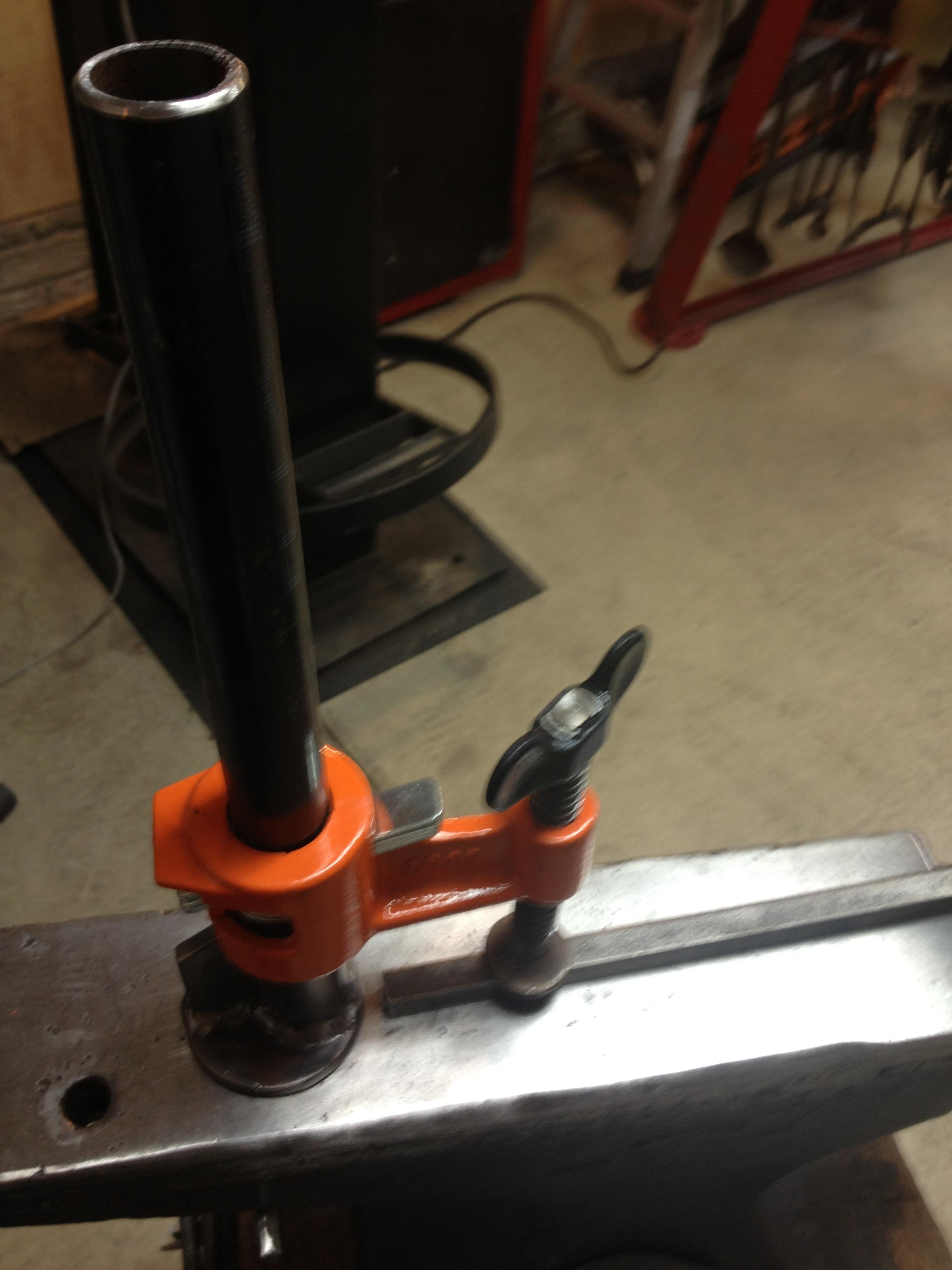

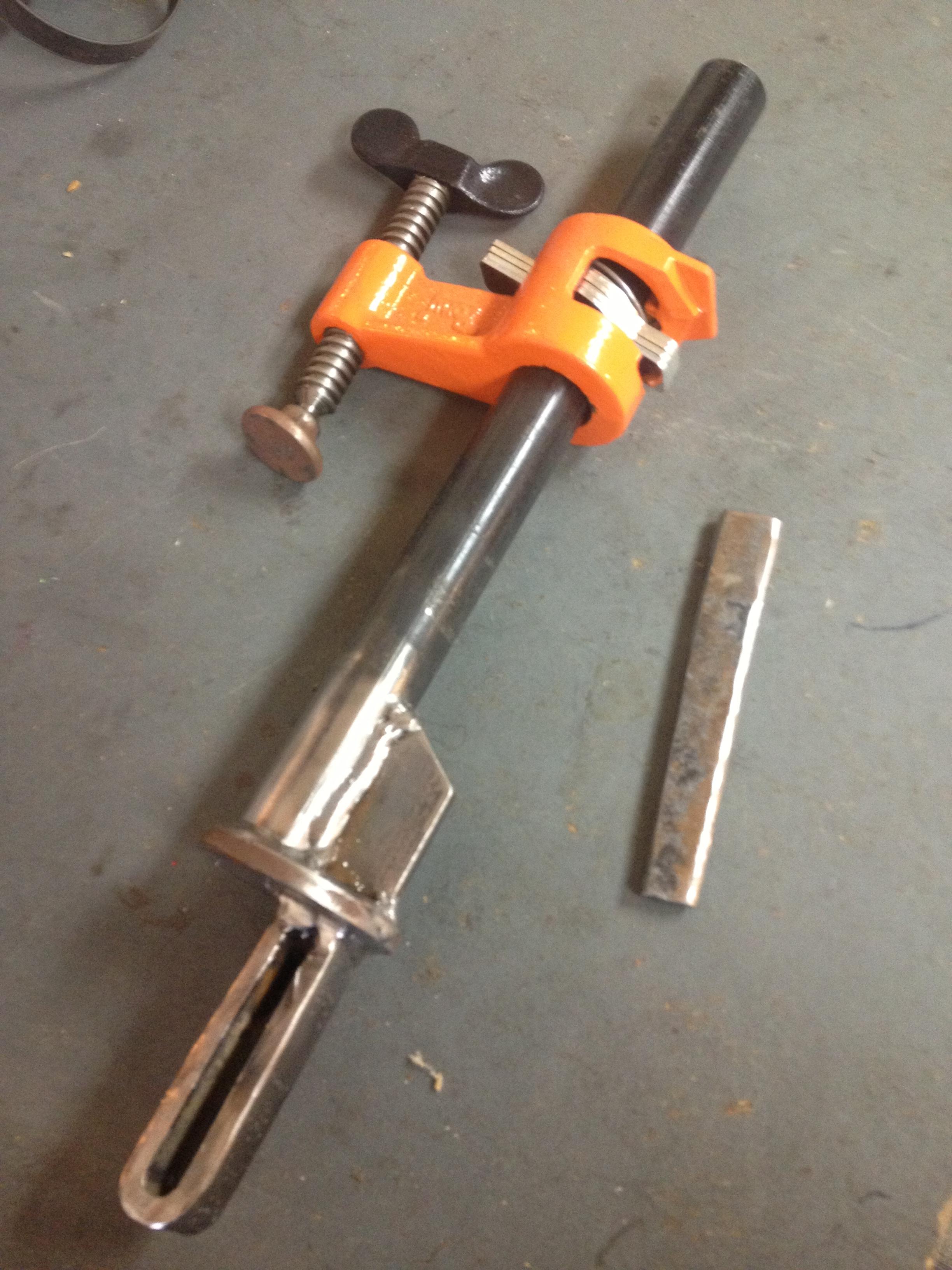

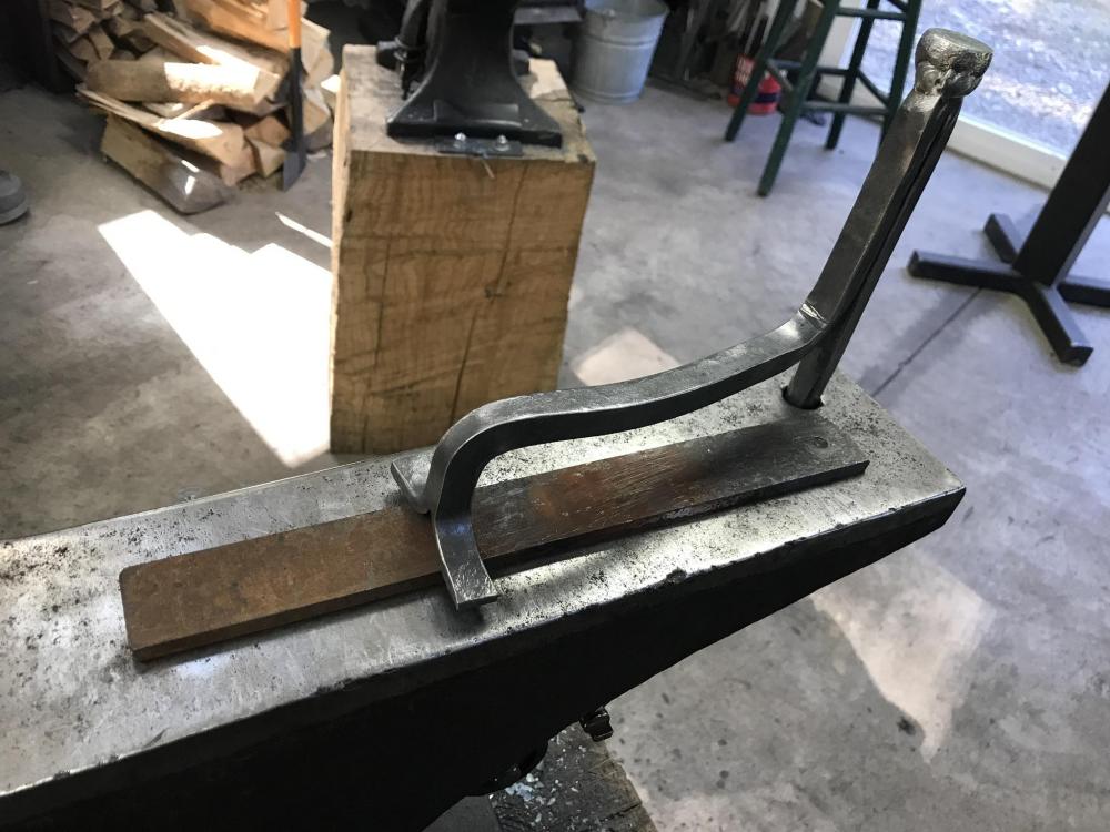

Greetings LE, You might try this design I made years ago, The upright is a pipe welded to a pass through with a wedge holding it from the bottom. Than just use a simple pip clamp . This design only takes up a small amount of anvil surface. Forge on and make beautiful things Jim
Greetings Le, You might try the one I designed . It will hold flat stock as well as round and square on the diagonal. I just finished a demo at my shop and most who attended when back to their shops to make one. Mild steel will work just fine. Notice the offset which allows holding long stock. Easy to make . Let me know if you have questions. Forge on and make beautiful things Jim

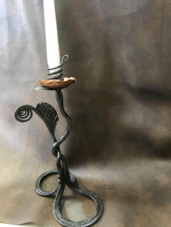

Greetings 671, Just a few on display. Mostly done cold . Yes they were made for customer selection but I no longer accept commissions. Forge on and make beautiful things Jim
Greetings 671, Lots of possibilities. Here are just a few that I have on display. Forge on and make beautiful things Jim

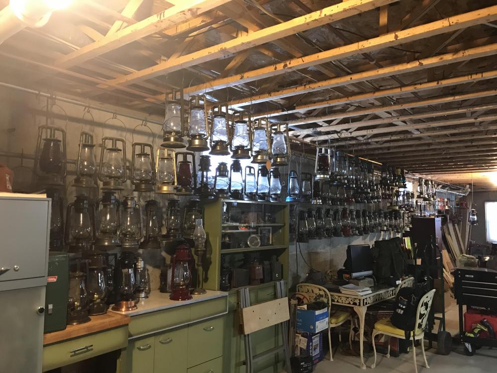

Greetings Chris and Irondragon. Lanterns are addictive. I only have 5 Aladdin’s butttttt 250 plus wick style. Been restoring and collecting for 50 some years. Without kerosine lanterns this country would not have made as much progress. Many companies started making lanterns and additional companies followed suit. Lenses by Corning , steel, and of course Standard oil. Lots of history in lanterns. If only they could talk. Have fun and of course Forge on and make beautiful things Jim

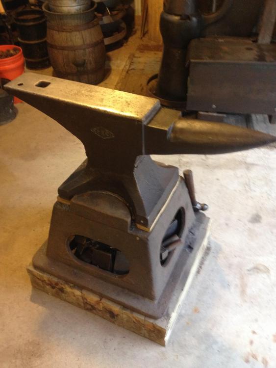

Trenton 138# with a custom cast iron stand
Jim Coke replied to Heinrocket's topic in Anvils, Swage Blocks, and Mandrels
Greetings Heinrocket, Trenton special build .. 300 lb on a 500 lb base all tool steel from the belt line up. Case base to boot. Forge on and make beautiful things Jim -
