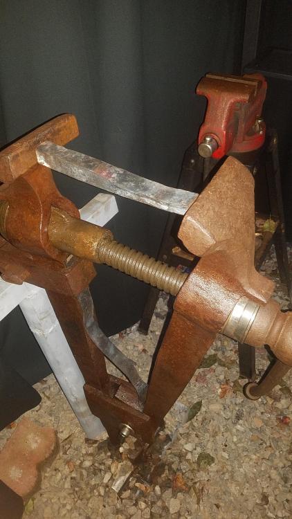

jlpservice, I just realized i never posted a picture in response to your question. Surprisingly the double spherical washer set appears to stay tight to about 12 inches. I do not see any gaps. I opened the ID if the washers by about 0.050 inches.

I am in the process of making /adjusting the spring and building the stand. I think I may have to make the ID of the washers a little larger than what i currently made. The spherical radius itself can provide about15 degrees of rotation. i bought two just in case I needed to add them in series for increased range. The distance from the pivot to the bolt is about 40 inches which would produce about a 12Deg sweep angle when separating the jaws by 4 inches. the bolt is about 1.75 inches and i will need to grind the washer opening to about 1.790 inches to allow free rotation to that angle. Wow, that was too much math for a saturday before my first cup of coffee
Actually, i found a set i could modify for cheap from Amazon, Morton Low Carbon Steel Spherical Washer Sets, Equalizing Washers, Inch Size, 1-5/8" Bolt Size. I had to grind the ID a bit but for 9 bucks it was worth it compared to the cost at McMaster.
Yeah, toluene and a bottle brush did the trick. I ordered a spherical washer set and everything is working smoothly. Now I need to build a stand this weekend.

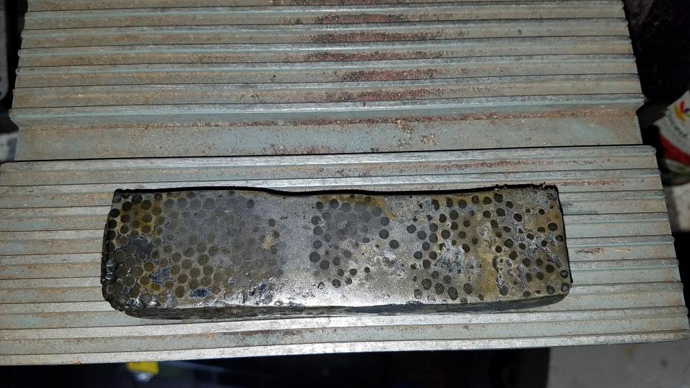

Well, I experimented with canister Damascus over the weekend. I want really thinking I would be all that successful. I did it to test out a)if my forge can get to good welding heats b) do I really need a press, how difficult by hand. The canister was 1.25x 5", 1084 powder, 52100 ball bearings. Liquid paper worked great, took me a minute to chisel it off. I took a quick grind on one surface and etched in vinegar to see how the pattern came out -

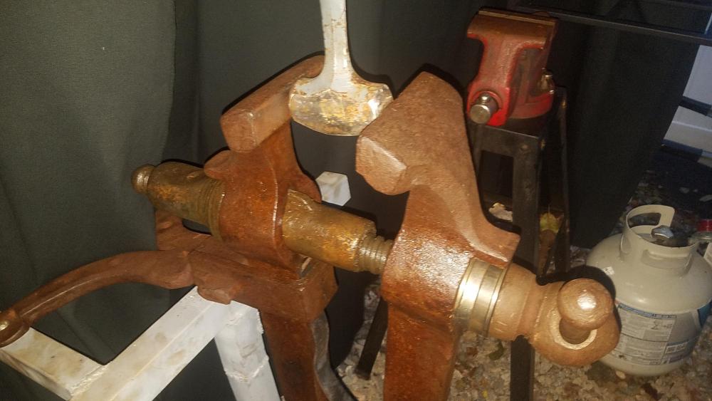

Well jlpservices thank you for kindly reminding me that there is a difference between being patient and being lazy I spent 3 hours and got it apart. I had to cut off the thrust washer but it didnt appear to be original anyways. Here are some pics of the threads after a quick clean. I have the parts soaking now. The lead in looks off and by the aligning the rust Mark's on the screw to the screw box you can see how the screw aligns to the dent. Some of the threads at the end of the screw looks a bit gnarly, but to my untrained eye the rest of the threads appear to be in really good condition.

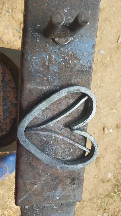

Well a friend at work who knew i just started blacksmithing as a hobby asked if I could make a heart with a V in it for his child's upcoming wedding. I told him that I am completely new to this but would give it a try. First thing I learned was that i need a larger scrap pile...only had mild steel rounds that were adequate length. Secondly I need to make a hold down tool . Not the prettiest of things but I got a little more experience using the horn. -
