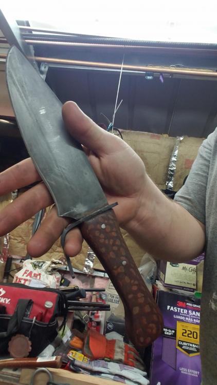

  6. Sorry for the delayed response five points... yes it is a hidden tang and I did start my bevels at the anvil but finished them and cleaned them up at the grinder. I normalized the blade twice, the first cycle I took above non magnetic let it soak for about 5min and for the second I had the forge turned down a little lower and did the same but watching the color of the steel it was a little cooler then the first cycle. I dont have a thermocouple so I dont know the exact temps. For the quench I heated back to non magnetic and let it soak for about 5min and quenched in warmed canola oil that was 130 degrees F. Tempering was done for 2-45min cycles at 400 degrees F.

  9. Thanks, yea it fits my hand well and I've chopped through 2 sections of 2×4 with no issues but I can see where it could cause issues. Thanks for the feedback and I will keep it in mind for future work.
  10. Hey guys heres some photos of my second knife attempt and I actually finished this one. The first knife I made from a leaf spring that I inexplicably dropped and broke after quenching but to my surprise the grain looked really good and tight. This knife is a bowie forged out of 80crv2 with a blade length of about 8.5". The guard is a piece of scrap spring steel forged to shape. The handle material is leopard wood fastened with epoxy and stainless steel roof nails that I cut for pins. I also purposely tarnished the blade with mustard and warmed apple cider vinegar for protection.

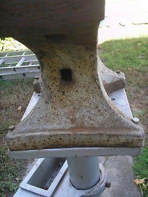

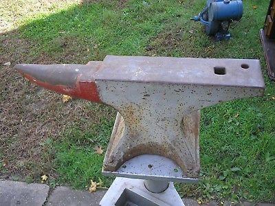

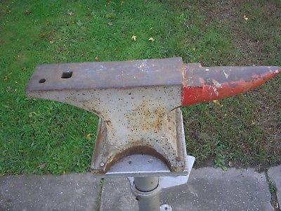

  11. Anvil stand is great! Very stable as long as it's on solid flat ground. I haven't done any sledge work on it but swinging my 4lb cross peen for hours and not even a wiggle. it actually came with the anvil I did have to shorten it up about 10 inches because the person I purchased it from mounted it for display. Also pleased to have done some wire brushing and found out that my anvil is a Peter wright.

  14. Dls1990 changed their profile photo
  15. Thanks for the welcome, not that I necessarily need to know the anvil maker was just curious if anyone had a thought on what it might be. Looking at other anvils I kind of thought it could be either a Peter Wright or mousehole but either way it's a great anvil. Good rebound and a nice clean surface to start pounding some steel on. Just happy months of looking for a clean affordable anvil paid off!
